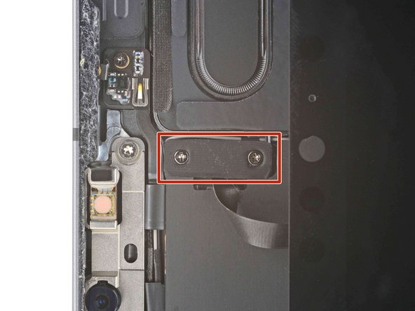

  24. iPad Pro 11" 2nd Gen Screen Replacement, Unscrew the ambient light sensor cable bracket: crwdns2935265:024crwdnd2935265:01crwdnd2935265:02crwdne2935265:0 iPad Pro 11" 2nd Gen Screen Replacement, Unscrew the ambient light sensor cable bracket: crwdns2935265:024crwdnd2935265:02crwdnd2935265:02crwdne2935265:0
    FixMat
    $36.95
    • Use a Phillips screwdriver to remove the two screws securing the ambient light sensor cable bracket to the logic board:
    • One 1.3 mm screw
    • One 2.0 mm screw
    • During reassembly, this is a good point to power on your iPad and test all functions before sealing it up. Be sure to power your iPad back down before you continue working.
  25. iPad Pro 11" 2nd Gen Screen Replacement, Remove the ambient light sensor cable bracket: crwdns2935265:025crwdnd2935265:01crwdnd2935265:01crwdne2935265:0
    • Use a pair of tweezers or your fingers to remove the bracket.

  44. iPad Pro 11" 2nd Gen Screen Replacement, Unfasten the display cable bracket: crwdns2935265:044crwdnd2935265:01crwdnd2935265:02crwdne2935265:0 iPad Pro 11" 2nd Gen Screen Replacement, Unfasten the display cable bracket: crwdns2935265:044crwdnd2935265:02crwdnd2935265:02crwdne2935265:0
    • Use a Phillips screwdriver to remove the two 1.2 mm screws securing the display cable bracket.
  45. iPad Pro 11" 2nd Gen Screen Replacement, Remove the display cable bracket: crwdns2935265:045crwdnd2935265:01crwdnd2935265:02crwdne2935265:0 iPad Pro 11" 2nd Gen Screen Replacement, Remove the display cable bracket: crwdns2935265:045crwdnd2935265:02crwdnd2935265:02crwdne2935265:0
    • Remove the display cable bracket.
