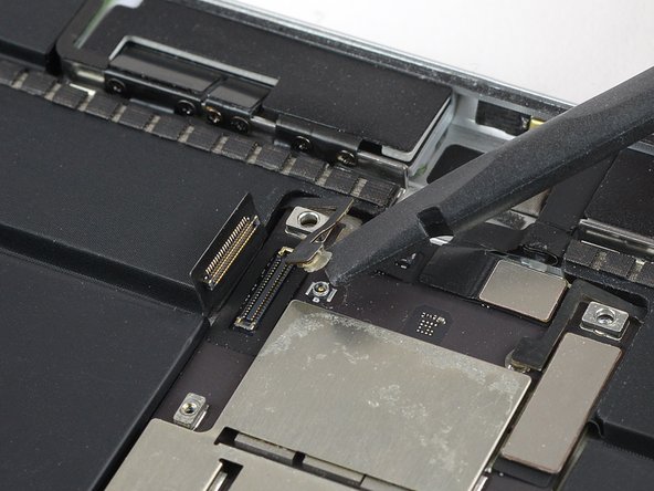

  20. iPad Pro 10.5" Battery Replacement, Remove the front-facing camera: crwdns2935265:020crwdnd2935265:01crwdnd2935265:03crwdne2935265:0 iPad Pro 10.5" Battery Replacement, Remove the front-facing camera: crwdns2935265:020crwdnd2935265:02crwdnd2935265:03crwdne2935265:0 iPad Pro 10.5" Battery Replacement, Remove the front-facing camera: crwdns2935265:020crwdnd2935265:03crwdnd2935265:03crwdne2935265:0
    • Use the edge of a spudger to pry up and disconnect the flex cable for the front-facing camera.
    • Remove the front-facing camera.
  21. iPad Pro 10.5" Battery Replacement, Battery: crwdns2935265:021crwdnd2935265:01crwdnd2935265:03crwdne2935265:0 iPad Pro 10.5" Battery Replacement, Battery: crwdns2935265:021crwdnd2935265:02crwdnd2935265:03crwdne2935265:0 iPad Pro 10.5" Battery Replacement, Battery: crwdns2935265:021crwdnd2935265:03crwdnd2935265:03crwdne2935265:0

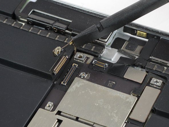

    • Use the edge of a spudger to pry up and disconnect both the left interconnect cable and antenna cable. Fold them gently out of the way.
    • If either cable is glued to the board, use a little heat to soften the adhesive so you can separate the cable without damage.

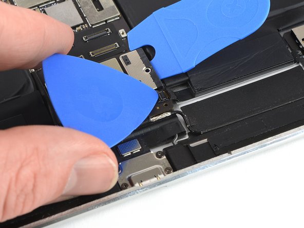

    • For the following steps, you'll need to relocate the Battery Blocker you inserted earlier.
    • The battery isolation pick or battery blocker is an outdated way of isolating the battery, as you risk damaging the battery pins underneath the logic board. If you use this method, take extreme care to insert it gently and straight in the direction of the logic board. Do not twist or swing the pick side to side.
    • Remove the Battery Blocker from the battery power connector.
    • Slide one side of the Battery Blocker under the battery power connector, and ensure that it doesn't cover the ZIF connector for the SIM card tray flex cable.
  26. iPad Pro 10.5" Battery Replacement: crwdns2935265:026crwdnd2935265:01crwdnd2935265:01crwdne2935265:0

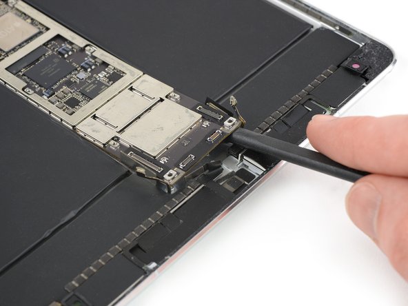

    • In the following steps you'll be very carefully prying up the logic board. The place to lift it is very tight. Avoid damage to the left and right interconnect and antenna cables, by making sure they don't get caught by the logic board when prying it up.
    • Insert the flat end of a spudger between the logic board and the rear case of the iPad.
    • Use the spudger to slowly pry up the right side of the logic board.
    • If the adhesive is too strong to pry up the logic board, apply some additional solvent and give it time to penetrate.
    • Pry up the left side of the logic board until you can get a good grip.
    • Don't try to remove the logic board all the way! It is still connected to the bottom area of the iPad.

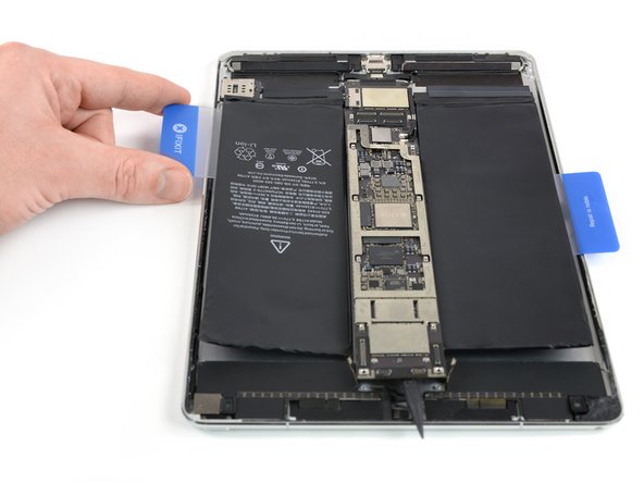

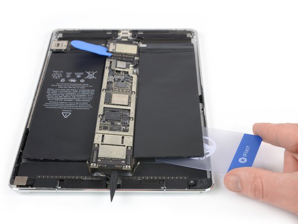

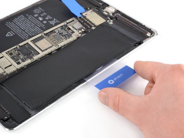

  30. iPad Pro 10.5" Battery Replacement: crwdns2935265:030crwdnd2935265:01crwdnd2935265:02crwdne2935265:0 iPad Pro 10.5" Battery Replacement: crwdns2935265:030crwdnd2935265:02crwdnd2935265:02crwdne2935265:0
    • Lifting from the top edge, swing the logic board upwards to a 45° angle to ensure all adhesive beneath is separated.
    • Use a spudger or opening pick to separate any remaining adhesive as needed.

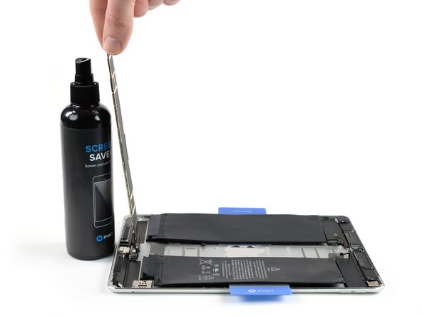

  31. iPad Pro 10.5" Battery Replacement: crwdns2935265:031crwdnd2935265:01crwdnd2935265:03crwdne2935265:0 iPad Pro 10.5" Battery Replacement: crwdns2935265:031crwdnd2935265:02crwdnd2935265:03crwdne2935265:0 iPad Pro 10.5" Battery Replacement: crwdns2935265:031crwdnd2935265:03crwdnd2935265:03crwdne2935265:0
    • Set the logic board back down, leaving the spudger underneath to prevent the adhesive from re-sealing.

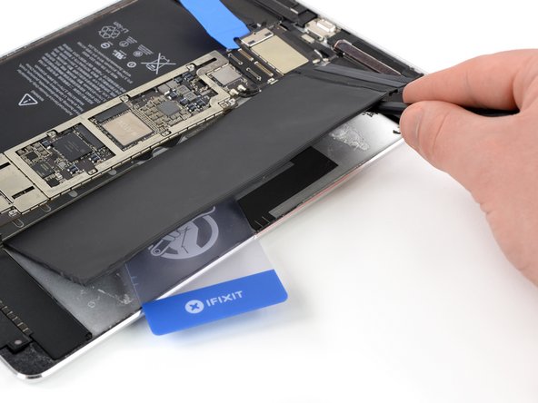

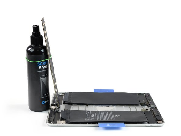

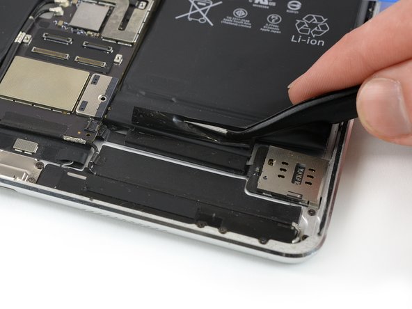

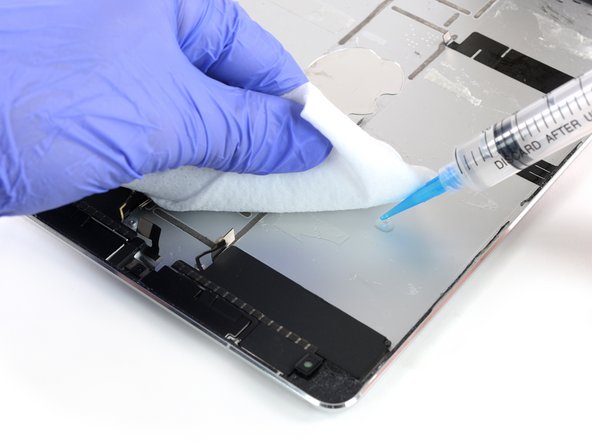

    • In the following steps, you'll use a liquid solvent (such as iFixit Adhesive Remover or high-concentration isopropyl alcohol) to weaken the adhesive under the battery. The location of the adhered areas and the Smart Connector flex cable underneath the battery are shown in the last two images:
    • Adhesive
    • Smart Connector cable

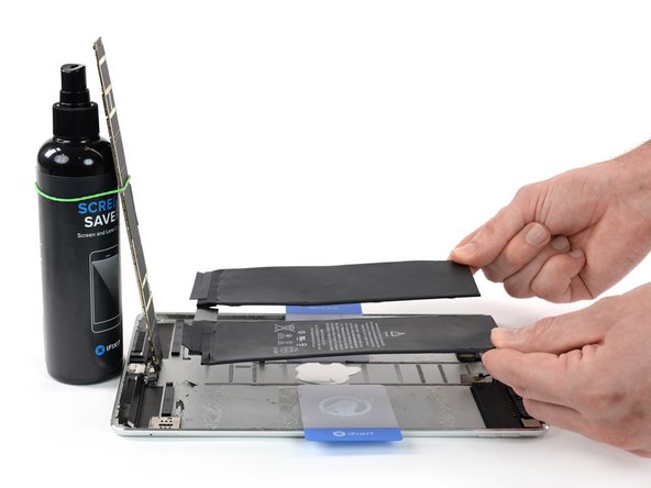

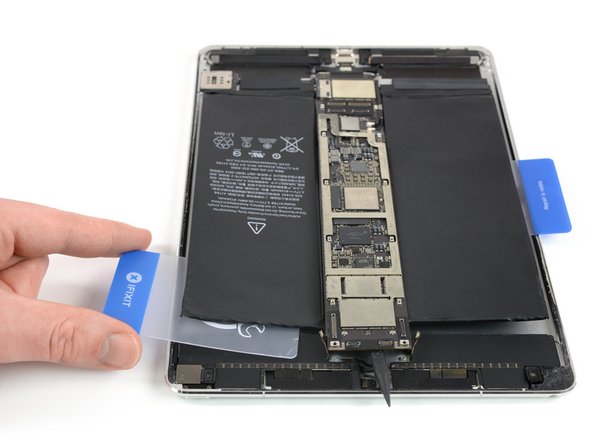

  32. iPad Pro 10.5" Battery Replacement: crwdns2935265:032crwdnd2935265:01crwdnd2935265:01crwdne2935265:0

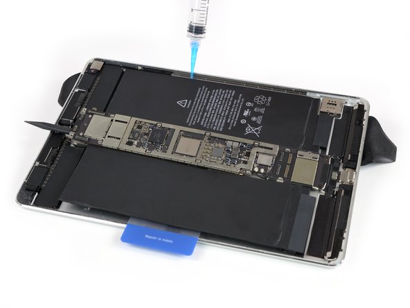

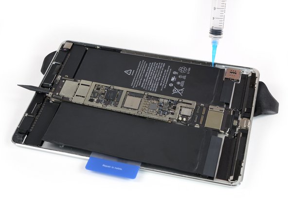

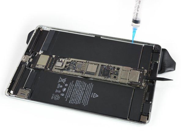

    • Elevate the left side of the iPad (long edge nearest the headphone jack) by placing an iOpener underneath, so that the iPad lays down at an angle.
  33. iPad Pro 10.5" Battery Replacement: crwdns2935265:033crwdnd2935265:01crwdnd2935265:03crwdne2935265:0 iPad Pro 10.5" Battery Replacement: crwdns2935265:033crwdnd2935265:02crwdnd2935265:03crwdne2935265:0 iPad Pro 10.5" Battery Replacement: crwdns2935265:033crwdnd2935265:03crwdnd2935265:03crwdne2935265:0
    • Do not apply any solvent to the Smart Connector flex cable to avoid it loosening during the battery removal.
    • Apply some solvent underneath the battery at the three separate points where the longer adhesive strips are located. Only apply the solvent point by point and not in a seamless movement.
    • Allow the solvent to penetrate for several minutes to help weaken the adhesive.
  34. iPad Pro 10.5" Battery Replacement: crwdns2935265:034crwdnd2935265:01crwdnd2935265:03crwdne2935265:0 iPad Pro 10.5" Battery Replacement: crwdns2935265:034crwdnd2935265:02crwdnd2935265:03crwdne2935265:0 iPad Pro 10.5" Battery Replacement: crwdns2935265:034crwdnd2935265:03crwdnd2935265:03crwdne2935265:0
    Plastic Cards
    $2.99
    • Remove the iOpener so the iPad lays flat, and rotate it so the headphone jack faces towards you.
    • Insert a plastic card underneath the battery cell, starting near the outer corner.
    • Wiggle the card from side to side and push it under the battery to separate the adhesive underneath.
    • Stop before you reach the Smart Connector flex cable, or you may damage it. Leave your card inserted to keep the battery from re-adhering.
  35. iPad Pro 10.5" Battery Replacement: crwdns2935265:035crwdnd2935265:01crwdnd2935265:03crwdne2935265:0 iPad Pro 10.5" Battery Replacement: crwdns2935265:035crwdnd2935265:02crwdnd2935265:03crwdne2935265:0 iPad Pro 10.5" Battery Replacement: crwdns2935265:035crwdnd2935265:03crwdnd2935265:03crwdne2935265:0
    • Carefully insert a spudger underneath the battery at the same hight as the display connectors. You might need to reapply an iOpener or adhesive remover.
    • Be careful not to puncture the battery by prying too hard.
    • Pry up the battery using the spudger and cut the remaining adhesive with it.
    • Lift the battery with the spudger to ensure all the adhesive is loosened.
    • Place the plastic card under the center of the battery cell, and leave it there to prevent the adhesive from re-sealing.
    • Mind the Smart Connector cable.
  36. iPad Pro 10.5" Battery Replacement: crwdns2935265:036crwdnd2935265:01crwdnd2935265:02crwdne2935265:0 iPad Pro 10.5" Battery Replacement: crwdns2935265:036crwdnd2935265:02crwdnd2935265:02crwdne2935265:0
    • Elevate the right side of the iPad (long edge, nearest the rear camera) by placing an iOpener underneath, so that the iPad lays down at an angle.
    • Apply some solvent underneath the battery at the two leftmost adhesive strip locations.
  37. iPad Pro 10.5" Battery Replacement: crwdns2935265:037crwdnd2935265:01crwdnd2935265:02crwdne2935265:0 iPad Pro 10.5" Battery Replacement: crwdns2935265:037crwdnd2935265:02crwdnd2935265:02crwdne2935265:0
    • Continue separately applying solvent at the remaining two adhesive strip locations. Allow it to penetrate for several minutes to help weaken the adhesive.
  38. iPad Pro 10.5" Battery Replacement: crwdns2935265:038crwdnd2935265:01crwdnd2935265:03crwdne2935265:0 iPad Pro 10.5" Battery Replacement: crwdns2935265:038crwdnd2935265:02crwdnd2935265:03crwdne2935265:0 iPad Pro 10.5" Battery Replacement: crwdns2935265:038crwdnd2935265:03crwdnd2935265:03crwdne2935265:0

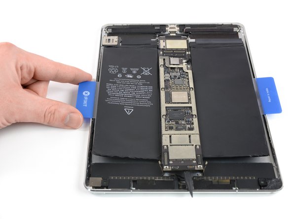

    • Wiggle the card from side to side and push it underneath the battery to separate the adhesive underneath.
    • Slide the plastic card down toward the bottom edge of the iPad and cut all the adhesive beneath the battery cell.
  39. iPad Pro 10.5" Battery Replacement: crwdns2935265:039crwdnd2935265:01crwdnd2935265:02crwdne2935265:0 iPad Pro 10.5" Battery Replacement: crwdns2935265:039crwdnd2935265:02crwdnd2935265:02crwdne2935265:0
    • Lift the battery cell slightly to ensure all the adhesive is separated.
    • Leave the plastic card under the battery to prevent it from re-adhering.

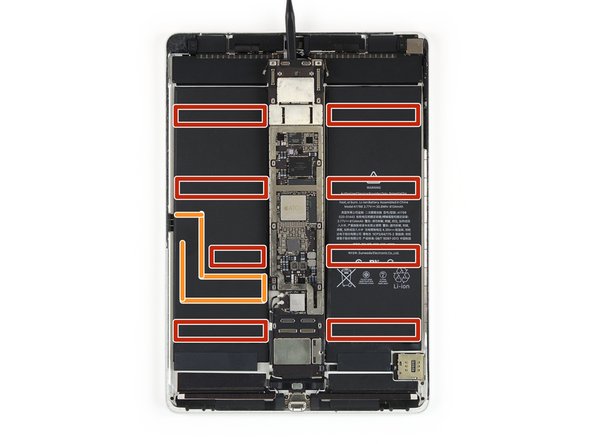

    • Peel up the black adhesive strip at the bottom edge of each battery cell, if they didn't already come off during the prying procedure.
  41. iPad Pro 10.5" Battery Replacement: crwdns2935265:041crwdnd2935265:01crwdnd2935265:03crwdne2935265:0 iPad Pro 10.5" Battery Replacement: crwdns2935265:041crwdnd2935265:02crwdnd2935265:03crwdne2935265:0 iPad Pro 10.5" Battery Replacement: crwdns2935265:041crwdnd2935265:03crwdnd2935265:03crwdne2935265:0
    • In this step, don't fold back the logic board to more than a 100° angle. Some connectors are still attached to it and can be damaged.
    • Lifting from the top edge, swing the logic board up until it's roughly perpendicular to the iPad.
    • Prop the board up securely so it doesn't move while you work. (Don't use anything metallic or conductive.)
    • You can use a small rubber band to keep the logic board in place.

    • Get a good grip on both sides of the battery and remove it from the iPad.
    • Do not reuse the battery after it has been removed, as doing so is a potential safety hazard. Replace it with a new battery.
  43. iPad Pro 10.5" Battery Replacement: crwdns2935265:043crwdnd2935265:01crwdnd2935265:02crwdne2935265:0 iPad Pro 10.5" Battery Replacement: crwdns2935265:043crwdnd2935265:02crwdnd2935265:02crwdne2935265:0
    Tesa 61395 Tape
    $5.99
    • Use a pair of tweezers to peel off the remaining adhesive strip parts.
    • Clean the glued areas with isopropyl alcohol and a lint-free cloth before installing a new battery to ensure the new battery fits and the adhesive bonds correctly.
    • If your new battery doesn't come with adhesive pre-applied, secure it with pre-cut adhesive or double-sided adhesive tape.
    • In order to position it correctly, apply the new adhesive into the iPad at the places where the old adhesive strips were located, not directly onto the battery. Press the new battery firmly into place for 5-10 seconds.
Compare your new replacement part to the original part. You may need to transfer remaining components or remove adhesive backings from the new part before installing.
