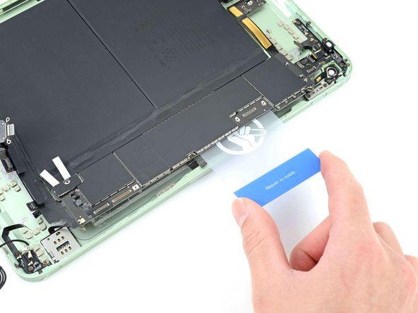

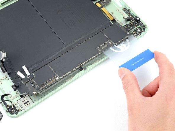

  18. iPad Air 4 Logic Board Replacement, Create a battery blocker: crwdns2935265:018crwdnd2935265:01crwdnd2935265:03crwdne2935265:0 iPad Air 4 Logic Board Replacement, Create a battery blocker: crwdns2935265:018crwdnd2935265:02crwdnd2935265:03crwdne2935265:0 iPad Air 4 Logic Board Replacement, Create a battery blocker: crwdns2935265:018crwdnd2935265:03crwdnd2935265:03crwdne2935265:0
    • Cut two 6 mm wide strips from a playing card or cardstock to use as a battery blocker.
    • The strips should be about 4 cm long so you can easily grip them.
  19. iPad Air 4 Logic Board Replacement, Insert the card strips: crwdns2935265:019crwdnd2935265:01crwdnd2935265:03crwdne2935265:0 iPad Air 4 Logic Board Replacement, Insert the card strips: crwdns2935265:019crwdnd2935265:02crwdnd2935265:03crwdne2935265:0 iPad Air 4 Logic Board Replacement, Insert the card strips: crwdns2935265:019crwdnd2935265:03crwdnd2935265:03crwdne2935265:0
    • Insert the card strips on each side of the battery connector until they stop.

  65. iPad Air 4 Logic Board Replacement, Apply isopropyl alcohol to the right edge of the logic board: crwdns2935265:065crwdnd2935265:01crwdnd2935265:03crwdne2935265:0 iPad Air 4 Logic Board Replacement, Apply isopropyl alcohol to the right edge of the logic board: crwdns2935265:065crwdnd2935265:02crwdnd2935265:03crwdne2935265:0 iPad Air 4 Logic Board Replacement, Apply isopropyl alcohol to the right edge of the logic board: crwdns2935265:065crwdnd2935265:03crwdnd2935265:03crwdne2935265:0
    • Prop the right side of the iPad up so the isopropyl alcohol can flow under the logic board.
    • Apply a few drops of high-strength (>90%) isopropyl alcohol along the right edge of the logic board.
    • Let the alcohol soak for one minute to soften the adhesive under the logic board.
  66. iPad Air 4 Logic Board Replacement, Separate the logic board adhesive: crwdns2935265:066crwdnd2935265:01crwdnd2935265:03crwdne2935265:0 iPad Air 4 Logic Board Replacement, Separate the logic board adhesive: crwdns2935265:066crwdnd2935265:02crwdnd2935265:03crwdne2935265:0 iPad Air 4 Logic Board Replacement, Separate the logic board adhesive: crwdns2935265:066crwdnd2935265:03crwdnd2935265:03crwdne2935265:0
    • Insert an opening pick under the right edge of the logic board.
    • Pry up and slide along the right edge of the logic board to separate the adhesive securing it to the frame.
    • Bending or warping the logic board could lead to permanent damage. If it's difficult to insert or slide the pick, apply more isopropyl alcohol and wait one minute.
  67. iPad Air 4 Logic Board Replacement: crwdns2935265:067crwdnd2935265:01crwdnd2935265:03crwdne2935265:0 iPad Air 4 Logic Board Replacement: crwdns2935265:067crwdnd2935265:02crwdnd2935265:03crwdne2935265:0 iPad Air 4 Logic Board Replacement: crwdns2935265:067crwdnd2935265:03crwdnd2935265:03crwdne2935265:0
    Plastic Cards
    $2.99
    • Insert a plastic card under the right edge of the logic board.
    • Pry up and slide along the right edge of the logic board to separate any remaining adhesive.
    • Bending or warping the logic board could lead to permanent damage. If it's difficult to insert or slide the card, apply more isopropyl alcohol and wait one minute.
