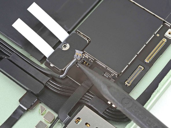

  16. iPad Air 4 Battery Replacement, Disconnect the battery: crwdns2935265:016crwdnd2935265:01crwdnd2935265:02crwdne2935265:0 iPad Air 4 Battery Replacement, Disconnect the battery: crwdns2935265:016crwdnd2935265:02crwdnd2935265:02crwdne2935265:0
    FixMat
    $36.95
    • Use a Phillips screwdriver to remove the 1.8 mm screw securing the battery connector to the logic board.
  17. iPad Air 4 Battery Replacement, Battery connector information: crwdns2935265:017crwdnd2935265:01crwdnd2935265:03crwdne2935265:0 iPad Air 4 Battery Replacement, Battery connector information: crwdns2935265:017crwdnd2935265:02crwdnd2935265:03crwdne2935265:0 iPad Air 4 Battery Replacement, Battery connector information: crwdns2935265:017crwdnd2935265:03crwdnd2935265:03crwdne2935265:0
    • These photos show what the battery connector looks like underneath the logic board. Use these photos as a reference while you safely disconnect the battery.
    • Notice that the battery connector has cantilever springs on the logic board that press against the battery contact pads. Since both the logic board and battery are glued down, you'll need to slide something thin and flexible between the contact points to disconnect the battery.
  18. iPad Air 4 Battery Replacement, Create a battery blocker: crwdns2935265:018crwdnd2935265:01crwdnd2935265:03crwdne2935265:0 iPad Air 4 Battery Replacement, Create a battery blocker: crwdns2935265:018crwdnd2935265:02crwdnd2935265:03crwdne2935265:0 iPad Air 4 Battery Replacement, Create a battery blocker: crwdns2935265:018crwdnd2935265:03crwdnd2935265:03crwdne2935265:0
    • Cut two 6 mm wide strips from a playing card or cardstock to use as a battery blocker.
    • The strips should be about 4 cm long so you can easily grip them.
  19. iPad Air 4 Battery Replacement, Insert the card strips: crwdns2935265:019crwdnd2935265:01crwdnd2935265:03crwdne2935265:0 iPad Air 4 Battery Replacement, Insert the card strips: crwdns2935265:019crwdnd2935265:02crwdnd2935265:03crwdne2935265:0 iPad Air 4 Battery Replacement, Insert the card strips: crwdns2935265:019crwdnd2935265:03crwdnd2935265:03crwdne2935265:0
    • Insert the card strips on each side of the battery connector until they stop.

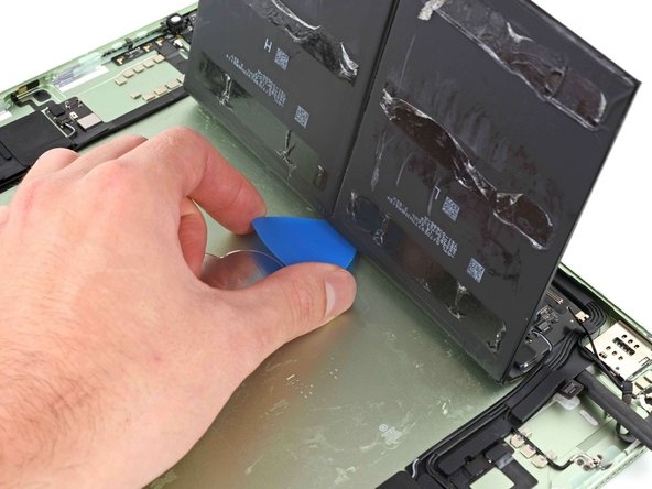

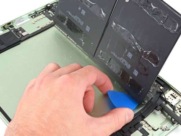

  31. iPad Air 4 Battery Replacement, Battery adhesive information: crwdns2935265:031crwdnd2935265:01crwdnd2935265:02crwdne2935265:0 iPad Air 4 Battery Replacement, Battery adhesive information: crwdns2935265:031crwdnd2935265:02crwdnd2935265:02crwdne2935265:0
    • The battery is secured to the frame with eight adhesive strips:
    • Three under each battery cell
    • Two under the battery boards

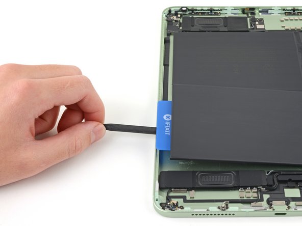

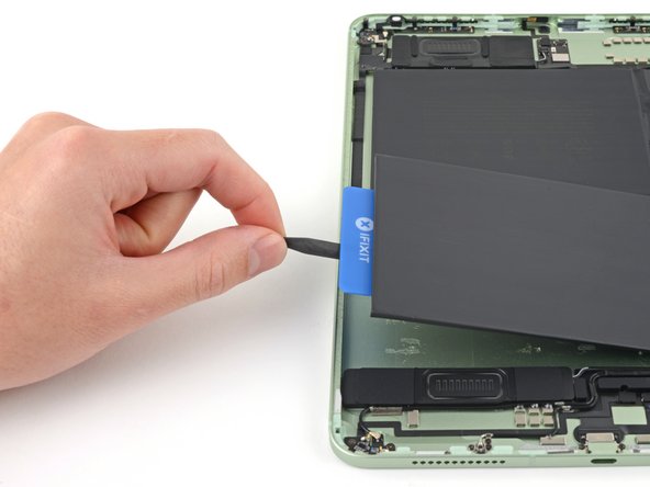

  32. iPad Air 4 Battery Replacement, Apply isopropyl alcohol to the left edge of the battery: crwdns2935265:032crwdnd2935265:01crwdnd2935265:03crwdne2935265:0 iPad Air 4 Battery Replacement, Apply isopropyl alcohol to the left edge of the battery: crwdns2935265:032crwdnd2935265:02crwdnd2935265:03crwdne2935265:0 iPad Air 4 Battery Replacement, Apply isopropyl alcohol to the left edge of the battery: crwdns2935265:032crwdnd2935265:03crwdnd2935265:03crwdne2935265:0
    • Prop the left side of the iPad up so the isopropyl alcohol can flow under the battery.
    • Apply a few drops of high-strength (>90%) isopropyl alcohol along the left edge of the battery.
    • Be careful if you're using a syringe with a needle or other sharp instrument to dispense isopropyl alcohol—a punctured battery may leak dangerous chemicals or cause a fire.
    • Let the alcohol soak for one minute to soften the adhesive under the battery.
  33. iPad Air 4 Battery Replacement, Separate the lower battery cell adhesive: crwdns2935265:033crwdnd2935265:01crwdnd2935265:03crwdne2935265:0 iPad Air 4 Battery Replacement, Separate the lower battery cell adhesive: crwdns2935265:033crwdnd2935265:02crwdnd2935265:03crwdne2935265:0 iPad Air 4 Battery Replacement, Separate the lower battery cell adhesive: crwdns2935265:033crwdnd2935265:03crwdnd2935265:03crwdne2935265:0
    Plastic Cards
    $2.99
    • Lay the iPad down flat on your work surface.
    • Insert a plastic card under the left side of the lower battery cell to separate the adhesive securing it to the frame.
    • Don't force the card or bend the battery—a punctured or bent battery may leak dangerous chemicals or cause a fire.
    • If it's difficult to insert or slide the card, apply more isopropyl alcohol, wait one minute, and try again.
    • Leave the plastic card in place to prevent the adhesive from re-sealing.
  34. iPad Air 4 Battery Replacement: crwdns2935265:034crwdnd2935265:01crwdnd2935265:03crwdne2935265:0 iPad Air 4 Battery Replacement: crwdns2935265:034crwdnd2935265:02crwdnd2935265:03crwdne2935265:0 iPad Air 4 Battery Replacement: crwdns2935265:034crwdnd2935265:03crwdnd2935265:03crwdne2935265:0
    • Insert the flat end of a spudger underneath the plastic card for additional leverage.
    • Pry against the card to separate the remaining adhesive.
  35. iPad Air 4 Battery Replacement, Separate the upper battery cell adhesive: crwdns2935265:035crwdnd2935265:01crwdnd2935265:02crwdne2935265:0 iPad Air 4 Battery Replacement, Separate the upper battery cell adhesive: crwdns2935265:035crwdnd2935265:02crwdnd2935265:02crwdne2935265:0
    • Repeat the previous two steps for the upper battery cell.

  38. iPad Air 4 Battery Replacement, Apply isopropyl to the battery boards: crwdns2935265:038crwdnd2935265:01crwdnd2935265:03crwdne2935265:0 iPad Air 4 Battery Replacement, Apply isopropyl to the battery boards: crwdns2935265:038crwdnd2935265:02crwdnd2935265:03crwdne2935265:0 iPad Air 4 Battery Replacement, Apply isopropyl to the battery boards: crwdns2935265:038crwdnd2935265:03crwdnd2935265:03crwdne2935265:0
    • Lift the left edge of the battery cells.
    • Apply a few drops of high-strength (>90%) isopropyl alcohol to the battery boards which sit along the right edge of the battery cells.
  39. iPad Air 4 Battery Replacement, Separate the battery board adhesive: crwdns2935265:039crwdnd2935265:01crwdnd2935265:03crwdne2935265:0 iPad Air 4 Battery Replacement, Separate the battery board adhesive: crwdns2935265:039crwdnd2935265:02crwdnd2935265:03crwdne2935265:0 iPad Air 4 Battery Replacement, Separate the battery board adhesive: crwdns2935265:039crwdnd2935265:03crwdnd2935265:03crwdne2935265:0
    • Slide an opening pick under the battery board to separate the adhesive securing it to the frame.
  40. iPad Air 4 Battery Replacement, Lift the battery connector out: crwdns2935265:040crwdnd2935265:01crwdnd2935265:03crwdne2935265:0 iPad Air 4 Battery Replacement, Lift the battery connector out: crwdns2935265:040crwdnd2935265:02crwdnd2935265:03crwdne2935265:0 iPad Air 4 Battery Replacement, Lift the battery connector out: crwdns2935265:040crwdnd2935265:03crwdnd2935265:03crwdne2935265:0
    • Remove the battery blocker card strips.
    • Lift the battery up and away from the frame so its connector clears the standoff post.
    • Don't let the battery connector touch the contacts on the logic board.
