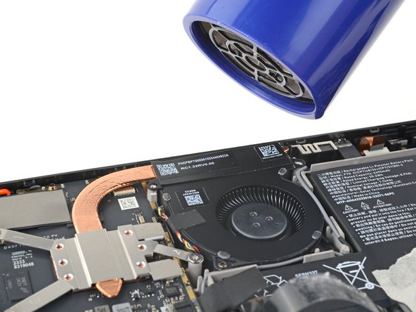

    1. Steam Deck OLED Front Shell Replacement, Heat the top edge screen adhesive: crwdns2935265:03crwdnd2935265:01crwdnd2935265:01crwdne2935265:0
      • Prepare an iOpener and apply it to the top edge of the screen for one minute.
      • You may also use a hair dryer or heat gun, but be careful not to overheat the device, as the screen, battery, and plastic frame are all susceptible to heat damage.

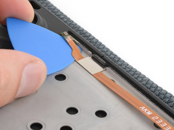

    3. Steam Deck OLED Front Shell Replacement, Insert an opening pick: crwdns2935265:05crwdnd2935265:01crwdnd2935265:03crwdne2935265:0 Steam Deck OLED Front Shell Replacement, Insert an opening pick: crwdns2935265:05crwdnd2935265:02crwdnd2935265:03crwdne2935265:0 Steam Deck OLED Front Shell Replacement, Insert an opening pick: crwdns2935265:05crwdnd2935265:03crwdnd2935265:03crwdne2935265:0
      • Pull up on the suction handle with a strong, steady force to create a gap between the screen and the frame.
      • Insert the tip of an opening pick into the gap.
      • Don't insert your pick deeper than 3 mm (~1/8 of an inch) to avoid damaging the screen panel, ambient light sensor, or sensor cable.

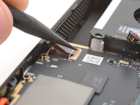

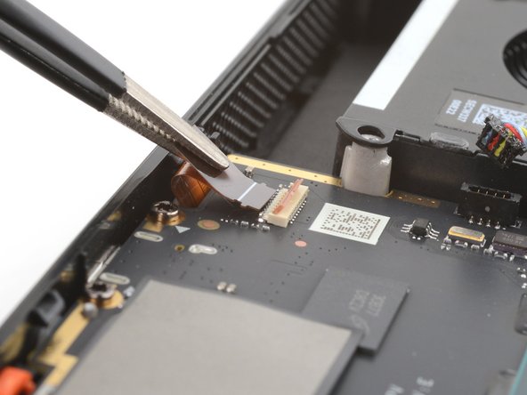

    15. Steam Deck OLED Front Shell Replacement, Unlatch the screen connector: crwdns2935265:017crwdnd2935265:01crwdnd2935265:02crwdne2935265:0 Steam Deck OLED Front Shell Replacement, Unlatch the screen connector: crwdns2935265:017crwdnd2935265:02crwdnd2935265:02crwdne2935265:0
      • Use the point of a spudger or a clean fingernail to flip up the locking flap on the outside edge of the screen ZIF connector.
      • Don't touch any of the small surface-mounted components around the connector.
    16. Steam Deck OLED Front Shell Replacement, Disconnect the screen: crwdns2935265:018crwdnd2935265:01crwdnd2935265:02crwdne2935265:0 Steam Deck OLED Front Shell Replacement, Disconnect the screen: crwdns2935265:018crwdnd2935265:02crwdnd2935265:02crwdne2935265:0
      • Use tweezers or your fingers to grip the screen cable pull tab and slide the cable straight out of its socket to disconnect it.

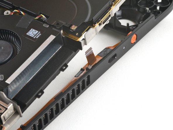

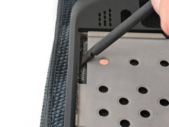

    1. Steam Deck OLED Front Shell Replacement, Remove the back cover screws: crwdns2935265:020crwdnd2935265:01crwdnd2935265:02crwdne2935265:0 Steam Deck OLED Front Shell Replacement, Remove the back cover screws: crwdns2935265:020crwdnd2935265:02crwdnd2935265:02crwdne2935265:0
      FixMat
      $36.95

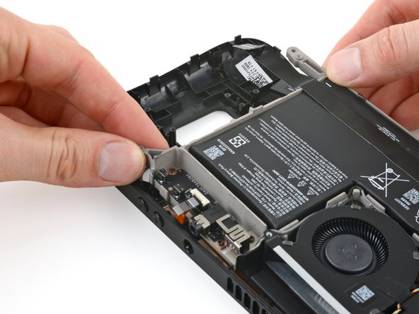

      • Use a T6 Torx driver to remove the eight 5.8 mm‑long screws securing the back cover.

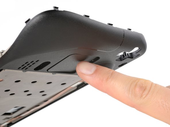

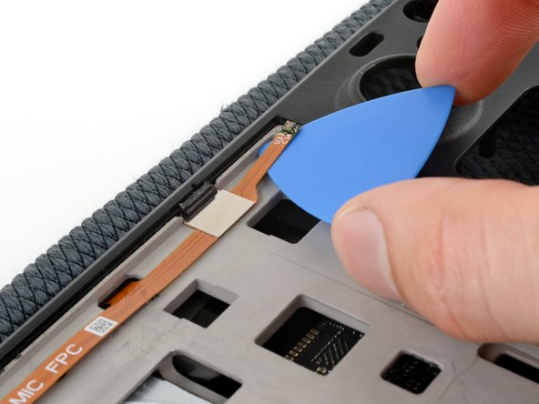

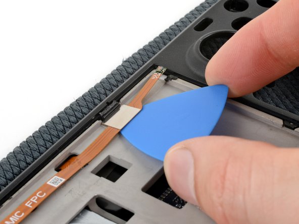

    2. Steam Deck OLED Front Shell Replacement, Unclip a handle: crwdns2935265:021crwdnd2935265:01crwdnd2935265:03crwdne2935265:0 Steam Deck OLED Front Shell Replacement, Unclip a handle: crwdns2935265:021crwdnd2935265:02crwdnd2935265:03crwdne2935265:0 Steam Deck OLED Front Shell Replacement, Unclip a handle: crwdns2935265:021crwdnd2935265:03crwdnd2935265:03crwdne2935265:0
      • Insert an opening pick at an upward angle between the back cover and the front shell near one of the triggers.
      • If you can't insert your pick here, try along the top or bottom edges of the Steam Deck OLED before sliding it toward the handle.
      • Slide your pick along the edge of the handle to release the clips securing it to the front shell.
    3. Steam Deck OLED Front Shell Replacement, Unclip the top and bottom edges: crwdns2935265:022crwdnd2935265:01crwdnd2935265:03crwdne2935265:0 Steam Deck OLED Front Shell Replacement, Unclip the top and bottom edges: crwdns2935265:022crwdnd2935265:02crwdnd2935265:03crwdne2935265:0 Steam Deck OLED Front Shell Replacement, Unclip the top and bottom edges: crwdns2935265:022crwdnd2935265:03crwdnd2935265:03crwdne2935265:0
      • Reinsert your pick and slide it along the top and bottom edges until the back cover feels loose.

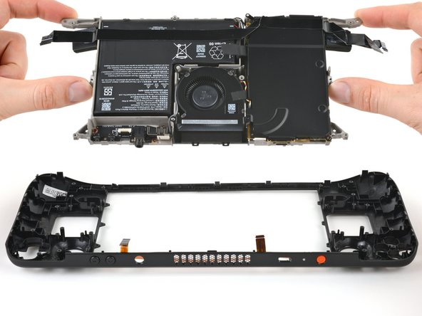

    4. Steam Deck OLED Front Shell Replacement, Remove the back cover: crwdns2935265:023crwdnd2935265:01crwdnd2935265:03crwdne2935265:0 Steam Deck OLED Front Shell Replacement, Remove the back cover: crwdns2935265:023crwdnd2935265:02crwdnd2935265:03crwdne2935265:0 Steam Deck OLED Front Shell Replacement, Remove the back cover: crwdns2935265:023crwdnd2935265:03crwdnd2935265:03crwdne2935265:0
      • Grip the unclipped handle and pull it away from the front shell to release the remaining clips.
      • Remove the back cover.

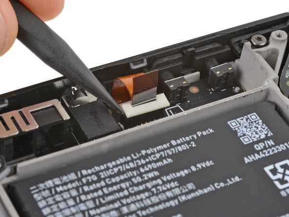

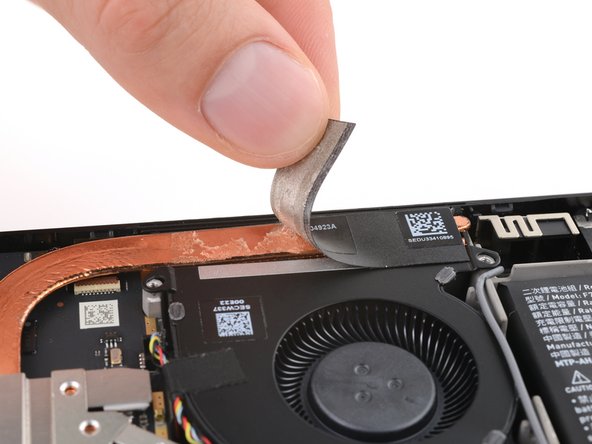

    1. Steam Deck OLED Front Shell Replacement, Disconnect the battery: crwdns2935265:024crwdnd2935265:01crwdnd2935265:03crwdne2935265:0 Steam Deck OLED Front Shell Replacement, Disconnect the battery: crwdns2935265:024crwdnd2935265:02crwdnd2935265:03crwdne2935265:0 Steam Deck OLED Front Shell Replacement, Disconnect the battery: crwdns2935265:024crwdnd2935265:03crwdnd2935265:03crwdne2935265:0
      • Grip the battery cable pull tab, located to the left of the battery.
      • Firmly pull the battery cable straight away from the motherboard shield (toward the battery) to disconnect it.
      • This bundled cable is fairly stiff. If you're having trouble, re-grip the pull tab close to the head of the connector and gently walk it side-to-side as you pull.
      • If the cable pull-tab feels fragile or rips during this process, remove the motherboard shield and disconnect the cable using a spudger.
      • When the battery cable comes free, it might push up on the motherboard shield. Don't worry, as this won't damage anything.

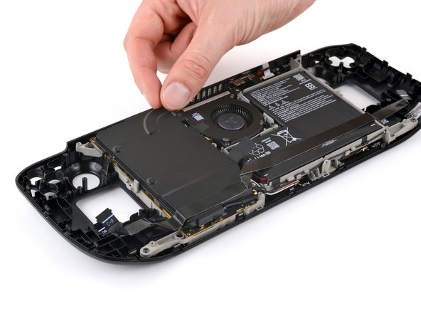

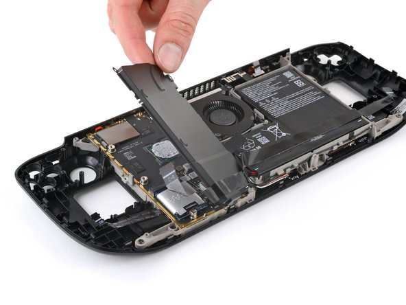

      • Use your T6 Torx driver to remove the two 3.8 mm‑long screws securing the motherboard shield.
      • Lift the top edge of the motherboard shield up and flip it over the bottom edge of the frame, away from the motherboard.
      • Be careful not to crease or strain the cable.

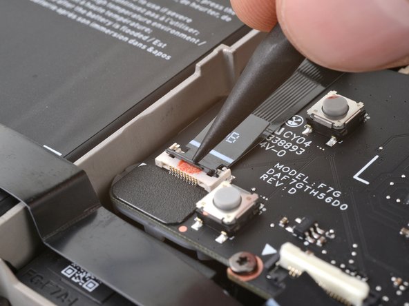

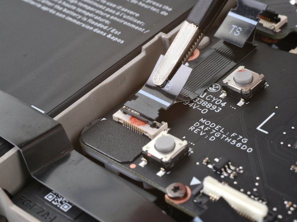

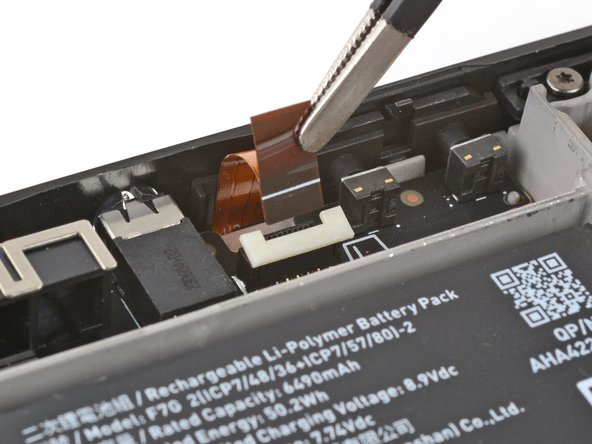

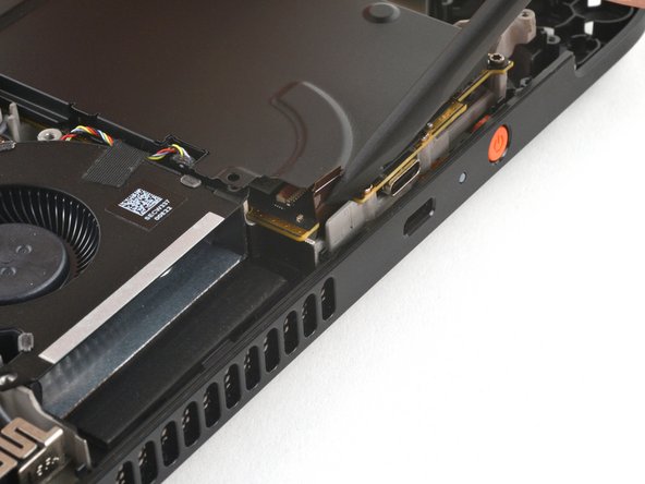

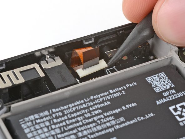

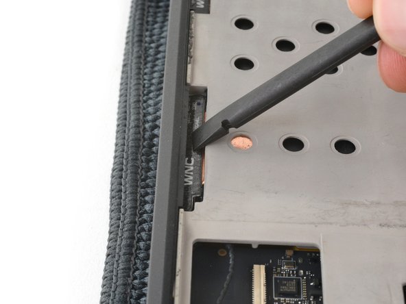

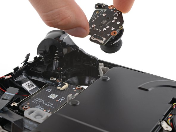

    1. Steam Deck OLED Front Shell Replacement, Disconnect the left thumbstick: crwdns2935265:028crwdnd2935265:01crwdnd2935265:03crwdne2935265:0 Steam Deck OLED Front Shell Replacement, Disconnect the left thumbstick: crwdns2935265:028crwdnd2935265:02crwdnd2935265:03crwdne2935265:0 Steam Deck OLED Front Shell Replacement, Disconnect the left thumbstick: crwdns2935265:028crwdnd2935265:03crwdnd2935265:03crwdne2935265:0
      • Use the point of a spudger to flip up the small locking flap on the left thumbstick ZIF connector.
      • The pull tab on this connector may be labeled TS.
      • Use tweezers or your fingers to grip the cable's pull tab and slide the connector straight out of its socket to disconnect it.

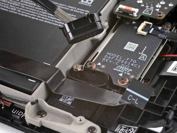

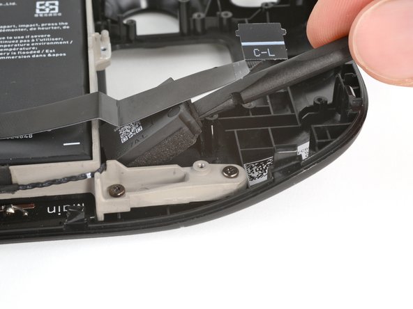

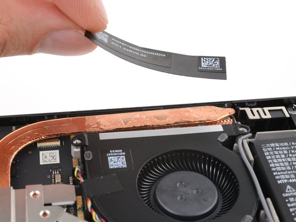

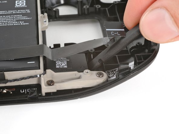

    1. Steam Deck OLED Front Shell Replacement, Disconnect the interconnect cable: crwdns2935265:029crwdnd2935265:01crwdnd2935265:03crwdne2935265:0 Steam Deck OLED Front Shell Replacement, Disconnect the interconnect cable: crwdns2935265:029crwdnd2935265:02crwdnd2935265:03crwdne2935265:0 Steam Deck OLED Front Shell Replacement, Disconnect the interconnect cable: crwdns2935265:029crwdnd2935265:03crwdnd2935265:03crwdne2935265:0
      • Use a spudger to flip up the small white locking flap on the left button board interconnect cable ZIF connector.
      • The pull tab on this connector may be labeled C‑L.
      • Use tweezers or your fingers to grip the cable's pull tab and slide it straight out of its socket to disconnect it.

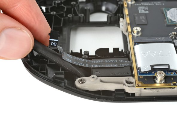

    2. Steam Deck OLED Front Shell Replacement, Disconnect the left thumbstick: crwdns2935265:030crwdnd2935265:01crwdnd2935265:03crwdne2935265:0 Steam Deck OLED Front Shell Replacement, Disconnect the left thumbstick: crwdns2935265:030crwdnd2935265:02crwdnd2935265:03crwdne2935265:0 Steam Deck OLED Front Shell Replacement, Disconnect the left thumbstick: crwdns2935265:030crwdnd2935265:03crwdnd2935265:03crwdne2935265:0
      • Flip up the small black locking flap on the left thumbstick cable ZIF connector.
      • The pull tab on this connector may be labeled DB.
      • Slide the connector straight out of its socket to disconnect it.

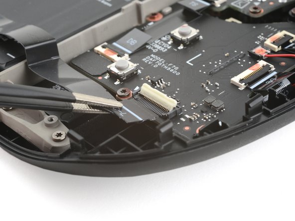

    4. Steam Deck OLED Front Shell Replacement, Disconnect the touchpad board: crwdns2935265:032crwdnd2935265:01crwdnd2935265:03crwdne2935265:0 Steam Deck OLED Front Shell Replacement, Disconnect the touchpad board: crwdns2935265:032crwdnd2935265:02crwdnd2935265:03crwdne2935265:0 Steam Deck OLED Front Shell Replacement, Disconnect the touchpad board: crwdns2935265:032crwdnd2935265:03crwdnd2935265:03crwdne2935265:0
      • Flip up the small locking flap on the touchpad board cable ZIF connector, located just below the previous one.
      • The pull tabs on the remaining ZIF connectors in this procedure may be labeled DB.
      • Lift the connector until its arms are free and slide it straight out to disconnect it.

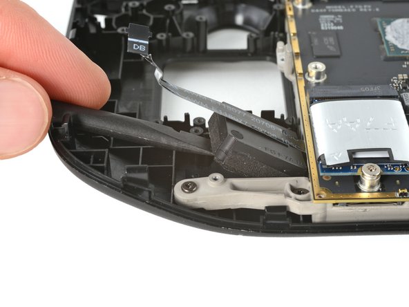

    5. Steam Deck OLED Front Shell Replacement, Disconnect the left haptics: crwdns2935265:033crwdnd2935265:01crwdnd2935265:03crwdne2935265:0 Steam Deck OLED Front Shell Replacement, Disconnect the left haptics: crwdns2935265:033crwdnd2935265:02crwdnd2935265:03crwdne2935265:0 Steam Deck OLED Front Shell Replacement, Disconnect the left haptics: crwdns2935265:033crwdnd2935265:03crwdnd2935265:03crwdne2935265:0
      • If you aren't replacing your button board, you can leave this cable connected and lay the board over the right side of the frame after you've removed the screws.
      • Be careful when disconnecting the haptics, as the cables and connector are very delicate. Pry only on the base of the white connector and not on the cables or socket.
      • Insert the point of your spudger under the neck of the haptics cable connector.
      • Gently pry up to disconnect it.

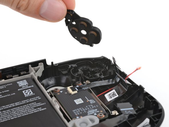

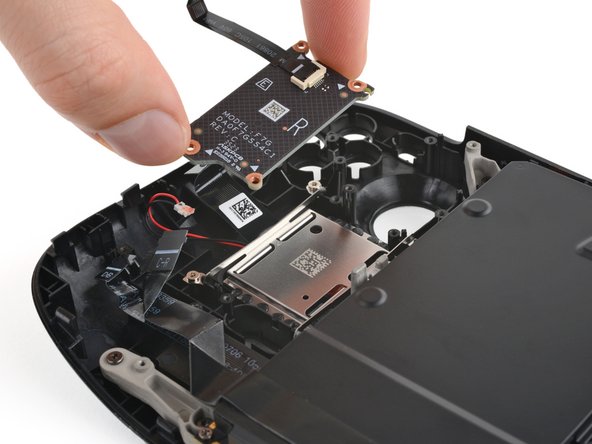

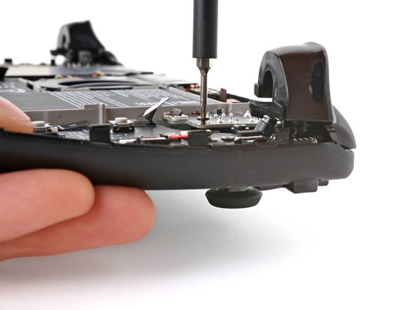

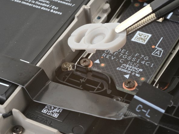

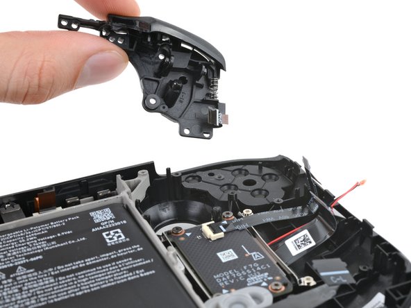

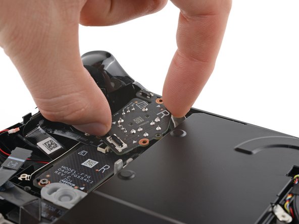

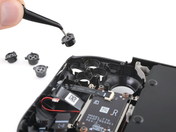

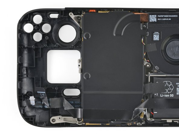

    7. Steam Deck OLED Front Shell Replacement, Remove the left button board screws: crwdns2935265:035crwdnd2935265:01crwdnd2935265:01crwdne2935265:0
      • Use your T6 Torx driver to remove the four screws securing the left button board:
      • Two 5.9 mm‑long screws
      • One 3.8 mm‑long screw
      • One 4.9 mm‑long screw

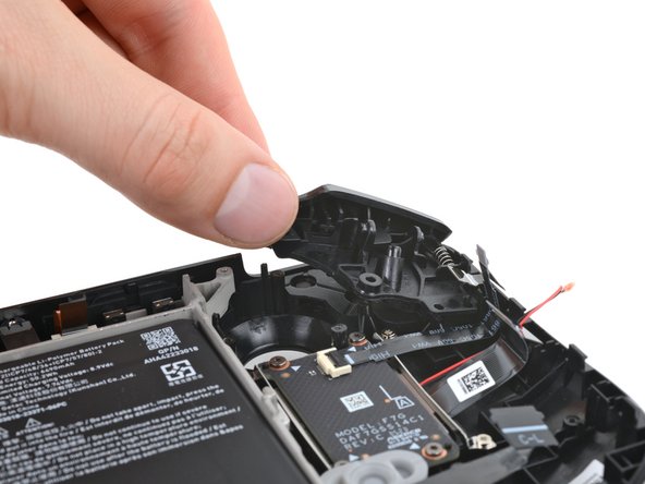

    8. Steam Deck OLED Front Shell Replacement, Remove the left button board: crwdns2935265:036crwdnd2935265:01crwdnd2935265:03crwdne2935265:0 Steam Deck OLED Front Shell Replacement, Remove the left button board: crwdns2935265:036crwdnd2935265:02crwdnd2935265:03crwdne2935265:0 Steam Deck OLED Front Shell Replacement, Remove the left button board: crwdns2935265:036crwdnd2935265:03crwdnd2935265:03crwdne2935265:0
      • Insert the point of your spudger between the bottom right corner of the button board and the frame.
      • Pry up until you can grab the button board with your fingers.
      • Remove the button board.
      • During reassembly, make sure none of the five cables become trapped underneath the button board as you lay it into place.

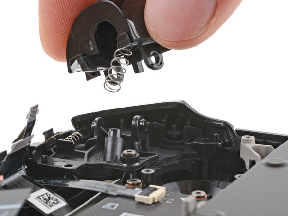

    1. Steam Deck OLED Front Shell Replacement, Remove the left trigger: crwdns2935265:039crwdnd2935265:01crwdnd2935265:03crwdne2935265:0 Steam Deck OLED Front Shell Replacement, Remove the left trigger: crwdns2935265:039crwdnd2935265:02crwdnd2935265:03crwdne2935265:0 Steam Deck OLED Front Shell Replacement, Remove the left trigger: crwdns2935265:039crwdnd2935265:03crwdnd2935265:03crwdne2935265:0
      • The left trigger is on your right-hand side when working on the Steam Deck OLED, as it's laying upside down.
      • The trigger clips into place on two pegs on the frame, which double as the hinge.
      • Place the flat end of a spudger onto the inside edge of the trigger's left clip.
      • Use your fingers to push the trigger toward the left as you wedge the spudger between the clip and the peg.
      • Use your spudger to pivot the trigger clip out, away, and up from the peg to unlatch it.
      • During reassembly, latch the right peg first. Once in place, push down on the trigger to latch the left peg, producing an audible "click" sound.
      • Check to make sure that the trigger spring is properly aligned. Test the trigger action before continuing reassembly.

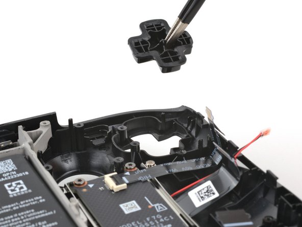

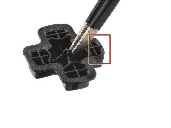

    1. Steam Deck OLED Front Shell Replacement, Remove the D-pad: crwdns2935265:043crwdnd2935265:01crwdnd2935265:03crwdne2935265:0 Steam Deck OLED Front Shell Replacement, Remove the D-pad: crwdns2935265:043crwdnd2935265:02crwdnd2935265:03crwdne2935265:0 Steam Deck OLED Front Shell Replacement, Remove the D-pad: crwdns2935265:043crwdnd2935265:03crwdnd2935265:03crwdne2935265:0
      • Use tweezers to remove the D-pad.
      • The left edge of the D-Pad is shorter than the other edges. During reassembly, orient the D-pad so that the left edge faces to the left, closest to the outside edge of the frame.
    1. Steam Deck OLED Front Shell Replacement, Remove the Steam button membrane: crwdns2935265:044crwdnd2935265:01crwdnd2935265:02crwdne2935265:0 Steam Deck OLED Front Shell Replacement, Remove the Steam button membrane: crwdns2935265:044crwdnd2935265:02crwdnd2935265:02crwdne2935265:0
      • Use tweezers to remove the Steam button membrane.
    2. Steam Deck OLED Front Shell Replacement, Remove the Steam button: crwdns2935265:045crwdnd2935265:01crwdnd2935265:02crwdne2935265:0 Steam Deck OLED Front Shell Replacement, Remove the Steam button: crwdns2935265:045crwdnd2935265:02crwdnd2935265:02crwdne2935265:0
      • Remove the Steam button.
      • This button is keyed so it only fits in its recess in the correct orientation.
    1. Steam Deck OLED Front Shell Replacement, Disconnect the right thumbstick: crwdns2935265:046crwdnd2935265:01crwdnd2935265:03crwdne2935265:0 Steam Deck OLED Front Shell Replacement, Disconnect the right thumbstick: crwdns2935265:046crwdnd2935265:02crwdnd2935265:03crwdne2935265:0 Steam Deck OLED Front Shell Replacement, Disconnect the right thumbstick: crwdns2935265:046crwdnd2935265:03crwdnd2935265:03crwdne2935265:0
      • Use the point of a spudger to flip up the small locking flap on the right thumbstick ZIF connector.
    1. Steam Deck OLED Front Shell Replacement, Disconnect the interconnect cable: crwdns2935265:047crwdnd2935265:01crwdnd2935265:03crwdne2935265:0 Steam Deck OLED Front Shell Replacement, Disconnect the interconnect cable: crwdns2935265:047crwdnd2935265:02crwdnd2935265:03crwdne2935265:0 Steam Deck OLED Front Shell Replacement, Disconnect the interconnect cable: crwdns2935265:047crwdnd2935265:03crwdnd2935265:03crwdne2935265:0
      • Use a spudger to flip up the small white locking flap on the right button board interconnect cable ZIF connector.
      • The pull tab on this connector may be labeled C‑R.
      • During reassembly, don't reconnect this cable yet. You'll reconnect it later.
    2. Steam Deck OLED Front Shell Replacement, Disconnect the right thumbstick: crwdns2935265:048crwdnd2935265:01crwdnd2935265:03crwdne2935265:0 Steam Deck OLED Front Shell Replacement, Disconnect the right thumbstick: crwdns2935265:048crwdnd2935265:02crwdnd2935265:03crwdne2935265:0 Steam Deck OLED Front Shell Replacement, Disconnect the right thumbstick: crwdns2935265:048crwdnd2935265:03crwdnd2935265:03crwdne2935265:0
      • Flip up the small black locking flap on the right thumbstick cable ZIF connector.

    6. Steam Deck OLED Front Shell Replacement, Remove the right button board screws: crwdns2935265:052crwdnd2935265:01crwdnd2935265:01crwdne2935265:0
      • Use your T6 Torx driver to remove the four screws securing the right button board:
    7. Steam Deck OLED Front Shell Replacement, Remove the right button board: crwdns2935265:053crwdnd2935265:01crwdnd2935265:03crwdne2935265:0 Steam Deck OLED Front Shell Replacement, Remove the right button board: crwdns2935265:053crwdnd2935265:02crwdnd2935265:03crwdne2935265:0 Steam Deck OLED Front Shell Replacement, Remove the right button board: crwdns2935265:053crwdnd2935265:03crwdnd2935265:03crwdne2935265:0
      • Insert the point of your spudger between the bottom left corner of the button board and the frame.
      • During reassembly, make sure none of the six cables become trapped underneath the button board as you lay it into place.
    1. Steam Deck OLED Front Shell Replacement, Remove the right thumbstick screws: crwdns2935265:054crwdnd2935265:01crwdnd2935265:02crwdne2935265:0 Steam Deck OLED Front Shell Replacement, Remove the right thumbstick screws: crwdns2935265:054crwdnd2935265:02crwdnd2935265:02crwdne2935265:0
      • Use your T6 Torx driver to remove the three 5.9 mm‑long screws securing the right thumbstick.
      • During reassembly, hold the Steam Deck OLED off your work surface so it doesn't rest on your thumbstick as you tighten the screws.
    2. Steam Deck OLED Front Shell Replacement, Remove the right thumbstick: crwdns2935265:055crwdnd2935265:01crwdnd2935265:03crwdne2935265:0 Steam Deck OLED Front Shell Replacement, Remove the right thumbstick: crwdns2935265:055crwdnd2935265:02crwdnd2935265:03crwdne2935265:0 Steam Deck OLED Front Shell Replacement, Remove the right thumbstick: crwdns2935265:055crwdnd2935265:03crwdnd2935265:03crwdne2935265:0
      • Grip the edges of the thumbstick board and rotate it clockwise to clear the trigger.
      • Remove the thumbstick.

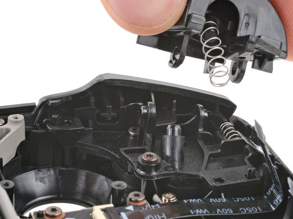

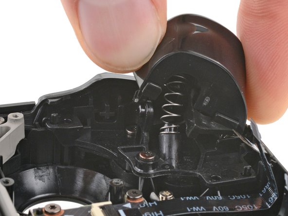

    1. Steam Deck OLED Front Shell Replacement, Unclip the right trigger: crwdns2935265:056crwdnd2935265:01crwdnd2935265:03crwdne2935265:0 Steam Deck OLED Front Shell Replacement, Unclip the right trigger: crwdns2935265:056crwdnd2935265:02crwdnd2935265:03crwdne2935265:0 Steam Deck OLED Front Shell Replacement, Unclip the right trigger: crwdns2935265:056crwdnd2935265:03crwdnd2935265:03crwdne2935265:0
      • The right trigger is on your left-hand side when working on the Steam Deck OLED, as it's laying upside down.
      • Place the flat end of a spudger onto the inside edge of the trigger's right clip.
      • Use your fingers to push the trigger toward the right as you wedge the spudger between the clip and the peg.
      • During reassembly, latch the left peg first. Once in place, push down on the trigger to latch the right peg, producing an audible "click" sound.

    3. Steam Deck OLED Front Shell Replacement, Remove the right bumper assembly: crwdns2935265:058crwdnd2935265:01crwdnd2935265:03crwdne2935265:0 Steam Deck OLED Front Shell Replacement, Remove the right bumper assembly: crwdns2935265:058crwdnd2935265:02crwdnd2935265:03crwdne2935265:0 Steam Deck OLED Front Shell Replacement, Remove the right bumper assembly: crwdns2935265:058crwdnd2935265:03crwdnd2935265:03crwdne2935265:0
      • Grip the right arm of the bumper assembly and lift it off the alignment pegs.
      • Slide the assembly to the right to clear the tab on the left edge of the frame.
      • Remove the assembly.
      • The action and menu buttons membrane might stay stuck to the underside of the bumper bracket. If so, remove it.
      • During reassembly, line up the bumper bracket with the alignment posts in the frame as you set it into place.

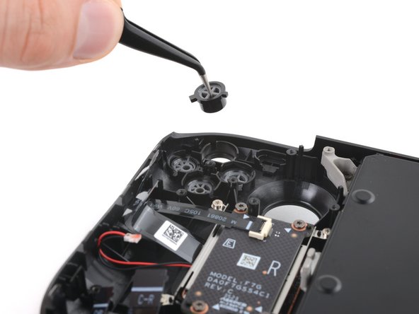

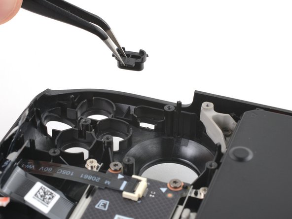

    1. Steam Deck OLED Front Shell Replacement, Remove the action buttons: crwdns2935265:060crwdnd2935265:01crwdnd2935265:03crwdne2935265:0 Steam Deck OLED Front Shell Replacement, Remove the action buttons: crwdns2935265:060crwdnd2935265:02crwdnd2935265:03crwdne2935265:0 Steam Deck OLED Front Shell Replacement, Remove the action buttons: crwdns2935265:060crwdnd2935265:03crwdnd2935265:03crwdne2935265:0
      • Use tweezers to remove the four action buttons, A, B, X, and Y.
      • During reassembly, don't worry! The buttons are keyed—they can only be reinstalled in one orientation.

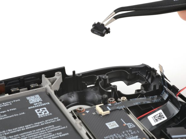

    2. Steam Deck OLED Front Shell Replacement, Remove the quick access button: crwdns2935265:062crwdnd2935265:01crwdnd2935265:03crwdne2935265:0 Steam Deck OLED Front Shell Replacement, Remove the quick access button: crwdns2935265:062crwdnd2935265:02crwdnd2935265:03crwdne2935265:0 Steam Deck OLED Front Shell Replacement, Remove the quick access button: crwdns2935265:062crwdnd2935265:03crwdnd2935265:03crwdne2935265:0
      • Use tweezers to remove the quick access button.

    11. Steam Deck OLED Front Shell Replacement, Remove the motherboard shield screws: crwdns2935265:073crwdnd2935265:01crwdnd2935265:02crwdne2935265:0 Steam Deck OLED Front Shell Replacement, Remove the motherboard shield screws: crwdns2935265:073crwdnd2935265:02crwdnd2935265:02crwdne2935265:0
      • Use your T6 Torx driver to remove the two 3.8 mm‑long screws securing the top left and bottom left corners of the motherboard shield.
    12. Steam Deck OLED Front Shell Replacement, Move the motherboard shield: crwdns2935265:074crwdnd2935265:01crwdnd2935265:03crwdne2935265:0 Steam Deck OLED Front Shell Replacement, Move the motherboard shield: crwdns2935265:074crwdnd2935265:02crwdnd2935265:03crwdne2935265:0 Steam Deck OLED Front Shell Replacement, Move the motherboard shield: crwdns2935265:074crwdnd2935265:03crwdnd2935265:03crwdne2935265:0
      • Lift the top edge of the motherboard shield up and flip it over to the right of the motherboard, over the battery.
    13. Steam Deck OLED Front Shell Replacement, Soften the sticker adhesive: crwdns2935265:075crwdnd2935265:01crwdnd2935265:02crwdne2935265:0 Steam Deck OLED Front Shell Replacement, Soften the sticker adhesive: crwdns2935265:075crwdnd2935265:02crwdnd2935265:02crwdne2935265:0
    14. Steam Deck OLED Front Shell Replacement, Remove the heat sink sticker: crwdns2935265:076crwdnd2935265:01crwdnd2935265:03crwdne2935265:0 Steam Deck OLED Front Shell Replacement, Remove the heat sink sticker: crwdns2935265:076crwdnd2935265:02crwdnd2935265:03crwdne2935265:0 Steam Deck OLED Front Shell Replacement, Remove the heat sink sticker: crwdns2935265:076crwdnd2935265:03crwdnd2935265:03crwdne2935265:0
      • Try not to tear the heat sink sticker, as you'll reuse it during reassembly.
      • Slide the tip of an opening pick under one edge of the heat sink sticker.
      • Peel the sticker up until you can grab it with your fingers.
      • Gently remove the sticker from the heat sink and fan.
      • During reassembly, place the sticker back in its original location. The residual adhesive should stick well.
      • If the residual adhesive isn't sticky anymore, tape the outside edges of the sticker to the heat sink and fan with small strips of tape.

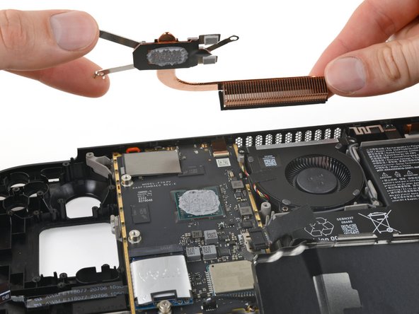

    16. Steam Deck OLED Front Shell Replacement, Remove the heat sink: crwdns2935265:078crwdnd2935265:01crwdnd2935265:02crwdne2935265:0 Steam Deck OLED Front Shell Replacement, Remove the heat sink: crwdns2935265:078crwdnd2935265:02crwdnd2935265:02crwdne2935265:0
      • Lift the heat sink from the motherboard and remove it.
      • Depending on the age of your device, this might require some force. A twisting motion may help loosen the thermal paste.
      • Before reinstalling the heat sink, follow this guide to clean the heat sink and APU and reapply thermal paste.
    17. Steam Deck OLED Front Shell Replacement, Disconnect the audio board: crwdns2935265:079crwdnd2935265:01crwdnd2935265:03crwdne2935265:0 Steam Deck OLED Front Shell Replacement, Disconnect the audio board: crwdns2935265:079crwdnd2935265:02crwdnd2935265:03crwdne2935265:0 Steam Deck OLED Front Shell Replacement, Disconnect the audio board: crwdns2935265:079crwdnd2935265:03crwdnd2935265:03crwdne2935265:0
      • Use the point of your spudger to flip up the small locking flap on the audio board ZIF connector in the upper right corner of the motherboard.
      • Use tweezers or your fingers to grip the cable's pull tab and pull it straight out of its socket to disconnect it.
    18. Steam Deck OLED Front Shell Replacement, Unlock the audio board connector: crwdns2935265:080crwdnd2935265:01crwdnd2935265:03crwdne2935265:0 Steam Deck OLED Front Shell Replacement, Unlock the audio board connector: crwdns2935265:080crwdnd2935265:02crwdnd2935265:03crwdne2935265:0 Steam Deck OLED Front Shell Replacement, Unlock the audio board connector: crwdns2935265:080crwdnd2935265:03crwdnd2935265:03crwdne2935265:0
      • Use your fingers or a spudger to gently lift the white locking tab on the audio board socket to release the cable.
      • Avoid bending the socket against the board—if you can't get your tool underneath, push up on alternating sides of the tab to lift it.
      • During reassembly, gently press down on the locking tab to secure the cable.
    19. Steam Deck OLED Front Shell Replacement, Disconnect the audio board: crwdns2935265:081crwdnd2935265:01crwdnd2935265:02crwdne2935265:0 Steam Deck OLED Front Shell Replacement, Disconnect the audio board: crwdns2935265:081crwdnd2935265:02crwdnd2935265:02crwdne2935265:0
      • Use tweezers or your fingers to pull the audio board cable out of its socket to disconnect it.
      • With the locking tab released, the cable will slide out with little to no resistance. If it doesn't, check that the white locking tab is fully released.
      • During reassembly, ensure that the locking tab is in its unlocked, lifted position before inserting the cable.

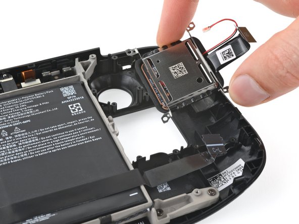

    20. Steam Deck OLED Front Shell Replacement, Pry up the right speaker: crwdns2935265:082crwdnd2935265:01crwdnd2935265:03crwdne2935265:0 Steam Deck OLED Front Shell Replacement, Pry up the right speaker: crwdns2935265:082crwdnd2935265:02crwdnd2935265:03crwdne2935265:0 Steam Deck OLED Front Shell Replacement, Pry up the right speaker: crwdns2935265:082crwdnd2935265:03crwdnd2935265:03crwdne2935265:0
      • Be careful not to damage the speaker mesh underneath the speaker.
      • Insert the flat end of your spudger between the right speaker and the frame.
      • Slowly pry up the speaker to separate the adhesive securing it.
      • If the speaker feels stubborn, lightly heat it using a hair dryer.
      • During reassembly, make sure that the speaker mesh lays flat against the frame before reinstalling your speakers.

      • Place the motherboard shield back onto the motherboard to protect it during the rest of the repair.
      • Optionally, you can secure the shield with its two 3.8 mm‑long screws to prevent it from falling off as you move the Steam Deck OLED.

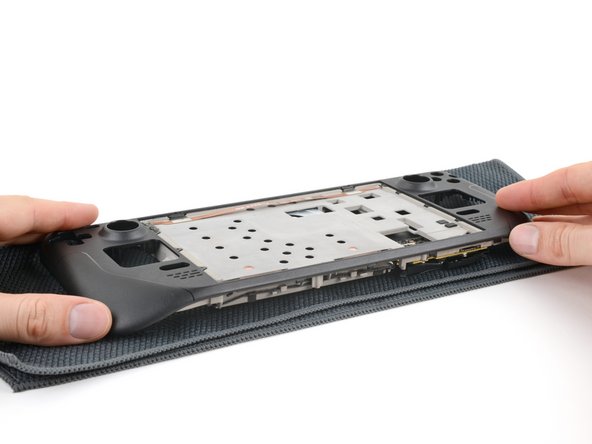

    23. Steam Deck OLED Front Shell Replacement, Flip over the Steam Deck OLED: crwdns2935265:085crwdnd2935265:01crwdnd2935265:03crwdne2935265:0 Steam Deck OLED Front Shell Replacement, Flip over the Steam Deck OLED: crwdns2935265:085crwdnd2935265:02crwdnd2935265:03crwdne2935265:0 Steam Deck OLED Front Shell Replacement, Flip over the Steam Deck OLED: crwdns2935265:085crwdnd2935265:03crwdnd2935265:03crwdne2935265:0
      • Lay a soft, clean cloth on your work surface.
      • While holding the motherboard shield in place, flip over your Steam Deck OLED and lay it screen-side-down onto the cloth.

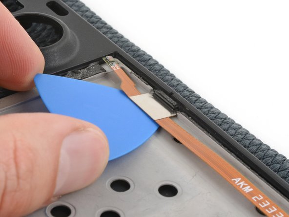

    24. Steam Deck OLED Front Shell Replacement, Separate the sensor cable: crwdns2935265:086crwdnd2935265:01crwdnd2935265:03crwdne2935265:0 Steam Deck OLED Front Shell Replacement, Separate the sensor cable: crwdns2935265:086crwdnd2935265:02crwdnd2935265:03crwdne2935265:0 Steam Deck OLED Front Shell Replacement, Separate the sensor cable: crwdns2935265:086crwdnd2935265:03crwdnd2935265:03crwdne2935265:0
      • Insert the tip of an opening pick under the right-side ambient light sensor to separate it from the top right corner of the screen recess.
      • Lower your pick flat to the midframe and reinsert it under the metal tab located next to the ambient light sensor.
      • Be careful not to damage the cable or separate it from the underside of the metal tab—the adhesive is strong, and the cable is fragile.
      • Slide your pick under the tab to separate it from the midframe.
      • Don't insert your pick deeper than the width of the cable to avoid damaging it.

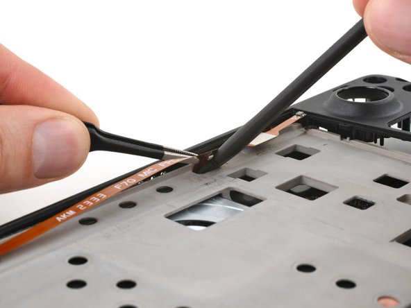

    25. Steam Deck OLED Front Shell Replacement: crwdns2935265:087crwdnd2935265:01crwdnd2935265:03crwdne2935265:0 Steam Deck OLED Front Shell Replacement: crwdns2935265:087crwdnd2935265:02crwdnd2935265:03crwdne2935265:0 Steam Deck OLED Front Shell Replacement: crwdns2935265:087crwdnd2935265:03crwdnd2935265:03crwdne2935265:0
      • Repeat the previous step to separate the left-side ambient light sensor and metal tab.
      • Remember to not insert your pick deeper than the width of the cable to avoid damaging it.
    26. Steam Deck OLED Front Shell Replacement, Separate the antennas: crwdns2935265:088crwdnd2935265:01crwdnd2935265:03crwdne2935265:0 Steam Deck OLED Front Shell Replacement, Separate the antennas: crwdns2935265:088crwdnd2935265:02crwdnd2935265:03crwdne2935265:0 Steam Deck OLED Front Shell Replacement, Separate the antennas: crwdns2935265:088crwdnd2935265:03crwdnd2935265:03crwdne2935265:0
      • Press the flat end of your spudger or your fingers through the bottom left cutout in the screen recess and separate the antenna from the front shell.
      • Only apply enough force to separate the antenna from the black plastic front shell and not the gray midframe. This doesn't require much force.
      • Repeat for the antenna in the bottom middle of the screen recess.

    30. Steam Deck OLED Front Shell Replacement, Separate the left edge of the midframe: crwdns2935265:092crwdnd2935265:01crwdnd2935265:02crwdne2935265:0 Steam Deck OLED Front Shell Replacement, Separate the left edge of the midframe: crwdns2935265:092crwdnd2935265:02crwdnd2935265:02crwdne2935265:0
      • Don't lift the midframe all the way out, yet—the audio board cable prevents the midframe from lifting more than half of an inch (~1.25 cm).
      • Repeat the previous step for the top left corner of the midframe, prying the front shell (near the power button) away from the midframe as you lift the midframe about half an inch (~1.25 cm) up.
      • Remember to inspect the frame and the screen-side sensor cable if you feel resistance.
      • During reassembly, squeeze the top edge of the front shell onto the midframe until it snaps into place.
    31. Steam Deck OLED Front Shell Replacement, Free the audio board cable: crwdns2935265:093crwdnd2935265:01crwdnd2935265:03crwdne2935265:0 Steam Deck OLED Front Shell Replacement, Free the audio board cable: crwdns2935265:093crwdnd2935265:02crwdnd2935265:03crwdne2935265:0 Steam Deck OLED Front Shell Replacement, Free the audio board cable: crwdns2935265:093crwdnd2935265:03crwdnd2935265:03crwdne2935265:0
      • Insert the flat end of your spudger against the audio board cable in the cutout in the midframe.
      • Hold the cable's pull tab clear of the cutout and lift the midframe over the cable.

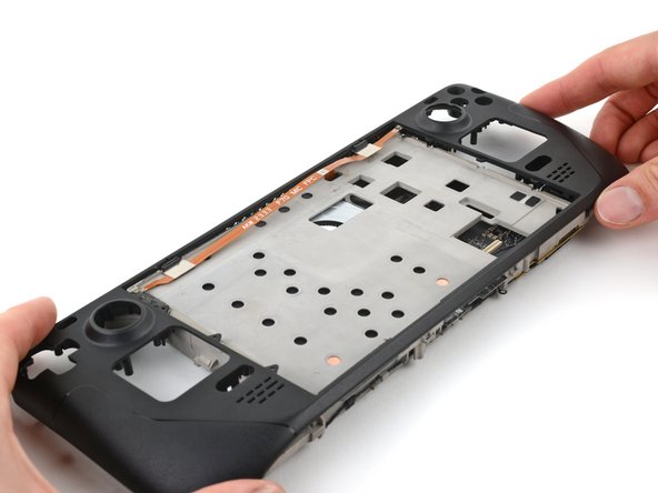

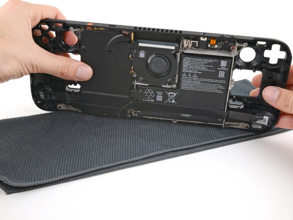

    32. Steam Deck OLED Front Shell Replacement, Remove the midframe: crwdns2935265:094crwdnd2935265:01crwdnd2935265:02crwdne2935265:0 Steam Deck OLED Front Shell Replacement, Remove the midframe: crwdns2935265:094crwdnd2935265:02crwdnd2935265:02crwdne2935265:0
      • Remove the midframe.

    34. Steam Deck OLED Front Shell Replacement, Separate the ambient light sensors cable: crwdns2935265:096crwdnd2935265:01crwdnd2935265:02crwdne2935265:0 Steam Deck OLED Front Shell Replacement, Separate the ambient light sensors cable: crwdns2935265:096crwdnd2935265:02crwdnd2935265:02crwdne2935265:0
      • Use your fingers to separate the metal tab securing the left-side ambient light sensor from the front shell.

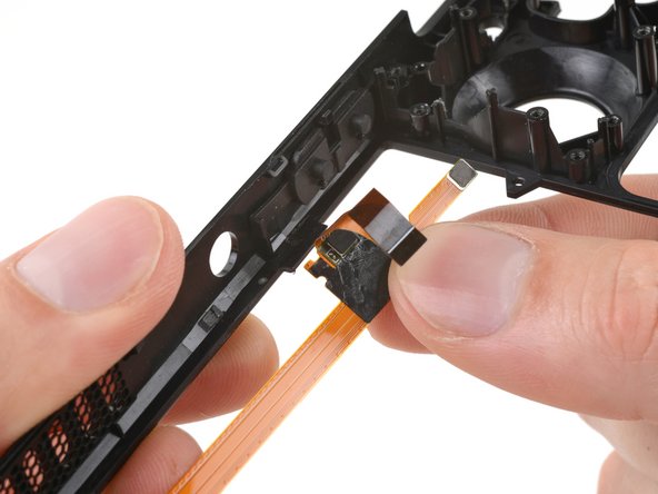

    35. Steam Deck OLED Front Shell Replacement: crwdns2935265:097crwdnd2935265:01crwdnd2935265:02crwdne2935265:0 Steam Deck OLED Front Shell Replacement: crwdns2935265:097crwdnd2935265:02crwdnd2935265:02crwdne2935265:0
      • Use your fingers to separate the metal tab securing the right-side ambient light sensor from the front shell.
    36. Steam Deck OLED Front Shell Replacement, Remove the ambient light sensors: crwdns2935265:098crwdnd2935265:01crwdnd2935265:01crwdne2935265:0
      • Remove the ambient light sensors and audio board cable.
      • All that remains is the front shell.
