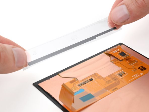

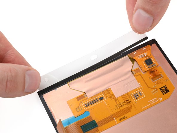

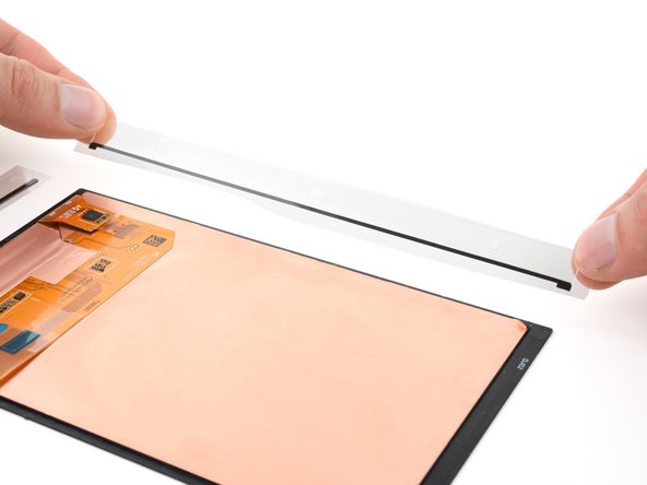

    • Each adhesive strip has a flexible liner on the back, and a stiff liner with hole cutouts on the front. As you orient your adhesives, make sure the stiff liners with holes face upward.
    • Before applying your new adhesives, lay them out over your screen to find their proper orientation:
    • The long piece with curved ends is for the top edge.
    • The other long piece is for the bottom edge.
    • The short piece with a notch cutout is for the edge with the screen cable. The notch should be closest to the top edge.
    • The other short piece is for the edge opposite the screen cable.
  4. How to Apply Screen Adhesive in your Steam Deck OLED, Apply the adhesives: crwdns2935265:04crwdnd2935265:01crwdnd2935265:01crwdne2935265:0
    • Peel the larger flexible adhesive liner from the back of an adhesive strip.
  5. How to Apply Screen Adhesive in your Steam Deck OLED: crwdns2935265:05crwdnd2935265:01crwdnd2935265:03crwdne2935265:0 How to Apply Screen Adhesive in your Steam Deck OLED: crwdns2935265:05crwdnd2935265:02crwdnd2935265:03crwdne2935265:0 How to Apply Screen Adhesive in your Steam Deck OLED: crwdns2935265:05crwdnd2935265:03crwdnd2935265:03crwdne2935265:0

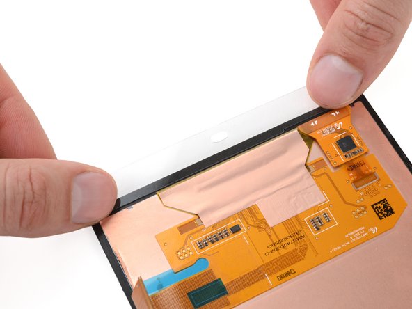

    • Note that the long strips of adhesive take up the entire length of the screen, and the short strips fit in-between the edges of the long strips.
    • Align and place the adhesive strip onto the edge of the screen, making sure it's flush with the outside edge and not overlapping the screen panel.

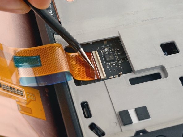

  8. How to Apply Screen Adhesive in your Steam Deck OLED, Install the screen: crwdns2935265:08crwdnd2935265:01crwdnd2935265:03crwdne2935265:0 How to Apply Screen Adhesive in your Steam Deck OLED, Install the screen: crwdns2935265:08crwdnd2935265:02crwdnd2935265:03crwdne2935265:0 How to Apply Screen Adhesive in your Steam Deck OLED, Install the screen: crwdns2935265:08crwdnd2935265:03crwdnd2935265:03crwdne2935265:0

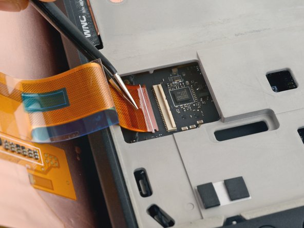

    • Make sure the small locking flap on the screen ZIF connector is flipped up before reconnecting the screen.
    • Hold the screen slightly below the bottom edge of the frame and align the screen cable with its socket on the motherboard.
    • Use angled tweezers to grip the pull tab on the neck of the screen cable.
    • Angle the cable so it's lined up and parallel to the socket, rotating the tips of the tweezers as necessary to get the right angle.
    • The end of the cable needs to be parallel to the motherboard—not angled downward.
    • Gently insert the connector into the socket until the white line meets the body of the socket.
    • If the connector doesn't smoothly enter the socket, realign it and try again.
    • Use your finger of the flat end of a spudger to flip the locking flap down to secure the cable.

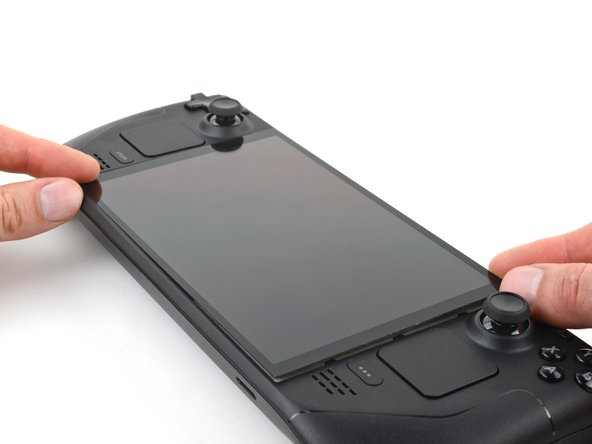

    • Align the screen over its recess in the frame.
    • Press the screen into place.

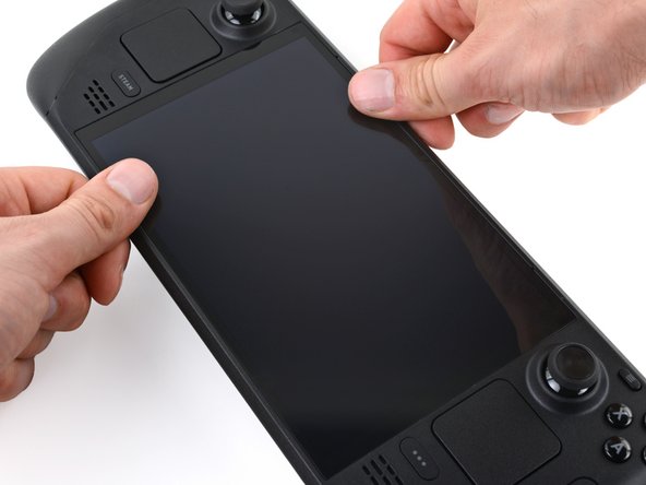

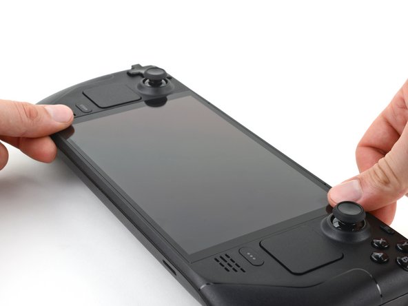

  10. How to Apply Screen Adhesive in your Steam Deck OLED: crwdns2935265:010crwdnd2935265:01crwdnd2935265:02crwdne2935265:0 How to Apply Screen Adhesive in your Steam Deck OLED: crwdns2935265:010crwdnd2935265:02crwdnd2935265:02crwdne2935265:0
    • Firmly press along the perimeter of the screen to secure the adhesive to the frame.
    • Optionally, you may use a hair dryer or heat gun to lightly heat the screen to strengthen the adhesive bond.
