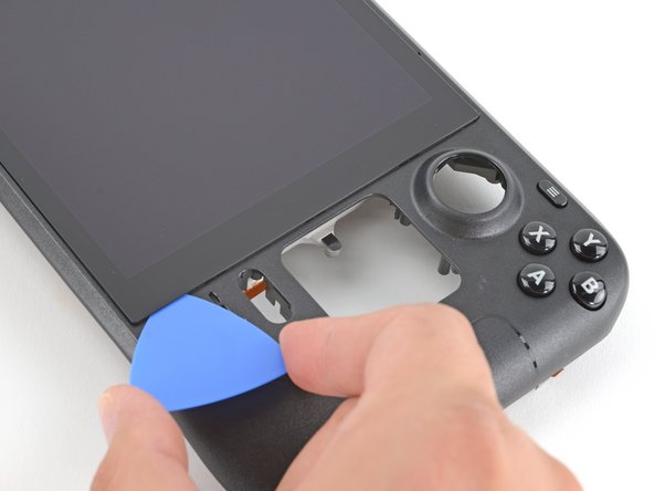

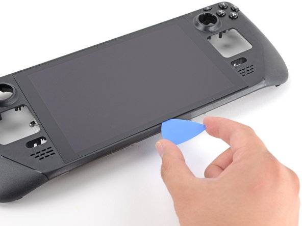

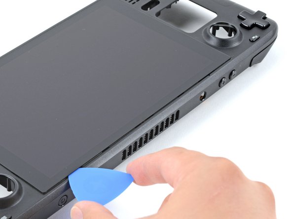

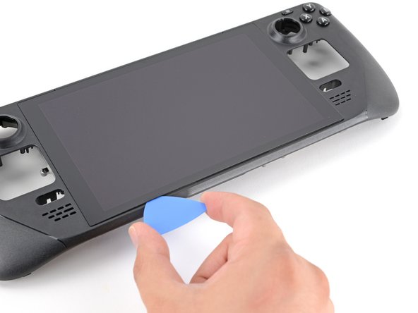

    3. Steam Deck Front Shell Replacement, Unclip the back cover: crwdns2935265:03crwdnd2935265:01crwdnd2935265:02crwdne2935265:0 Steam Deck Front Shell Replacement, Unclip the back cover: crwdns2935265:03crwdnd2935265:02crwdnd2935265:02crwdne2935265:0
      • Insert an opening pick into the thin gap between the back cover and the front shell, along the edge of the right grip.
      • If you're having trouble inserting your pick at the grip seam, try starting at either the top or bottom long edges first, then slide the pick towards the grip.
      • Pry up on the back cover to release it from the locking clips.

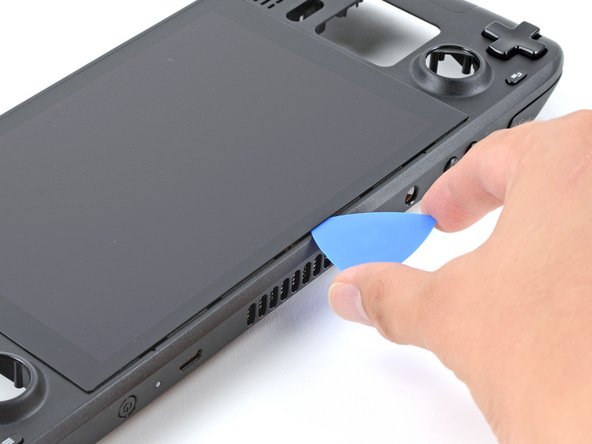

    4. Steam Deck Front Shell Replacement, Remove the back cover: crwdns2935265:04crwdnd2935265:01crwdnd2935265:03crwdne2935265:0 Steam Deck Front Shell Replacement, Remove the back cover: crwdns2935265:04crwdnd2935265:02crwdnd2935265:03crwdne2935265:0 Steam Deck Front Shell Replacement, Remove the back cover: crwdns2935265:04crwdnd2935265:03crwdnd2935265:03crwdne2935265:0
      • Once the clips are disconnected from one edge, the rest disconnect easily.
      • Grip the back cover at the opening you just created and pull it up and away from the device to unclip the long edges.
      • Remove the back cover.

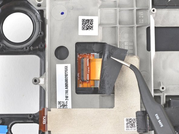

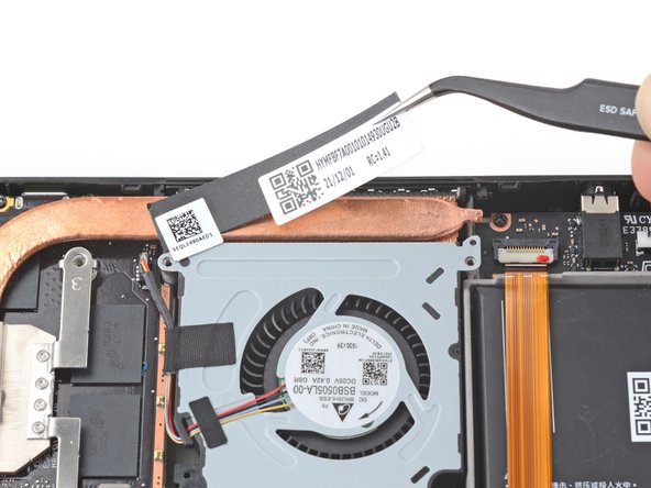

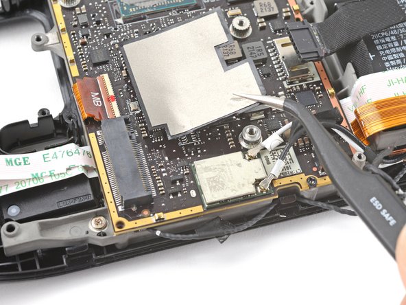

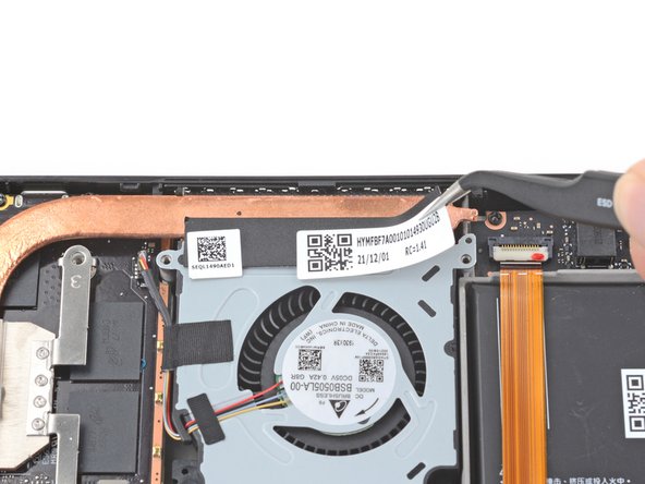

    1. Steam Deck Front Shell Replacement, Uncover the hidden shield screw: crwdns2935265:05crwdnd2935265:01crwdnd2935265:02crwdne2935265:0 Steam Deck Front Shell Replacement, Uncover the hidden shield screw: crwdns2935265:05crwdnd2935265:02crwdnd2935265:02crwdne2935265:0
      • If you have a refreshed Steam Deck version with the black motherboard cover, skip this step.
      • Use a pair of tweezers to remove the piece of foil tape covering the hidden screw on the board shield.
      • If possible, try not to rip or tear this tape so it can be reused. If necessary, you can fashion a replacement by cutting a piece of aluminum foil tape to fit.
    2. Steam Deck Front Shell Replacement, Remove the shield screws: crwdns2935265:06crwdnd2935265:01crwdnd2935265:02crwdne2935265:0 Steam Deck Front Shell Replacement, Remove the shield screws: crwdns2935265:06crwdnd2935265:02crwdnd2935265:02crwdne2935265:0
      • Use a Phillips driver to remove the three screws securing the board shield:
      • One 3.4 mm screw
      • Two 3.7 mm screws
      • Only the two 3.7 mm screws along the left edge are present in refreshed Steam Decks.

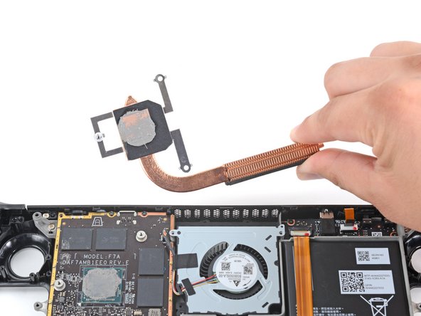

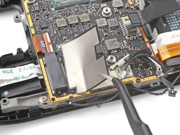

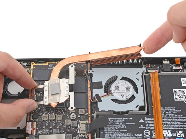

    3. Steam Deck Front Shell Replacement, Remove the shield: crwdns2935265:07crwdnd2935265:01crwdnd2935265:03crwdne2935265:0 Steam Deck Front Shell Replacement, Remove the shield: crwdns2935265:07crwdnd2935265:02crwdnd2935265:03crwdne2935265:0 Steam Deck Front Shell Replacement, Remove the shield: crwdns2935265:07crwdnd2935265:03crwdnd2935265:03crwdne2935265:0
      • Remove the board shield.
      • Depending on the age of your Steam Deck, this shield may stick to the thermal pads underneath.
      • During reassembly, ensure that the fan cable lays on the side of the board shield and isn't pinched underneath.

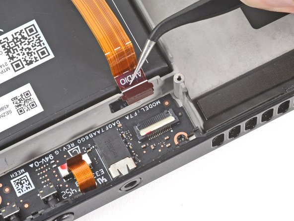

    4. Steam Deck Front Shell Replacement, Disconnect the battery: crwdns2935265:08crwdnd2935265:01crwdnd2935265:03crwdne2935265:0 Steam Deck Front Shell Replacement, Disconnect the battery: crwdns2935265:08crwdnd2935265:02crwdnd2935265:03crwdne2935265:0 Steam Deck Front Shell Replacement, Disconnect the battery: crwdns2935265:08crwdnd2935265:03crwdnd2935265:03crwdne2935265:0
      • Grip the battery cable by its pull tab and pull it directly away from the motherboard to disconnect it.
      • Alternatively, use the flat end of a spudger or a clean fingernail to gently push the connector out of its socket, then disconnect it completely by hand.

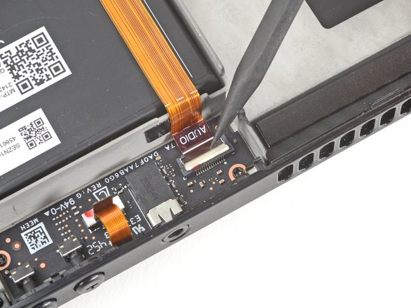

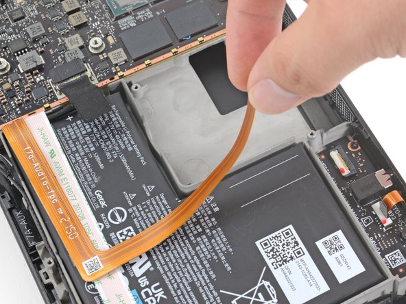

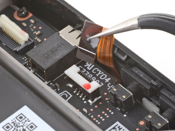

    4. Steam Deck Front Shell Replacement, Disconnect the interconnect cable: crwdns2935265:016crwdnd2935265:01crwdnd2935265:03crwdne2935265:0 Steam Deck Front Shell Replacement, Disconnect the interconnect cable: crwdns2935265:016crwdnd2935265:02crwdnd2935265:03crwdne2935265:0 Steam Deck Front Shell Replacement, Disconnect the interconnect cable: crwdns2935265:016crwdnd2935265:03crwdnd2935265:03crwdne2935265:0
      • Use the pointed end of a spudger to lift up the small locking flap on the button board interconnect cable's ZIF connector.
      • Use a pair of tweezers to slide the cable out of its connector.
      • Grip the cable by the blue pull tab, not by the cable itself.

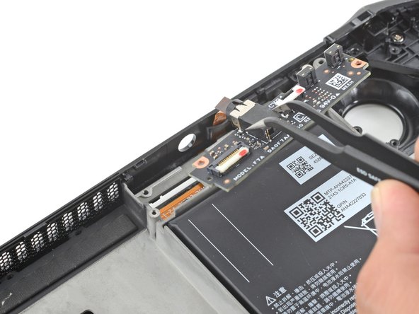

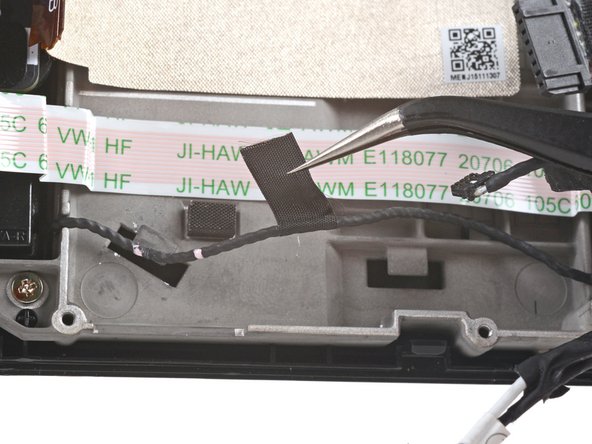

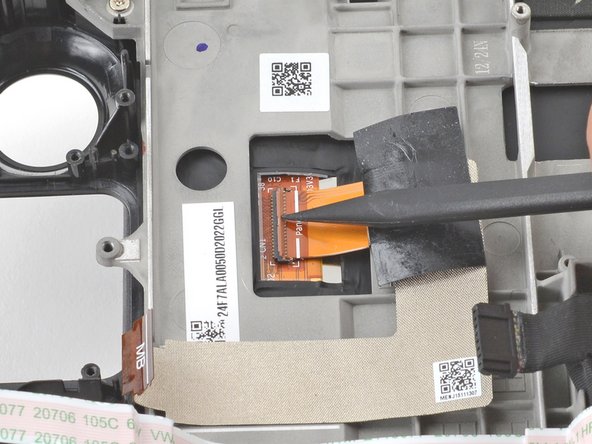

    5. Steam Deck Front Shell Replacement, Disconnect the remaining button board cables: crwdns2935265:017crwdnd2935265:01crwdnd2935265:03crwdne2935265:0 Steam Deck Front Shell Replacement, Disconnect the remaining button board cables: crwdns2935265:017crwdnd2935265:02crwdnd2935265:03crwdne2935265:0 Steam Deck Front Shell Replacement, Disconnect the remaining button board cables: crwdns2935265:017crwdnd2935265:03crwdnd2935265:03crwdne2935265:0
      • If any connectors are covered with tape, use a pair of tweezers to remove it.
      • Use the pointed end of a spudger to lift up the small locking flaps on the rest of the button board ZIF connectors. Use a pair of tweezers to slide the cables out of their connectors:
      • Disconnect the D-pad cable.
      • Disconnect the touchpad board cable.
      • Disconnect the touchpad cable.

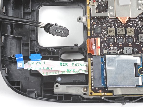

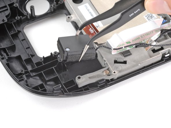

    6. Steam Deck Front Shell Replacement, Disconnect the left haptics: crwdns2935265:018crwdnd2935265:01crwdnd2935265:03crwdne2935265:0 Steam Deck Front Shell Replacement, Disconnect the left haptics: crwdns2935265:018crwdnd2935265:02crwdnd2935265:03crwdne2935265:0 Steam Deck Front Shell Replacement, Disconnect the left haptics: crwdns2935265:018crwdnd2935265:03crwdnd2935265:03crwdne2935265:0
      • Exercise caution when lifting this connector—pry up on the connector itself, not its housing.
      • Use the pointed end of a spudger to lift up on the haptics cable to disconnect it.
      • Alternatively, you can leave the haptics connected to the button board and flip the board up and over the edge of the shell and out of the way.

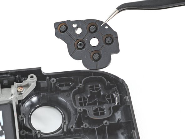

    8. Steam Deck Front Shell Replacement, Remove the button board: crwdns2935265:020crwdnd2935265:01crwdnd2935265:02crwdne2935265:0 Steam Deck Front Shell Replacement, Remove the button board: crwdns2935265:020crwdnd2935265:02crwdnd2935265:02crwdne2935265:0
      • Remove the left button board.

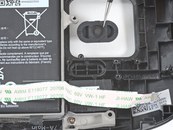

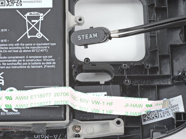

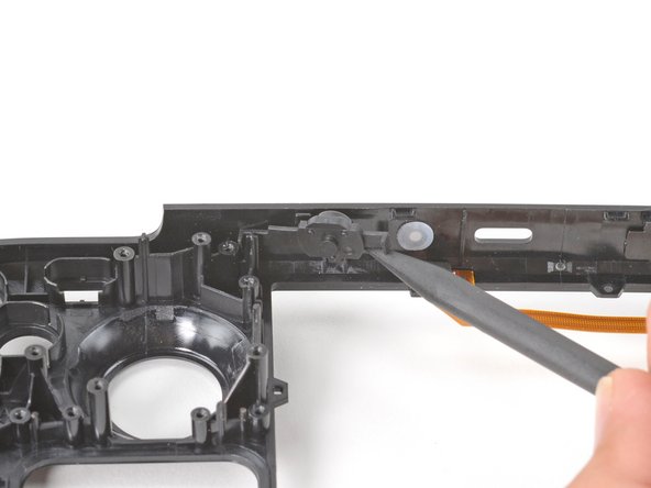

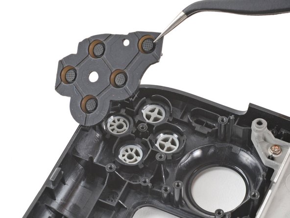

      • Keep track of the Steam button and its membrane, as once the left button board is removed, they're no longer secured in place.

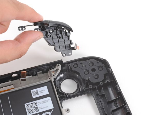

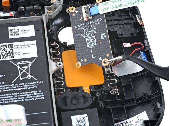

    1. Steam Deck Front Shell Replacement, Remove the touchpad board screws: crwdns2935265:021crwdnd2935265:01crwdnd2935265:01crwdne2935265:0
      • Use a Phillips driver to remove the four 4.7 mm screws securing the touchpad board.
    2. Steam Deck Front Shell Replacement, Remove the touchpad board: crwdns2935265:022crwdnd2935265:01crwdnd2935265:02crwdne2935265:0 Steam Deck Front Shell Replacement, Remove the touchpad board: crwdns2935265:022crwdnd2935265:02crwdnd2935265:02crwdne2935265:0
      • Remove the touchpad board.

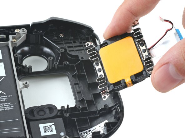

    3. Steam Deck Front Shell Replacement, Remove the touchpad screws: crwdns2935265:023crwdnd2935265:01crwdnd2935265:02crwdne2935265:0 Steam Deck Front Shell Replacement, Remove the touchpad screws: crwdns2935265:023crwdnd2935265:02crwdnd2935265:02crwdne2935265:0
      • Use a Phillips driver to remove the four 4.7 mm screws securing the touchpad.
      • You may need to temporarily remove the Steam button membrane for easier access to the bottom left screw.
      • Each of the touchpad's four mounting corners have a locating peg. During reassembly, ensure each is properly seated.
    4. Steam Deck Front Shell Replacement, Remove the left touchpad: crwdns2935265:024crwdnd2935265:01crwdnd2935265:03crwdne2935265:0 Steam Deck Front Shell Replacement, Remove the left touchpad: crwdns2935265:024crwdnd2935265:02crwdnd2935265:03crwdne2935265:0 Steam Deck Front Shell Replacement, Remove the left touchpad: crwdns2935265:024crwdnd2935265:03crwdnd2935265:03crwdne2935265:0

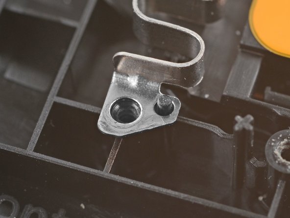

      • The touchpad's springs are very delicate and are precisely positioned. If bent, the touchpad may rattle or not work as intended.
      • From the front of the Steam Deck, use your finger to push the left touchpad partway through the front shell to unseat it.
      • Lift the touchpad out from underneath the overhanging section of the midframe.
      • Remove the touchpad.

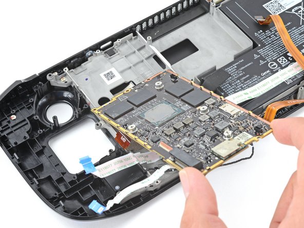

    1. Steam Deck Front Shell Replacement, Unclip the right trigger: crwdns2935265:025crwdnd2935265:01crwdnd2935265:02crwdne2935265:0 Steam Deck Front Shell Replacement, Unclip the right trigger: crwdns2935265:025crwdnd2935265:02crwdnd2935265:02crwdne2935265:0
      • The right trigger will be on your left-hand side when working on the Steam Deck, as it's laying upside down.
      • The Steam Deck's triggers clip into place on two pegs on the trigger bracket, which doubles as the hinge.
      • Place the flat end of a spudger onto the inside edge of the trigger's right clip.
      • Pivot the trigger clip out, away, and up from the peg to unlatch it.
      • During reassembly, latch the outermost peg first. Once in place, push down on the trigger to latch the innermost peg, producing an audible "click" sound.
      • Check to make sure that the trigger spring is properly aligned. Test the trigger action before continuing reassembly.
    2. Steam Deck Front Shell Replacement, Remove the right trigger: crwdns2935265:026crwdnd2935265:01crwdnd2935265:02crwdne2935265:0 Steam Deck Front Shell Replacement, Remove the right trigger: crwdns2935265:026crwdnd2935265:02crwdnd2935265:02crwdne2935265:0
      • Remove the right trigger.
      • Take care to not lose the trigger spring. It press-fits onto a peg on the trigger's underside.
    3. Steam Deck Front Shell Replacement, Remove the trigger bracket screws: crwdns2935265:027crwdnd2935265:01crwdnd2935265:01crwdne2935265:0
      • Use a Phillips driver to remove the three 5.2 mm screws securing the right trigger bracket.
    4. Steam Deck Front Shell Replacement, Remove the trigger bracket: crwdns2935265:028crwdnd2935265:01crwdnd2935265:01crwdne2935265:0
      • Remove the right trigger bracket.
      • Replacement triggers require calibration to work as expected. To calibrate new triggers, follow this calibration guide.

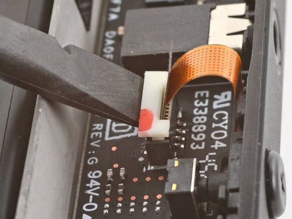

    1. Steam Deck Front Shell Replacement, Disconnect the right thumbstick: crwdns2935265:029crwdnd2935265:01crwdnd2935265:03crwdne2935265:0 Steam Deck Front Shell Replacement, Disconnect the right thumbstick: crwdns2935265:029crwdnd2935265:02crwdnd2935265:03crwdne2935265:0 Steam Deck Front Shell Replacement, Disconnect the right thumbstick: crwdns2935265:029crwdnd2935265:03crwdnd2935265:03crwdne2935265:0
      • Use the pointed end of a spudger to lift up the small locking flap on the thumbstick cable's ZIF connector.

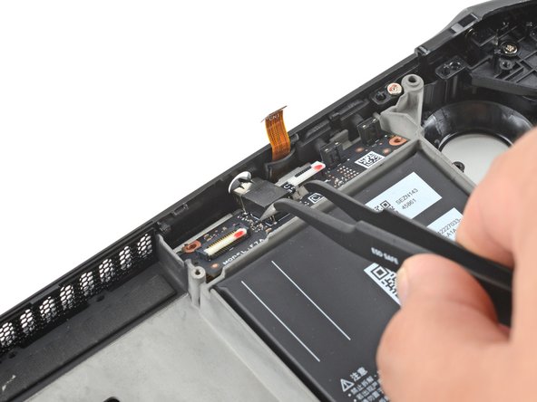

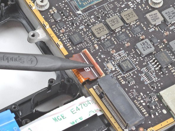

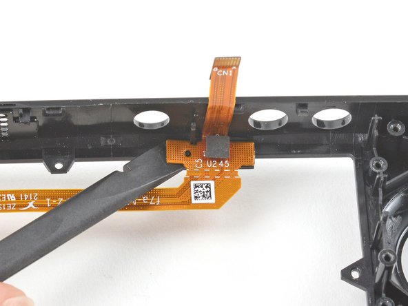

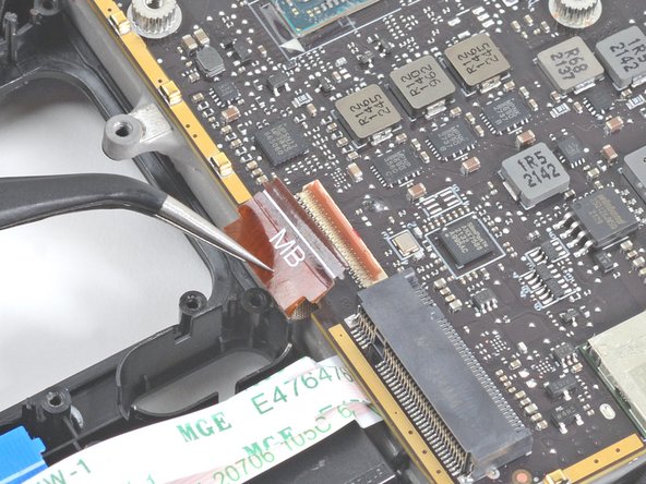

    4. Steam Deck Front Shell Replacement, Disconnect the button board cable: crwdns2935265:032crwdnd2935265:01crwdnd2935265:03crwdne2935265:0 Steam Deck Front Shell Replacement, Disconnect the button board cable: crwdns2935265:032crwdnd2935265:02crwdnd2935265:03crwdne2935265:0 Steam Deck Front Shell Replacement, Disconnect the button board cable: crwdns2935265:032crwdnd2935265:03crwdnd2935265:03crwdne2935265:0
      • Use the pointed end of a spudger to lift up the small locking flap on the button board cable's ZIF connector.

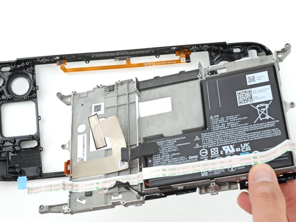

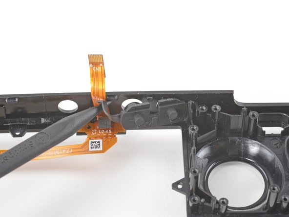

    5. Steam Deck Front Shell Replacement, Disconnect the interconnect cable: crwdns2935265:033crwdnd2935265:01crwdnd2935265:03crwdne2935265:0 Steam Deck Front Shell Replacement, Disconnect the interconnect cable: crwdns2935265:033crwdnd2935265:02crwdnd2935265:03crwdne2935265:0 Steam Deck Front Shell Replacement, Disconnect the interconnect cable: crwdns2935265:033crwdnd2935265:03crwdnd2935265:03crwdne2935265:0

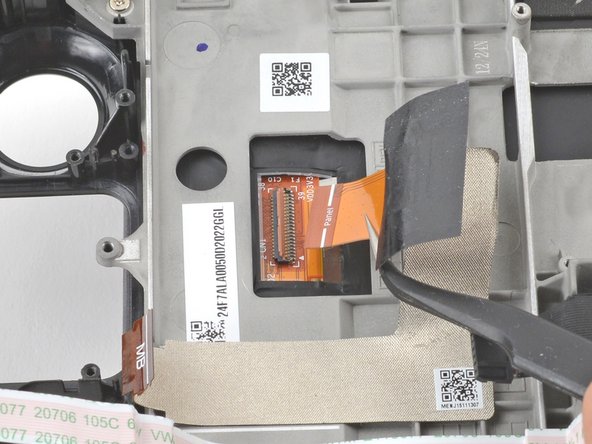

    6. Steam Deck Front Shell Replacement, Disconnect the remaining button board cables: crwdns2935265:034crwdnd2935265:01crwdnd2935265:03crwdne2935265:0 Steam Deck Front Shell Replacement, Disconnect the remaining button board cables: crwdns2935265:034crwdnd2935265:02crwdnd2935265:03crwdne2935265:0 Steam Deck Front Shell Replacement, Disconnect the remaining button board cables: crwdns2935265:034crwdnd2935265:03crwdnd2935265:03crwdne2935265:0
      • Disconnect the action buttons cable.

    1. Steam Deck Front Shell Replacement, Remove the touchpad board screws: crwdns2935265:038crwdnd2935265:01crwdnd2935265:01crwdne2935265:0
    2. Steam Deck Front Shell Replacement, Remove the touchpad board: crwdns2935265:039crwdnd2935265:01crwdnd2935265:02crwdne2935265:0 Steam Deck Front Shell Replacement, Remove the touchpad board: crwdns2935265:039crwdnd2935265:02crwdnd2935265:02crwdne2935265:0
    3. Steam Deck Front Shell Replacement, Remove the touchpad screws: crwdns2935265:040crwdnd2935265:01crwdnd2935265:02crwdne2935265:0 Steam Deck Front Shell Replacement, Remove the touchpad screws: crwdns2935265:040crwdnd2935265:02crwdnd2935265:02crwdne2935265:0
      • You may need to temporarily remove the quick access button membrane for easier access to the bottom right screw.
    4. Steam Deck Front Shell Replacement, Remove the right touchpad: crwdns2935265:041crwdnd2935265:01crwdnd2935265:03crwdne2935265:0 Steam Deck Front Shell Replacement, Remove the right touchpad: crwdns2935265:041crwdnd2935265:02crwdnd2935265:03crwdne2935265:0 Steam Deck Front Shell Replacement, Remove the right touchpad: crwdns2935265:041crwdnd2935265:03crwdnd2935265:03crwdne2935265:0
      • From the front of the Steam Deck, use your finger to push the right touchpad partway through the front shell to unseat it.

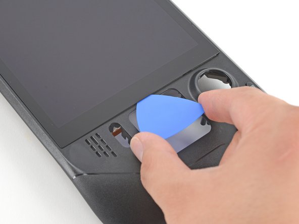

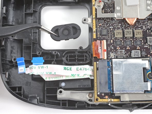

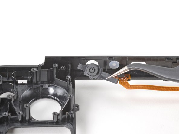

    1. Steam Deck Front Shell Replacement, Remove the quick access button membrane: crwdns2935265:042crwdnd2935265:01crwdnd2935265:02crwdne2935265:0 Steam Deck Front Shell Replacement, Remove the quick access button membrane: crwdns2935265:042crwdnd2935265:02crwdnd2935265:02crwdne2935265:0
      • Use a pair of tweezers to remove the quick access button membrane.

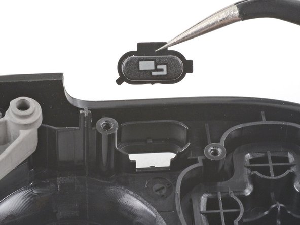

    2. Steam Deck Front Shell Replacement, Remove the quick access button: crwdns2935265:043crwdnd2935265:01crwdnd2935265:02crwdne2935265:0 Steam Deck Front Shell Replacement, Remove the quick access button: crwdns2935265:043crwdnd2935265:02crwdnd2935265:02crwdne2935265:0
      • Use a pair of tweezers to remove the quick access button.
    3. Steam Deck Front Shell Replacement, Remove the Steam button membrane: crwdns2935265:044crwdnd2935265:01crwdnd2935265:02crwdne2935265:0 Steam Deck Front Shell Replacement, Remove the Steam button membrane: crwdns2935265:044crwdnd2935265:02crwdnd2935265:02crwdne2935265:0
      • Use a pair of tweezers to remove the Steam button membrane.
    4. Steam Deck Front Shell Replacement, Remove the Steam button: crwdns2935265:045crwdnd2935265:01crwdnd2935265:02crwdne2935265:0 Steam Deck Front Shell Replacement, Remove the Steam button: crwdns2935265:045crwdnd2935265:02crwdnd2935265:02crwdne2935265:0
      • Use a pair of tweezers to remove the Steam button.

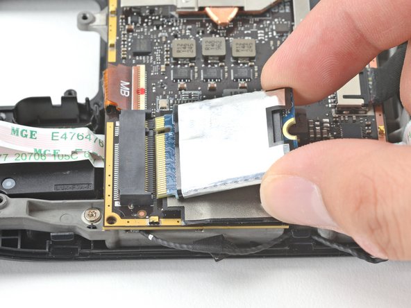

    5. Steam Deck Front Shell Replacement, Remove the SSD screw: crwdns2935265:046crwdnd2935265:01crwdnd2935265:01crwdne2935265:0
      • Use a Phillips driver to remove the 3.4 mm screw securing the SSD.
    6. Steam Deck Front Shell Replacement, Remove the SSD: crwdns2935265:047crwdnd2935265:01crwdnd2935265:02crwdne2935265:0 Steam Deck Front Shell Replacement, Remove the SSD: crwdns2935265:047crwdnd2935265:02crwdnd2935265:02crwdne2935265:0
      • With the SSD screw removed, the SSD will pop up at a shallow angle.
      • Grip the end of the SSD and pull it away from its M.2 board connector to remove it.
      • During reassembly, insert the SSD at a shallow angle into its board connector, and secure it back into its horizontal position with the SSD screw.
    7. Steam Deck Front Shell Replacement, Remove the heatsink sticker: crwdns2935265:048crwdnd2935265:01crwdnd2935265:03crwdne2935265:0 Steam Deck Front Shell Replacement, Remove the heatsink sticker: crwdns2935265:048crwdnd2935265:02crwdnd2935265:03crwdne2935265:0 Steam Deck Front Shell Replacement, Remove the heatsink sticker: crwdns2935265:048crwdnd2935265:03crwdnd2935265:03crwdne2935265:0
      • Use a pair of tweezers to remove the sticker from the top edge of the fan.
      • If possible, try not to rip or tear this sticker so it can be reused. Use a little bit of heat if necessary to soften the adhesive.
    8. Steam Deck Front Shell Replacement, Remove the heatsink screws: crwdns2935265:049crwdnd2935265:01crwdnd2935265:01crwdne2935265:0
      • Use a Phillips driver to loosen and remove the two screws securing the heatsink to the motherboard:
      • One captive 3.5 mm screw
      • One 3.4 mm screw
      • No, your eyes don't deceive you! The third heatsink screw was removed earlier in the disassembly: it doubles as the hidden board shield screw.
    9. Steam Deck Front Shell Replacement, Remove the heatsink: crwdns2935265:050crwdnd2935265:01crwdnd2935265:03crwdne2935265:0 Steam Deck Front Shell Replacement, Remove the heatsink: crwdns2935265:050crwdnd2935265:02crwdnd2935265:03crwdne2935265:0 Steam Deck Front Shell Replacement, Remove the heatsink: crwdns2935265:050crwdnd2935265:03crwdnd2935265:03crwdne2935265:0
      • Lift and remove the heatsink.
      • Before reinstalling the heatsink, follow this guide to clean the heatsink and APU and reapply thermal paste.

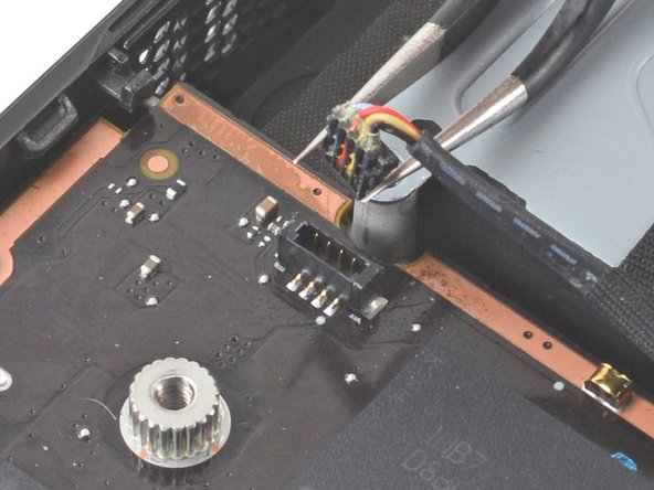

    13. Steam Deck Front Shell Replacement, Disconnect the speakers: crwdns2935265:054crwdnd2935265:01crwdnd2935265:02crwdne2935265:0 Steam Deck Front Shell Replacement, Disconnect the speakers: crwdns2935265:054crwdnd2935265:02crwdnd2935265:02crwdne2935265:0
      • Use a pair of tweezers to grip the edges of the speaker connector and pull up to disconnect it from the motherboard.
      • Pull the speaker cable by its connector, not the wires themselves.

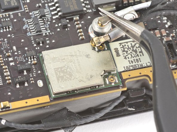

    14. Steam Deck Front Shell Replacement, Remove the Wi-Fi shield tape: crwdns2935265:055crwdnd2935265:01crwdnd2935265:03crwdne2935265:0 Steam Deck Front Shell Replacement, Remove the Wi-Fi shield tape: crwdns2935265:055crwdnd2935265:02crwdnd2935265:03crwdne2935265:0 Steam Deck Front Shell Replacement, Remove the Wi-Fi shield tape: crwdns2935265:055crwdnd2935265:03crwdnd2935265:03crwdne2935265:0
      • Use a pair of tweezers to peel up and remove the Wi-Fi shield tape.

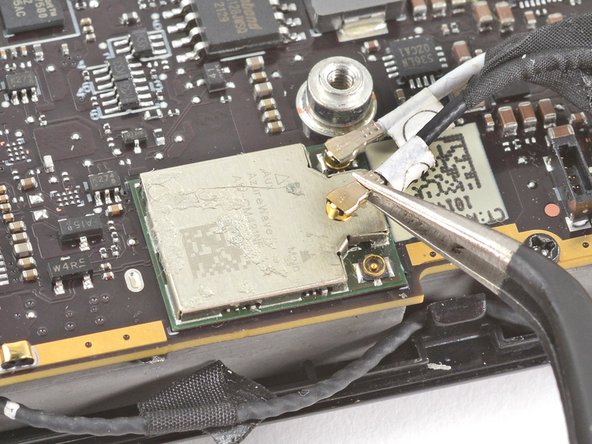

    15. Steam Deck Front Shell Replacement, Disconnect the Wi-Fi: crwdns2935265:056crwdnd2935265:01crwdnd2935265:03crwdne2935265:0 Steam Deck Front Shell Replacement, Disconnect the Wi-Fi: crwdns2935265:056crwdnd2935265:02crwdnd2935265:03crwdne2935265:0 Steam Deck Front Shell Replacement, Disconnect the Wi-Fi: crwdns2935265:056crwdnd2935265:03crwdnd2935265:03crwdne2935265:0
      • Use a pair of tweezers to grip the antenna connector close to its base.
      • Pull straight up to disconnect the cable.
      • Repeat for the second antenna cable.
      • During reassembly, ensure that both antenna cables are reconnected at their appropriate connectors. The labels on the cables match the markings on the Wi-Fi module.
      • To reconnect each cable, align the connector directly over its socket, and then press down so it snaps into place.
    16. Steam Deck Front Shell Replacement, Disconnect the display: crwdns2935265:057crwdnd2935265:01crwdnd2935265:03crwdne2935265:0 Steam Deck Front Shell Replacement, Disconnect the display: crwdns2935265:057crwdnd2935265:02crwdnd2935265:03crwdne2935265:0 Steam Deck Front Shell Replacement, Disconnect the display: crwdns2935265:057crwdnd2935265:03crwdnd2935265:03crwdne2935265:0
      • Use the pointed end of a spudger to lift up the small locking flap on the display cable's ZIF connector.
      • Grip the cable by the pull tab, not by the cable itself.
    17. Steam Deck Front Shell Replacement, Disconnect the audio cable: crwdns2935265:058crwdnd2935265:01crwdnd2935265:02crwdne2935265:0 Steam Deck Front Shell Replacement, Disconnect the audio cable: crwdns2935265:058crwdnd2935265:02crwdnd2935265:02crwdne2935265:0
      • Use the pointed end of a spudger to lift up the small locking flap on the audio cable's ZIF connector.
    18. Steam Deck Front Shell Replacement: crwdns2935265:059crwdnd2935265:01crwdnd2935265:02crwdne2935265:0 Steam Deck Front Shell Replacement: crwdns2935265:059crwdnd2935265:02crwdnd2935265:02crwdne2935265:0
      • Grip the cable by its pull tab, not by the cable itself.
    19. Steam Deck Front Shell Replacement: crwdns2935265:060crwdnd2935265:01crwdnd2935265:03crwdne2935265:0 Steam Deck Front Shell Replacement: crwdns2935265:060crwdnd2935265:02crwdnd2935265:03crwdne2935265:0 Steam Deck Front Shell Replacement: crwdns2935265:060crwdnd2935265:03crwdnd2935265:03crwdne2935265:0
      • Carefully peel the audio cable off of the battery.
      • The audio cable is secured to the battery with some light adhesive.
      • If the adhesive is stubborn, don't force the cable. Lightly heat the audio cable using an iOpener or a hair dryer to soften the adhesive.

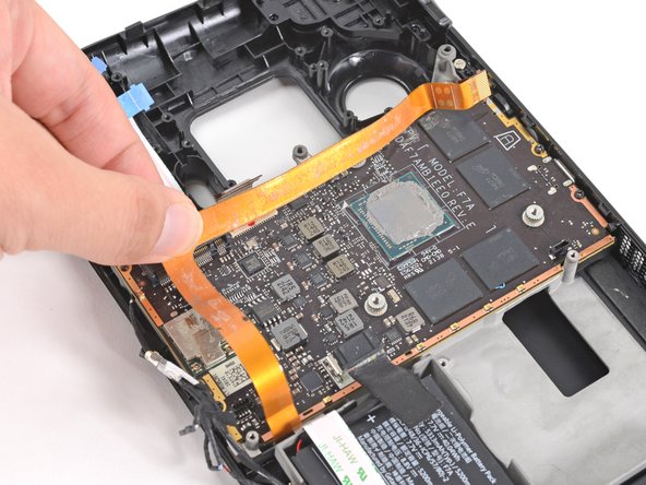

    20. Steam Deck Front Shell Replacement, Remove the motherboard screws: crwdns2935265:061crwdnd2935265:01crwdnd2935265:01crwdne2935265:0
      • Use a Phillips driver to remove the three 3.7 mm screws securing the motherboard.
    21. Steam Deck Front Shell Replacement, Remove the motherboard: crwdns2935265:062crwdnd2935265:01crwdnd2935265:03crwdne2935265:0 Steam Deck Front Shell Replacement, Remove the motherboard: crwdns2935265:062crwdnd2935265:02crwdnd2935265:03crwdne2935265:0 Steam Deck Front Shell Replacement, Remove the motherboard: crwdns2935265:062crwdnd2935265:03crwdnd2935265:03crwdne2935265:0
      • Remove the motherboard.

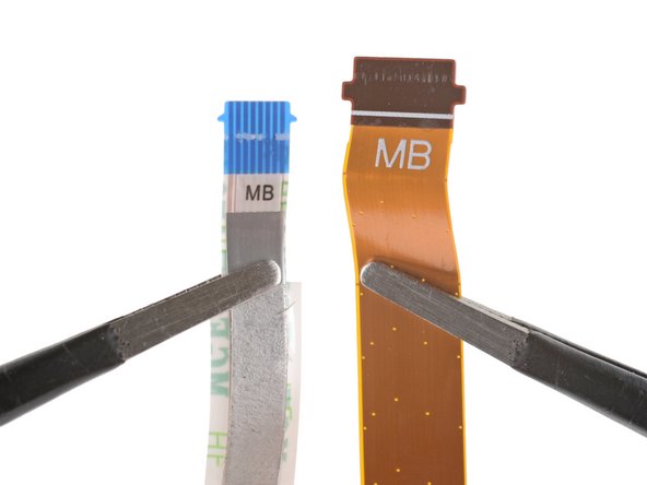

      • The audio and button board cables attach to the underside of the motherboard with ZIF connectors.

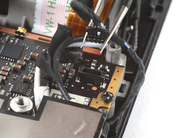

    22. Steam Deck Front Shell Replacement, Disconnect the mic cable: crwdns2935265:063crwdnd2935265:01crwdnd2935265:03crwdne2935265:0 Steam Deck Front Shell Replacement, Disconnect the mic cable: crwdns2935265:063crwdnd2935265:02crwdnd2935265:03crwdne2935265:0 Steam Deck Front Shell Replacement, Disconnect the mic cable: crwdns2935265:063crwdnd2935265:03crwdnd2935265:03crwdne2935265:0
      • Use the pointed end of a spudger to lift up on the mic cable's white locking tab.
      • You should feel a small tactile bump once the connector unlocks.
      • Use a pair of tweezers to pull the mic cable up and out of its connector.
      • With the connector properly unlocked, the mic cable should slide out with little to no resistance.
      • During reassembly, ensure that the locking tab is in its unlocked, lifted position before reinserting the mic cable. Press down on the tab to lock the cable in place.
    23. Steam Deck Front Shell Replacement, Remove the audio board screws: crwdns2935265:064crwdnd2935265:01crwdnd2935265:01crwdne2935265:0
      • Use a Phillips driver to remove the two 3.7 mm screws securing the audio board.
    24. Steam Deck Front Shell Replacement, Remove the audio board: crwdns2935265:065crwdnd2935265:01crwdnd2935265:03crwdne2935265:0 Steam Deck Front Shell Replacement, Remove the audio board: crwdns2935265:065crwdnd2935265:02crwdnd2935265:03crwdne2935265:0 Steam Deck Front Shell Replacement, Remove the audio board: crwdns2935265:065crwdnd2935265:03crwdnd2935265:03crwdne2935265:0
      • Use a pair of tweezers to grip the audio board by the headphone jack.
      • Pivot the board up and out of its recess to remove it.

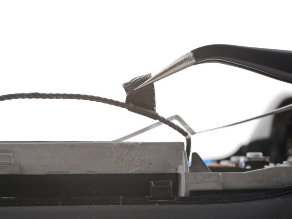

    25. Steam Deck Front Shell Replacement, Isolate the speaker wire: crwdns2935265:066crwdnd2935265:01crwdnd2935265:01crwdne2935265:0
      • Use a pair of tweezers to peel up the tape bundling the speaker wire to the Wi-Fi antenna cables.
    26. Steam Deck Front Shell Replacement: crwdns2935265:067crwdnd2935265:01crwdnd2935265:03crwdne2935265:0 Steam Deck Front Shell Replacement: crwdns2935265:067crwdnd2935265:02crwdnd2935265:03crwdne2935265:0 Steam Deck Front Shell Replacement: crwdns2935265:067crwdnd2935265:03crwdnd2935265:03crwdne2935265:0
      • Use a pair of tweezers to peel up the various strips of black tape routing the speaker wire along the bottom edge of the chassis.

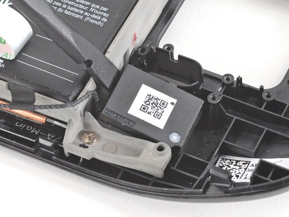

    27. Steam Deck Front Shell Replacement, Remove the right speaker: crwdns2935265:068crwdnd2935265:01crwdnd2935265:02crwdne2935265:0 Steam Deck Front Shell Replacement, Remove the right speaker: crwdns2935265:068crwdnd2935265:02crwdnd2935265:02crwdne2935265:0
      • Insert the flat end of a spudger between the right speaker and the frame.
      • Pivot the spudger up to separate the speaker from the light adhesive securing it against the front shell.
      • If the adhesive is stubborn, don't force the speaker out. Lightly heat it using an iOpener or a hair dryer to soften the adhesive underneath.

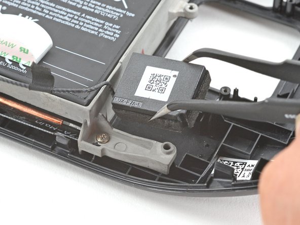

    28. Steam Deck Front Shell Replacement: crwdns2935265:069crwdnd2935265:01crwdnd2935265:02crwdne2935265:0 Steam Deck Front Shell Replacement: crwdns2935265:069crwdnd2935265:02crwdnd2935265:02crwdne2935265:0
      • Use a pair of tweezers to grip and remove the right speaker from its cavity.

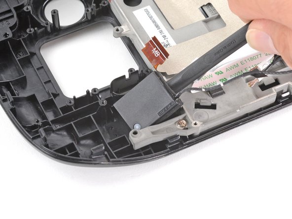

    29. Steam Deck Front Shell Replacement, Remove the left speaker: crwdns2935265:070crwdnd2935265:01crwdnd2935265:02crwdne2935265:0 Steam Deck Front Shell Replacement, Remove the left speaker: crwdns2935265:070crwdnd2935265:02crwdnd2935265:02crwdne2935265:0
      • Insert the flat end of a spudger between the left speaker and the frame.
    30. Steam Deck Front Shell Replacement: crwdns2935265:071crwdnd2935265:01crwdnd2935265:02crwdne2935265:0 Steam Deck Front Shell Replacement: crwdns2935265:071crwdnd2935265:02crwdnd2935265:02crwdne2935265:0
      • Use a pair of tweezers to grip and remove the left speaker from its cavity.
    31. Steam Deck Front Shell Replacement, Remove the speakers: crwdns2935265:072crwdnd2935265:01crwdnd2935265:01crwdne2935265:0
      • Remove the tethered right and left speakers.
    32. Steam Deck Front Shell Replacement, Uncover the display connector: crwdns2935265:073crwdnd2935265:01crwdnd2935265:02crwdne2935265:0 Steam Deck Front Shell Replacement, Uncover the display connector: crwdns2935265:073crwdnd2935265:02crwdnd2935265:02crwdne2935265:0
      • Use a pair of tweezers to peel back the sticker covering the display connector.
    33. Steam Deck Front Shell Replacement, Disconnect the display: crwdns2935265:074crwdnd2935265:01crwdnd2935265:03crwdne2935265:0 Steam Deck Front Shell Replacement, Disconnect the display: crwdns2935265:074crwdnd2935265:02crwdnd2935265:03crwdne2935265:0 Steam Deck Front Shell Replacement, Disconnect the display: crwdns2935265:074crwdnd2935265:03crwdnd2935265:03crwdne2935265:0

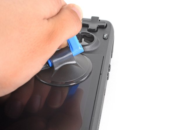

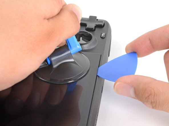

    35. Steam Deck Front Shell Replacement, Insert an opening pick: crwdns2935265:076crwdnd2935265:01crwdnd2935265:03crwdne2935265:0 Steam Deck Front Shell Replacement, Insert an opening pick: crwdns2935265:076crwdnd2935265:02crwdnd2935265:03crwdne2935265:0 Steam Deck Front Shell Replacement, Insert an opening pick: crwdns2935265:076crwdnd2935265:03crwdnd2935265:03crwdne2935265:0
      • Apply a suction cup to the top left corner of the display by pressing down on it to create suction, as close to the edge as possible.
      • If your screen is badly cracked, covering it with a layer of clear packing tape may allow the suction cup to adhere. Alternatively, very strong tape may be used instead of the suction cup. If all else fails, you can superglue the suction cup to the broken glass.
      • Pull up on the suction cup with strong, steady force to create a gap between the display and the frame.
      • Insert the point of an opening pick into the gap.
      • Don't insert the pick more than 1/8 of an inch (~3 mm) or you risk damaging the display panel, ambient light sensor, or fragile cable underneath.
    36. Steam Deck Front Shell Replacement, Begin to slice the adhesive: crwdns2935265:077crwdnd2935265:01crwdnd2935265:03crwdne2935265:0 Steam Deck Front Shell Replacement, Begin to slice the adhesive: crwdns2935265:077crwdnd2935265:02crwdnd2935265:03crwdne2935265:0 Steam Deck Front Shell Replacement, Begin to slice the adhesive: crwdns2935265:077crwdnd2935265:03crwdnd2935265:03crwdne2935265:0
      • Slide the opening pick no more than 3 mm deep across the top edge to slice the adhesive.

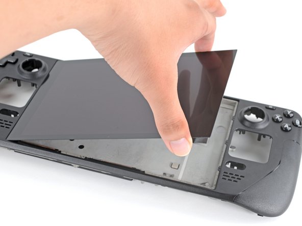

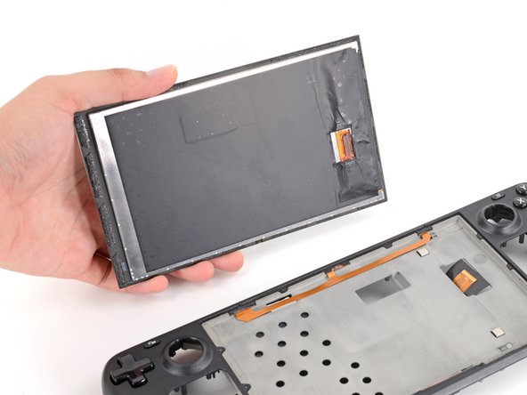

    42. Steam Deck Front Shell Replacement, Lift up the display: crwdns2935265:083crwdnd2935265:01crwdnd2935265:03crwdne2935265:0 Steam Deck Front Shell Replacement, Lift up the display: crwdns2935265:083crwdnd2935265:02crwdnd2935265:03crwdne2935265:0 Steam Deck Front Shell Replacement, Lift up the display: crwdns2935265:083crwdnd2935265:03crwdnd2935265:03crwdne2935265:0
      • Once you have sliced around the perimeter of the display, carefully lift the right edge up, opening it like a book.
      • Remove the display.
      • During reassembly, if you’d like to install new display adhesive strips, follow these steps after removing your old adhesive strips from your current display.

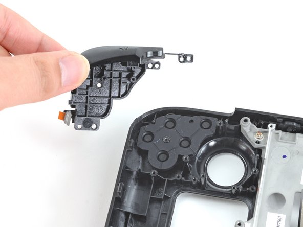

    43. Steam Deck Front Shell Replacement, Remove the bumper screws: crwdns2935265:084crwdnd2935265:01crwdnd2935265:01crwdne2935265:0
      • Use a Phillips driver to remove the two 5.2 mm screws securing the left bumper assembly.
    44. Steam Deck Front Shell Replacement, Remove the left bumper assembly: crwdns2935265:085crwdnd2935265:01crwdnd2935265:02crwdne2935265:0 Steam Deck Front Shell Replacement, Remove the left bumper assembly: crwdns2935265:085crwdnd2935265:02crwdnd2935265:02crwdne2935265:0
      • Remove the left bumper assembly.
    45. Steam Deck Front Shell Replacement, Remove the bumper screws: crwdns2935265:086crwdnd2935265:01crwdnd2935265:01crwdne2935265:0
      • Use a Phillips driver to remove the two 5.2 mm screws securing the right bumper assembly.
    46. Steam Deck Front Shell Replacement, Remove the right bumper assembly: crwdns2935265:087crwdnd2935265:01crwdnd2935265:02crwdne2935265:0 Steam Deck Front Shell Replacement, Remove the right bumper assembly: crwdns2935265:087crwdnd2935265:02crwdnd2935265:02crwdne2935265:0
      • Remove the right bumper assembly.

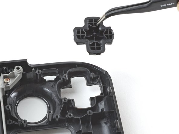

    47. Steam Deck Front Shell Replacement, Remove the D-pad membrane: crwdns2935265:088crwdnd2935265:01crwdnd2935265:02crwdne2935265:0 Steam Deck Front Shell Replacement, Remove the D-pad membrane: crwdns2935265:088crwdnd2935265:02crwdnd2935265:02crwdne2935265:0
      • Use a pair of tweezers to remove the D-pad membrane.
    48. Steam Deck Front Shell Replacement, Remove the D-pad: crwdns2935265:089crwdnd2935265:01crwdnd2935265:02crwdne2935265:0 Steam Deck Front Shell Replacement, Remove the D-pad: crwdns2935265:089crwdnd2935265:02crwdnd2935265:02crwdne2935265:0
      • Use a pair of tweezers to remove the D-pad.
      • During reassembly, align the D-pad button such that the short side is facing towards the Steam Deck's outer edge.

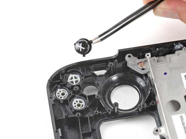

    50. Steam Deck Front Shell Replacement, Remove the action buttons: crwdns2935265:091crwdnd2935265:01crwdnd2935265:03crwdne2935265:0 Steam Deck Front Shell Replacement, Remove the action buttons: crwdns2935265:091crwdnd2935265:02crwdnd2935265:03crwdne2935265:0 Steam Deck Front Shell Replacement, Remove the action buttons: crwdns2935265:091crwdnd2935265:03crwdnd2935265:03crwdne2935265:0
      • Use a pair of tweezers to remove the four action buttons, A, B, X, and Y.
      • During reassembly, don't worry! The buttons are keyed—they can only be reinstalled in one orientation.

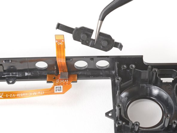

    51. Steam Deck Front Shell Replacement, Remove the view button: crwdns2935265:092crwdnd2935265:01crwdnd2935265:02crwdne2935265:0 Steam Deck Front Shell Replacement, Remove the view button: crwdns2935265:092crwdnd2935265:02crwdnd2935265:02crwdne2935265:0
      • Use a pair of tweezers to remove the view button.

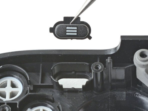

    52. Steam Deck Front Shell Replacement, Remove the menu button: crwdns2935265:093crwdnd2935265:01crwdnd2935265:02crwdne2935265:0 Steam Deck Front Shell Replacement, Remove the menu button: crwdns2935265:093crwdnd2935265:02crwdnd2935265:02crwdne2935265:0
      • Use a pair of tweezers to remove the menu button.

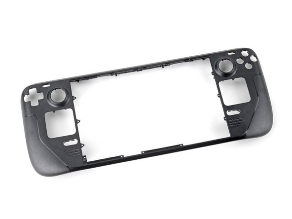

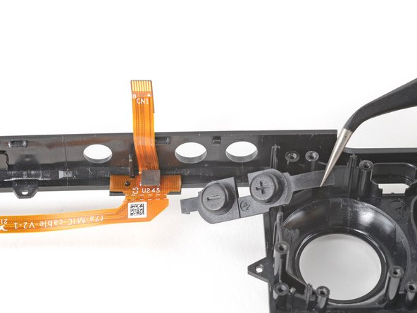

    53. Steam Deck Front Shell Replacement, Remove the front midframe screws: crwdns2935265:094crwdnd2935265:01crwdnd2935265:01crwdne2935265:0
      • Use a Phillips driver to remove the six 2.3 mm screws securing the midframe to the front shell, located on the front side.
      • To prevent these tight screws from stripping, apply firm downward force, work slowly and try a different Phillips driver if the screws won't come out.
    54. Steam Deck Front Shell Replacement, Remove the rear midframe screws: crwdns2935265:095crwdnd2935265:01crwdnd2935265:01crwdne2935265:0
      • Use a Phillips driver to remove the four 5.2 mm screws securing the midframe to the front shell.
    55. Steam Deck Front Shell Replacement, Remove the midframe: crwdns2935265:096crwdnd2935265:01crwdnd2935265:02crwdne2935265:0 Steam Deck Front Shell Replacement, Remove the midframe: crwdns2935265:096crwdnd2935265:02crwdnd2935265:02crwdne2935265:0
      • Remove the midframe.

      • Use the pointed end of a spudger to lift the rubber flap to the left of the volume buttons up and out of its plastic clip.
    57. Steam Deck Front Shell Replacement, Remove the volume buttons: crwdns2935265:098crwdnd2935265:01crwdnd2935265:03crwdne2935265:0 Steam Deck Front Shell Replacement, Remove the volume buttons: crwdns2935265:098crwdnd2935265:02crwdnd2935265:03crwdne2935265:0 Steam Deck Front Shell Replacement, Remove the volume buttons: crwdns2935265:098crwdnd2935265:03crwdnd2935265:03crwdne2935265:0
      • Use a pair of tweezers to remove the volume buttons by pulling them up and away from the front shell.
    58. Steam Deck Front Shell Replacement: crwdns2935265:099crwdnd2935265:01crwdnd2935265:02crwdne2935265:0 Steam Deck Front Shell Replacement: crwdns2935265:099crwdnd2935265:02crwdnd2935265:02crwdne2935265:0
      • Use the pointed end of a spudger to lift the rubber flap to the right of the power button up and out of its plastic clip.
    59. Steam Deck Front Shell Replacement, Remove the power button: crwdns2935265:0100crwdnd2935265:01crwdnd2935265:03crwdne2935265:0 Steam Deck Front Shell Replacement, Remove the power button: crwdns2935265:0100crwdnd2935265:02crwdnd2935265:03crwdne2935265:0 Steam Deck Front Shell Replacement, Remove the power button: crwdns2935265:0100crwdnd2935265:03crwdnd2935265:03crwdne2935265:0
      • Use the pointed end of a spudger to lift the rubber flap to the left of the power button up and out of its plastic clip.
      • Remove the power button.

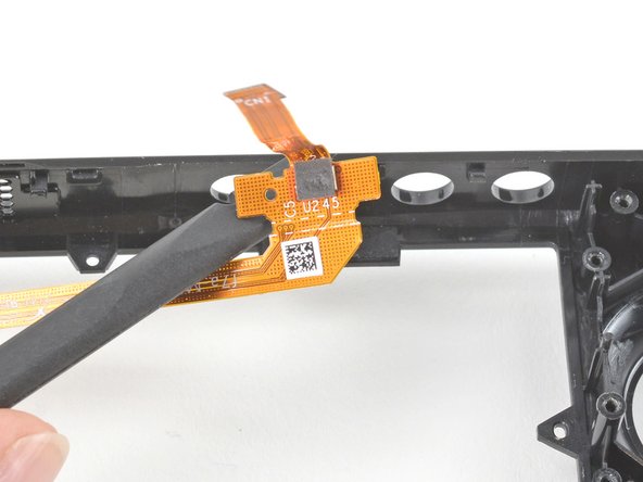

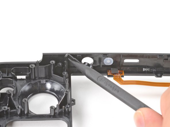

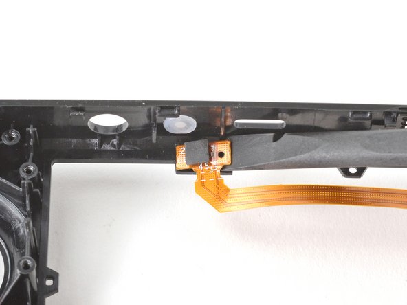

    60. Steam Deck Front Shell Replacement: crwdns2935265:0101crwdnd2935265:01crwdnd2935265:02crwdne2935265:0 Steam Deck Front Shell Replacement: crwdns2935265:0101crwdnd2935265:02crwdnd2935265:02crwdne2935265:0
      • Insert the flat end of a spudger under the left end of the mic cable and pry upwards to peel it up from the front shell.
      • The mic cable is secured to the front shell with some light adhesive.
      • If the adhesive is stubborn, don't force the cable. Lightly heat the mic cable using an iOpener or a hair dryer to soften the adhesive.
    61. Steam Deck Front Shell Replacement: crwdns2935265:0102crwdnd2935265:01crwdnd2935265:03crwdne2935265:0 Steam Deck Front Shell Replacement: crwdns2935265:0102crwdnd2935265:02crwdnd2935265:03crwdne2935265:0 Steam Deck Front Shell Replacement: crwdns2935265:0102crwdnd2935265:03crwdnd2935265:03crwdne2935265:0
      • Insert the flat end of a spudger under the right end of the mic cable and pry upwards to peel it up from the front shell.
    62. Steam Deck Front Shell Replacement, Remove the mic cable: crwdns2935265:0103crwdnd2935265:01crwdnd2935265:02crwdne2935265:0 Steam Deck Front Shell Replacement, Remove the mic cable: crwdns2935265:0103crwdnd2935265:02crwdnd2935265:02crwdne2935265:0
      • Remove the mic cable from the front shell.
      • Only the front shell remains.
