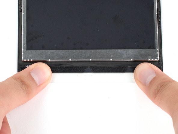

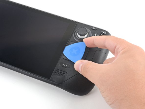

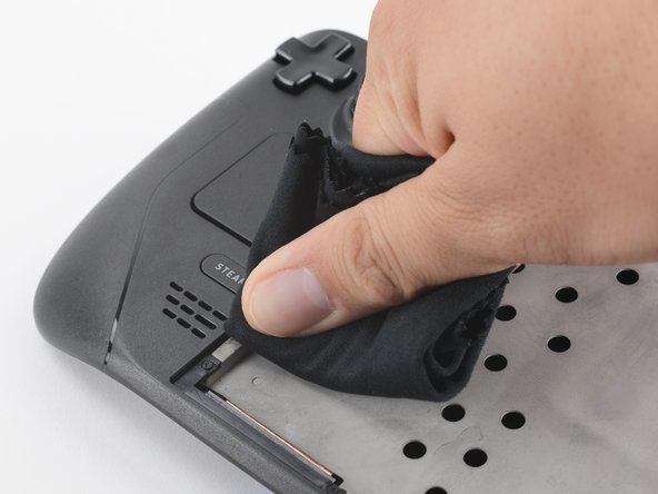

    1. Steam Deck Screen Replacement, Heat the display adhesive: crwdns2935265:027crwdnd2935265:01crwdnd2935265:01crwdne2935265:0
      • Prepare an iOpener and apply it to the top edge of the display for one minute.
      • A hair dryer or heat gun may also be used, but be careful not to overheat the Steam Deck—displays and internal batteries are both susceptible to heat damage.

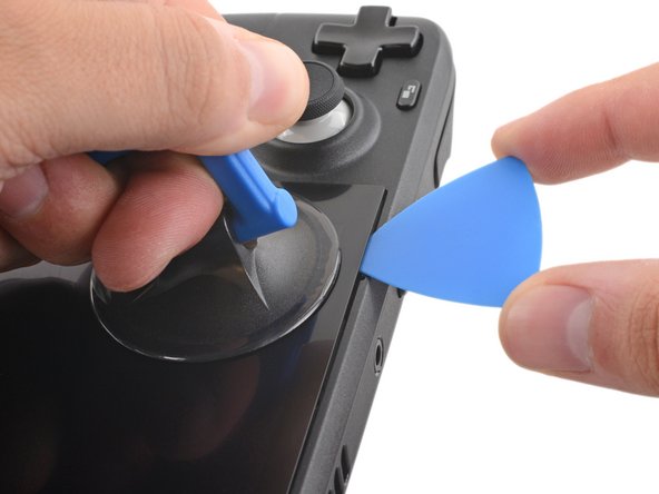

    2. Steam Deck Screen Replacement, Apply a suction cup: crwdns2935265:028crwdnd2935265:01crwdnd2935265:03crwdne2935265:0 Steam Deck Screen Replacement, Apply a suction cup: crwdns2935265:028crwdnd2935265:02crwdnd2935265:03crwdne2935265:0 Steam Deck Screen Replacement, Apply a suction cup: crwdns2935265:028crwdnd2935265:03crwdnd2935265:03crwdne2935265:0
      • Apply a suction cup to the top left corner of the display by pressing down on it to create suction, as close to the edge as possible.
      • If your screen is badly cracked, covering it with a layer of clear packing tape may allow the suction cup to adhere. Alternatively, very strong tape may be used instead of the suction cup. If all else fails, you can superglue the suction cup to the broken glass.
      • Glass shards can complicate disassembly—or worse, cause injury. If your Steam Deck has a cracked screen, consider wearing safety glasses to protect your eyes from any glass shaken free during the repair.

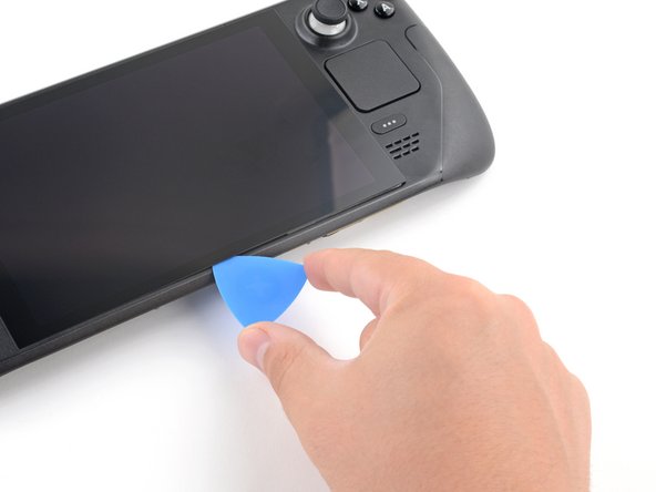

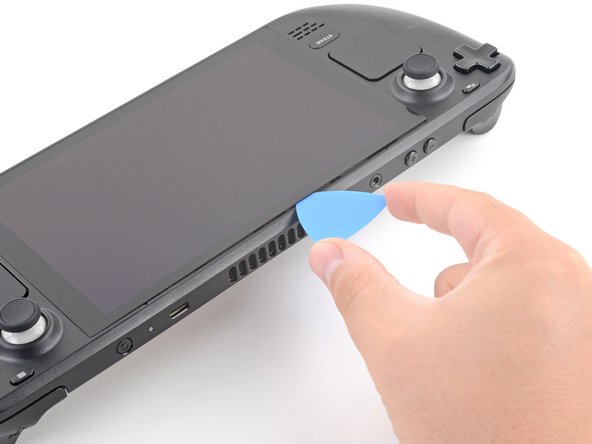

    3. Steam Deck Screen Replacement, Insert an opening pick: crwdns2935265:029crwdnd2935265:01crwdnd2935265:03crwdne2935265:0 Steam Deck Screen Replacement, Insert an opening pick: crwdns2935265:029crwdnd2935265:02crwdnd2935265:03crwdne2935265:0 Steam Deck Screen Replacement, Insert an opening pick: crwdns2935265:029crwdnd2935265:03crwdnd2935265:03crwdne2935265:0
      • Pull up on the suction cup with strong, steady force to create a gap between the display and the frame.
      • Insert the point of an opening pick into the gap.
      • Don't insert the pick more than 1/8 of an inch (~3 mm) or you risk damaging the display panel, ambient light sensor, or fragile cable underneath.

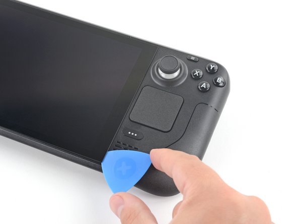

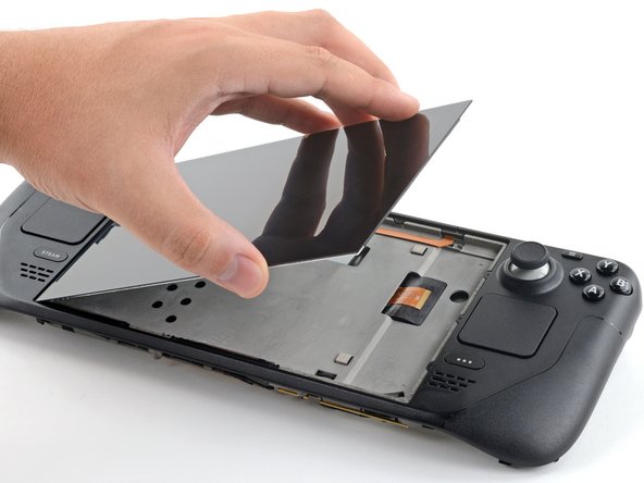

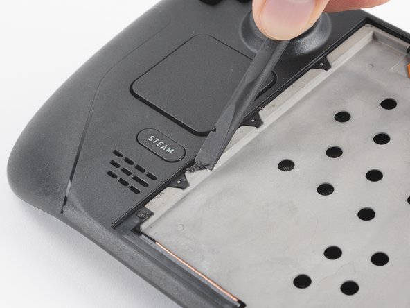

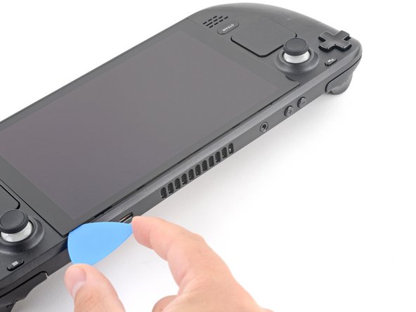

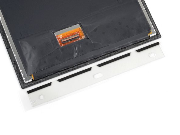

    4. Steam Deck Screen Replacement, Begin to slice the adhesive: crwdns2935265:030crwdnd2935265:01crwdnd2935265:03crwdne2935265:0 Steam Deck Screen Replacement, Begin to slice the adhesive: crwdns2935265:030crwdnd2935265:02crwdnd2935265:03crwdne2935265:0 Steam Deck Screen Replacement, Begin to slice the adhesive: crwdns2935265:030crwdnd2935265:03crwdnd2935265:03crwdne2935265:0
      • Slide the opening pick across the top edge to slice the adhesive.
    5. Steam Deck Screen Replacement, Heat the display adhesive: crwdns2935265:031crwdnd2935265:01crwdnd2935265:01crwdne2935265:0
      • Heat the right edge of the display for one minute.
    6. Steam Deck Screen Replacement, Slice the right side adhesive: crwdns2935265:032crwdnd2935265:01crwdnd2935265:03crwdne2935265:0 Steam Deck Screen Replacement, Slice the right side adhesive: crwdns2935265:032crwdnd2935265:02crwdnd2935265:03crwdne2935265:0 Steam Deck Screen Replacement, Slice the right side adhesive: crwdns2935265:032crwdnd2935265:03crwdnd2935265:03crwdne2935265:0
      • Slide the opening pick down the right edge to slice the adhesive.

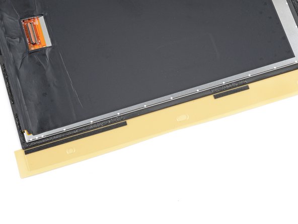

    7. Steam Deck Screen Replacement, Heat the display adhesive: crwdns2935265:033crwdnd2935265:01crwdnd2935265:01crwdne2935265:0
      • Heat the bottom edge of the display for one minute.
    8. Steam Deck Screen Replacement, Slice the bottom side adhesive: crwdns2935265:034crwdnd2935265:01crwdnd2935265:02crwdne2935265:0 Steam Deck Screen Replacement, Slice the bottom side adhesive: crwdns2935265:034crwdnd2935265:02crwdnd2935265:02crwdne2935265:0
      • Slide the opening pick across the bottom edge to slice the adhesive.
    9. Steam Deck Screen Replacement, Heat the display adhesive: crwdns2935265:035crwdnd2935265:01crwdnd2935265:01crwdne2935265:0
      • Heat the left edge of the display for one minute.
      • Slide the opening pick across the left edge to slice the adhesive.
    10. Steam Deck Screen Replacement, Lift up the display: crwdns2935265:036crwdnd2935265:01crwdnd2935265:03crwdne2935265:0 Steam Deck Screen Replacement, Lift up the display: crwdns2935265:036crwdnd2935265:02crwdnd2935265:03crwdne2935265:0 Steam Deck Screen Replacement, Lift up the display: crwdns2935265:036crwdnd2935265:03crwdnd2935265:03crwdne2935265:0
      • Once you have sliced around the perimeter of the display, carefully lift the right edge up, opening it like a book.
      • Remove the display.
    11. Steam Deck Screen Replacement, Identify the adhesive strips and their locations: crwdns2935265:037crwdnd2935265:01crwdnd2935265:03crwdne2935265:0 Steam Deck Screen Replacement, Identify the adhesive strips and their locations: crwdns2935265:037crwdnd2935265:02crwdnd2935265:03crwdne2935265:0 Steam Deck Screen Replacement, Identify the adhesive strips and their locations: crwdns2935265:037crwdnd2935265:03crwdnd2935265:03crwdne2935265:0
      • During reassembly:
      • Look over the new display adhesive and match each strip to its respective side of the display.
    12. Steam Deck Screen Replacement, Prepare the surfaces: crwdns2935265:038crwdnd2935265:01crwdnd2935265:02crwdne2935265:0 Steam Deck Screen Replacement, Prepare the surfaces: crwdns2935265:038crwdnd2935265:02crwdnd2935265:02crwdne2935265:0
      • To ensure a good adhesive bond, thoroughly clean all adhesion surfaces.
      • Remove large chunks of adhesives with the flat end of a spudger or plastic opening tool.
      • Don't use metal tools, as they can scratch the surface.
    13. Steam Deck Screen Replacement: crwdns2935265:039crwdnd2935265:01crwdnd2935265:02crwdne2935265:0 Steam Deck Screen Replacement: crwdns2935265:039crwdnd2935265:02crwdnd2935265:02crwdne2935265:0
      • Use adhesive remover or isopropyl alcohol (>90%) to remove any remaining residue. Wipe in one direction with a lint-free cloth or coffee filter until all the adhesive residue is gone.
      • While isopropyl alcohol is generally safe to use on electronics, they will dissolve certain foam adhesives. Be careful to contain the alcohol when cleaning—don't use too much.
      • Allow any leftover isopropyl alcohol to completely evaporate before reassembly.

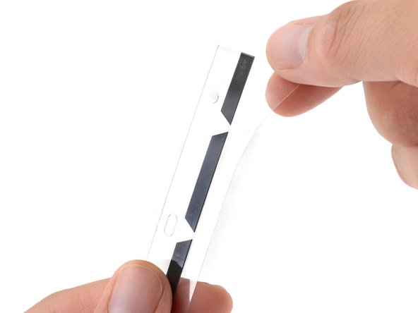

    14. Steam Deck Screen Replacement, Remove the adhesive liner: crwdns2935265:040crwdnd2935265:01crwdnd2935265:02crwdne2935265:0 Steam Deck Screen Replacement, Remove the adhesive liner: crwdns2935265:040crwdnd2935265:02crwdnd2935265:02crwdne2935265:0
      • Before you peel any liners, locate the surface the sticky side should adhere to.
      • Once you have a good idea of where the adhesive strip goes, peel off and discard the liner, exposing the adhesive underneath.
      • Be careful with exposed adhesives. Most of the time, you can't peel and reapply adhesive strips if they're stuck to the wrong spot.

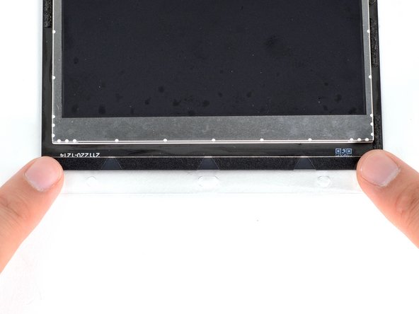

    15. Steam Deck Screen Replacement, Align and place the adhesive strips: crwdns2935265:041crwdnd2935265:01crwdnd2935265:03crwdne2935265:0 Steam Deck Screen Replacement, Align and place the adhesive strips: crwdns2935265:041crwdnd2935265:02crwdnd2935265:03crwdne2935265:0 Steam Deck Screen Replacement, Align and place the adhesive strips: crwdns2935265:041crwdnd2935265:03crwdnd2935265:03crwdne2935265:0
      • Hold the exposed strip by its tabs and carefully line up the edge of the adhesive to the outer edge of display.
      • Use your old display as a reference for where the new adhesive strips should be applied on the new display’s edges.
      • Be careful with alignment. Most of the time, you can't peel and reapply adhesive strips if they stick misaligned.
      • Set the adhesive onto the surface and press firmly with your fingers to set it in place.
      • Repeat the previous two steps for the three other display adhesive strips.
    16. Steam Deck Screen Replacement, Peel off the last adhesive liners: crwdns2935265:042crwdnd2935265:01crwdnd2935265:01crwdne2935265:0
      • Peel off and discard the remaining plastic liners on all four strips, exposing the adhesive underneath.
      • Repeat for all four display adhesive strips, being careful not to touch any exposed adhesives.

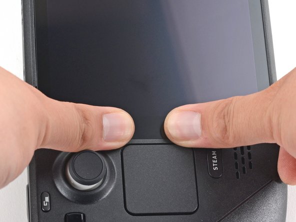

    17. Steam Deck Screen Replacement, Install the new display: crwdns2935265:043crwdnd2935265:01crwdnd2935265:02crwdne2935265:0 Steam Deck Screen Replacement, Install the new display: crwdns2935265:043crwdnd2935265:02crwdnd2935265:02crwdne2935265:0
      • Set the new display in place on the midframe and press firmly along the edges for 20-30 seconds to ensure a good adhesive bond.
