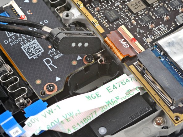

    7. Steam Deck Quick Access Button Replacement, Disconnect the right haptics: crwdns2935265:019crwdnd2935265:01crwdnd2935265:03crwdne2935265:0 Steam Deck Quick Access Button Replacement, Disconnect the right haptics: crwdns2935265:019crwdnd2935265:02crwdnd2935265:03crwdne2935265:0 Steam Deck Quick Access Button Replacement, Disconnect the right haptics: crwdns2935265:019crwdnd2935265:03crwdnd2935265:03crwdne2935265:0
      • Exercise caution when lifting this connector—pry up on the connector itself, not its housing.
      • Use the pointed end of a spudger to lift up on the haptics cable to disconnect it.
      • Alternatively, you can leave the haptics connected to the button board and flip the board up and over the edge of the shell and out of the way.
    8. Steam Deck Quick Access Button Replacement, Remove the button board screws: crwdns2935265:020crwdnd2935265:01crwdnd2935265:01crwdne2935265:0
      • Use a Phillips driver to disconnect the four screws securing the right button board:
      • Three 5.2 mm screws
      • One 3.9 mm screw
    9. Steam Deck Quick Access Button Replacement, Remove the button board: crwdns2935265:021crwdnd2935265:01crwdnd2935265:02crwdne2935265:0 Steam Deck Quick Access Button Replacement, Remove the button board: crwdns2935265:021crwdnd2935265:02crwdnd2935265:02crwdne2935265:0
      • Remove the right button board.
      • Keep track of the quick access button and its membrane, as once the right button board is removed, they're no longer secured in place.
