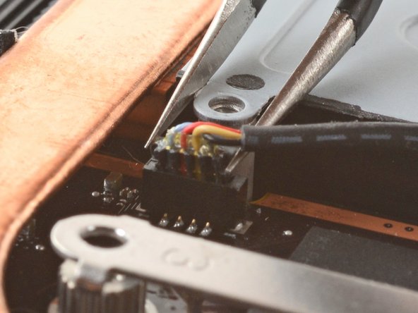

    1. Steam Deck Fan Replacement, Disconnect the fan: crwdns2935265:010crwdnd2935265:01crwdnd2935265:03crwdne2935265:0 Steam Deck Fan Replacement, Disconnect the fan: crwdns2935265:010crwdnd2935265:02crwdnd2935265:03crwdne2935265:0 Steam Deck Fan Replacement, Disconnect the fan: crwdns2935265:010crwdnd2935265:03crwdnd2935265:03crwdne2935265:0
      • Use a pair of tweezers to grip the edges of the fan connector and pull up to disconnect it from the motherboard.
      • Pull the fan cable by its connector, not the wires themselves.
      • During reassembly, be gentle while plugging in the fan connector.
      • If the connector is misaligned, the use of too much force can damage the fragile internal pins.
