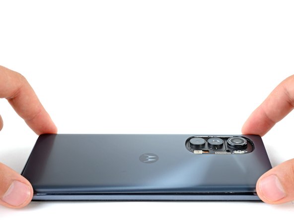

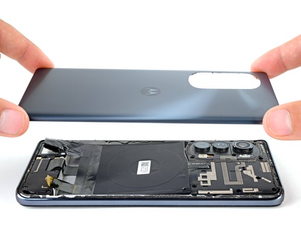

    13. Motorola Edge (2022) Display Replacement, Remove the back cover: crwdns2935265:013crwdnd2935265:01crwdnd2935265:02crwdne2935265:0 Motorola Edge (2022) Display Replacement, Remove the back cover: crwdns2935265:013crwdnd2935265:02crwdnd2935265:02crwdne2935265:0
      • Lift the back cover from the phone and remove it.
      • If the back cover is still stuck to the midframe, slide an opening pick around the edges of the phone until the cover separates completely.

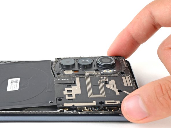

    1. Motorola Edge (2022) Display Replacement, Separate the camera bezel adhesive: crwdns2935265:014crwdnd2935265:01crwdnd2935265:02crwdne2935265:0 Motorola Edge (2022) Display Replacement, Separate the camera bezel adhesive: crwdns2935265:014crwdnd2935265:02crwdnd2935265:02crwdne2935265:0
      • Insert an opening pick between the right edge of the camera bezel and the motherboard cover.
      • Slide the pick back and forth along the edge to slice the adhesive.
    2. Motorola Edge (2022) Display Replacement: crwdns2935265:015crwdnd2935265:01crwdnd2935265:02crwdne2935265:0 Motorola Edge (2022) Display Replacement: crwdns2935265:015crwdnd2935265:02crwdnd2935265:02crwdne2935265:0
      • Insert an opening pick between the left edge of the camera bezel and the motherboard cover.
    3. Motorola Edge (2022) Display Replacement, Remove the camera bezel: crwdns2935265:016crwdnd2935265:01crwdnd2935265:02crwdne2935265:0 Motorola Edge (2022) Display Replacement, Remove the camera bezel: crwdns2935265:016crwdnd2935265:02crwdnd2935265:02crwdne2935265:0
      • Lift the camera bezel from the phone and remove it.

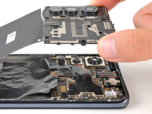

    9. Motorola Edge (2022) Display Replacement, Remove the motherboard cover: crwdns2935265:022crwdnd2935265:01crwdnd2935265:03crwdne2935265:0 Motorola Edge (2022) Display Replacement, Remove the motherboard cover: crwdns2935265:022crwdnd2935265:02crwdnd2935265:03crwdne2935265:0 Motorola Edge (2022) Display Replacement, Remove the motherboard cover: crwdns2935265:022crwdnd2935265:03crwdnd2935265:03crwdne2935265:0
      • Slowly pull the motherboard cover up and away from the phone and remove it.

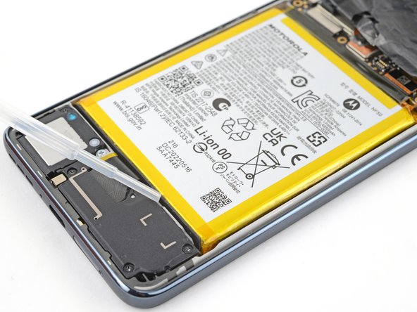

    1. Motorola Edge (2022) Display Replacement, Apply isopropyl alcohol: crwdns2935265:025crwdnd2935265:01crwdnd2935265:02crwdne2935265:0 Motorola Edge (2022) Display Replacement, Apply isopropyl alcohol: crwdns2935265:025crwdnd2935265:02crwdnd2935265:02crwdne2935265:0
      • Apply a few drops of high-concentration (90% or higher) isopropyl alcohol to the gaps along the battery's edges.
      • Tilt the device as you apply alcohol to help it flow under the battery.
      • Wait one minute to allow the isopropyl alcohol to penetrate the adhesive.
      • Only apply a few drops initially and apply more as necessary. If you apply too much alcohol, it may overflow onto the motherboard and daughterboard.

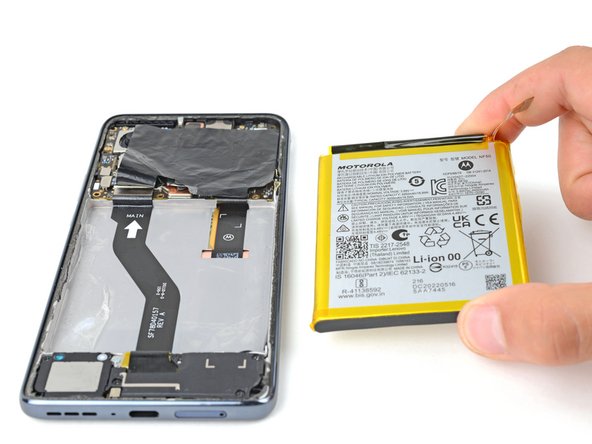

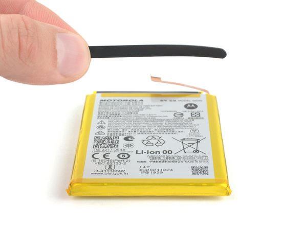

    3. Motorola Edge (2022) Display Replacement, Remove the battery: crwdns2935265:027crwdnd2935265:01crwdnd2935265:02crwdne2935265:0 Motorola Edge (2022) Display Replacement, Remove the battery: crwdns2935265:027crwdnd2935265:02crwdnd2935265:02crwdne2935265:0
      • Remove the battery from the midframe.
      • Do not reuse the battery if it has been deformed or damaged, as doing so is a potential safety hazard. Replace it with a new battery.
      • Follow this guide to install new battery adhesive.

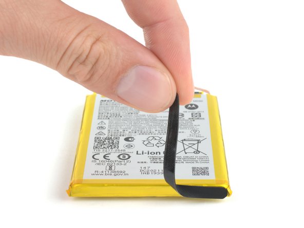

    4. Motorola Edge (2022) Display Replacement, Transfer the battery's foam strip: crwdns2935265:028crwdnd2935265:01crwdnd2935265:03crwdne2935265:0 Motorola Edge (2022) Display Replacement, Transfer the battery's foam strip: crwdns2935265:028crwdnd2935265:02crwdnd2935265:03crwdne2935265:0 Motorola Edge (2022) Display Replacement, Transfer the battery's foam strip: crwdns2935265:028crwdnd2935265:03crwdnd2935265:03crwdne2935265:0
      • Use tweezers or your fingers to remove the foam strip from the battery's bottom edge.
      • Before installing your new battery, apply the foam strip to it.

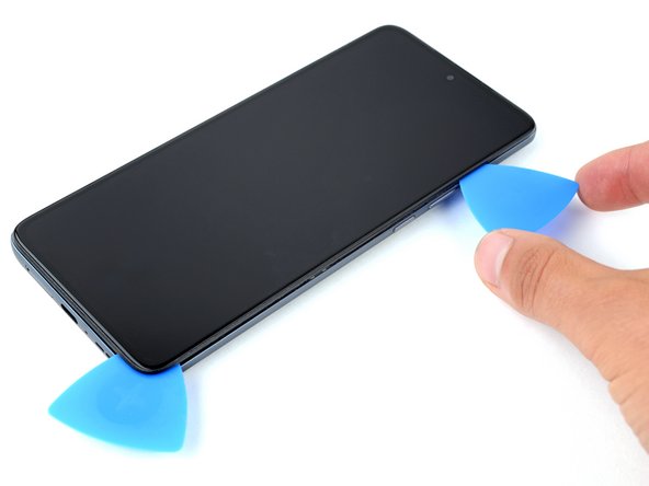

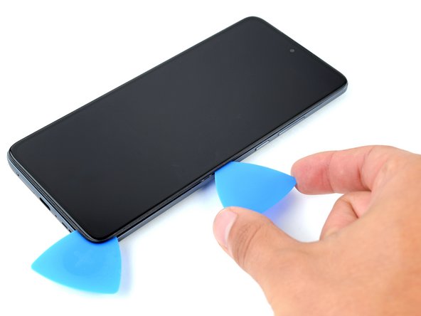

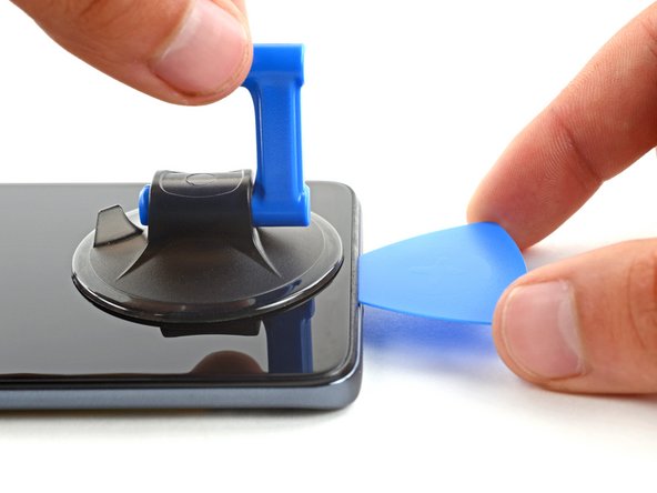

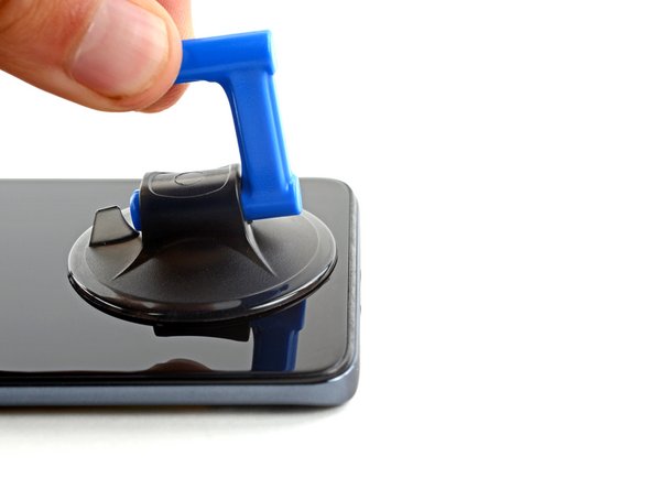

    4. Motorola Edge (2022) Display Replacement, Insert an opening pick: crwdns2935265:032crwdnd2935265:01crwdnd2935265:03crwdne2935265:0 Motorola Edge (2022) Display Replacement, Insert an opening pick: crwdns2935265:032crwdnd2935265:02crwdnd2935265:03crwdne2935265:0 Motorola Edge (2022) Display Replacement, Insert an opening pick: crwdns2935265:032crwdnd2935265:03crwdnd2935265:03crwdne2935265:0
      • Once the display is hot to the touch, apply a suction handle to the bottom of the display as close to the edge as possible.
      • If your display is badly cracked, covering it with a layer of clear packing tape may allow the suction cup to adhere. Alternatively, very strong tape may be used instead of the suction handle. If all else fails, you can superglue the suction cup to the display.
      • Pull up on the suction handle with a strong, steady force to create a small gap between the display and the frame.
      • The display adhesive is very strong, so this may take multiple attempts. If you're having trouble, reheat the display and try again.
      • Insert an opening pick into the gap between the frame and the display.
      • Do not insert more than 3 mm of the pick to avoid damaging the display ribbon cable.
    5. Motorola Edge (2022) Display Replacement: crwdns2935265:033crwdnd2935265:01crwdnd2935265:03crwdne2935265:0 Motorola Edge (2022) Display Replacement: crwdns2935265:033crwdnd2935265:02crwdnd2935265:03crwdne2935265:0 Motorola Edge (2022) Display Replacement: crwdns2935265:033crwdnd2935265:03crwdnd2935265:03crwdne2935265:0
      • When slicing the bottom adhesive, don't insert the opening pick more than 3 mm to avoid damaging the fingerprint sensor.
      • Slide the opening pick along the bottom edge of the phone to slice the adhesive.
      • Leave the pick inserted in the bottom right corner to prevent the adhesive from resealing.

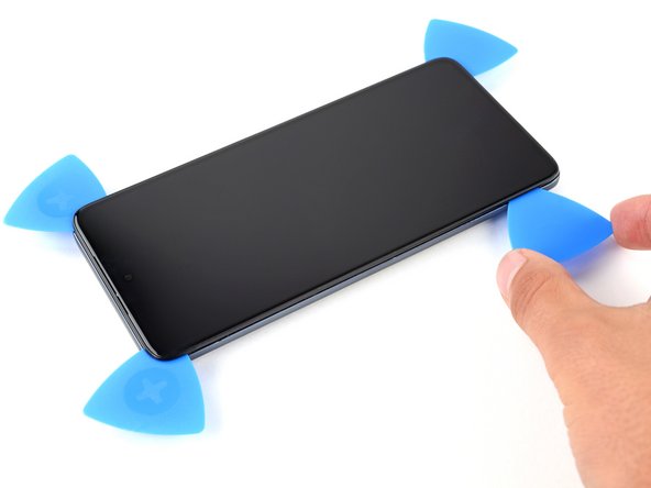

    6. Motorola Edge (2022) Display Replacement: crwdns2935265:034crwdnd2935265:01crwdnd2935265:03crwdne2935265:0 Motorola Edge (2022) Display Replacement: crwdns2935265:034crwdnd2935265:02crwdnd2935265:03crwdne2935265:0 Motorola Edge (2022) Display Replacement: crwdns2935265:034crwdnd2935265:03crwdnd2935265:03crwdne2935265:0
      • Don't insert the opening pick more than 6 mm to avoid damaging the heat spreader.
      • Insert a second opening pick near the bottom right corner and slide it along the right edge to slice the adhesive.
      • Leave the pick inserted in the top right corner to prevent the adhesive from resealing.

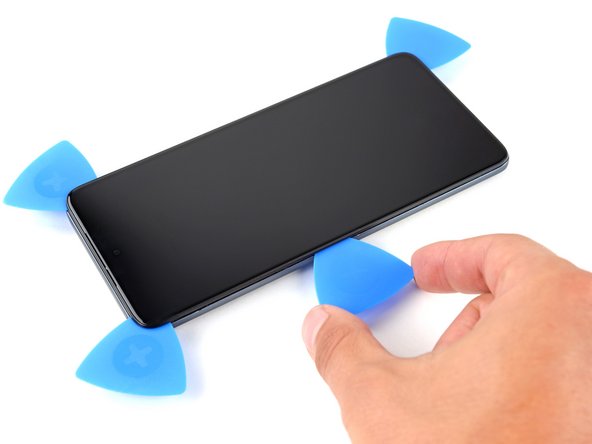

    7. Motorola Edge (2022) Display Replacement: crwdns2935265:035crwdnd2935265:01crwdnd2935265:03crwdne2935265:0 Motorola Edge (2022) Display Replacement: crwdns2935265:035crwdnd2935265:02crwdnd2935265:03crwdne2935265:0 Motorola Edge (2022) Display Replacement: crwdns2935265:035crwdnd2935265:03crwdnd2935265:03crwdne2935265:0
      • Insert a third opening pick at the top right corner of the display.
      • When slicing near the front facing camera, don't insert the opening pick more than 2 mm to avoid damaging the earpiece speaker cutout and the front camera.
      • Slide the opening pick along the top edge of the phone to slice the adhesive.
      • Leave the opening pick inserted in the top left corner to prevent the adhesive from resealing.

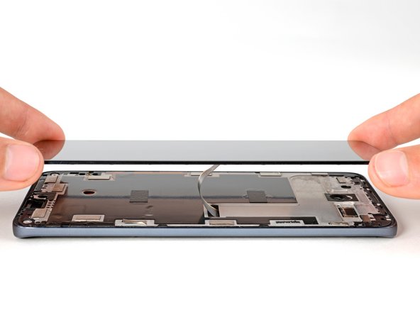

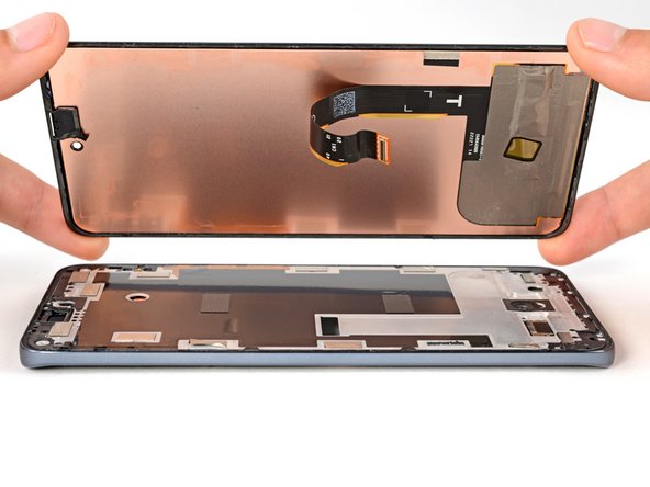

    8. Motorola Edge (2022) Display Replacement: crwdns2935265:036crwdnd2935265:01crwdnd2935265:03crwdne2935265:0 Motorola Edge (2022) Display Replacement: crwdns2935265:036crwdnd2935265:02crwdnd2935265:03crwdne2935265:0 Motorola Edge (2022) Display Replacement: crwdns2935265:036crwdnd2935265:03crwdnd2935265:03crwdne2935265:0
      • Insert a fourth opening pick in the top left corner of the display.
      • Don't insert the pick more than 2 mm to avoid damaging the heat spreader and the fingerprint sensor.
      • Slide the pick along the left edge to slice the adhesive.
      • The screen should be detached at this point.
    9. Motorola Edge (2022) Display Replacement, Remove the back cover: crwdns2935265:037crwdnd2935265:01crwdnd2935265:02crwdne2935265:0 Motorola Edge (2022) Display Replacement, Remove the back cover: crwdns2935265:037crwdnd2935265:02crwdnd2935265:02crwdne2935265:0

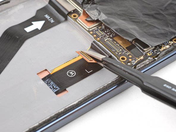

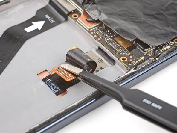

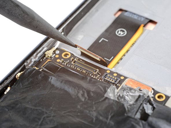

    11. Motorola Edge (2022) Display Replacement: crwdns2935265:039crwdnd2935265:01crwdnd2935265:02crwdne2935265:0 Motorola Edge (2022) Display Replacement: crwdns2935265:039crwdnd2935265:02crwdnd2935265:02crwdne2935265:0
      • Use the pointed end of a spudger to pry up and disconnect the display cable's press connector.
    12. Motorola Edge (2022) Display Replacement, Loosen the display cable adhesive: crwdns2935265:040crwdnd2935265:01crwdnd2935265:01crwdne2935265:0
    13. Motorola Edge (2022) Display Replacement, Separate the cable adhesive: crwdns2935265:041crwdnd2935265:01crwdnd2935265:03crwdne2935265:0 Motorola Edge (2022) Display Replacement, Separate the cable adhesive: crwdns2935265:041crwdnd2935265:02crwdnd2935265:03crwdne2935265:0 Motorola Edge (2022) Display Replacement, Separate the cable adhesive: crwdns2935265:041crwdnd2935265:03crwdnd2935265:03crwdne2935265:0
      • Use tweezers to grip the display cable just below the press connector.
      • Gently pull the display cable towards the bottom of the phone until it's freed from its space under the motherboard.
      • Continue pulling the cable to separate its adhesive.
    14. Motorola Edge (2022) Display Replacement, Remove the display: crwdns2935265:042crwdnd2935265:01crwdnd2935265:03crwdne2935265:0 Motorola Edge (2022) Display Replacement, Remove the display: crwdns2935265:042crwdnd2935265:02crwdnd2935265:03crwdne2935265:0 Motorola Edge (2022) Display Replacement, Remove the display: crwdns2935265:042crwdnd2935265:03crwdnd2935265:03crwdne2935265:0
      • The display may have lightly readhered to the frame during the last few steps. If it has, use an opening pick to detach the display from the frame before continuing.
      • Before removing the display, make sure that the display's ribbon cable is completely detached from the adhesive on the midframe.
      • Gently pull up on the display and thread the ribbon cable through the hole in midframe to remove the display.
