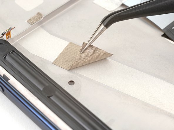

    4. Motorola Edge (2022) Screen Replacement, Detach the left wireless charging coil tape: crwdns2935265:018crwdnd2935265:01crwdnd2935265:02crwdne2935265:0 Motorola Edge (2022) Screen Replacement, Detach the left wireless charging coil tape: crwdns2935265:018crwdnd2935265:02crwdnd2935265:02crwdne2935265:0
      • Insert the pointed end of a spudger underneath the tape that connects the wireless charging coil to the speaker on the bottom left of the phone.
      • Slowly lift the spudger up until the tape detaches from the speaker.
    5. Motorola Edge (2022) Screen Replacement, Detach the right wireless charging coil tape: crwdns2935265:019crwdnd2935265:01crwdnd2935265:02crwdne2935265:0 Motorola Edge (2022) Screen Replacement, Detach the right wireless charging coil tape: crwdns2935265:019crwdnd2935265:02crwdnd2935265:02crwdne2935265:0
      • Insert a spudger underneath the tape that connects the wireless charging coil to the daughterboard cover on the bottom right of the phone.
      • Slowly lift the spudger up until the tape detaches.

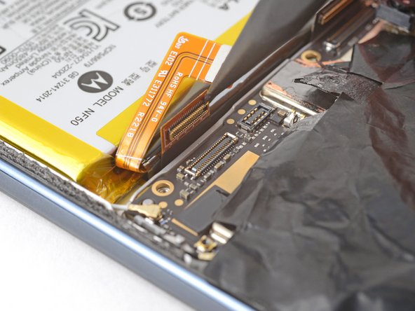

    2. Motorola Edge (2022) Screen Replacement, Disconnect the battery: crwdns2935265:025crwdnd2935265:01crwdnd2935265:02crwdne2935265:0 Motorola Edge (2022) Screen Replacement, Disconnect the battery: crwdns2935265:025crwdnd2935265:02crwdnd2935265:02crwdne2935265:0
      • Use the pointed end of a spudger to pry up and disconnect the battery's press connector.
      • To re-attach press connectors like this one, carefully align and press down on one side until it clicks into place, then repeat on the other side. Do not press down on the middle. If the connector is misaligned, the pins can bend, causing permanent damage.

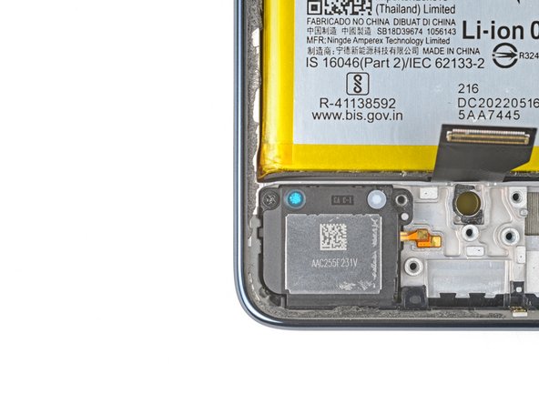

    1. Motorola Edge (2022) Screen Replacement, Unfasten the daughterboard cover: crwdns2935265:026crwdnd2935265:01crwdnd2935265:02crwdne2935265:0 Motorola Edge (2022) Screen Replacement, Unfasten the daughterboard cover: crwdns2935265:026crwdnd2935265:02crwdnd2935265:02crwdne2935265:0
      • Use a Phillips screwdriver to remove the five screws securing the daughterboard cover:
      • Four 4.1 mm screws
      • One 3 mm screw
    2. Motorola Edge (2022) Screen Replacement, Release the daughterboard cover clips: crwdns2935265:027crwdnd2935265:01crwdnd2935265:02crwdne2935265:0 Motorola Edge (2022) Screen Replacement, Release the daughterboard cover clips: crwdns2935265:027crwdnd2935265:02crwdnd2935265:02crwdne2935265:0
      • Insert a spudger under the daughterboard cover on the bottom right corner of the phone.
      • Pry up with the spudger to release the clips securing the cover.
    3. Motorola Edge (2022) Screen Replacement, Remove the daughterboard cover: crwdns2935265:028crwdnd2935265:01crwdnd2935265:02crwdne2935265:0 Motorola Edge (2022) Screen Replacement, Remove the daughterboard cover: crwdns2935265:028crwdnd2935265:02crwdnd2935265:02crwdne2935265:0
      • Use your fingers or tweezers to remove daughterboard cover.

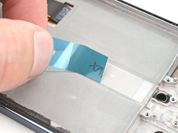

    5. Motorola Edge (2022) Screen Replacement: crwdns2935265:030crwdnd2935265:01crwdnd2935265:03crwdne2935265:0 Motorola Edge (2022) Screen Replacement: crwdns2935265:030crwdnd2935265:02crwdnd2935265:03crwdne2935265:0 Motorola Edge (2022) Screen Replacement: crwdns2935265:030crwdnd2935265:03crwdnd2935265:03crwdne2935265:0
      • Use your fingers or tweezers to peel back and remove the tape on the fingerprint sensor cover.
      • Set the tape aside for reassembly.

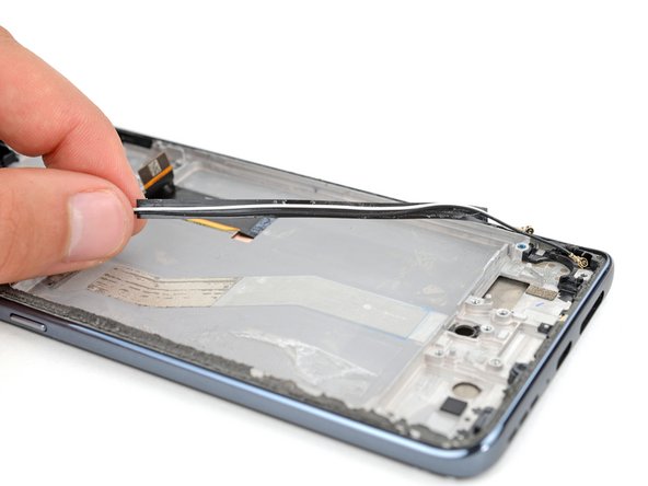

    9. Motorola Edge (2022) Screen Replacement: crwdns2935265:034crwdnd2935265:01crwdnd2935265:03crwdne2935265:0 Motorola Edge (2022) Screen Replacement: crwdns2935265:034crwdnd2935265:02crwdnd2935265:03crwdne2935265:0 Motorola Edge (2022) Screen Replacement: crwdns2935265:034crwdnd2935265:03crwdnd2935265:03crwdne2935265:0
      • Use the pointed end of a spudger to pry up and disconnect the black antenna's coaxial connector.
      • Pry under the rounded edge of the coaxial connector, not the straight edge. If you pry under the straight edge, you may rip the socket off the daughterboard.
      • Use the spudger to push the antenna up and away from the phone until the cable is freed from the clip securing it to the daughterboard.
      • During reassembly, make sure the cable's metal band connects to the grounding clip in the daughterboard.
      • To re-attach coaxial connectors like this one, hold the connectors in place and gently press them straight down with your finger or the pointed end of a spudger.
    10. Motorola Edge (2022) Screen Replacement: crwdns2935265:035crwdnd2935265:01crwdnd2935265:03crwdne2935265:0 Motorola Edge (2022) Screen Replacement: crwdns2935265:035crwdnd2935265:02crwdnd2935265:03crwdne2935265:0 Motorola Edge (2022) Screen Replacement: crwdns2935265:035crwdnd2935265:03crwdnd2935265:03crwdne2935265:0
      • Repeat the previous step for the white antenna cable.
      • During reassembly, make sure to put the cable back in its clip on the daughterboard.

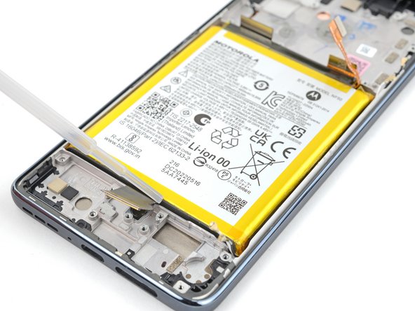

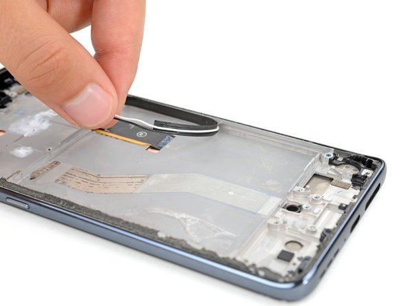

    1. Motorola Edge (2022) Screen Replacement, Pry and remove the fingerprint sensor: crwdns2935265:038crwdnd2935265:01crwdnd2935265:03crwdne2935265:0 Motorola Edge (2022) Screen Replacement, Pry and remove the fingerprint sensor: crwdns2935265:038crwdnd2935265:02crwdnd2935265:03crwdne2935265:0 Motorola Edge (2022) Screen Replacement, Pry and remove the fingerprint sensor: crwdns2935265:038crwdnd2935265:03crwdnd2935265:03crwdne2935265:0
      • Use the flat side of a spudger to pry the fingerprint sensor from the frame.
      • A small amount of adhesive secures the fingerprint sensor to the frame, so this may take a few tries and some force.
      • Use your fingers or tweezers to remove the fingerprint sensor from the phone.
      • Apply new adhesive to the frame before installing the fingerprint sensor.

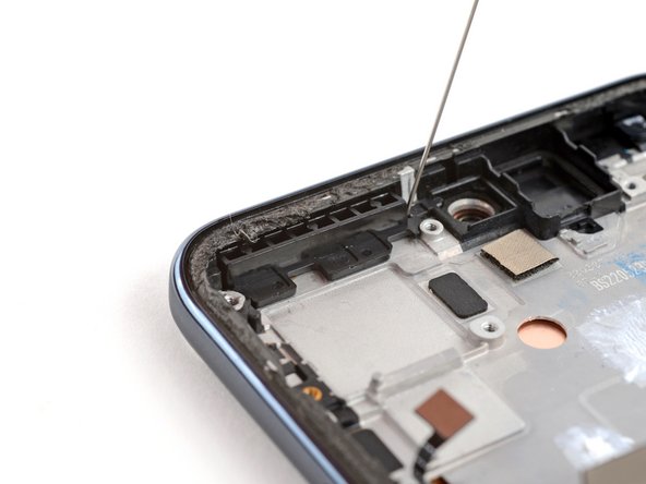

    1. Motorola Edge (2022) Screen Replacement, Apply isopropyl alcohol: crwdns2935265:039crwdnd2935265:01crwdnd2935265:01crwdne2935265:0
      • Apply a few drops of high-concentration (90% or higher) isopropyl alcohol under the vibration motor and its contact pad to loosen the adhesive securing them.
      • Wait one minute to allow the isopropyl alcohol to penetrate the adhesive.
    2. Motorola Edge (2022) Screen Replacement, Pry the vibration motor: crwdns2935265:040crwdnd2935265:01crwdnd2935265:02crwdne2935265:0 Motorola Edge (2022) Screen Replacement, Pry the vibration motor: crwdns2935265:040crwdnd2935265:02crwdnd2935265:02crwdne2935265:0
      • Insert the pointed end of a spudger in the gap between the vibration motor and frame.
      • Pry up with the spudger to separate the vibration motor from the frame.
    3. Motorola Edge (2022) Screen Replacement, Remove the vibration motor: crwdns2935265:041crwdnd2935265:01crwdnd2935265:02crwdne2935265:0 Motorola Edge (2022) Screen Replacement, Remove the vibration motor: crwdns2935265:041crwdnd2935265:02crwdnd2935265:02crwdne2935265:0
      • Use your fingers or tweezers to remove the vibration motor.
      • The vibration motor's flex cable is very fragile. Work slowly to prevent tearing the cable.
      • If there's any alcohol remaining, use a lint-free cloth to wipe it up or allow the alcohol to dry off before installing a new vibration motor.
      • Apply new adhesive to your vibration motor before installing it in the frame.

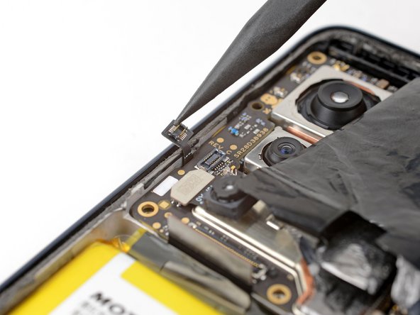

    1. Motorola Edge (2022) Screen Replacement, Disconnect the interconnect cable: crwdns2935265:042crwdnd2935265:01crwdnd2935265:02crwdne2935265:0 Motorola Edge (2022) Screen Replacement, Disconnect the interconnect cable: crwdns2935265:042crwdnd2935265:02crwdnd2935265:02crwdne2935265:0
      • Use the pointed end of a spudger to pry up and disconnect the interconnect cable's press connector.
    2. Motorola Edge (2022) Screen Replacement, Disconnect the screen cable: crwdns2935265:043crwdnd2935265:01crwdnd2935265:02crwdne2935265:0 Motorola Edge (2022) Screen Replacement, Disconnect the screen cable: crwdns2935265:043crwdnd2935265:02crwdnd2935265:02crwdne2935265:0
      • Use the pointed end of a spudger to pry up and disconnect the screen's press connector.
    3. Motorola Edge (2022) Screen Replacement, Disconnect the button assembly cable: crwdns2935265:044crwdnd2935265:01crwdnd2935265:02crwdne2935265:0 Motorola Edge (2022) Screen Replacement, Disconnect the button assembly cable: crwdns2935265:044crwdnd2935265:02crwdnd2935265:02crwdne2935265:0
      • Use the pointed end of a spudger to pry up and disconnect the button assembly's press connector.
    4. Motorola Edge (2022) Screen Replacement, Disconnect the white coaxial cable: crwdns2935265:045crwdnd2935265:01crwdnd2935265:02crwdne2935265:0 Motorola Edge (2022) Screen Replacement, Disconnect the white coaxial cable: crwdns2935265:045crwdnd2935265:02crwdnd2935265:02crwdne2935265:0
      • Use the pointed end of a spudger to pry up and disconnect the white antenna's coaxial connector.
      • Pry under the rounded edge of the coaxial connector, not the straight edge. If you pry under the straight edge you may rip the socket off of the motherboard.
      • During reassembly, make sure to put the cable back in its clip on the motherboard.

    1. Motorola Edge (2022) Screen Replacement, Unfasten the loudspeaker: crwdns2935265:050crwdnd2935265:01crwdnd2935265:02crwdne2935265:0 Motorola Edge (2022) Screen Replacement, Unfasten the loudspeaker: crwdns2935265:050crwdnd2935265:02crwdnd2935265:02crwdne2935265:0
      • Use a Phillips screwdriver to remove the 4.1 mm screw securing the loudspeaker.
    2. Motorola Edge (2022) Screen Replacement, Apply isopropyl alcohol: crwdns2935265:051crwdnd2935265:01crwdnd2935265:01crwdne2935265:0
      • Apply a few drops of high-concentration (90% or higher) isopropyl alcohol under the loudspeaker's contact pad to loosen the adhesive securing it.
    3. Motorola Edge (2022) Screen Replacement, Remove the loudspeaker: crwdns2935265:052crwdnd2935265:01crwdnd2935265:02crwdne2935265:0 Motorola Edge (2022) Screen Replacement, Remove the loudspeaker: crwdns2935265:052crwdnd2935265:02crwdnd2935265:02crwdne2935265:0
      • Use your fingers or tweezers to remove the loudspeaker.
      • The loudspeaker's flex cable is very fragile. Work slowly to prevent tearing the cable.
      • If there's any alcohol remaining, use a lint-free cloth to wipe it up or allow the alcohol to dry off before installing a new loudspeaker.
    4. Motorola Edge (2022) Screen Replacement, Apply isopropyl alcohol: crwdns2935265:053crwdnd2935265:01crwdnd2935265:02crwdne2935265:0 Motorola Edge (2022) Screen Replacement, Apply isopropyl alcohol: crwdns2935265:053crwdnd2935265:02crwdnd2935265:02crwdne2935265:0
      • Apply a few drops of high-concentration (90% or higher) isopropyl alcohol to the gaps along the battery's edges.
      • Tilt the device as you apply alcohol to help it flow under the battery.
      • Only apply a few drops initially and apply more as necessary.
    5. Motorola Edge (2022) Screen Replacement: crwdns2935265:054crwdnd2935265:01crwdnd2935265:03crwdne2935265:0 Motorola Edge (2022) Screen Replacement: crwdns2935265:054crwdnd2935265:02crwdnd2935265:03crwdne2935265:0 Motorola Edge (2022) Screen Replacement: crwdns2935265:054crwdnd2935265:03crwdnd2935265:03crwdne2935265:0
      • Take care not to puncture or bend the battery during the removal process—a punctured or bent battery may leak dangerous chemicals or cause a fire.
      • Apply a suction cup to the battery.
      • Pull up on the suction cup with strong, steady force to separate the battery from the frame.
      • If the battery does not budge, apply a few more drops of isopropyl alcohol and try again.
      • Insert an opening pick into the gap.
      • Continue to pull up on the suction cup with a strong, steady force while sliding the opening pick back and forth to slice the adhesive. Continue this process until the battery separates from the midframe.
    6. Motorola Edge (2022) Screen Replacement: crwdns2935265:055crwdnd2935265:01crwdnd2935265:02crwdne2935265:0 Motorola Edge (2022) Screen Replacement: crwdns2935265:055crwdnd2935265:02crwdnd2935265:02crwdne2935265:0
      • Remove the battery from the midframe.
      • Do not reuse the battery if it has been deformed or damaged, as doing so is a potential safety hazard. Replace it with a new battery.
      • Follow this guide to replace the battery adhesive.

    9. Motorola Edge (2022) Screen Replacement: crwdns2935265:058crwdnd2935265:01crwdnd2935265:03crwdne2935265:0 Motorola Edge (2022) Screen Replacement: crwdns2935265:058crwdnd2935265:02crwdnd2935265:03crwdne2935265:0 Motorola Edge (2022) Screen Replacement: crwdns2935265:058crwdnd2935265:03crwdnd2935265:03crwdne2935265:0
      • Use tweezers to grip the buffer.
      • Tilt the buffer towards the bottom of the phone to disconnect it from the lip in the midframe.
      • Pull up and remove the buffer.
    10. Motorola Edge (2022) Screen Replacement: crwdns2935265:059crwdnd2935265:01crwdnd2935265:03crwdne2935265:0 Motorola Edge (2022) Screen Replacement: crwdns2935265:059crwdnd2935265:02crwdnd2935265:03crwdne2935265:0 Motorola Edge (2022) Screen Replacement: crwdns2935265:059crwdnd2935265:03crwdnd2935265:03crwdne2935265:0
      • Use your fingers to slowly peel the board ribbon cable from the midframe.
      • If you're having trouble separating the adhesive, use an iOpener or hair dryer to heat the cable.
    11. Motorola Edge (2022) Screen Replacement, Reassembly information: crwdns2935265:060crwdnd2935265:01crwdnd2935265:03crwdne2935265:0 Motorola Edge (2022) Screen Replacement, Reassembly information: crwdns2935265:060crwdnd2935265:02crwdnd2935265:03crwdne2935265:0 Motorola Edge (2022) Screen Replacement, Reassembly information: crwdns2935265:060crwdnd2935265:03crwdnd2935265:03crwdne2935265:0
      • This step shows how to replace the conductive adhesive for the board cable during reassembly. If your frame has this adhesive preinstalled, skip this step.
      • If necessary, cut the adhesive blocks to fit into contours of the cable channel. The adhesive doesn't need fit the contours perfectly.
      • Peel the adhesive blocks from the adhesive sheet.
      • Place the adhesives in the board cable channel. Space them evenly through the channel.
      • Peel any remaining plastic liners to expose the adhesive.
    12. Motorola Edge (2022) Screen Replacement: crwdns2935265:061crwdnd2935265:01crwdnd2935265:03crwdne2935265:0 Motorola Edge (2022) Screen Replacement: crwdns2935265:061crwdnd2935265:02crwdnd2935265:03crwdne2935265:0 Motorola Edge (2022) Screen Replacement: crwdns2935265:061crwdnd2935265:03crwdnd2935265:03crwdne2935265:0
      • Use your fingers to slowly peel the antenna cables from the right side of the midframe.
      • If you're having trouble separating the adhesive, apply a heated iOpener for 30 seconds and try again.
      • During reassembly, align the top end of the antenna cables so that they extend just out of their grooves near the motherboard.
      • There is a groove on the inner right side of the midframe for the cables. Make sure they are in the groove before reinstalling the adhesive securing them to the midframe.
    13. Motorola Edge (2022) Screen Replacement: crwdns2935265:062crwdnd2935265:01crwdnd2935265:01crwdne2935265:0
