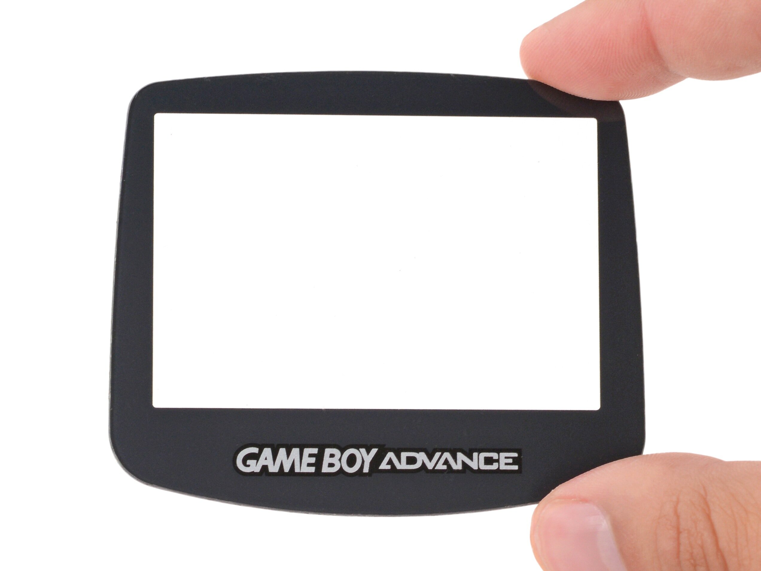

  15. Game Boy Advance LCD Screen Replacement, Where to insert your tool: crwdns2935265:015crwdnd2935265:01crwdnd2935265:03crwdne2935265:0 Game Boy Advance LCD Screen Replacement, Where to insert your tool: crwdns2935265:015crwdnd2935265:02crwdnd2935265:03crwdne2935265:0 Game Boy Advance LCD Screen Replacement, Where to insert your tool: crwdns2935265:015crwdnd2935265:03crwdnd2935265:03crwdne2935265:0
    • Before prying up the screen, note where you need to pry:
    • There's a seam between the screen and its gasket. Insert your tool here (under the screen) to give yourself the best chance of preserving the gasket.
    • There's a seam between the gasket and the shell. Don't insert your tool here, or you may damage the gasket.
  16. Game Boy Advance LCD Screen Replacement, Pry up the screen: crwdns2935265:016crwdnd2935265:01crwdnd2935265:03crwdne2935265:0 Game Boy Advance LCD Screen Replacement, Pry up the screen: crwdns2935265:016crwdnd2935265:02crwdnd2935265:03crwdne2935265:0 Game Boy Advance LCD Screen Replacement, Pry up the screen: crwdns2935265:016crwdnd2935265:03crwdnd2935265:03crwdne2935265:0
    • When removing the screen, be careful not to damage or stretch the adhesive gasket that secures it to the shell.
    • Insert the flat end of a spudger under the screen and pry the screen up. Apply constant, steady pressure to allow the adhesive to separate.
    • If the screen isn't budging, flip your Game Boy over and lay a heated iOpener on the screen for two minutes to soften the adhesive. Alternatively, you can use a hair dryer on the Low heat setting—be careful not to overheat your device, or you may warp the plastic.
  17. Game Boy Advance LCD Screen Replacement, Remove the screen: crwdns2935265:017crwdnd2935265:01crwdnd2935265:02crwdne2935265:0 Game Boy Advance LCD Screen Replacement, Remove the screen: crwdns2935265:017crwdnd2935265:02crwdnd2935265:02crwdne2935265:0
    Tesa 61395 Tape
    $2.99
    • Remove the screen.
    • If the gasket stuck to the screen, carefully remove it and put it back on the shell.
    • During reassembly:
    • If you're upgrading the screen to an IPS one, you'll likely need to solder or modify the motherboard. Read any instructions included with your replacement part, and check the website you bought the part from for more information. If it's your first time soldering, check out our helpful soldering guide!
    • Compare your replacement screen to the original part—you may need to remove adhesive backings or protective liners from the new part before you install it.
    • If you damaged the gasket, remove all of it from the shell and use high‑concentration (>90%) isopropyl alcohol and coffee filters or a lint‑free cloth to remove any remaining residue. Then, replace the gasket with a new one, or apply strips of double‑sided tape where the old one was.
