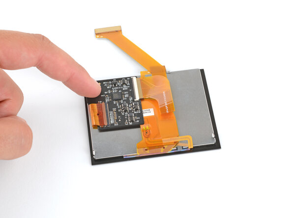

  26. Nintendo Game Boy Advance SP Screen Replacement, Remove the screen: crwdns2935265:026crwdnd2935265:01crwdnd2935265:03crwdne2935265:0 Nintendo Game Boy Advance SP Screen Replacement, Remove the screen: crwdns2935265:026crwdnd2935265:02crwdnd2935265:03crwdne2935265:0 Nintendo Game Boy Advance SP Screen Replacement, Remove the screen: crwdns2935265:026crwdnd2935265:03crwdnd2935265:03crwdne2935265:0
    • Use your fingers to lift and remove the screen, threading the cable through its cutout.
    • If your screen stayed attached to the shell, you may need to gently pry it up with a spudger before removing it.
    • During reassembly:
    • Place the screen foam-side up into its recess, so the cable is near the hinges.
    • Make one loop in the screen cable and then slide it through the cutout.

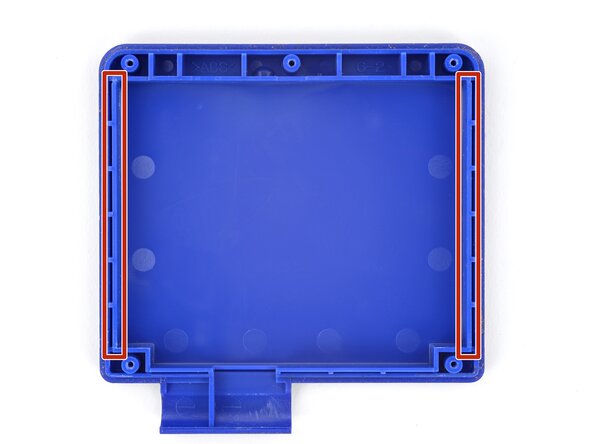

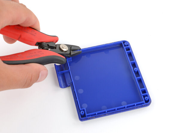

  27. Nintendo Game Boy Advance SP Screen Replacement, Modification information: crwdns2935265:027crwdnd2935265:01crwdnd2935265:03crwdne2935265:0 Nintendo Game Boy Advance SP Screen Replacement, Modification information: crwdns2935265:027crwdnd2935265:02crwdnd2935265:03crwdne2935265:0 Nintendo Game Boy Advance SP Screen Replacement, Modification information: crwdns2935265:027crwdnd2935265:03crwdnd2935265:03crwdne2935265:0
    • For some IPS screen upgrades, you may need to make modifications to your replacement screen shell or the screen itself. If you're using the original screen, you don't need to make modifications. Check your kit or the website you purchased it from for specific instructions before making any modifications.
    • Some IPS screens are bigger than the original. You may need to use flush cutters to trim one of the side rails to make room for your replacement screen.
    • Your replacement screen may come with a small board and ribbon cable(s). The board will likely need to be adhered to the back of the screen, and the ribbon cable will connect to the board. Check the board and any cables for adhesive backings.

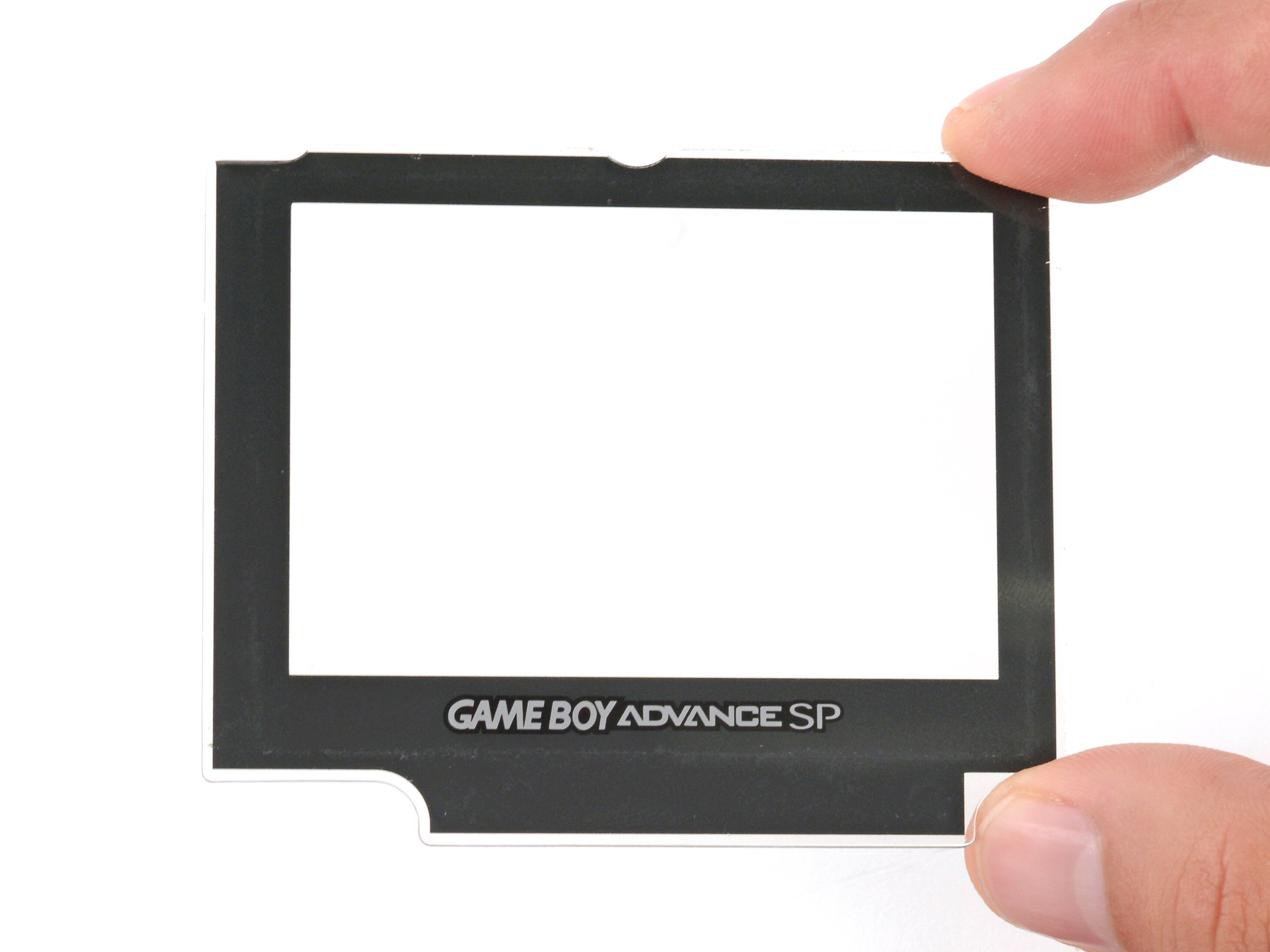

hello can i ask something? can you take apart the lcd? because my lcd has fungus
Jorick Earl Bastian - crwdns2934203:0crwdne2934203:0 crwdns2950251:0crwdne2950251:0
I am pretty sure, as the actual screen can be separated from the plastic cover (the thing that says game boy advance). I’ve never seen fungus in a screen though. That’s interesting.
Lucas Hoekstra (Lucas9810) - crwdns2950251:0crwdne2950251:0
