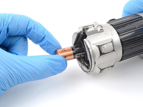

      • Remove the batteries from your device.
      • If there's a lot of corrosion, the batteries may be stuck in their recess. Don't try to force them out...unless you're a small, green, force-sensitive creature.
      • If any batteries are stuck, follow the next step as normal to clean around them.

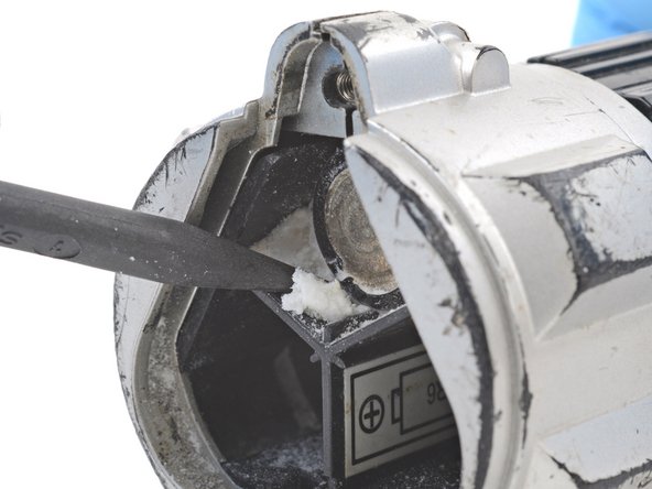

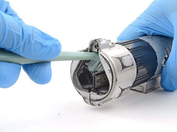

      • Use a toothbrush or anti‑static brush to gently remove any bigger chunks of corrosion from the battery terminals and battery recess.
      • Use the point of a spudger to pick out any bits that are stuck.
      • Pick around the batteries, and not at the batteries themselves.

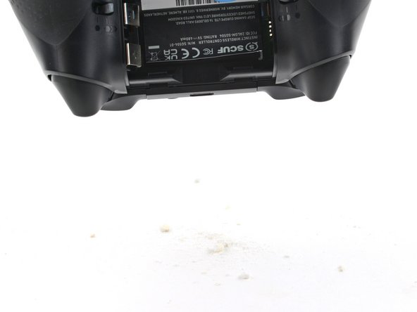

      • Flip your device over and gently shake out the loose corrosion and debris.
      • Dispose of the corrosion and debris in the trash.

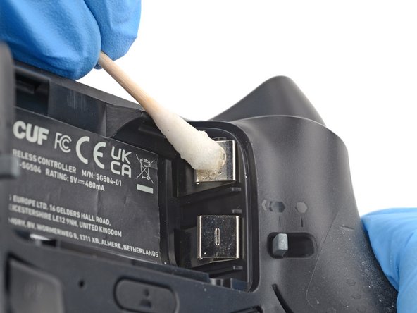

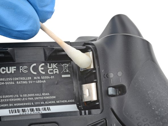

      • Alkaline batteries contain a base, which is what corrosion is made of. An acid like white vinegar or lemon juice will neutralize this base.
      • Lightly dip a cotton swab in white vinegar or lemon juice.
      • Don't soak the cotton swab. Only use a small amount of liquid at a time.
      • Gently rub the battery terminals with the cotton swab to dissolve and remove the corrosion.
      • The corrosion may fizz and bubble. Don't worry, this is normal.
      • Continue this process until there's no corrosion on the terminals.

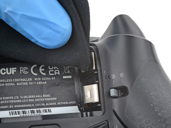

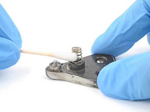

      • Isopropyl alcohol will remove any residue left from the previous step.
      • Lightly dip a cotton swab in highly-concentrated isopropyl alcohol (over 90%).
      • Gently rub the battery terminals with the cotton swap to remove any remaining residue from the previous step.
      • Wipe the residue away with a microfiber or lint-free cloth.
      • Repeat this process until the terminals are completely clean.
      • Wait two minutes to allow any residual alcohol to evaporate.
