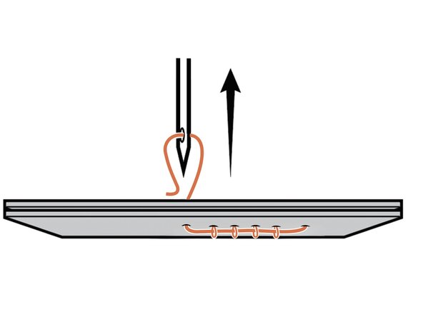

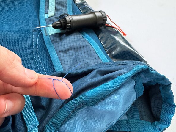

    1. Expedition Sewing Awl, Intro to sewing with an awl: crwdns2935265:01crwdnd2935265:01crwdnd2935265:03crwdne2935265:0 Expedition Sewing Awl, Intro to sewing with an awl: crwdns2935265:01crwdnd2935265:02crwdnd2935265:03crwdne2935265:0 Expedition Sewing Awl, Intro to sewing with an awl: crwdns2935265:01crwdnd2935265:03crwdnd2935265:03crwdne2935265:0

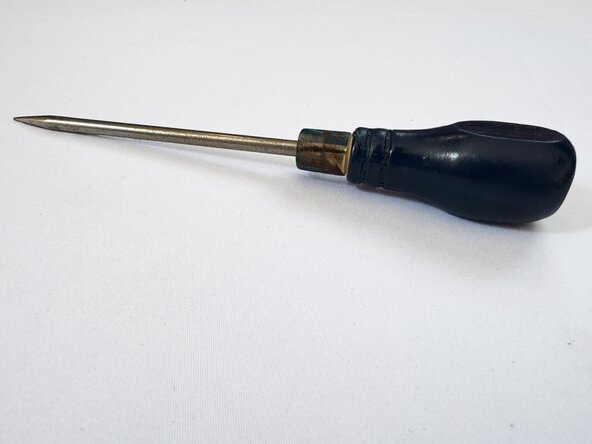

      • Standard awls are used in sewing to punch holes in thick materials to make stitching easier.
      • The Expedition Sewing Awl (ESA) is unique because it punches holes and sews simultaneously, and can be adapted to work on a multitude of materials!
      • The ESA creates a lockstitch where the upper thread and lower thread "lock" together.

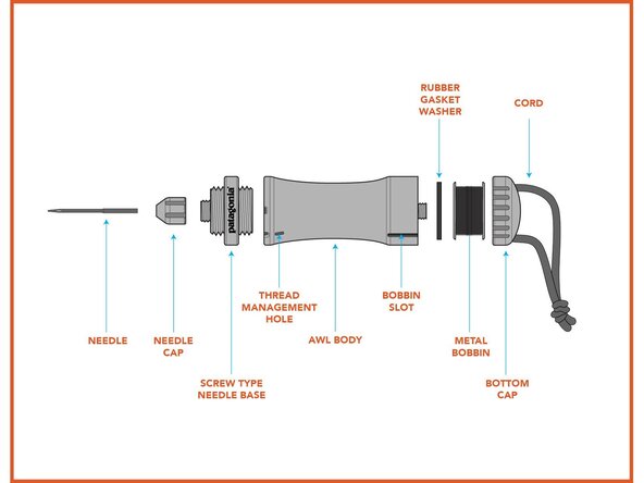

    3. Expedition Sewing Awl, Tool overview: crwdns2935265:03crwdnd2935265:01crwdnd2935265:01crwdne2935265:0
      • Needle: The ESA uses a machine sewing needle. Unlike hand sewing needles, the eye of a machine needle is on the pointed end.
      • Thread: This tool is best suited for equipment-weight thread. The included thread is Tex 70 Nylon which is heavy-duty.
      • Bobbin: Included within the ESA is a metal bobbin (A-Style / Class 15) that holds the thread. Other types of bobbins aren't compatible.

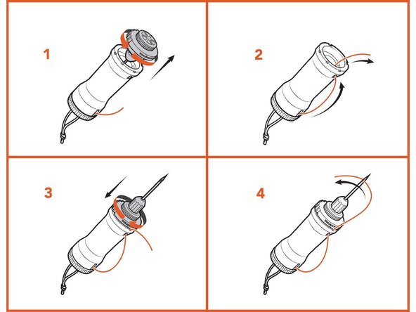

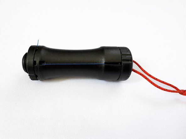

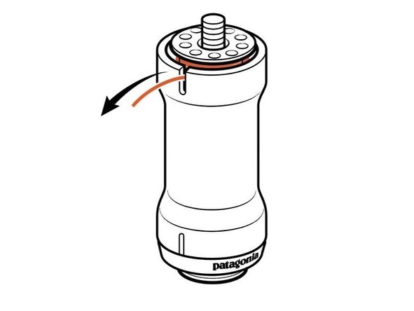

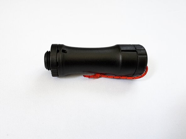

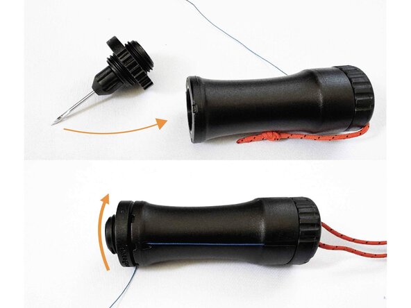

    4. Expedition Sewing Awl, Internal storage: crwdns2935265:04crwdnd2935265:01crwdnd2935265:03crwdne2935265:0 Expedition Sewing Awl, Internal storage: crwdns2935265:04crwdnd2935265:02crwdnd2935265:03crwdne2935265:0 Expedition Sewing Awl, Internal storage: crwdns2935265:04crwdnd2935265:03crwdnd2935265:03crwdne2935265:0
      • The ESA has a hollow body to store extra needles and contain the active needle when not in use:
      • Unscrew the needle base.
      • Flip the needle base so the needle points into the awl body.
      • Screw the needle base back onto the body.
      • If a thread tail remains, wind it fully back into the bobbin slot or wrap it between the body and needle base.
      • If you're storing the ESA flat, rotate the paracord so it cradles the body and prevents it from rolling away.

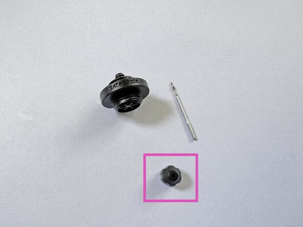

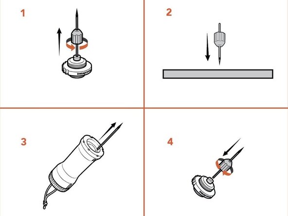

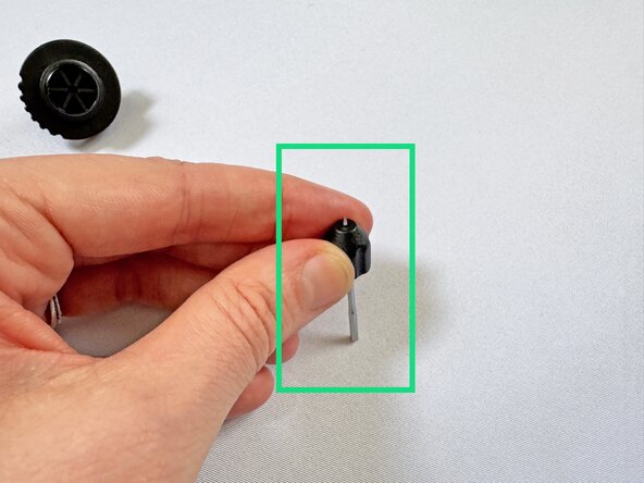

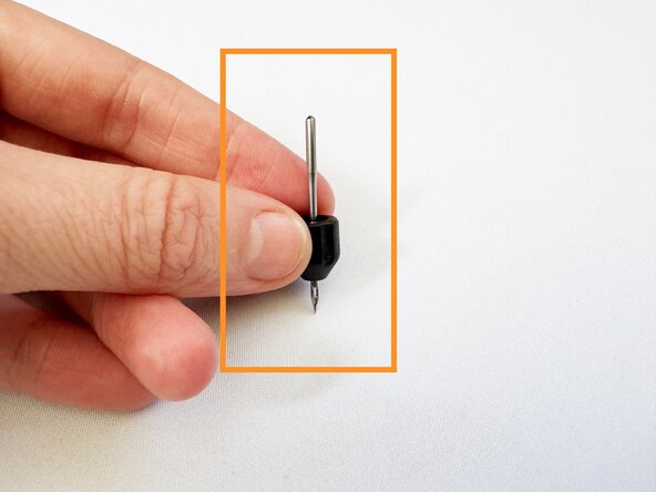

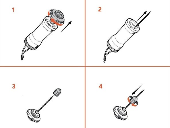

    5. Expedition Sewing Awl, Installing a needle: crwdns2935265:05crwdnd2935265:01crwdnd2935265:03crwdne2935265:0 Expedition Sewing Awl, Installing a needle: crwdns2935265:05crwdnd2935265:02crwdnd2935265:03crwdne2935265:0 Expedition Sewing Awl, Installing a needle: crwdns2935265:05crwdnd2935265:03crwdnd2935265:03crwdne2935265:0
      • Unscrew the needle base from the ESA.
      • Flip over the needle base and twist off the needle cap.
      • Remove one of the included needles from inside the body.
      • Hold the needle upright on a work surface and carefully place the needle cap over the needle.
      • Push the needle cap down onto the needle shank until the needle is snug in the needle cap.
      • Screw the needle cap with the needle onto the needle base.
    6. Expedition Sewing Awl, Changing the needle: crwdns2935265:06crwdnd2935265:01crwdnd2935265:03crwdne2935265:0 Expedition Sewing Awl, Changing the needle: crwdns2935265:06crwdnd2935265:02crwdnd2935265:03crwdne2935265:0 Expedition Sewing Awl, Changing the needle: crwdns2935265:06crwdnd2935265:03crwdnd2935265:03crwdne2935265:0
      • Unscrew the needle cap from the needle base of the ESA and pull the needle out through the bottom of the needle cap.
      • If the needle isn't loose after removing the cap, hold only the needle cap and press the point of the needle down on a soft surface to push it through the cap.
      • Remove a new needle from inside the awl body.
      • Insert the new needle from the back of the needle cap. Press the shank of the needle in until tight. Screw the needle cap with the needle onto the needle base.
      • The only limitation for exchanging needles is the needle shank size. Ensure that the needle sits snugly in the needle cap and base. Once placed, it shouldn't rotate or pull out.

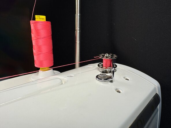

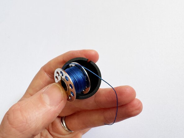

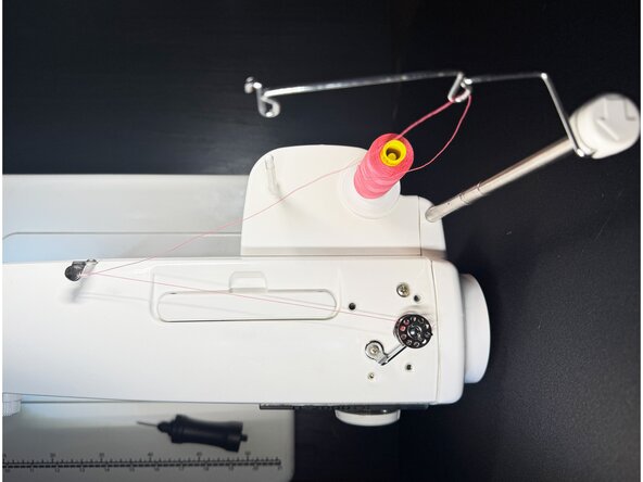

    7. Expedition Sewing Awl, Winding a bobbin: crwdns2935265:07crwdnd2935265:01crwdnd2935265:03crwdne2935265:0 Expedition Sewing Awl, Winding a bobbin: crwdns2935265:07crwdnd2935265:02crwdnd2935265:03crwdne2935265:0 Expedition Sewing Awl, Winding a bobbin: crwdns2935265:07crwdnd2935265:03crwdnd2935265:03crwdne2935265:0
      • The ESA comes with 40 meters of Tex 70 nylon thread pre-loaded on the metal bobbin. You can reload the thread using a sewing machine or a bobbin winder.
      • See How to Wind a Bobbin for more details.
    8. Expedition Sewing Awl, Inserting the bobbin: crwdns2935265:08crwdnd2935265:01crwdnd2935265:03crwdne2935265:0 Expedition Sewing Awl, Inserting the bobbin: crwdns2935265:08crwdnd2935265:02crwdnd2935265:03crwdne2935265:0 Expedition Sewing Awl, Inserting the bobbin: crwdns2935265:08crwdnd2935265:03crwdnd2935265:03crwdne2935265:0
      • Unscrew the bottom cap from the awl body.
      • Place the bobbin into the awl body in the space under the bottom cap so it'll spin clockwise when the thread is pulled.
      • Thread the tail of the thread through the bobbin slot.
      • Screw the bottom cap onto the awl body.
      • The directionality of the bobbin is important.
      • Check that the bobbin is placed correctly by slowly pulling on the thread. If the bottom cap unscrews, flip the bobbin over.

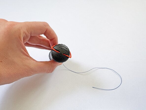

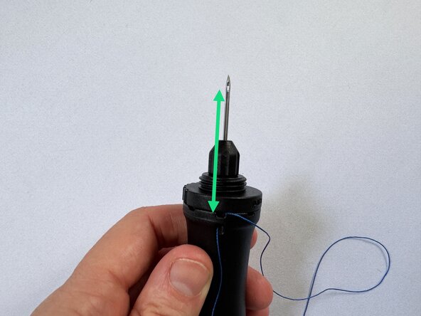

    9. Expedition Sewing Awl, Threading the awl: crwdns2935265:09crwdnd2935265:01crwdnd2935265:03crwdne2935265:0 Expedition Sewing Awl, Threading the awl: crwdns2935265:09crwdnd2935265:02crwdnd2935265:03crwdne2935265:0 Expedition Sewing Awl, Threading the awl: crwdns2935265:09crwdnd2935265:03crwdnd2935265:03crwdne2935265:0
      • With the needle base removed, insert the thread emerging from the bobbin slot into the thread management hole.
      • Pull the thread into the awl body, then thread it out through the slot above the thread management hole.
      • Screw the needle base onto the awl body.
      • For best results, the needle shaft should face towards the thread management hole. (The indentation in the needle should face away from the thread management hole.)
      • Insert the thread through the flat side of the needle so it comes out on the indented side.
      • Pull the thread through and leave a tail equal to the length of the damage plus 2 inches (~50 mm) for tying off.
      • See the next step for a video of this process.

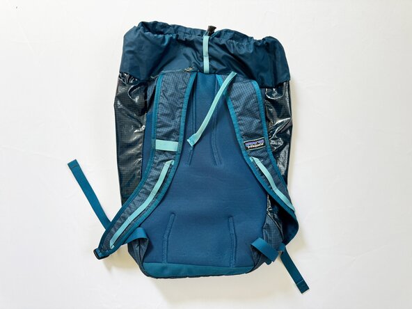

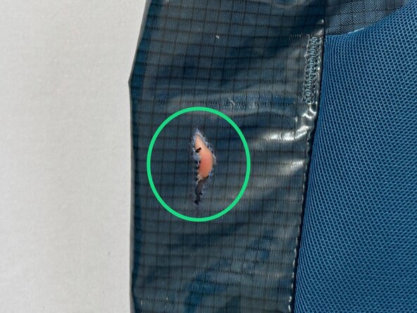

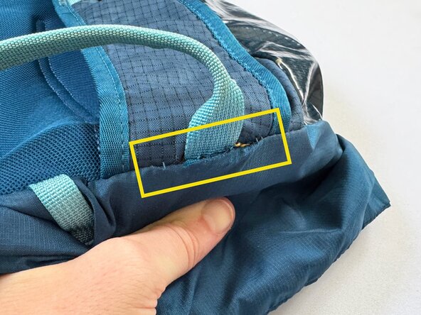

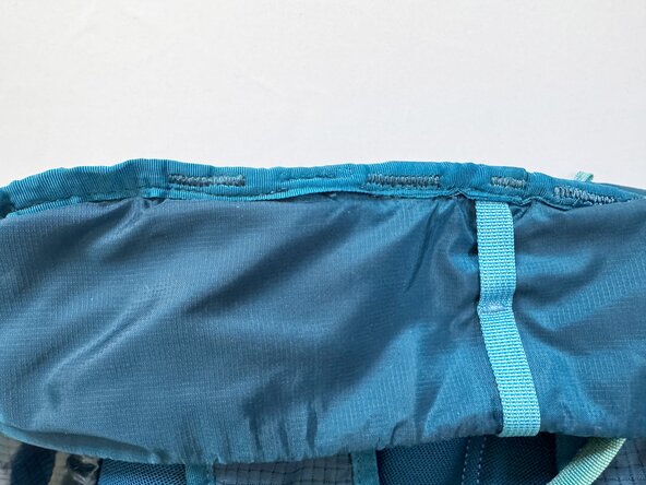

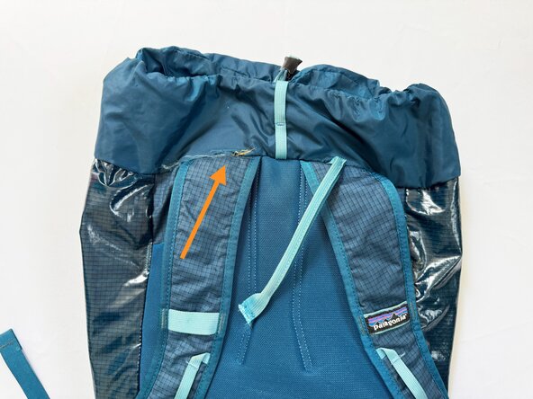

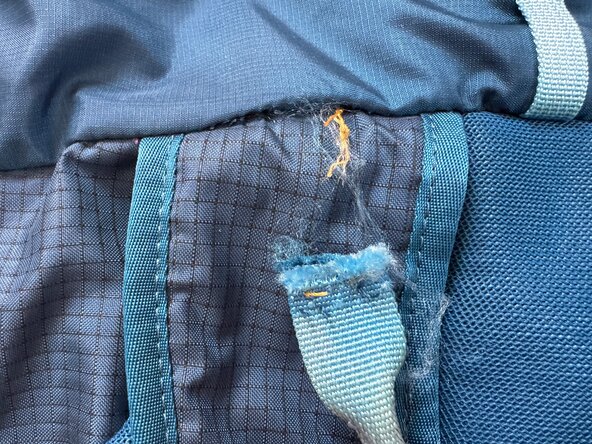

    10. Expedition Sewing Awl, Assess the damage: crwdns2935265:011crwdnd2935265:01crwdnd2935265:03crwdne2935265:0 Expedition Sewing Awl, Assess the damage: crwdns2935265:011crwdnd2935265:02crwdnd2935265:03crwdne2935265:0 Expedition Sewing Awl, Assess the damage: crwdns2935265:011crwdnd2935265:03crwdnd2935265:03crwdne2935265:0
      • Locate the damage.
      • Determine whether a seam has opened or if there's also damage to the fabric.
      • Flip the item inside out to gain better access to the damaged area.

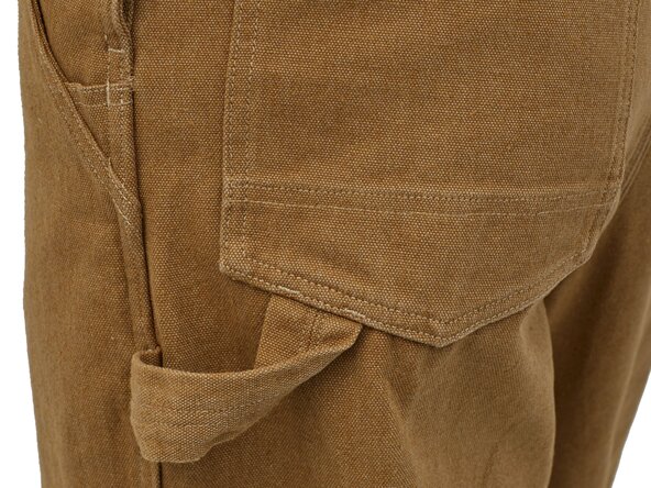

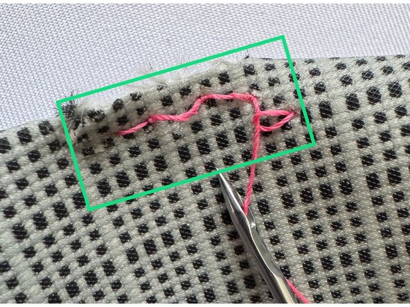

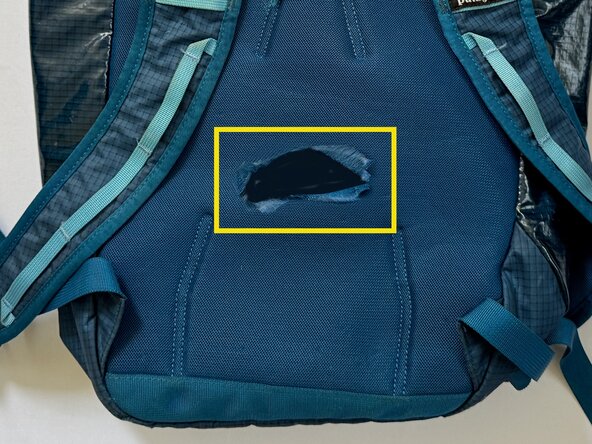

    11. Expedition Sewing Awl, Types of damage: crwdns2935265:012crwdnd2935265:01crwdnd2935265:03crwdne2935265:0 Expedition Sewing Awl, Types of damage: crwdns2935265:012crwdnd2935265:02crwdnd2935265:03crwdne2935265:0 Expedition Sewing Awl, Types of damage: crwdns2935265:012crwdnd2935265:03crwdnd2935265:03crwdne2935265:0
      • Split Seam: This tutorial covers how to repair a short, straight popped seam with no fabric loss using the Expedition Sewing Awl.
      • Tear Without Fabric Loss: Determine if the edges of the tear can be brought together for the tear to be re-stitched. See also: Whip Stitch on a Tear.
      • Tear With Fabric Loss: If there's significant fabric loss, you'll need to make a patch to cover the hole.
      • Before proceeding, test that the needle can pierce all layers of the material cleanly and easily.
      • If the material is thick and difficult to pierce with the needle, try using a twisting motion as you insert the needle. This can help it pass more easily though all layers.

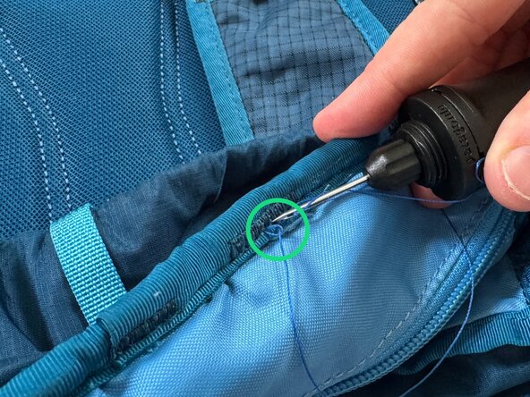

    12. Expedition Sewing Awl, Prep the area: crwdns2935265:013crwdnd2935265:01crwdnd2935265:03crwdne2935265:0 Expedition Sewing Awl, Prep the area: crwdns2935265:013crwdnd2935265:02crwdnd2935265:03crwdne2935265:0 Expedition Sewing Awl, Prep the area: crwdns2935265:013crwdnd2935265:03crwdnd2935265:03crwdne2935265:0
      • These steps show a split seam repair.

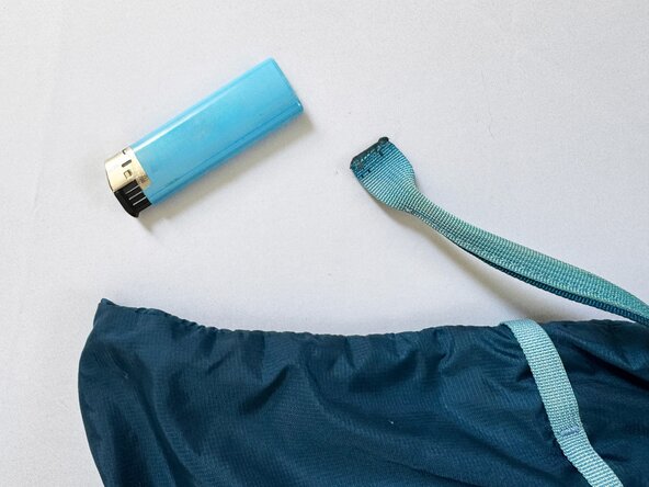

      • Tuck any loose fabric or webbing back into place.
      • If the fabric or webbing has frayed, carefully singe the edge with a lighter to prevent further fraying.
      • Use binder clips to secure the area in place.

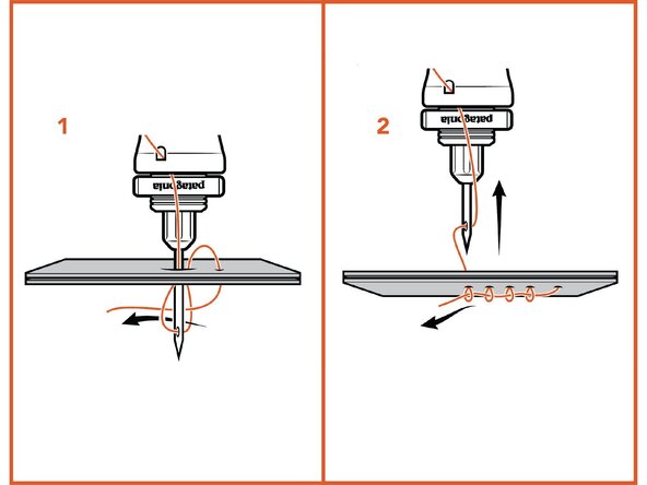

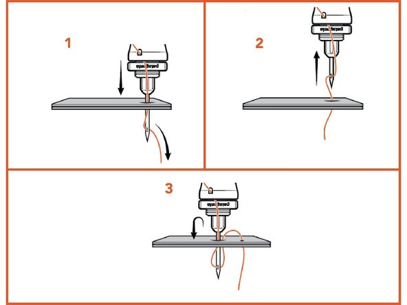

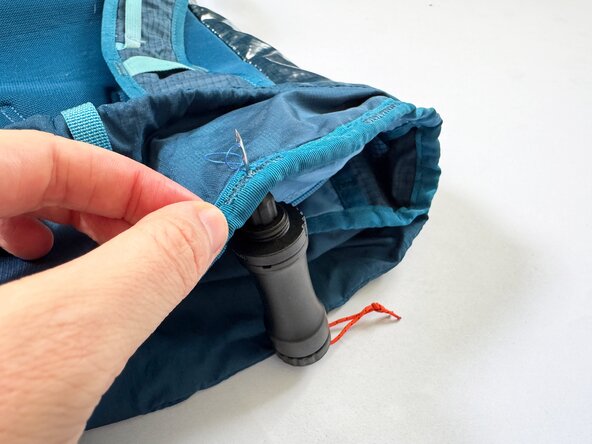

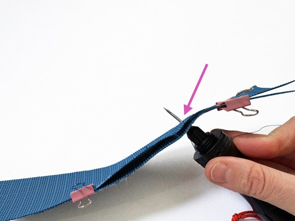

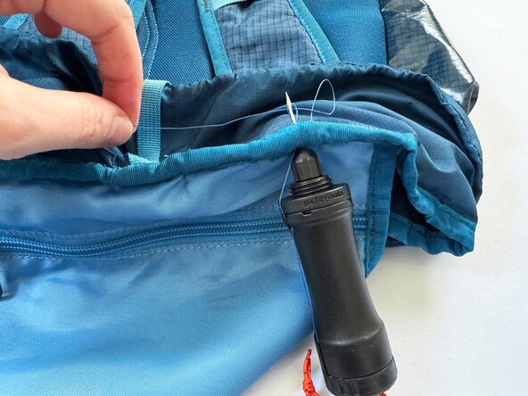

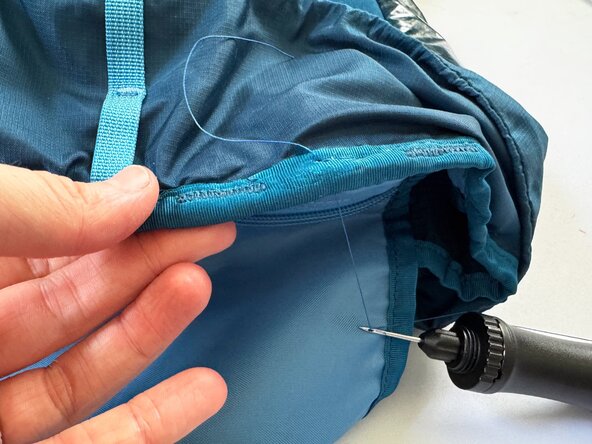

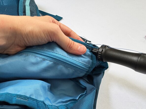

    13. Expedition Sewing Awl, Start the stitch: crwdns2935265:014crwdnd2935265:01crwdnd2935265:03crwdne2935265:0 Expedition Sewing Awl, Start the stitch: crwdns2935265:014crwdnd2935265:02crwdnd2935265:03crwdne2935265:0 Expedition Sewing Awl, Start the stitch: crwdns2935265:014crwdnd2935265:03crwdnd2935265:03crwdne2935265:0
      • Beginning from the less visible side of the item, push the needle fully through all layers.
      • With the the needle still inserted, pull the thread tail through to the front side.
      • Pull the needle out, leaving the thread tail through the fabric.
      • Reinsert the needle into the fabric about 1/4 inch (~6 mm) or less from the first hole. Leave the needle inserted.

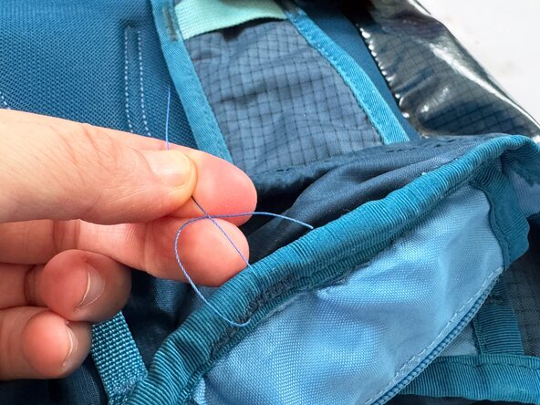

    14. Expedition Sewing Awl, Lock the stitch: crwdns2935265:015crwdnd2935265:01crwdnd2935265:03crwdne2935265:0 Expedition Sewing Awl, Lock the stitch: crwdns2935265:015crwdnd2935265:02crwdnd2935265:03crwdne2935265:0 Expedition Sewing Awl, Lock the stitch: crwdns2935265:015crwdnd2935265:03crwdnd2935265:03crwdne2935265:0
      • Pass the thread tail through the loop created by the inserted needle.
      • This is where the indented section of the needle (the needle scarf) comes in handy. Use the scarf indent as a guide or window for the thread to pass through.
      • Pull the excess thread until it's taut and the fabric is flat.
      • Pull the needle back out. Keep the tail taut and ensure it doesn't move with the needle to the back side of the fabric.
      • Repeat this process along the entire stitch line.
      • Control the thread tension (how easily the thread emerges from the ESA) by tightening or loosening the bottom cap.
      • Ideally the thread is slightly tense, neither too tight nor too loose, as it moves through the needle. This is important for creating a tight and secure stitch.
      • In this example the tension is being adjusted from being too tight to the correct tension for this thread type.
      • Alternatively, hold the ESA like a pencil with the thread under your thumb to control the tension.

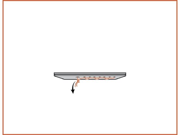

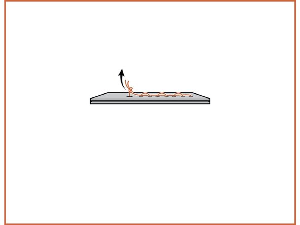

    16. Expedition Sewing Awl, Knot the thread end: crwdns2935265:018crwdnd2935265:01crwdnd2935265:03crwdne2935265:0 Expedition Sewing Awl, Knot the thread end: crwdns2935265:018crwdnd2935265:02crwdnd2935265:03crwdne2935265:0 Expedition Sewing Awl, Knot the thread end: crwdns2935265:018crwdnd2935265:03crwdnd2935265:03crwdne2935265:0
      • Before tying off, adjust the stitch tension and ensure the seam lies flat.
      • Cut the thread coming from the awl, leaving about 2 inches (~50 mm) of tail for tying off.
      • Tie the two thread ends together with a square knot, keeping it as flush to the fabric as possible.
      • Trim off the excess thread from the knot.

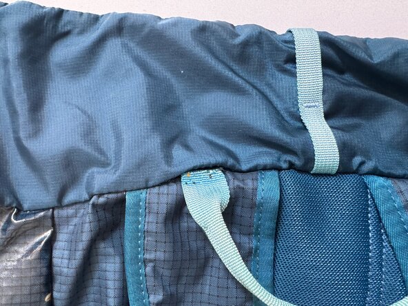

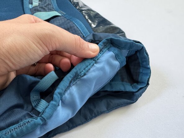

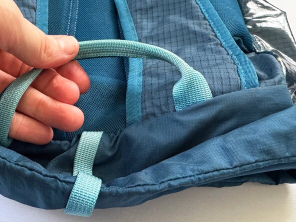

    17. Expedition Sewing Awl, Quality check: crwdns2935265:019crwdnd2935265:01crwdnd2935265:02crwdne2935265:0 Expedition Sewing Awl, Quality check: crwdns2935265:019crwdnd2935265:02crwdnd2935265:02crwdne2935265:0
      • Gently pull on the repaired seam to check that the stitches are sturdy and secure.
      • In the pictured repair, tug on the haul handle that was sewn into the seam to ensure it can hold weight. The stitches should hold firmly and the handle should remain securely attached.

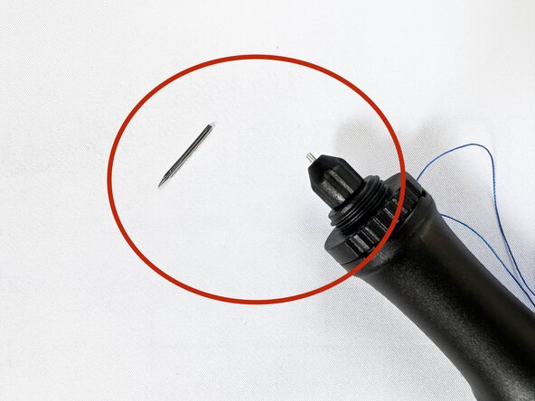

      • Broken needle: If the needle breaks, stop immediately and remove all broken pieces from the fabric and the awl. This can happen due to (1) the material being too thick for the needle size, (2) the material being too thick for the device, or (3) a dull needle.
