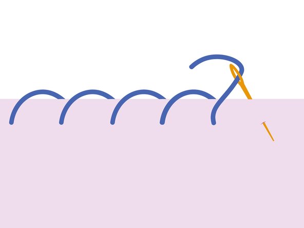

    • Structure - The whip stitch is a simple looping stitch that creates a spiral of thread.
    • Repair Use - This stretch stitch is highly versatile and can be used to seal a tear, bind a raw fabric edge, or attach a patch.

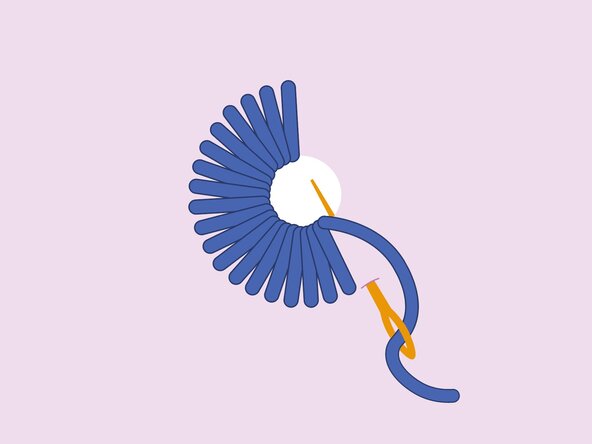

    • When placed close together, whip stitches can also reinforce an opening to create a buttonhole or a decorative eyelet.

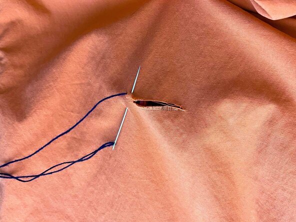

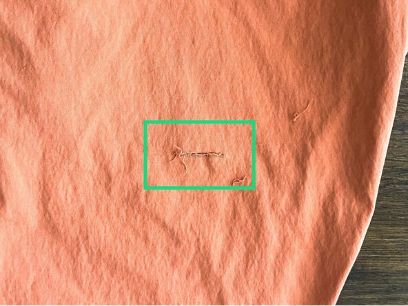

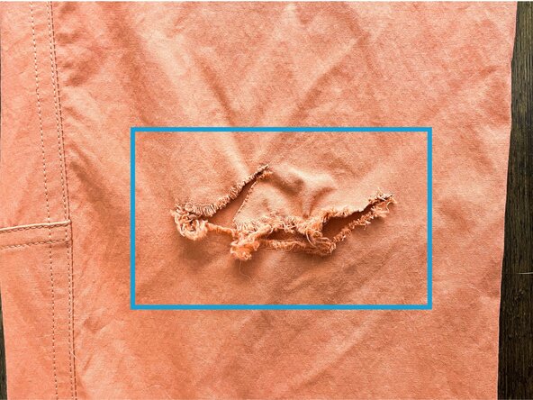

  2. Whip Stitch on a Tear, Assess the damage: crwdns2935265:02crwdnd2935265:01crwdnd2935265:03crwdne2935265:0 Whip Stitch on a Tear, Assess the damage: crwdns2935265:02crwdnd2935265:02crwdnd2935265:03crwdne2935265:0 Whip Stitch on a Tear, Assess the damage: crwdns2935265:02crwdnd2935265:03crwdnd2935265:03crwdne2935265:0
    • Locate the damaged area and trim away any loose or hanging threads.
    • In this tutorial, the whip stitch will be used to seal a short, straight tear with minimal fraying and fabric loss.
    • If the damage is more extensive, a variation of this technique can be used to attach a patch over the damaged area. See Whip Stitch on a Patch or Blanket Stitch on a Patch.
    • Cut a length of thread approximately 24 inches (~61 cm) long.

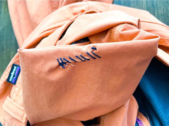

    • The pictured repair uses contrast thread for visibility, but matching thread will make this repair more invisible.
    • Thread the needle and adjust the thread so there are equal lengths of thread on each side of the needle.
    • Tie an overhand knot with both ends to create a doubled length of thread.
    • See Needles and Thread for more details.

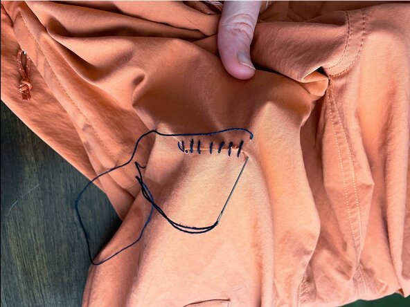

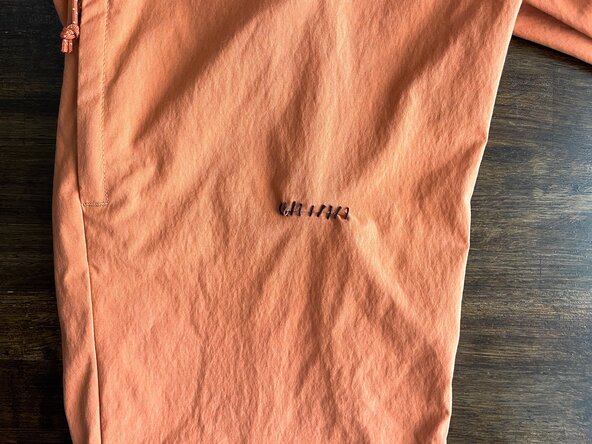

  3. Whip Stitch on a Tear, Start the stitch: crwdns2935265:04crwdnd2935265:01crwdnd2935265:02crwdne2935265:0 Whip Stitch on a Tear, Start the stitch: crwdns2935265:04crwdnd2935265:02crwdnd2935265:02crwdne2935265:0
    • Insert the needle up from the backside of the fabric, about 1/8 inch (~3 mm) diagonally away from the end of the tear. Pull tight so the knot is flush on the backside.
    • Pierce down into the fabric 1/4 inch (~6 mm) away from the first stitch, on the opposite side of the tear, then bring the needle back up right next to the first stitch, about 1/8 inch (~3 mm) away. Pull through.
    • The first stitch will be in the undamaged fabric before the tear. This will serve as an anchor that stabilizes the rest of the stitch line.

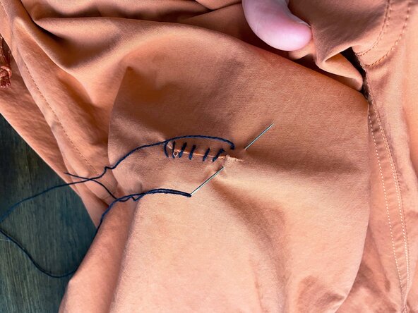

  4. Whip Stitch on a Tear, Continue the stitch: crwdns2935265:05crwdnd2935265:01crwdnd2935265:01crwdne2935265:0
    • Repeat the process from the previous step to continue stitching in a spiral pattern, passing the needle from one side of the tear to the other.
    • The stitches should be no more than 1/8 inch (~3 mm) apart for a secure and even repair.
    • Maintain consistent tension and spacing for a neat appearance.
    • Thread that's too tight will pucker the fabric and thread that's too loose won't effectively seal the tear.
  5. Whip Stitch on a Tear, Finish the stitch: crwdns2935265:06crwdnd2935265:01crwdnd2935265:03crwdne2935265:0 Whip Stitch on a Tear, Finish the stitch: crwdns2935265:06crwdnd2935265:02crwdnd2935265:03crwdne2935265:0 Whip Stitch on a Tear, Finish the stitch: crwdns2935265:06crwdnd2935265:03crwdnd2935265:03crwdne2935265:0
    • Continue whip stitching until you get to the opposite side of the tear.
    • Make a final stitch beyond the end of the tear to secure the stitching, just as it was anchored at the beginning of the tear.
    • Pass the needle through to the backside of the fabric.
    • Make a secure knot on the backside of the fabric using one of the techniques from Knot Thread to the Fabric (2 Ways) and trim the extra thread.
  6. Whip Stitch on a Tear, Quality check: crwdns2935265:07crwdnd2935265:01crwdnd2935265:03crwdne2935265:0 Whip Stitch on a Tear, Quality check: crwdns2935265:07crwdnd2935265:02crwdnd2935265:03crwdne2935265:0 Whip Stitch on a Tear, Quality check: crwdns2935265:07crwdnd2935265:03crwdnd2935265:03crwdne2935265:0
    • Check that the tear is effectively sealed and that the stitching has even spacing and appropriate tension.
    • Trim any loose threads.
