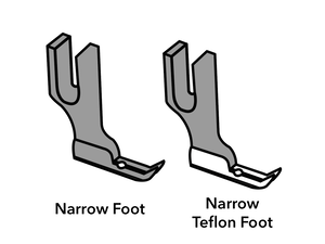

  • Narrow foot - offers better visibility and maneuverability in tight spaces (not compatible with most zigzag capable machines)
  • A Teflon (non-stick) foot - reduces friction as it moves across the fabric and is great for preventing bunching and improving stitch quality on tricky surfaces
Note: These images show industrial presser feet. Home machine feet may look different and often attach via a snap-on mechanism.

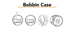

Bobbins and Casings
A bobbin is a small spool, usually made of plastic or metal, that holds the lower thread in a sewing machine. It works together with the top thread to form each stitch.
Bobbins come in different sizes and styles, and it’s important to use the correct type for your specific machine to ensure smooth stitching and proper tension.
There are three common bobbin setups:
  • Drop-in bobbin - The bobbin is placed directly into a compartment beneath the needle plate. This style is common in many modern home machines and is easy to load and monitor.
  • Front-loading bobbin with a bobbin case - The bobbin is first inserted into a removable bobbin case, which is then loaded into the front of the machine. This setup is more common in older or industrial machines and allows for more precise tension adjustments.
  • Side-loading bobbin with a bobbin case - The bobbin is first inserted into a removable bobbin case, which is then loaded into the left side of the machine. This setup is more common in industrial machines and allows for more precise tension adjustments.
See tutorial on How to Wind a Bobbin.
Always wind thread onto the bobbin evenly and under tension, and check that it’s inserted in the correct direction!

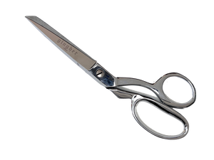

Fabric Scissors
Fabric scissors are designed to cut fabric with a clean edge to reduce fraying. Your fabric scissors should be very sharp and used only to cut fabric, cutting items like paper and tape will dull them quickly. And it can be very frustrating to cut fabric with dull scissors!

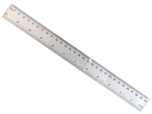

Ruler
A ruler is necessary for making accurate measurements and drawing straight lines. A straight or L-shaped ruler is used to measure, draw and create a fabric patch. A see-through ruler can be extra handy for visibility when making marks.

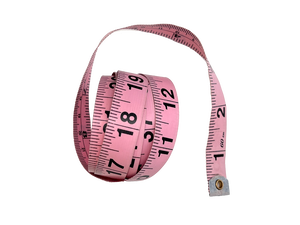

Soft Measuring Tape
A soft measuring tape differs from a ruler because it can measure curved and irregular surfaces. It's essential for any 3-dimensional or curved measuring. And because it's made of fabric, you can even pin through it!

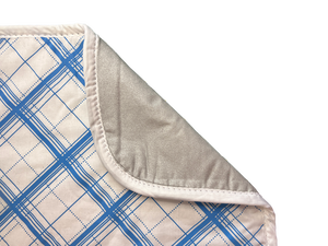

Ironing Board or Ironing Pad
An ironing board or ironing pad is a heat resistant surface on which you can use your iron.
