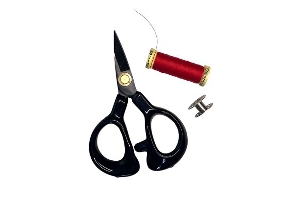

      • You'll need:
      • A sewing machine or bobbin winder
      • An empty bobbin (compatible with your machine or tool)
      • A spool of thread
      • Your sewing machine or bobbin winder manual (optional, but helpful, especially for first-timers!)

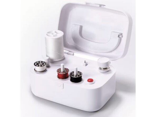

      • Place the bobbin onto the bobbin winder pin.
      • Place the spool of thread onto the spool pin.
      • Secure the spool with a cap if your machine uses one.
      • Guide the thread through the thread path and tension discs, following your machine's manual.
      • This step is essential for maintaining proper tension during winding.
      • Attach the thread to the bobbin:
      • If the bobbin has a hole, thread the end through it from the inside out.
      • If the bobbin doesn't have a hole, wrap the thread around the bobbin manually a few times in the direction it will spin.
      • Turn on the machine if it's not already on.
      • Engage the bobbin winder by pushing the bobbin pin to the right or pressing a knob, depending on your machine.
      • Some bobbin winders will start automatically. Others will require you to engage the foot pedal.
      • Hold the thread tail for the first few seconds, then let go once it’s secure.
      • The bobbin will spin and fill with thread.
      • Most machines stop automatically when the bobbin is full. If you want to stop the winder or if you run out of thread, disengage the bobbin pin.
      • Cut the thread and remove the bobbin.

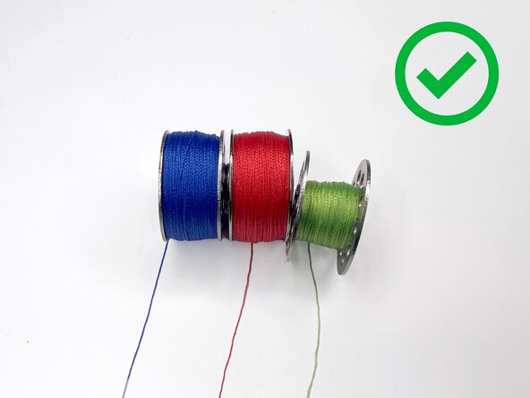

      • The ideal bobbin has:
      • Uniform distribution: The thread should be wound in smooth, uniform layers across the entire bobbin. There are no peaks, dips, or bunching in the middle or at the edges.
      • Firm tension: The thread should be tight and compact. Each layer lies flat and smooth without loops or tangles.
      • Proper fill level: When full, the thread shouldn't extend past the rim of the bobbin.

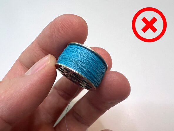

      • Loosely wound: A messy bobbin leads to messy sewing. The bobbin must be wound tightly and with consistent tension to function properly—this applies whether you're using a sewing machine or an Expedition Sewing Awl. Unwind the bobbin, re-thread the machine, and try again. Make sure the thread passes through all tension guides.
