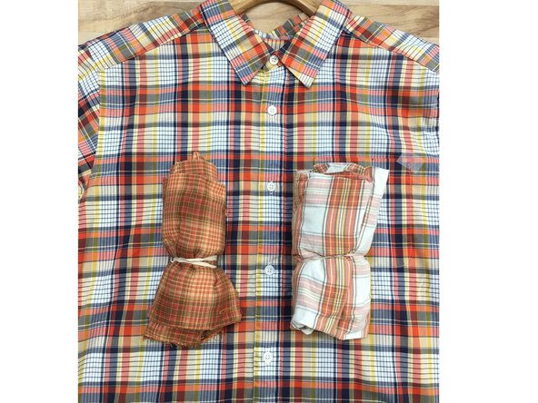

    1. Make a Fabric Patch, Choose the patch fabric: crwdns2935265:01crwdnd2935265:01crwdnd2935265:03crwdne2935265:0 Make a Fabric Patch, Choose the patch fabric: crwdns2935265:01crwdnd2935265:02crwdnd2935265:03crwdne2935265:0 Make a Fabric Patch, Choose the patch fabric: crwdns2935265:01crwdnd2935265:03crwdnd2935265:03crwdne2935265:0
      • To choose the ideal patch fabric for performance and aesthetics, take the following aspects into consideration and match them to the garment:

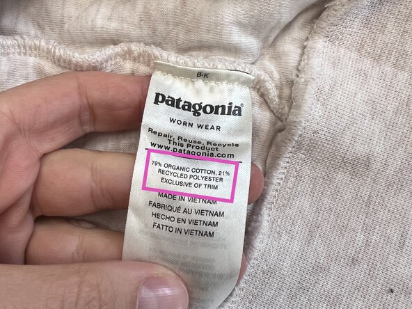

      • Weave Structure - Whether the fabric is woven or knit.
      • Fiber Content - The fiber that the fabric is made of (cotton, nylon, etc). This will likely be written somewhere on the garment tag.
      • Weight - How thick and rigid the fabric feels.
      • Stretch - Whether the fabric stretches horizontally, vertically, or both.
      • Color - Matching color is up to personal discretion but often a slightly darker fabric will look less obvious than a slightly lighter fabric.
      • Preference - A preference for a contrasting patch for a more visible repair.
    2. Make a Fabric Patch, Example: Choose the patch fabric: crwdns2935265:02crwdnd2935265:01crwdnd2935265:01crwdne2935265:0
      • In the pictured example, the damaged garment is non-stretch woven, heavyweight organic cotton in a medium tan color. Here's a breakdown of the pros and cons each of the fabric patch options:
      • All of the pictured fabric samples are woven.
      • Options 1 - 4 are heavyweight organic non-stretch cotton in a variety of colors.
      • Option 5 is very close in color, but is woven nylon with noticeable stretch.
      • Option 6 is close in color and cotton, but is medium weight.
      • Option 7 is a medium weight cotton in a contrast print.
      • The ideal match fabric is Option 1 because it's close in color and has the same fiber content, weave structure, stretch, and weight.
      • Options 3, 4 and 7 could be chosen for contrast patches. However, Option 7 may be too lightweight for long term durability.

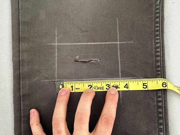

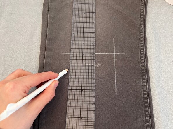

    4. Make a Fabric Patch, Measure the damage: crwdns2935265:04crwdnd2935265:01crwdnd2935265:02crwdne2935265:0 Make a Fabric Patch, Measure the damage: crwdns2935265:04crwdnd2935265:02crwdnd2935265:02crwdne2935265:0

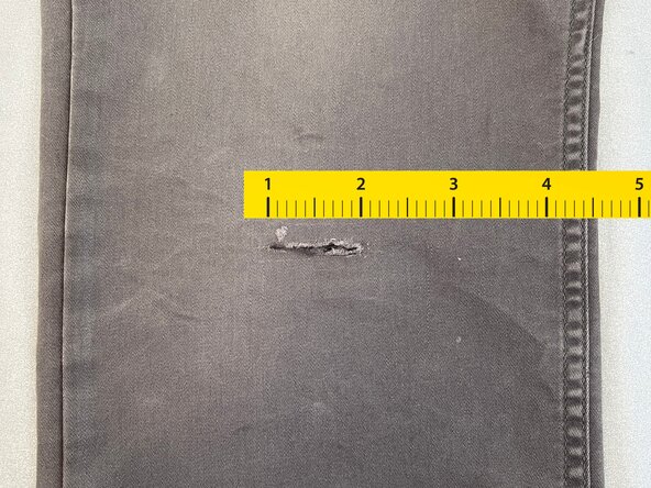

      • Measure the dimensions of the damage.
      • Follow the grain lines of the garment fabric, measuring in each grain direction to get the width and height of the damage.
      • Remember these measurements for the next step.
    5. Make a Fabric Patch, Determine the patch dimensions: crwdns2935265:05crwdnd2935265:01crwdnd2935265:03crwdne2935265:0 Make a Fabric Patch, Determine the patch dimensions: crwdns2935265:05crwdnd2935265:02crwdnd2935265:03crwdne2935265:0 Make a Fabric Patch, Determine the patch dimensions: crwdns2935265:05crwdnd2935265:03crwdnd2935265:03crwdne2935265:0
      • Add at least 1/2 inch (~13 mm) in each direction—so at least 1 inch (~25 mm) total—to each damage dimension measurement from the previous step.
      • These new measurements will be the final patch size, which is the size of the patch when it's sewn on.
      • The fabric directly surrounding the damage is weak and unable to hold stitching. This additional space ensures the patch can be securely attached and provides a buffer in case the damage grows.
      • Optionally, mark the size and orientation of the patch onto the garment.

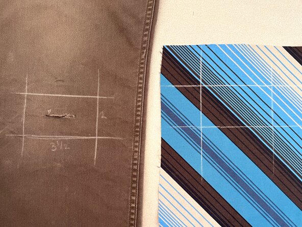

    6. Make a Fabric Patch, Mark the patch measurements: crwdns2935265:06crwdnd2935265:01crwdnd2935265:03crwdne2935265:0 Make a Fabric Patch, Mark the patch measurements: crwdns2935265:06crwdnd2935265:02crwdnd2935265:03crwdne2935265:0 Make a Fabric Patch, Mark the patch measurements: crwdns2935265:06crwdnd2935265:03crwdnd2935265:03crwdne2935265:0

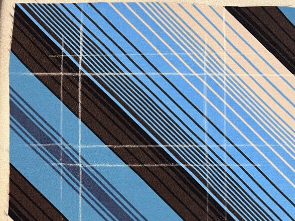

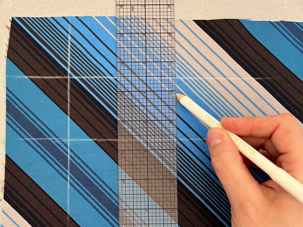

      • Use chalk or heat-erasable pen to mark the final patch dimensions found in the previous step onto the right (front) side of the patch fabric.
      • Be sure that the edges of the patch follow the grain directions of the patch fabric. The grain direction of the patch should match the grain direction of the garment for the best appearance and performance.
      • In the pictured repair, the patch fabric has a diagonal print pattern in relation to the fabric grain.

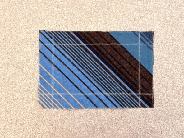

    7. Make a Fabric Patch, Add seam allowance: crwdns2935265:07crwdnd2935265:01crwdnd2935265:02crwdne2935265:0 Make a Fabric Patch, Add seam allowance: crwdns2935265:07crwdnd2935265:02crwdnd2935265:02crwdne2935265:0
      • Add 1/2 inch (~13 mm) to each side of the drawn patch dimensions and mark these new lines using chalk or heat-erasable pen.
      • This is for seam allowance, additional fabric that will be folded under so that the raw fabric edges of the patch don't show when the repair is complete.
    8. Make a Fabric Patch, Cut the patch: crwdns2935265:08crwdnd2935265:01crwdnd2935265:02crwdne2935265:0 Make a Fabric Patch, Cut the patch: crwdns2935265:08crwdnd2935265:02crwdnd2935265:02crwdne2935265:0
      • Cut out the patch along the seam allowance lines.
      • Use sharp scissors, ideally ones that aren't used to cut paper or tape.

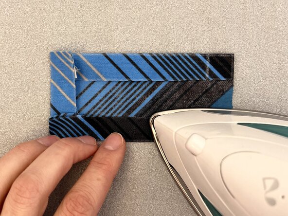

    9. Make a Fabric Patch, Fold the seam allowance: crwdns2935265:09crwdnd2935265:01crwdnd2935265:02crwdne2935265:0 Make a Fabric Patch, Fold the seam allowance: crwdns2935265:09crwdnd2935265:02crwdnd2935265:02crwdne2935265:0
      • Using the guidelines on the patch, iron the seam allowance inward toward the backside of the patch.
      • Repeat on each side.

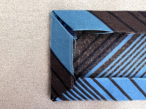

    10. Make a Fabric Patch, Miter the patch corners: crwdns2935265:010crwdnd2935265:01crwdnd2935265:02crwdne2935265:0 Make a Fabric Patch, Miter the patch corners: crwdns2935265:010crwdnd2935265:02crwdnd2935265:02crwdne2935265:0
      • Miter each corner so no raw fabric is exposed at the edges of the patch. (See the next step for video instructions.)
      • Unfold the seam allowance on either side of the corner.
      • Use the fold lines to determine the diagonal line that bisects the point where the folds intersect.
      • Fold the corner inward along this diagonal line.
      • Refold the seam allowances of the adjacent patch sides. If done correctly, their corner edges will meet at a 45-degree angle.
      • Press the fabric in place and repeat on each corner.

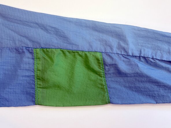

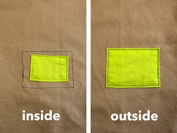

      • CLOSE TEAR: In most cases, stitch the tear closed before attaching the patch. This will seal the tear on the inside so it doesn't grow bigger or get caught while the garment is being worn. See Whip Stitch on a Tear.
      • UNDERPATCH: If the tear is too large to be stitched closed, use an underpatch: a smaller patch that's sewn over the hole on the inside before the main patch is sewn on the front.
      • PATCH INTO A SEAM: For a patch that goes into a garment seam, use the same measurement steps but leave the seam allowance along that edge unfolded. The seam allowance will instead be sewn into the garment seam.
