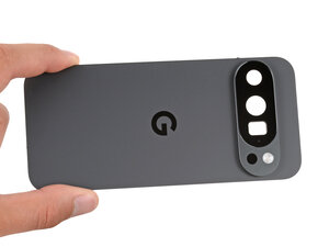

The Google Pixel 10 Pro can be identified by its rounded off camera bar, the Google "G" logo in the center, and a chassis with squared-off sides.
