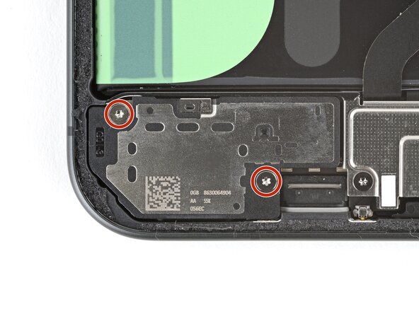

  12. Google Pixel 10 Pro Bottom Speaker Replacement, Remove the bracket screws: crwdns2935265:012crwdnd2935265:01crwdnd2935265:02crwdne2935265:0 Google Pixel 10 Pro Bottom Speaker Replacement, Remove the bracket screws: crwdns2935265:012crwdnd2935265:02crwdnd2935265:02crwdne2935265:0
    • Use a Torx Plus 3IP screwdriver to remove the two 5.8 mm‑long screws securing the back glass connector bracket.
  13. Google Pixel 10 Pro Bottom Speaker Replacement: crwdns2935265:013crwdnd2935265:01crwdnd2935265:03crwdne2935265:0 Google Pixel 10 Pro Bottom Speaker Replacement: crwdns2935265:013crwdnd2935265:02crwdnd2935265:03crwdne2935265:0 Google Pixel 10 Pro Bottom Speaker Replacement: crwdns2935265:013crwdnd2935265:03crwdnd2935265:03crwdne2935265:0
    • Use tweezers to slide the cover towards the center of the phone to unhook the tabs and remove it.
    • Be careful not to damage the battery or rear cameras.

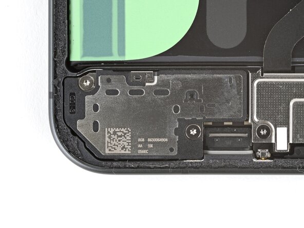

  16. Google Pixel 10 Pro Bottom Speaker Replacement, Remove the bottom speaker screws: crwdns2935265:016crwdnd2935265:01crwdnd2935265:02crwdne2935265:0 Google Pixel 10 Pro Bottom Speaker Replacement, Remove the bottom speaker screws: crwdns2935265:016crwdnd2935265:02crwdnd2935265:02crwdne2935265:0
    • Use a Torx Plus 3IP screwdriver to remove the two 5.0 mm‑long screws securing the bottom speaker.
  17. Google Pixel 10 Pro Bottom Speaker Replacement, Remove the bottom speaker: crwdns2935265:017crwdnd2935265:01crwdnd2935265:02crwdne2935265:0 Google Pixel 10 Pro Bottom Speaker Replacement, Remove the bottom speaker: crwdns2935265:017crwdnd2935265:02crwdnd2935265:02crwdne2935265:0
    • Pull the speaker towards the top of the phone and remove it.
