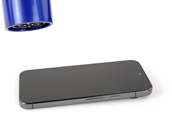

  3. Google Pixel 10 Pro Screen Replacement, Heat the screen: crwdns2935265:03crwdnd2935265:01crwdnd2935265:03crwdne2935265:0 Google Pixel 10 Pro Screen Replacement, Heat the screen: crwdns2935265:03crwdnd2935265:02crwdnd2935265:03crwdne2935265:0 Google Pixel 10 Pro Screen Replacement, Heat the screen: crwdns2935265:03crwdnd2935265:03crwdnd2935265:03crwdne2935265:0
    • Adhesive secures the screen to the frame. Heating the screen softens the adhesive, making it easier to separate.
    • Use a hair dryer, heat gun, or heat pad to heat the entire screen until it's almost too hot to touch.
    • Improper use of a heat gun can destroy the display and/or battery—follow the linked instructions carefully.
    • If you're using a heat pad, set it to 60° C (140° F) and place your phone screen side down for 10 minutes.

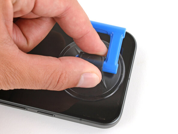

  4. Google Pixel 10 Pro Screen Replacement, Apply a suction handle: crwdns2935265:04crwdnd2935265:01crwdnd2935265:02crwdne2935265:0 Google Pixel 10 Pro Screen Replacement, Apply a suction handle: crwdns2935265:04crwdnd2935265:02crwdnd2935265:02crwdne2935265:0
    • Apply a suction handle to the center of the screen's top edge, as close to the edge as possible.

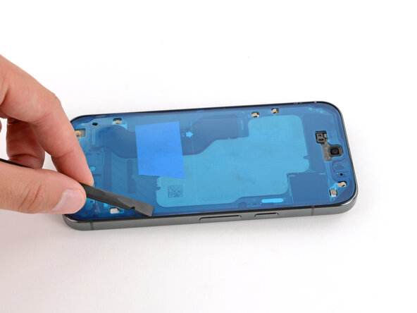

  14. Google Pixel 10 Pro Screen Replacement, Clean the frame: crwdns2935265:014crwdnd2935265:01crwdnd2935265:02crwdne2935265:0 Google Pixel 10 Pro Screen Replacement, Clean the frame: crwdns2935265:014crwdnd2935265:02crwdnd2935265:02crwdne2935265:0
    • Before installing adhesive, all the old adhesive must be completely removed from the frame.
    • Take your time during the next two steps. A clean frame allows replacement adhesive to lay totally flat, ensuring a better seal for your new screen.
  15. Google Pixel 10 Pro Screen Replacement: crwdns2935265:015crwdnd2935265:01crwdnd2935265:03crwdne2935265:0 Google Pixel 10 Pro Screen Replacement: crwdns2935265:015crwdnd2935265:02crwdnd2935265:03crwdne2935265:0 Google Pixel 10 Pro Screen Replacement: crwdns2935265:015crwdnd2935265:03crwdnd2935265:03crwdne2935265:0
    • This step will take some time, as removing the adhesive can be very tricky.
    • Use the point of a spudger to remove all the old screen adhesive from the frame. Try to "roll" the adhesive onto itself so it balls up, making it easier to remove.
    • If you can ball up a big enough chunk, use tweezers to slowly pull the adhesive the opposite way you were scraping with your spudger.

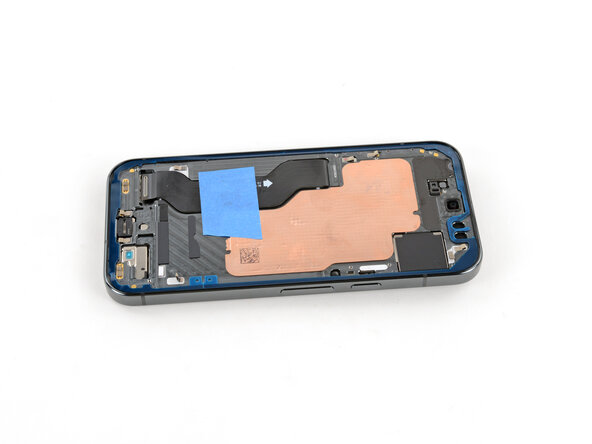

  18. Google Pixel 10 Pro Screen Replacement, Tape the screen cable down: crwdns2935265:018crwdnd2935265:01crwdnd2935265:02crwdne2935265:0 Google Pixel 10 Pro Screen Replacement, Tape the screen cable down: crwdns2935265:018crwdnd2935265:02crwdnd2935265:02crwdne2935265:0
    • The screen cable sticks up off the frame, making it difficult to apply new screen adhesive.
    • Tape the middle of the cable to the frame, making sure the tape isn't covering anywhere the new adhesive will go.

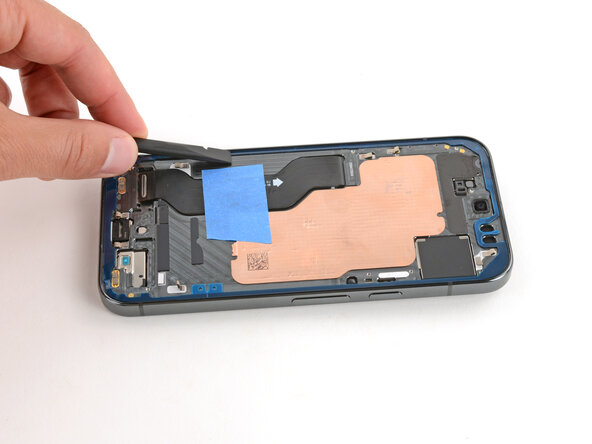

  20. Google Pixel 10 Pro Screen Replacement, Apply the adhesive: crwdns2935265:020crwdnd2935265:01crwdnd2935265:01crwdne2935265:0
    • Peel up the bottom half of the large, clear liner to expose the adhesive—don't fully remove the liner yet.
  21. Google Pixel 10 Pro Screen Replacement: crwdns2935265:021crwdnd2935265:01crwdnd2935265:03crwdne2935265:0 Google Pixel 10 Pro Screen Replacement: crwdns2935265:021crwdnd2935265:02crwdnd2935265:03crwdne2935265:0 Google Pixel 10 Pro Screen Replacement: crwdns2935265:021crwdnd2935265:03crwdnd2935265:03crwdne2935265:0
    • Take your time aligning the adhesive with the frame—it's very sticky and can't be moved after you apply it.
    • With the larger, clear liner folded towards the top of the phone, lay the exposed bottom edge of the adhesive onto the frame.
    • Use the lip of the frame to help align the adhesive.
    • Once the top edge is properly aligned, gently press down on the top corners to secure the adhesive.
  22. Google Pixel 10 Pro Screen Replacement: crwdns2935265:022crwdnd2935265:01crwdnd2935265:03crwdne2935265:0 Google Pixel 10 Pro Screen Replacement: crwdns2935265:022crwdnd2935265:02crwdnd2935265:03crwdne2935265:0 Google Pixel 10 Pro Screen Replacement: crwdns2935265:022crwdnd2935265:03crwdnd2935265:03crwdne2935265:0
    • Slowly lay the rest of the adhesive onto the frame, pressing it into place and peeling away the larger liner as you go.

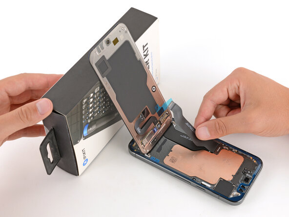

  29. Google Pixel 10 Pro Screen Replacement, Prop up the screen: crwdns2935265:029crwdnd2935265:01crwdnd2935265:01crwdne2935265:0
    • Use a sturdy object to prop up the screen so you can reconnect its cable.
    • Make sure the screen is oriented so it's in the proper position when you flip it back down.
