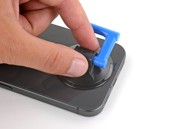

  4. Google Pixel 10 Pro 5G mmWave Antenna Replacement, Apply a suction handle: crwdns2935265:04crwdnd2935265:01crwdnd2935265:02crwdne2935265:0 Google Pixel 10 Pro 5G mmWave Antenna Replacement, Apply a suction handle: crwdns2935265:04crwdnd2935265:02crwdnd2935265:02crwdne2935265:0
    • Apply a suction handle to the center of the back glass's bottom edge, as close to the edge as possible.

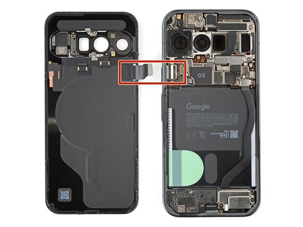

  6. Google Pixel 10 Pro 5G mmWave Antenna Replacement, Back glass adhesive information: crwdns2935265:06crwdnd2935265:01crwdnd2935265:03crwdne2935265:0 Google Pixel 10 Pro 5G mmWave Antenna Replacement, Back glass adhesive information: crwdns2935265:06crwdnd2935265:02crwdnd2935265:03crwdne2935265:0 Google Pixel 10 Pro 5G mmWave Antenna Replacement, Back glass adhesive information: crwdns2935265:06crwdnd2935265:03crwdnd2935265:03crwdne2935265:0
    • The back glass is secured with adhesive around the perimeter of the frame. Use this picture as a reference while you separate the adhesive.
    • A cable connects the back glass near the power button. Don't insert your pick here to avoid damaging the cable.

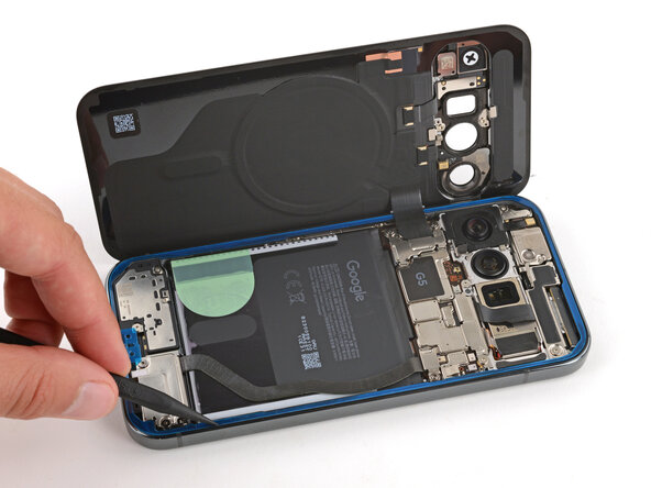

  11. Google Pixel 10 Pro 5G mmWave Antenna Replacement, Prop up the back glass: crwdns2935265:011crwdnd2935265:01crwdnd2935265:03crwdne2935265:0 Google Pixel 10 Pro 5G mmWave Antenna Replacement, Prop up the back glass: crwdns2935265:011crwdnd2935265:02crwdnd2935265:03crwdne2935265:0 Google Pixel 10 Pro 5G mmWave Antenna Replacement, Prop up the back glass: crwdns2935265:011crwdnd2935265:03crwdnd2935265:03crwdne2935265:0
    • Flip the back glass over the left side of the phone and use the suction handle (or a sturdy object) to prop it up.
    • If the back glass still feels stuck, go back around the perimeter with an opening pick and separate any remaining adhesive.

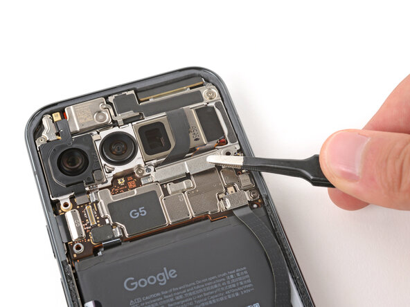

  13. Google Pixel 10 Pro 5G mmWave Antenna Replacement: crwdns2935265:013crwdnd2935265:01crwdnd2935265:03crwdne2935265:0 Google Pixel 10 Pro 5G mmWave Antenna Replacement: crwdns2935265:013crwdnd2935265:02crwdnd2935265:03crwdne2935265:0 Google Pixel 10 Pro 5G mmWave Antenna Replacement: crwdns2935265:013crwdnd2935265:03crwdnd2935265:03crwdne2935265:0
    • Use tweezers to slide the cover towards the center of the phone to unhook the tabs and remove it.
    • Be careful not to damage the battery or rear cameras.

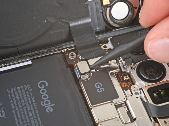

  22. Google Pixel 10 Pro 5G mmWave Antenna Replacement, Disconnect the mmWave antenna: crwdns2935265:022crwdnd2935265:01crwdnd2935265:02crwdne2935265:0 Google Pixel 10 Pro 5G mmWave Antenna Replacement, Disconnect the mmWave antenna: crwdns2935265:022crwdnd2935265:02crwdnd2935265:02crwdne2935265:0
    • Use the point of a spudger to pry up and disconnect the mmWave antenna press connector.

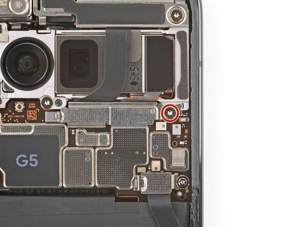

  23. Google Pixel 10 Pro 5G mmWave Antenna Replacement, Remove the mmWave antenna screw: crwdns2935265:023crwdnd2935265:01crwdnd2935265:02crwdne2935265:0 Google Pixel 10 Pro 5G mmWave Antenna Replacement, Remove the mmWave antenna screw: crwdns2935265:023crwdnd2935265:02crwdnd2935265:02crwdne2935265:0
    • Use a Torx Plus 3IP screwdriver to remove the 4.1 mm‑long screw securing the mmWave antenna.

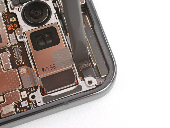

  24. Google Pixel 10 Pro 5G mmWave Antenna Replacement, Remove the mmWave antenna: crwdns2935265:024crwdnd2935265:01crwdnd2935265:02crwdne2935265:0 Google Pixel 10 Pro 5G mmWave Antenna Replacement, Remove the mmWave antenna: crwdns2935265:024crwdnd2935265:02crwdnd2935265:02crwdne2935265:0
    • Remove the mmWave antenna.

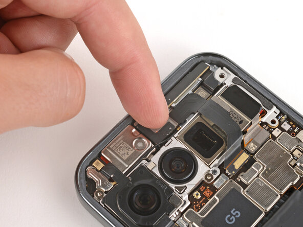

  35. Google Pixel 10 Pro 5G mmWave Antenna Replacement, Connect the front camera: crwdns2935265:035crwdnd2935265:01crwdnd2935265:02crwdne2935265:0 Google Pixel 10 Pro 5G mmWave Antenna Replacement, Connect the front camera: crwdns2935265:035crwdnd2935265:02crwdnd2935265:02crwdne2935265:0
    • Use your finger to press down and reconnect the front camera press connector.

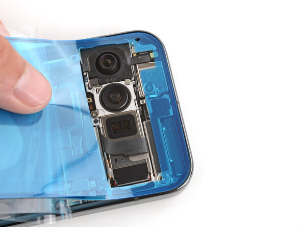

  42. Google Pixel 10 Pro 5G mmWave Antenna Replacement, Orient the adhesive: crwdns2935265:042crwdnd2935265:01crwdnd2935265:02crwdne2935265:0 Google Pixel 10 Pro 5G mmWave Antenna Replacement, Orient the adhesive: crwdns2935265:042crwdnd2935265:02crwdnd2935265:02crwdne2935265:0
    • Before applying the back glass adhesive, make sure you know how it will sit on the frame. If you apply the adhesive incorrectly, you'll need to restart with new adhesive.
    • Hold the adhesive above the frame to find its orientation. Use the rear camera cutout in the liner to help visualize how it will lay in the frame.
  43. Google Pixel 10 Pro 5G mmWave Antenna Replacement: crwdns2935265:043crwdnd2935265:01crwdnd2935265:01crwdne2935265:0
    • Peel down the top half of the large, clear liner to expose the adhesive—don't fully remove the liner yet.
  44. Google Pixel 10 Pro 5G mmWave Antenna Replacement, Install the back glass adhesive: crwdns2935265:044crwdnd2935265:01crwdnd2935265:03crwdne2935265:0 Google Pixel 10 Pro 5G mmWave Antenna Replacement, Install the back glass adhesive: crwdns2935265:044crwdnd2935265:02crwdnd2935265:03crwdne2935265:0 Google Pixel 10 Pro 5G mmWave Antenna Replacement, Install the back glass adhesive: crwdns2935265:044crwdnd2935265:03crwdnd2935265:03crwdne2935265:0
    • Take your time aligning the adhesive with the frame—it's very sticky and can't be moved after you apply it.
    • With the larger, clear liner folded towards the bottom of the phone, lay the exposed top edge of the adhesive onto the frame.
    • Use the lip of the frame to help align the adhesive.
    • Once the top edge is properly aligned, gently press down on the top corners to secure the adhesive.
  45. Google Pixel 10 Pro 5G mmWave Antenna Replacement: crwdns2935265:045crwdnd2935265:01crwdnd2935265:03crwdne2935265:0 Google Pixel 10 Pro 5G mmWave Antenna Replacement: crwdns2935265:045crwdnd2935265:02crwdnd2935265:03crwdne2935265:0 Google Pixel 10 Pro 5G mmWave Antenna Replacement: crwdns2935265:045crwdnd2935265:03crwdnd2935265:03crwdne2935265:0
    • Slowly lay the rest of the adhesive onto the frame, pressing it into place and peeling away the larger liner as you go.

  47. Google Pixel 10 Pro 5G mmWave Antenna Replacement, Remove the larger liner: crwdns2935265:047crwdnd2935265:01crwdnd2935265:03crwdne2935265:0 Google Pixel 10 Pro 5G mmWave Antenna Replacement, Remove the larger liner: crwdns2935265:047crwdnd2935265:02crwdnd2935265:03crwdne2935265:0 Google Pixel 10 Pro 5G mmWave Antenna Replacement, Remove the larger liner: crwdns2935265:047crwdnd2935265:03crwdnd2935265:03crwdne2935265:0
    • Slowly peel up and remove the large colored liner, gripping it from the cutout near the top edge.
    • If the adhesive starts to peel up with the liner, check that you’ve pushed all of it into place with your spudger. If it continues to peel up, hold it down with the point of your spudger as you go.
