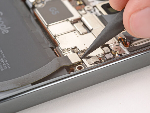

  14. Google Pixel 10 Pro Battery Replacement, Disconnect the back glass: crwdns2935265:014crwdnd2935265:01crwdnd2935265:03crwdne2935265:0 Google Pixel 10 Pro Battery Replacement, Disconnect the back glass: crwdns2935265:014crwdnd2935265:02crwdnd2935265:03crwdne2935265:0 Google Pixel 10 Pro Battery Replacement, Disconnect the back glass: crwdns2935265:014crwdnd2935265:03crwdnd2935265:03crwdne2935265:0
    • Use the point of a spudger to pry up and disconnect the battery and back glass press connectors.

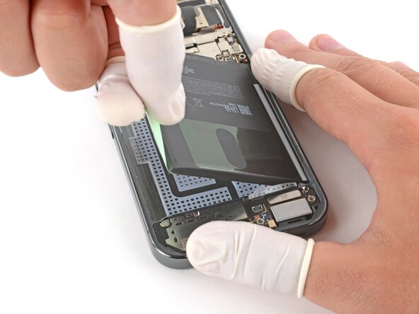

  23. Google Pixel 10 Pro Battery Replacement, Peel up the battery pull tab: crwdns2935265:023crwdnd2935265:01crwdnd2935265:03crwdne2935265:0 Google Pixel 10 Pro Battery Replacement, Peel up the battery pull tab: crwdns2935265:023crwdnd2935265:02crwdnd2935265:03crwdne2935265:0 Google Pixel 10 Pro Battery Replacement, Peel up the battery pull tab: crwdns2935265:023crwdnd2935265:03crwdnd2935265:03crwdne2935265:0
    • Use your fingers to peel up the entire battery tab on the left side of the battery, including the skinny strip running along the side.
  24. Google Pixel 10 Pro Battery Replacement: crwdns2935265:024crwdnd2935265:01crwdnd2935265:01crwdne2935265:0
    Finger Stalls
    $8.99
  25. Google Pixel 10 Pro Battery Replacement, Separate the battery adhesive: crwdns2935265:025crwdnd2935265:01crwdnd2935265:03crwdne2935265:0 Google Pixel 10 Pro Battery Replacement, Separate the battery adhesive: crwdns2935265:025crwdnd2935265:02crwdnd2935265:03crwdne2935265:0 Google Pixel 10 Pro Battery Replacement, Separate the battery adhesive: crwdns2935265:025crwdnd2935265:03crwdnd2935265:03crwdne2935265:0
    • Secure the right side of your phone with one hand, and use your free hand to grip the battery pull tab.
    • Make sure your hand securing the phone is mainly pressing on the frame—it shouldn't be covering the battery or pressing down on delicate components.
    • Pull straight up on the tab and apply constant, steady force until the adhesive separates.

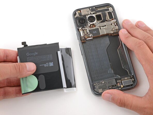

  26. Google Pixel 10 Pro Battery Replacement, Remove the battery: crwdns2935265:026crwdnd2935265:01crwdnd2935265:03crwdne2935265:0 Google Pixel 10 Pro Battery Replacement, Remove the battery: crwdns2935265:026crwdnd2935265:02crwdnd2935265:03crwdne2935265:0 Google Pixel 10 Pro Battery Replacement, Remove the battery: crwdns2935265:026crwdnd2935265:03crwdnd2935265:03crwdne2935265:0
    • Grip the battery and slowly pull it away from your phone to peel the plastic sleeve out of the recess.
    • Remove the battery.

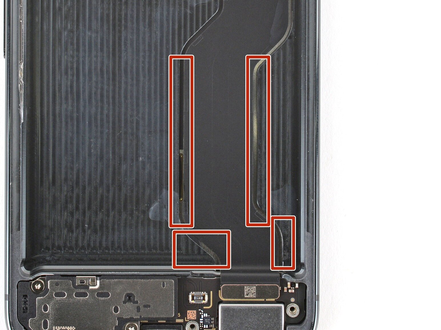

  28. Google Pixel 10 Pro Battery Replacement, Clean the battery recess: crwdns2935265:028crwdnd2935265:01crwdnd2935265:03crwdne2935265:0 Google Pixel 10 Pro Battery Replacement, Clean the battery recess: crwdns2935265:028crwdnd2935265:02crwdnd2935265:03crwdne2935265:0 Google Pixel 10 Pro Battery Replacement, Clean the battery recess: crwdns2935265:028crwdnd2935265:03crwdnd2935265:03crwdne2935265:0
    • Before installing a new battery, check the recess for leftover bits of plastic, as well as adhesive residue from the battery sleeve.
    • If the battery came out cleanly, you can skip this step.
    • Remove any bits of plastic from the old battery sleeve.
    • Use one or two drops high‑concentration (>90%) isopropyl alcohol and a microfiber or lint‑free cloth to clean up any adhesive residue.
    • Be careful not to get alcohol in the cutouts in the battery recess—the bottom of the screen is exposed and may get damaged.
    • Allow the alcohol to dry completely before continuing.

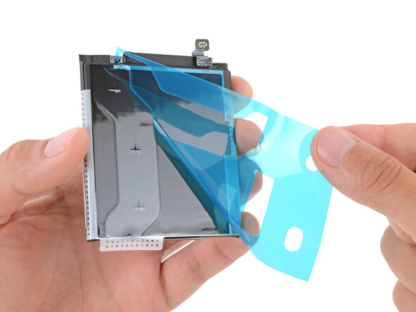

  29. Google Pixel 10 Pro Battery Replacement, Remove the battery liner: crwdns2935265:029crwdnd2935265:01crwdnd2935265:01crwdne2935265:0
    • Remove the large, colored liner from the battery to expose the adhesive.
