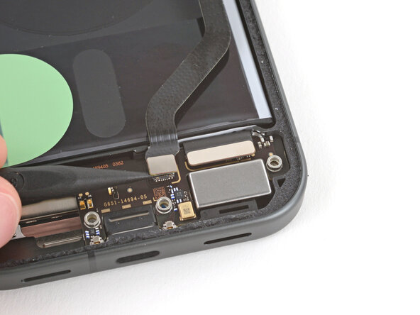

  14. Google Pixel 10 Pro USB‑C Board Replacement, Disconnect the back glass: crwdns2935265:014crwdnd2935265:01crwdnd2935265:03crwdne2935265:0 Google Pixel 10 Pro USB‑C Board Replacement, Disconnect the back glass: crwdns2935265:014crwdnd2935265:02crwdnd2935265:03crwdne2935265:0 Google Pixel 10 Pro USB‑C Board Replacement, Disconnect the back glass: crwdns2935265:014crwdnd2935265:03crwdnd2935265:03crwdne2935265:0
    • Use the point of a spudger to pry up and disconnect the battery and back glass press connectors.

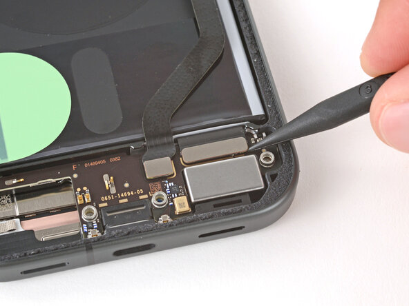

  20. Google Pixel 10 Pro USB‑C Board Replacement, Disconnect the USB‑C board: crwdns2935265:020crwdnd2935265:01crwdnd2935265:03crwdne2935265:0 Google Pixel 10 Pro USB‑C Board Replacement, Disconnect the USB‑C board: crwdns2935265:020crwdnd2935265:02crwdnd2935265:03crwdne2935265:0 Google Pixel 10 Pro USB‑C Board Replacement, Disconnect the USB‑C board: crwdns2935265:020crwdnd2935265:03crwdnd2935265:03crwdne2935265:0
    • Use the point of a spudger to pry up and disconnect the two press connectors from the top edge of the USB‑C board.

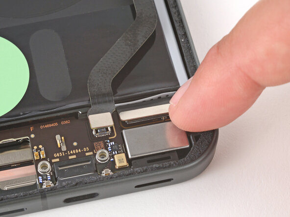

  21. Google Pixel 10 Pro USB‑C Board Replacement: crwdns2935265:021crwdnd2935265:01crwdnd2935265:02crwdne2935265:0 Google Pixel 10 Pro USB‑C Board Replacement: crwdns2935265:021crwdnd2935265:02crwdnd2935265:02crwdne2935265:0
    • Use your finger to gently lift the wider cable near the right edge of the board, so it's out of the way.

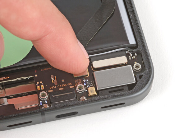

  26. Google Pixel 10 Pro USB‑C Board Replacement, Connect the USB‑C board cables: crwdns2935265:026crwdnd2935265:01crwdnd2935265:03crwdne2935265:0 Google Pixel 10 Pro USB‑C Board Replacement, Connect the USB‑C board cables: crwdns2935265:026crwdnd2935265:02crwdnd2935265:03crwdne2935265:0 Google Pixel 10 Pro USB‑C Board Replacement, Connect the USB‑C board cables: crwdns2935265:026crwdnd2935265:03crwdnd2935265:03crwdne2935265:0
    • Use your finger to press down and connect the two press connectors to the top edge of the USB‑C board.
