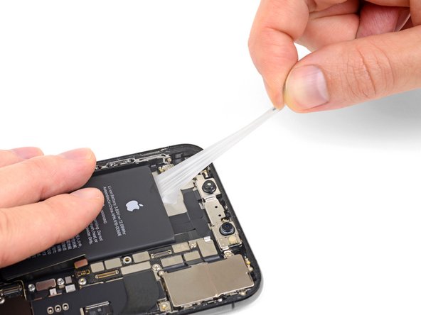

      • Remove four Y000 screws securing the logic board cover bracket, of the following lengths:
      • Two 1.1 mm screws
      • One 1.5 mm screw
      • One 3.7 mm screw
      • Throughout this repair, keep track of each screw and make sure it goes back exactly where it came from to avoid damaging your iPhone.
    2. iPhone XS Max Battery Replacement: crwdns2935265:018crwdnd2935265:01crwdnd2935265:01crwdne2935265:0
      • Remove the bracket.
      • The bracket may be lightly adhered in place. Lift gently but firmly to separate it.
      • During reassembly, this is a good point to power on your iPhone and test all functions before you seal the display in place. Be sure to power your iPhone back down completely before you continue working.
    3. iPhone XS Max Battery Replacement: crwdns2935265:019crwdnd2935265:01crwdnd2935265:02crwdne2935265:0 iPhone XS Max Battery Replacement: crwdns2935265:019crwdnd2935265:02crwdnd2935265:02crwdne2935265:0
      • Use a spudger or a clean fingernail to pry the battery connector up from its socket on the logic board.
      • Try not to damage the black silicone seal surrounding this and other board connections. These seals provide extra protection against water and dust intrusion.
      • Bend the connector slightly away from the logic board to prevent it from accidentally making contact with the socket and providing power to the phone during your repair.

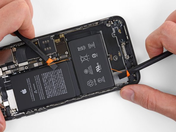

    2. iPhone XS Max Battery Replacement: crwdns2935265:042crwdnd2935265:01crwdnd2935265:02crwdne2935265:0 iPhone XS Max Battery Replacement: crwdns2935265:042crwdnd2935265:02crwdnd2935265:02crwdne2935265:0
      • Separate the first battery adhesive tab from the bottom edge of the battery.
      • Each tab has a small loop in the center; insert a tool through the loop if you're having trouble grabbing hold of the tab.
      • Don't jab the battery with any sharp tools. A punctured battery may leak dangerous chemicals or catch fire.
    3. iPhone XS Max Battery Replacement: crwdns2935265:043crwdnd2935265:01crwdnd2935265:03crwdne2935265:0 iPhone XS Max Battery Replacement: crwdns2935265:043crwdnd2935265:02crwdnd2935265:03crwdne2935265:0 iPhone XS Max Battery Replacement: crwdns2935265:043crwdnd2935265:03crwdnd2935265:03crwdne2935265:0
      • Repeat the above step to separate the remaining two adhesive tabs from the bottom edge of the battery.
      • Take care not to damage the speaker cable connector just below the center adhesive tab.
    4. iPhone XS Max Battery Replacement: crwdns2935265:044crwdnd2935265:01crwdnd2935265:03crwdne2935265:0 iPhone XS Max Battery Replacement: crwdns2935265:044crwdnd2935265:02crwdnd2935265:03crwdne2935265:0 iPhone XS Max Battery Replacement: crwdns2935265:044crwdnd2935265:03crwdnd2935265:03crwdne2935265:0

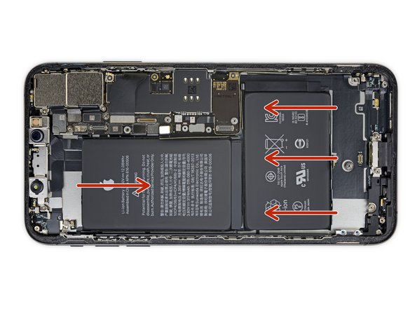

      • In the following steps, you'll pull each tab to slowly stretch out the adhesive underneath the battery. This special stretch-release adhesive loses its tack when stretched and then comes out in your hand, allowing you to lift out the battery with ease.
      • If the strips break, don't panic! They don't always work as intended. Keep reading for some additional steps for removing broken strips.
      • To increase your odds of success:
      • Don't press down on the battery. Hold the iPhone firmly by its sides.
      • Keep the strips flat and unwrinkled as you pull.
      • Pull very slowly, giving the strip time to stretch and separate. It takes around 15-30 seconds of stretching to remove each strip.
      • Pull at a low angle so the strip doesn't snag along the bottom edge of the battery.
      • If a strip does break off underneath the battery and cannot be retrieved, move on to the other strips and then continue with the additional steps below.

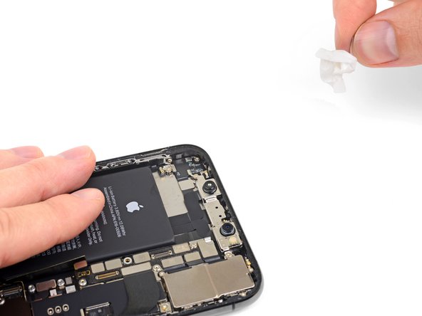

    5. iPhone XS Max Battery Replacement: crwdns2935265:045crwdnd2935265:01crwdnd2935265:03crwdne2935265:0 iPhone XS Max Battery Replacement: crwdns2935265:045crwdnd2935265:02crwdnd2935265:03crwdne2935265:0 iPhone XS Max Battery Replacement: crwdns2935265:045crwdnd2935265:03crwdnd2935265:03crwdne2935265:0
      • Grab one of the outer battery adhesive tabs and slowly pull it away from the battery, toward the bottom of the iPhone.
      • Pull steadily, maintaining constant tension on the strip until it slips out from between the battery and the rear case.
      • The strip will stretch to many times its original length. Continue pulling and re-grab the strip near the battery if necessary.
      • If the battery adhesive tabs break during the removal process, use your fingers or blunt tweezers to retrieve the remaining length of adhesive, and continue pulling.
      • If any of the adhesive strips break underneath the battery and cannot be retrieved, try to remove the remaining strips, and then proceed as instructed below.

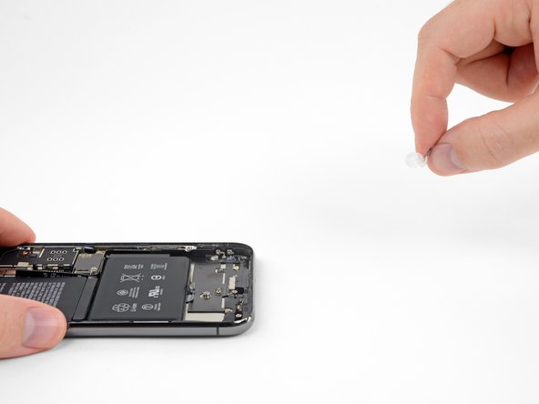

    6. iPhone XS Max Battery Replacement: crwdns2935265:046crwdnd2935265:01crwdnd2935265:03crwdne2935265:0 iPhone XS Max Battery Replacement: crwdns2935265:046crwdnd2935265:02crwdnd2935265:03crwdne2935265:0 iPhone XS Max Battery Replacement: crwdns2935265:046crwdnd2935265:03crwdnd2935265:03crwdne2935265:0
      • Repeat the previous step to remove the strip on the opposite side, leaving the center strip for last.

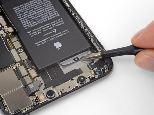

    8. iPhone XS Max Battery Replacement: crwdns2935265:048crwdnd2935265:01crwdnd2935265:02crwdne2935265:0 iPhone XS Max Battery Replacement: crwdns2935265:048crwdnd2935265:02crwdnd2935265:02crwdne2935265:0
      • The final pull tab lies very close to the Face ID hardware. If damaged, Face ID can only be repaired by Apple, so work with care.
      • Peel and separate the pull tab on the final adhesive strip, on the top edge of the upper battery cell.

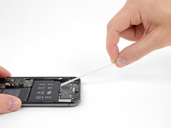

    9. iPhone XS Max Battery Replacement: crwdns2935265:049crwdnd2935265:01crwdnd2935265:03crwdne2935265:0 iPhone XS Max Battery Replacement: crwdns2935265:049crwdnd2935265:02crwdnd2935265:03crwdne2935265:0 iPhone XS Max Battery Replacement: crwdns2935265:049crwdnd2935265:03crwdnd2935265:03crwdne2935265:0
      • Pull and remove the final adhesive strip.
      • The strip may fling the battery when it separates from the iPhone, so hold your hand over the battery to secure it—but don't press down on the battery itself, or the added pressure may cause the adhesive strip to break off underneath the battery.
      • If you removed all four adhesive strips successfully, skip the next step.
