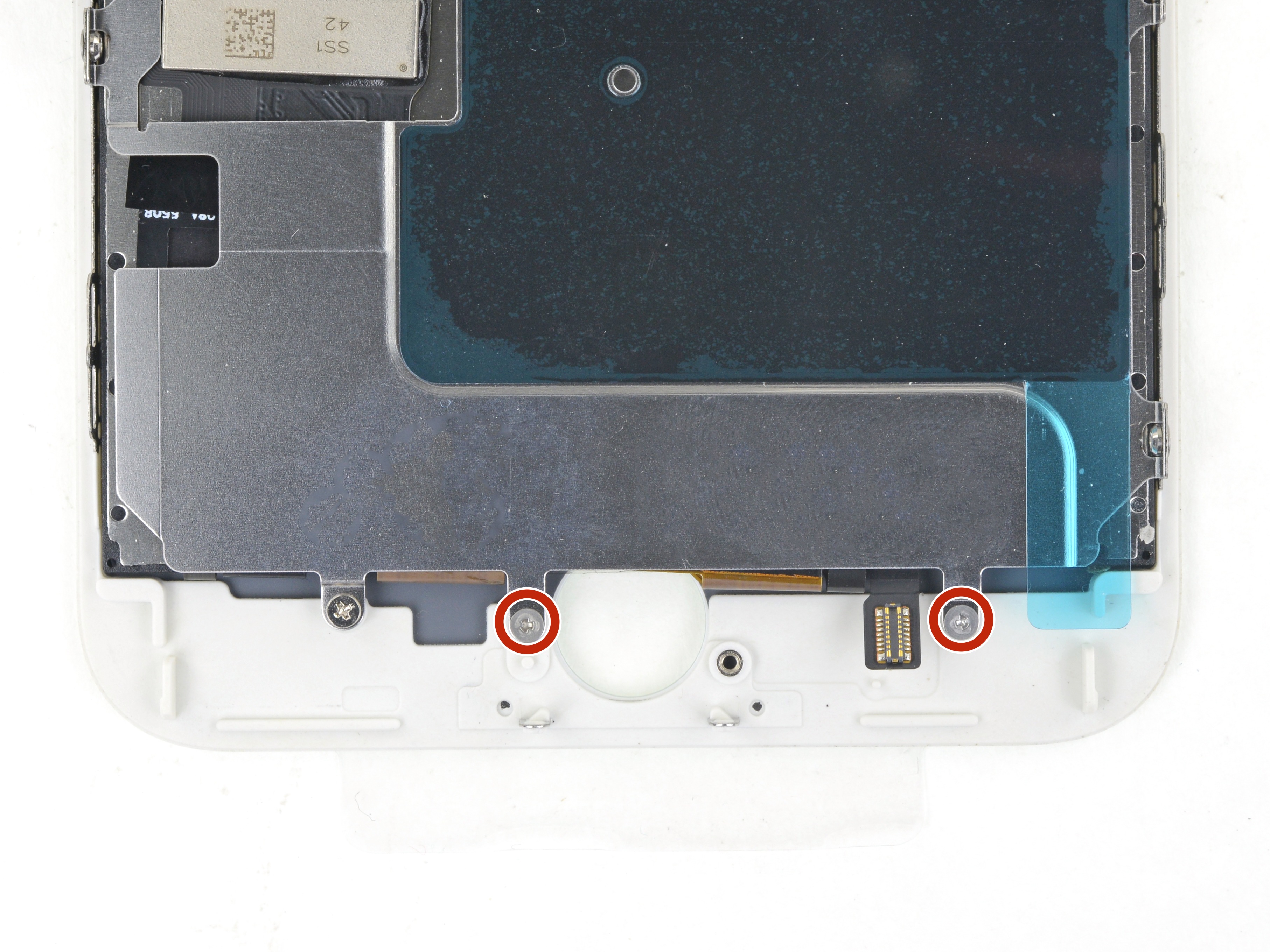

    1. iPhone 8 Plus Screen Replacement, Home/Touch ID Sensor: crwdns2935265:027crwdnd2935265:01crwdnd2935265:02crwdne2935265:0 iPhone 8 Plus Screen Replacement, Home/Touch ID Sensor: crwdns2935265:027crwdnd2935265:02crwdnd2935265:02crwdne2935265:0
      • Remove the four Y000 screws securing the bracket over the home/Touch ID sensor:
      • One 1.2 mm screw
      • Three 1.3 mm screws
      • During reassembly, be careful not to overtighten these screws, or your home button may not work.
    2. iPhone 8 Plus Screen Replacement: crwdns2935265:028crwdnd2935265:01crwdnd2935265:01crwdne2935265:0
      • Remove the bracket that secures the home/Touch ID sensor.
