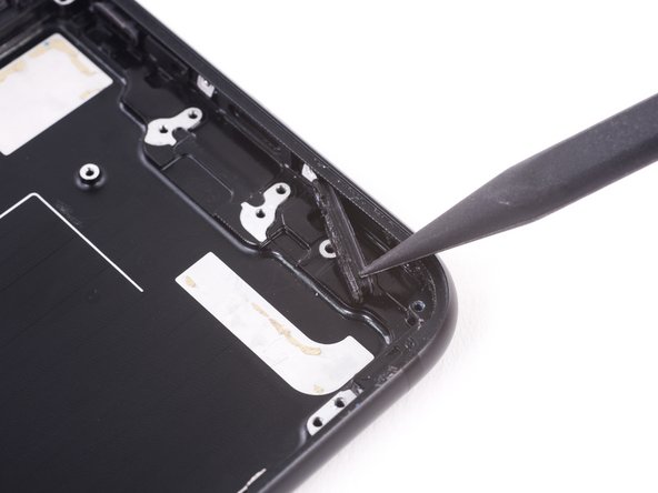

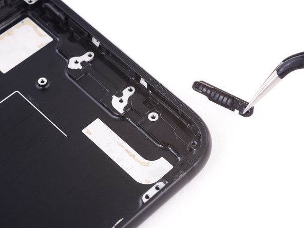

    1. iPhone 7 Rear Case Replacement, Barometric Vent: crwdns2935265:023crwdnd2935265:01crwdnd2935265:01crwdne2935265:0
      • Remove the two 1.9 mm Phillips screws securing the barometric vent to the rear case.
    2. iPhone 7 Rear Case Replacement: crwdns2935265:024crwdnd2935265:01crwdnd2935265:02crwdne2935265:0 iPhone 7 Rear Case Replacement: crwdns2935265:024crwdnd2935265:02crwdnd2935265:02crwdne2935265:0
      • Remove the vent.

    4. iPhone 7 Rear Case Replacement: crwdns2935265:099crwdnd2935265:01crwdnd2935265:02crwdne2935265:0 iPhone 7 Rear Case Replacement: crwdns2935265:099crwdnd2935265:02crwdnd2935265:02crwdne2935265:0
      • Slide the flat end of a spudger underneath the bottom edge of the volume button bracket.
      • Adjust the spudger so that it can move away from the rear case without contacting the protruding peg that is on the volume button.
      • Rotate the spudger to pop the bracket off of the peg on the volume button.

    1. iPhone 7 Rear Case Replacement, Rear Case: crwdns2935265:0103crwdnd2935265:01crwdnd2935265:03crwdne2935265:0 iPhone 7 Rear Case Replacement, Rear Case: crwdns2935265:0103crwdnd2935265:02crwdnd2935265:03crwdne2935265:0 iPhone 7 Rear Case Replacement, Rear Case: crwdns2935265:0103crwdnd2935265:03crwdnd2935265:03crwdne2935265:0
      • Use the point of a spudger to push the left rubber speaker vent out of the rear case.
    2. iPhone 7 Rear Case Replacement: crwdns2935265:0104crwdnd2935265:01crwdnd2935265:01crwdne2935265:0
      • Remove the right rubber speaker vent from the rear case.
