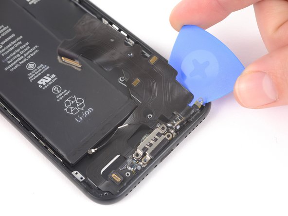

  2. iPhone 7 Lightning Connector Assembly Replacement, Mark your opening picks: crwdns2935265:02crwdnd2935265:01crwdnd2935265:03crwdne2935265:0 iPhone 7 Lightning Connector Assembly Replacement, Mark your opening picks: crwdns2935265:02crwdnd2935265:02crwdnd2935265:03crwdne2935265:0 iPhone 7 Lightning Connector Assembly Replacement, Mark your opening picks: crwdns2935265:02crwdnd2935265:03crwdnd2935265:03crwdne2935265:0
    • If inserted too far, an opening pick can damage your device. Follow this step to mark your pick and prevent damage.
    • Measure 3 mm from the tip and mark the opening pick with a permanent marker.
    • You can also mark the other corners of the pick with different measurements.
    • Alternatively, tape a coin to a pick 3 mm from the tip.
    Got to step 2 and realized the fix kit doesn't include an opening pick! Looks like a guitar pick, and I have those lying around. Is that expected? Looks like the pick is used in many steps below. There's a little blue crowbar that isn't mentioned in the instructions. Perhaps that replaces the opening pick?

    Make sure you check inside the black boxes after emptying them. My pick was stuck inside one of the boxes.
    AndyF - crwdns2934203:0crwdne2934203:0
    My AliExpress refurbished screen came with a pick that has a coin-like circle that pops out, so no modification was necessary
    Gijs Leegwater - crwdns2934203:0crwdne2934203:0
    the picture shows 3 cm but the description says 3 mm's. Which one is it?
    John Pena - crwdns2934203:0crwdne2934203:0
    That is a misunderstanding. It is a ruler with a scale for cm, it shows 0.3 cm, i.e. 3 mm.

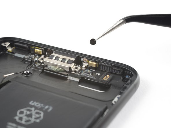

  16. iPhone 7 Lightning Connector Assembly Replacement, Battery Disconnection: crwdns2935265:016crwdnd2935265:01crwdnd2935265:01crwdne2935265:0
    Tri-point Y000 Screwdriver
    $5.99
    Ahhh shoot! accidentally ordered tri-wing vs tri-point (must have just looked for y000).. It seems they only did this to annoy repair folks because not everything is tri-point on the phone...
    Steve - crwdns2934203:0crwdne2934203:0
    These screws just spin for me. They don't back out, but the heads aren't stripped either. I've tried applying backpressure to help lift the screws, but no luck
    Jeff Hurst - crwdns2934203:0crwdne2934203:0
    The Y000 took out one of the screws but not the other 3. I even tried the PH000 as suggested but nothing.
    dbright - crwdns2934203:0crwdne2934203:0
    What driver do I need to remove these screws i’m stuck
    Nasser Nader - crwdns2934203:0crwdne2934203:0
    i cant use, the Y000 it isnt working.
    joscarlos91 - crwdns2934203:0crwdne2934203:0
    What if I stripped a screw what do I do??
    Jacob Ramos - crwdns2934203:0crwdne2934203:0
    Yep, only the 2.4mm came out, other 3 won’t budge, and worried I’ve stripped the heads. Anyone got any ideas?
    Stephen Babbage - crwdns2934203:0crwdne2934203:0
    It’s the screwdriver bit that is the problem. I had the same issue with 2 Y000 bits not grabbing the screw properly. I fixed it by using a small 3 sided file to slightly grind the groves in the Y000 bit just a bit deeper. Then the bit worked like a charm on these screws.
    Jim Staples - crwdns2934203:0crwdne2934203:0
    Use Y000 on all 4. U have to be very sensitive on the 1.2mm screws. Put the bit in the screw, put the left pointing finger on top of the screwdriver and turn the driver carefully to the right until you feel a “bump”, thats the trick :-), then you are able to screw the screw out.
    Magne Eivindson - crwdns2934203:0crwdne2934203:0
    For me the key here was a LOT of downward pressure to ensure the Y000 bit caught in the screw. Not sure i can describe how much exactly, but is was significant. Otherwise the bit would not catch.
    Erik Fredriksen - crwdns2934203:0crwdne2934203:0
    What do I do if I Stripped one of them?
    Adam Corral - crwdns2934203:0crwdne2934203:0
    Can’t get them removed what to do ?
    cowling_luke - crwdns2934203:0crwdne2934203:0
    Managed to get the central one out. The upper one won't move, the lower one I've popped out with some force. This allows you to rotate the cover enough to unplug the various bits. Not ideal, but works. I've tried applying a lot of pressure, using the tighten/ loosen method, but the heads have just got mashed… no wonder Samsung are now No1, sigh…
    jimpoolio - crwdns2934203:0crwdne2934203:0
    You need to be careful when just rotating the cover as you can accidentally slice through the two black antennas! You only need to nip them…As you can tell I have done this in the past :/
    Kyle Webb -
    The first, longer screw came out fine, but the other three wouldn’t budge, regardless of more/less pressure or a slight angle or anything. I finally filed down the tip of the Y000 bit ever so slightly, and then it worked. Hope this helps someone.
    Harmony - crwdns2934203:0crwdne2934203:0
    Filing down the bit worked for me. The tip about putting an index finger on the end of the screwdriver handles and then turning gently until it clicks into place was very helpful! Using these 2 tips I didn't need much downward pressure. Screws are out in a few turns.
    Chris Bennett - crwdns2934203:0crwdne2934203:0
    If you can’t get the bit to grip the screw properly, you can use a little bit of the water-proof sealing between the bit and the screw. That worked for me. Hope this helps anyone.
    jvalaamo - crwdns2934203:0crwdne2934203:0
    Mine came out easily. I placed the screws in the area where the bit goes in my kit so I can keep track.
    Gina Torres - crwdns2934203:0crwdne2934203:0
    I used a bunch of medicine cups to track my screws. You need like 12 if you want them all in cups. I ran out. There are so many different sizes that literally vary by 1mm. The tolerances on these things are tight.
    Ray Bieze - crwdns2934203:0crwdne2934203:0
    I use a 28 day pill box and keep every screw separate and reburn to exact slot because they all vary in length, width and can really damage u phone if too long and nt secure if to small.  use a magnetised screwdriver,  or make the cheap freebees magnetic for a short period by rubbing it up an a magnet. lol
    scallyteacher - crwdns2934203:0crwdne2934203:0
    Absolutely ridiculous had to go get a different one just stupid
    mark golling - crwdns2934203:0crwdne2934203:0
    I couldn’t get the lowest one out and just turned the metal bracket out of the way and replaced battery.
    qwerty77x - crwdns2934203:0crwdne2934203:0
    Was able to get the outer bracket screws out using fine needle nose pliers 90 degrees straight down for the outer ones by pressing down a little and using medium gripping force. Had to take these out first before i could use tweezers on the middle one, for which I had to use tweezers to hold the screw, then rotating the bracket (not the screw) counter clockwise a few mm many times over to slowly unscrew it 1/32th of a turn at a time, repeat. (this loosened middle screw). Think ‘rotating bracket 3minutes/degrees counterclockwise at a time while holding screw in place.) You are gonna need really small/fine pliers and tweezers for this because the heads are countersunk into the bracket.
    Galen Wollenberg - crwdns2934203:0crwdne2934203:0
    The top screw in the step was much longer than 1.2mm. It has the same head as the 1.2mm, but different than the 2.4mm. It’s good to keep track of where they came from.
    All are so small that I thought I’d lost one, when it was still sitting in the phone.
    Mark - crwdns2934203:0crwdne2934203:0
    To help tell if the screw is turning, put a small dot from a marker on the head of the screws.  This helped me to know I wasn't just stripping the head.
    Darren Thibodaux - crwdns2934203:0crwdne2934203:0
    try heating the iPhone with a hairdryer or a bag of rice or about 60 degrees in an oven for 3 minutes . It has worked for me. If the screws don’t come out while hot the will come out as the iPhone cools.
    David Howard - crwdns2934203:0crwdne2934203:0
    A small tapered triangle file using moderate pressure did the trick for me.
    Jack - crwdns2934203:0crwdne2934203:0
    I think these screws are Y0000, not Y000. I also used a triangular file to get the tip small enough to work (I bought the file in the 1970's, when I was working on vehicles).
    NOTE. The admonition to keep track of the screws should be above the step to remove the screws.

  17. iPhone 7 Lightning Connector Assembly Replacement: crwdns2935265:017crwdnd2935265:01crwdnd2935265:01crwdne2935265:0
    • Remove the lower connector bracket.
    my battery cable connector was stuck to the bottom of this metal bracket plate so be careful when you lift it off

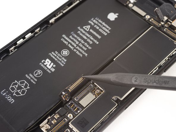

  18. iPhone 7 Lightning Connector Assembly Replacement: crwdns2935265:018crwdnd2935265:01crwdnd2935265:03crwdne2935265:0 iPhone 7 Lightning Connector Assembly Replacement: crwdns2935265:018crwdnd2935265:02crwdnd2935265:03crwdne2935265:0 iPhone 7 Lightning Connector Assembly Replacement: crwdns2935265:018crwdnd2935265:03crwdnd2935265:03crwdne2935265:0
    • Use the point of a spudger to lift the battery connector out of its socket on the logic board.
    • Bend the connector cable up slightly to prevent it from making contact with the socket and providing power to the phone.
    Was kann passieren wenn man diesses Kabel vergessen hat zu entfernen `?
    Julian Eltrich - crwdns2934203:0crwdne2934203:0
    Reconnecting the battery poorly can cause the iPhone to appear to be properly powered and functional, but then suffer a reboot loop.
    I had difficulty after a screen replacement, and the Console app on my Mac showed that the ‘thermalmonitord’ process was throwing lots of errors from not getting any sensor readings from the battery. It would never charge past 1% and just kept rebooting.
    The contacts on this conector looked fine so even though I had reseated this connector several times already, I reconnected it very firmly using my thumb and a spudger to really press all the corners and middle and really gave it a good massage and then finally it showed the normal dead battery screen and started properly charging and eventually booted back up to normal functionality.
    It seems the battery has to be able to transmit data to the phone to say it’s not overheating or iOS will not allow any current into the battery to recharge it, and the kernel will panic from the null readings and just reboot over and over again.
    jason - crwdns2934203:0crwdne2934203:0
    In my case, the battery connector was attached to the bracket. We just left it connected bracket when we pryed it up.
    Dave Miller - crwdns2934203:0crwdne2934203:0
    Reconnecting the battery connector was a bit difficult in my case. The cable that comes out of the battery was a tiny bit too long, or that I placed the battery a bit too high (i.e., too close to the top of the phone). It took me several frustrating minutes of fiddling with the connector for it to sit right into the socket. I was not sure if that was connected correctly but, alas, the phone came back to life when it was turned back on.
    Tomoharu Eguchi - crwdns2934203:0crwdne2934203:0
    VERY IMPORTANT NOTE: Please READ the reply here by jason.
    It is very easy to knock off or nudge the little pins near the battery socket, see https://guide-images.cdn.ifixit.com/igi/... and https://guide-images.cdn.ifixit.com/igi/....
    Those pins are the data lines to extract battery info: temperature, charge, etc. If you accidentally nudge/knock off them the phone could appear to work normally, even for a few days. But then you will start getting wrong battery reads and then after that it may suffer a reboot loop. If you enter settings > privacy > analytics & improvements and you scroll down you will find panic errors from thermalmonitord that there are missing sensors (TG0B or TGXXX) and you will have to micro solder them. DO NOT NUDGE THEM and double check the socket connector when reconnecting the battery.

    When removing the screen, be aware of the two tiny square black rubber grommets on the Penelope screw brackets that secure the screen. They can fall off very easily and be lost without even knowing it (it happened to me, but was lucky enough to find them).
    Guy Cooley - crwdns2934203:0crwdne2934203:0

    ** also remove the small Phillips screw fastening the WiFi antenna to the top rear casing of the phone
    iBroke - crwdns2934203:0crwdne2934203:0

    %#*@, lost that part during the job, thought it’d be alright without it. Couple days later figured out NFC doesn’t work anymore. Any ideas on where to get this part from, colleagues?
    azowux - crwdns2934203:0crwdne2934203:0

    Reassembly note:
    Peel up a couple centimeters of the lightening port and plug it in to the logic board *before* seating the logic board. Doing this, you can perfectly line up the connector and hold it to the board as you jimmy everything in to place. This makes the hardest part of the job a no-brainer.
    jason4 - crwdns2934203:0crwdne2934203:0

  55. iPhone 7 Lightning Connector Assembly Replacement: crwdns2935265:055crwdnd2935265:01crwdnd2935265:02crwdne2935265:0 iPhone 7 Lightning Connector Assembly Replacement: crwdns2935265:055crwdnd2935265:02crwdnd2935265:02crwdne2935265:0

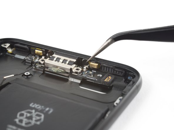

    • Remove the spring contact from the lightning connector.
    What’s the purpose of this contact? Is it just a ground?
    Josh M - crwdns2934203:0crwdne2934203:0
    Not sure but dont forget to place it
    Josh Brito - crwdns2934203:0crwdne2934203:0
    I forfait it, watt I have to search for buy it
    TONY IDEA - crwdns2934203:0crwdne2934203:0
    Scary thought - did you manage to find one?

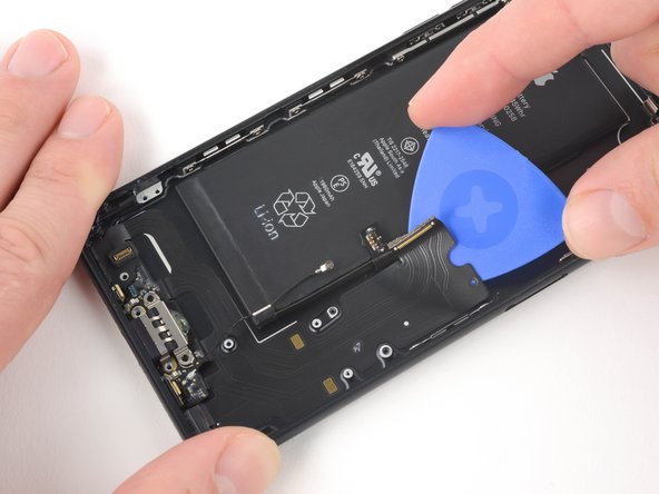

  60. iPhone 7 Lightning Connector Assembly Replacement: crwdns2935265:060crwdnd2935265:01crwdnd2935265:01crwdne2935265:0
    • Heating the lower edge of the iPhone will help soften the adhesive securing Lightning connector cable, making it easier to remove.
    • Use a hairdryer or reheat your iOpener to heat the lower edge of the phone.
    • Wait for about a minute, allowing the adhesive to warm up before proceeding to the next step.
  61. iPhone 7 Lightning Connector Assembly Replacement: crwdns2935265:061crwdnd2935265:01crwdnd2935265:03crwdne2935265:0 iPhone 7 Lightning Connector Assembly Replacement: crwdns2935265:061crwdnd2935265:02crwdnd2935265:03crwdne2935265:0 iPhone 7 Lightning Connector Assembly Replacement: crwdns2935265:061crwdnd2935265:03crwdnd2935265:03crwdne2935265:0
    • Starting from the middle of the phone, slide an opening pick underneath the lightning connector to separate it from the rear case.
  62. iPhone 7 Lightning Connector Assembly Replacement: crwdns2935265:062crwdnd2935265:01crwdnd2935265:03crwdne2935265:0 iPhone 7 Lightning Connector Assembly Replacement: crwdns2935265:062crwdnd2935265:02crwdnd2935265:03crwdne2935265:0 iPhone 7 Lightning Connector Assembly Replacement: crwdns2935265:062crwdnd2935265:03crwdnd2935265:03crwdne2935265:0

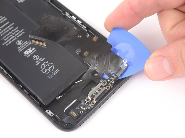

    • Continue to slide the pick towards the lightning connector to further separate the assembly from the rear case.
  63. iPhone 7 Lightning Connector Assembly Replacement: crwdns2935265:063crwdnd2935265:01crwdnd2935265:02crwdne2935265:0 iPhone 7 Lightning Connector Assembly Replacement: crwdns2935265:063crwdnd2935265:02crwdnd2935265:02crwdne2935265:0
    • Continue to slide the pick underneath the lightning connecter assembly.
    • Stop sliding the pick once it passes the battery.
    Could I use something like an hotel card instead?
    Kenneth Wang - crwdns2934203:0crwdne2934203:0

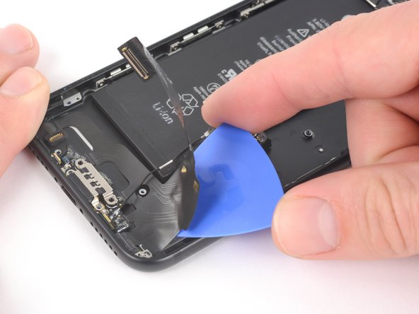

  64. iPhone 7 Lightning Connector Assembly Replacement: crwdns2935265:064crwdnd2935265:01crwdnd2935265:03crwdne2935265:0 iPhone 7 Lightning Connector Assembly Replacement: crwdns2935265:064crwdnd2935265:02crwdnd2935265:03crwdne2935265:0 iPhone 7 Lightning Connector Assembly Replacement: crwdns2935265:064crwdnd2935265:03crwdnd2935265:03crwdne2935265:0
    • Starting at the corner of the phone, slide the pick underneath the assembly towards the lightning connector.
    • Stop sliding the pick when it reaches the lightning connector.

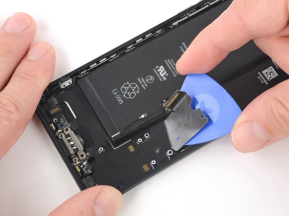

  65. iPhone 7 Lightning Connector Assembly Replacement: crwdns2935265:065crwdnd2935265:01crwdnd2935265:02crwdne2935265:0 iPhone 7 Lightning Connector Assembly Replacement: crwdns2935265:065crwdnd2935265:02crwdnd2935265:02crwdne2935265:0
    • Gently pull the lightning connector out of its hole on the rear case.
  66. iPhone 7 Lightning Connector Assembly Replacement: crwdns2935265:066crwdnd2935265:01crwdnd2935265:02crwdne2935265:0 iPhone 7 Lightning Connector Assembly Replacement: crwdns2935265:066crwdnd2935265:02crwdnd2935265:02crwdne2935265:0
    • Slide a pick below the lightning connector to further separate the lightning connector assembly from the rear case.
    • Continue to slide the pick until the lightning connector assembly is no longer adhered to the rear case.
    Getting this thing out really wasn’t that big of a deal. Of note, if you’re also replacing the batter this is a good spot to put the new one in.
