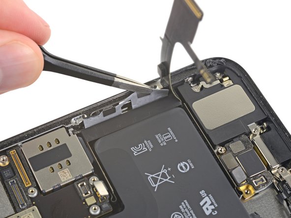

    1. iPhone 11 Pro Battery Replacement, Unscrew the flex cable bracket: crwdns2935265:031crwdnd2935265:01crwdnd2935265:02crwdne2935265:0 iPhone 11 Pro Battery Replacement, Unscrew the flex cable bracket: crwdns2935265:031crwdnd2935265:02crwdnd2935265:02crwdne2935265:0
      • Use a Y000 driver to remove the two 1.4 mm screws securing the Lightning flex cable bracket.
    2. iPhone 11 Pro Battery Replacement, Remove the flex cable bracket: crwdns2935265:032crwdnd2935265:01crwdnd2935265:01crwdne2935265:0
      • Remove the flex cable bracket.
    3. iPhone 11 Pro Battery Replacement, Disconnect the Lightning flex cable: crwdns2935265:033crwdnd2935265:01crwdnd2935265:03crwdne2935265:0 iPhone 11 Pro Battery Replacement, Disconnect the Lightning flex cable: crwdns2935265:033crwdnd2935265:02crwdnd2935265:03crwdne2935265:0 iPhone 11 Pro Battery Replacement, Disconnect the Lightning flex cable: crwdns2935265:033crwdnd2935265:03crwdnd2935265:03crwdne2935265:0
      • Pry up to disconnect both of the Lightning flex cable connectors from the Logic board.
    4. iPhone 11 Pro Battery Replacement, Push the flex cable aside: crwdns2935265:034crwdnd2935265:01crwdnd2935265:02crwdne2935265:0 iPhone 11 Pro Battery Replacement, Push the flex cable aside: crwdns2935265:034crwdnd2935265:02crwdnd2935265:02crwdne2935265:0
      • Gently lift the Lightning flex cable and bend it slightly toward the bottom edge of the iPhone for better access to the battery underneath.

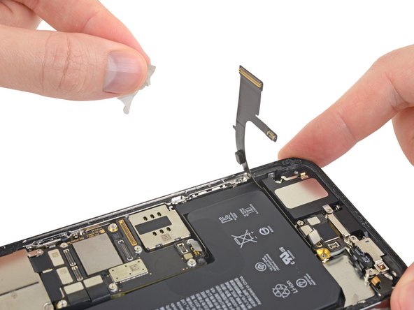

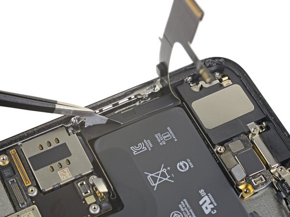

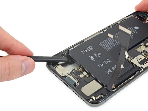

    5. iPhone 11 Pro Battery Replacement, Locate the adhesive pull-tabs: crwdns2935265:035crwdnd2935265:01crwdnd2935265:03crwdne2935265:0 iPhone 11 Pro Battery Replacement, Locate the adhesive pull-tabs: crwdns2935265:035crwdnd2935265:02crwdnd2935265:03crwdne2935265:0 iPhone 11 Pro Battery Replacement, Locate the adhesive pull-tabs: crwdns2935265:035crwdnd2935265:03crwdnd2935265:03crwdne2935265:0
      • The battery is secured to the rear case with three pieces of stretch-release adhesive—one near the bottom edge of the battery, one near the top, and one on the right.
      • Each piece of adhesive has one or two black pull-tabs at the end, which are lightly adhered to the side edges of the battery.
      • In the following steps, you'll pull each tab to slowly stretch out the adhesive underneath the battery. These "command-strip" style adhesives lose their stick when stretched, so you can remove the battery with ease.
      • If the strips break, don't panic! They don't always work as intended. Keep reading for tips on removing broken strips.

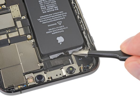

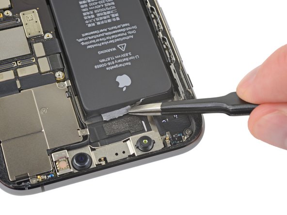

    6. iPhone 11 Pro Battery Replacement: crwdns2935265:036crwdnd2935265:01crwdnd2935265:02crwdne2935265:0 iPhone 11 Pro Battery Replacement: crwdns2935265:036crwdnd2935265:02crwdnd2935265:02crwdne2935265:0
      • Peel down the first battery adhesive pull-tab to un-stick it from the bottom edge of the battery.
      • Don't jab the battery with any sharp tools. A punctured battery may leak dangerous chemicals or catch fire.

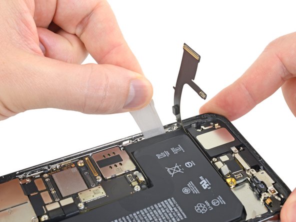

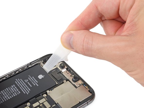

    7. iPhone 11 Pro Battery Replacement, Remove the bottom adhesive strip: crwdns2935265:037crwdnd2935265:01crwdnd2935265:03crwdne2935265:0 iPhone 11 Pro Battery Replacement, Remove the bottom adhesive strip: crwdns2935265:037crwdnd2935265:02crwdnd2935265:03crwdne2935265:0 iPhone 11 Pro Battery Replacement, Remove the bottom adhesive strip: crwdns2935265:037crwdnd2935265:03crwdnd2935265:03crwdne2935265:0
      • Grab the pull tab with your fingers and slowly pull it away from the battery, toward the bottom of the iPhone.
      • Pull hard enough to maintain tension on the strip, but don't force it. Give it plenty of time to stretch and un-stick from under the battery.
      • Don't press down on the battery. Hold the iPhone firmly by its sides.
      • Keep the strip flat and unwrinkled. Try to pull evenly on the whole strip, rather than pulling mainly in the middle or on one side.
      • Pull at a low angle so the strip doesn't snag on the edge of the battery.
      • If the adhesive strip breaks off, try to retrieve it using your fingers or blunt tweezers, and continue pulling—but do not pry under the battery.
      • If any of the adhesive strips break off underneath the battery and can't be retrieved, try to remove the other strips, and then proceed as instructed below.
    8. iPhone 11 Pro Battery Replacement: crwdns2935265:038crwdnd2935265:01crwdnd2935265:03crwdne2935265:0 iPhone 11 Pro Battery Replacement: crwdns2935265:038crwdnd2935265:02crwdnd2935265:03crwdne2935265:0 iPhone 11 Pro Battery Replacement: crwdns2935265:038crwdnd2935265:03crwdnd2935265:03crwdne2935265:0
      • The top pull tabs lie very close to the Face ID sensors. If damaged, Face ID can only be repaired by Apple, so work with care. Don't touch the lenses with your fingers.
      • Peel down the battery adhesive pull tabs to un-stick them from the top edge of the battery.
    9. iPhone 11 Pro Battery Replacement, Remove the top adhesive strip: crwdns2935265:039crwdnd2935265:01crwdnd2935265:03crwdne2935265:0 iPhone 11 Pro Battery Replacement, Remove the top adhesive strip: crwdns2935265:039crwdnd2935265:02crwdnd2935265:03crwdne2935265:0 iPhone 11 Pro Battery Replacement, Remove the top adhesive strip: crwdns2935265:039crwdnd2935265:03crwdnd2935265:03crwdne2935265:0
      • Grab both pull tabs at the same time, and slowly pull to stretch the adhesive away from the battery, toward the top of the iPhone.
      • Follow the same procedure as with the previous strip: don't press down on the battery, keep the strip flat and unwrinkled, and pull at a low angle.
      • If the adhesive breaks off underneath the battery and can't be retrieved, continue with the next step.
    10. iPhone 11 Pro Battery Replacement: crwdns2935265:040crwdnd2935265:01crwdnd2935265:03crwdne2935265:0 iPhone 11 Pro Battery Replacement: crwdns2935265:040crwdnd2935265:02crwdnd2935265:03crwdne2935265:0 iPhone 11 Pro Battery Replacement: crwdns2935265:040crwdnd2935265:03crwdnd2935265:03crwdne2935265:0
      • Peel up the two remaining battery adhesive pull-tabs to un-stick them from the right edge of the battery.
    11. iPhone 11 Pro Battery Replacement, Remove the side adhesive strip: crwdns2935265:041crwdnd2935265:01crwdnd2935265:03crwdne2935265:0 iPhone 11 Pro Battery Replacement, Remove the side adhesive strip: crwdns2935265:041crwdnd2935265:02crwdnd2935265:03crwdne2935265:0 iPhone 11 Pro Battery Replacement, Remove the side adhesive strip: crwdns2935265:041crwdnd2935265:03crwdnd2935265:03crwdne2935265:0
      • Using the same procedure as before, pull both tabs at the same time to stretch and remove the remaining adhesive strip holding the battery in place. Try not to snag the adhesive on the edge of the iPhone.
      • Be careful not to fling the battery from the iPhone as the final adhesive strip comes out.
      • If you removed all the adhesive strips successfully, skip the next step.
      • Otherwise, continue with the next step below.
    12. iPhone 11 Pro Battery Replacement, How to remove a stuck battery: crwdns2935265:042crwdnd2935265:01crwdnd2935265:02crwdne2935265:0 iPhone 11 Pro Battery Replacement, How to remove a stuck battery: crwdns2935265:042crwdnd2935265:02crwdnd2935265:02crwdne2935265:0
      • If you're still having trouble removing the battery, apply a few drops of high concentration (over 90%) isopropyl alcohol under the edge of the battery in the area of the broken adhesive strip(s).
      • Wait about one minute for the alcohol solution to weaken the adhesive.
      • Use the flat end of a spudger to gently lift the battery.
      • Don't try to forcefully lever the battery out. If needed, apply a few more drops of alcohol to further weaken the adhesive. Never deform or puncture the battery with your pry tool.
    13. iPhone 11 Pro Battery Replacement, Remove the battery: crwdns2935265:043crwdnd2935265:01crwdnd2935265:01crwdne2935265:0
      • Remove the battery.
      • If there's any alcohol solution remaining in the phone, carefully wipe it off or allow it to air dry before installing your new battery.
