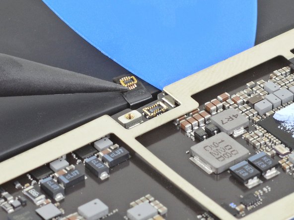

  11. iPad Air 3 Logic Board Replacement, Battery connector information: crwdns2935265:011crwdnd2935265:01crwdnd2935265:03crwdne2935265:0 iPad Air 3 Logic Board Replacement, Battery connector information: crwdns2935265:011crwdnd2935265:02crwdnd2935265:03crwdne2935265:0 iPad Air 3 Logic Board Replacement, Battery connector information: crwdns2935265:011crwdnd2935265:03crwdnd2935265:03crwdne2935265:0
    • These photos show what the battery connector looks like underneath the logic board. Use these photos as a reference while you safely disconnect the battery.
    • Notice that the battery connector has cantilever springs on the logic board that press against the battery contact pads. Since both the logic board and battery are glued down, you'll need to slide something thin and flexible between the contact points to disconnect the battery.
  12. iPad Air 3 Logic Board Replacement, Disconnect the battery: crwdns2935265:012crwdnd2935265:01crwdnd2935265:01crwdne2935265:0
    • Be careful when you isolate the battery using a battery blocker. The battery contacts are easily bent or broken, resulting in irreversible damage.
    • To disconnect the battery, slide one prong of a battery blocker or the tip of an opening pick under the battery power connector to ensure the power circuit is interrupted.
    • Don't push the battery blocker underneath the connector with excessive force. If you're having trouble fitting the battery blocker underneath the logic board, you can try using a playing card to disconnect the battery instead.
    • The battery blocker or playing card ideally should slide under the logic board without encountering any blockages.
    • Leave the battery blocker in place as you work.

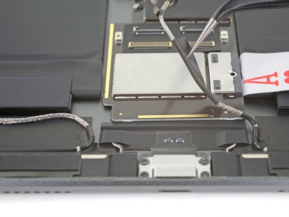

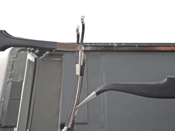

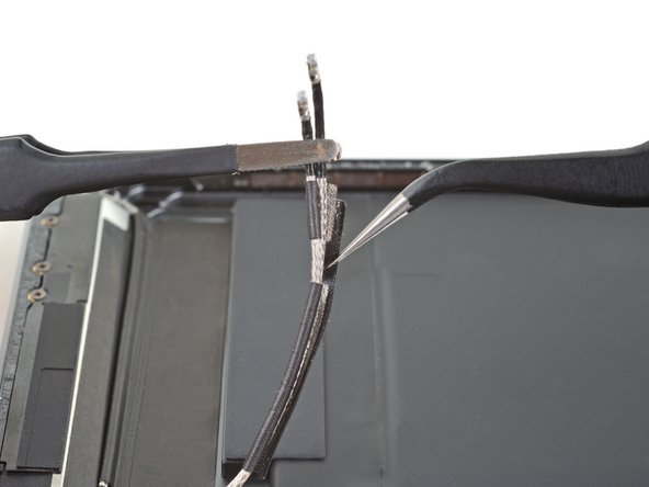

  20. iPad Air 3 Logic Board Replacement, Disconnect the antennas: crwdns2935265:020crwdnd2935265:01crwdnd2935265:03crwdne2935265:0 iPad Air 3 Logic Board Replacement, Disconnect the antennas: crwdns2935265:020crwdnd2935265:02crwdnd2935265:03crwdne2935265:0 iPad Air 3 Logic Board Replacement, Disconnect the antennas: crwdns2935265:020crwdnd2935265:03crwdnd2935265:03crwdne2935265:0
  21. iPad Air 3 Logic Board Replacement, Separate the antenna cables: crwdns2935265:021crwdnd2935265:01crwdnd2935265:03crwdne2935265:0 iPad Air 3 Logic Board Replacement, Separate the antenna cables: crwdns2935265:021crwdnd2935265:02crwdnd2935265:03crwdne2935265:0 iPad Air 3 Logic Board Replacement, Separate the antenna cables: crwdns2935265:021crwdnd2935265:03crwdnd2935265:03crwdne2935265:0
    • Use a pair of tweezers to lift the antenna cables away from the logic board.
  22. iPad Air 3 Logic Board Replacement: crwdns2935265:022crwdnd2935265:01crwdnd2935265:03crwdne2935265:0 iPad Air 3 Logic Board Replacement: crwdns2935265:022crwdnd2935265:02crwdnd2935265:03crwdne2935265:0 iPad Air 3 Logic Board Replacement: crwdns2935265:022crwdnd2935265:03crwdnd2935265:03crwdne2935265:0
    • Use a pair of tweezers to unwrap the tape securing the two antenna cables together.

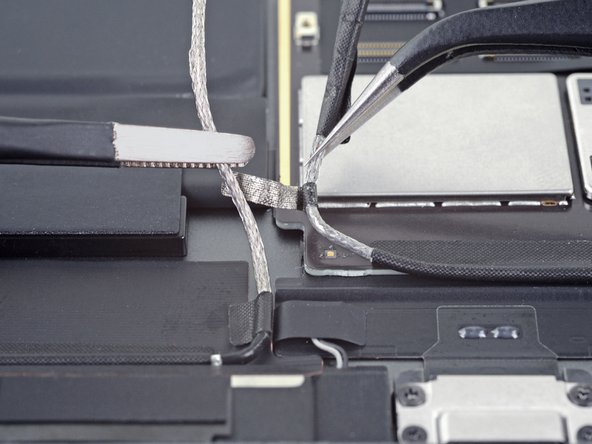

  23. iPad Air 3 Logic Board Replacement: crwdns2935265:023crwdnd2935265:01crwdnd2935265:03crwdne2935265:0 iPad Air 3 Logic Board Replacement: crwdns2935265:023crwdnd2935265:02crwdnd2935265:03crwdne2935265:0 iPad Air 3 Logic Board Replacement: crwdns2935265:023crwdnd2935265:03crwdnd2935265:03crwdne2935265:0
    • Use a pair of tweezers to unwrap the lower tape strip securing the antenna cables together.
    • Separate the two antenna cables.

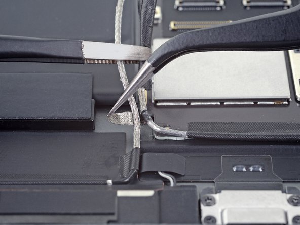

  24. iPad Air 3 Logic Board Replacement, Peel up the right antenna cable: crwdns2935265:024crwdnd2935265:01crwdnd2935265:02crwdne2935265:0 iPad Air 3 Logic Board Replacement, Peel up the right antenna cable: crwdns2935265:024crwdnd2935265:02crwdnd2935265:02crwdne2935265:0
    • Use a pair of tweezers to peel the right antenna cable away from the logic board.
    • Fold both the left and right antenna cables out of the way.

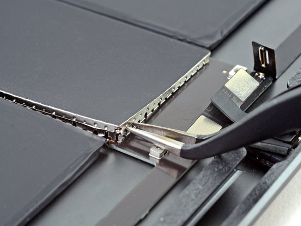

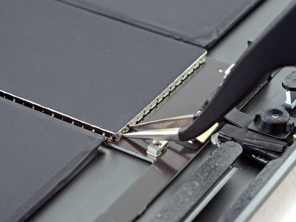

  30. iPad Air 3 Logic Board Replacement, Pry up the logic board shield: crwdns2935265:030crwdnd2935265:01crwdnd2935265:03crwdne2935265:0 iPad Air 3 Logic Board Replacement, Pry up the logic board shield: crwdns2935265:030crwdnd2935265:02crwdnd2935265:03crwdne2935265:0 iPad Air 3 Logic Board Replacement, Pry up the logic board shield: crwdns2935265:030crwdnd2935265:03crwdnd2935265:03crwdne2935265:0
    • Insert the tips of a pair of tweezers into the gaps under the the logic board shield on the upper right corner.
    • Take care not to puncture or bend the battery with your tool—a punctured or bent battery may leak dangerous chemicals or cause a thermal event.
    • Pry up slightly to loosen the logic board shield.
    • Pivot the tweezers on the screw boss to avoid damaging the press connectors.

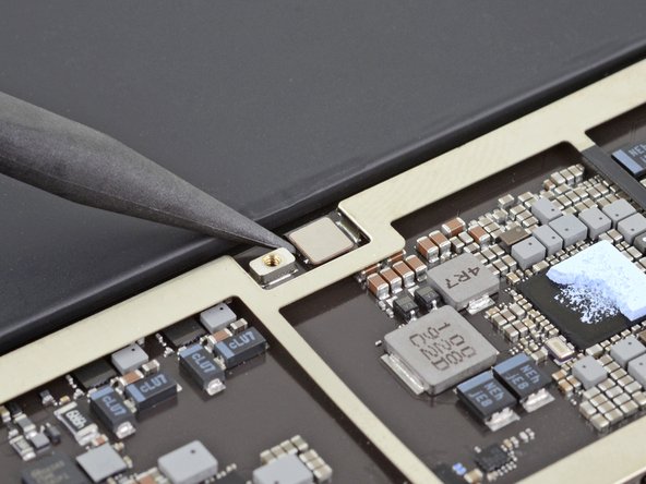

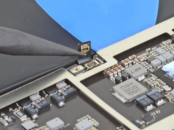

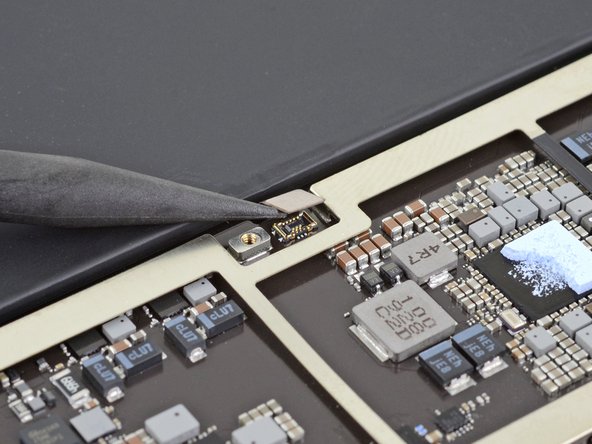

  34. iPad Air 3 Logic Board Replacement, Disconnect the Smart Connector cable: crwdns2935265:034crwdnd2935265:01crwdnd2935265:03crwdne2935265:0 iPad Air 3 Logic Board Replacement, Disconnect the Smart Connector cable: crwdns2935265:034crwdnd2935265:02crwdnd2935265:03crwdne2935265:0 iPad Air 3 Logic Board Replacement, Disconnect the Smart Connector cable: crwdns2935265:034crwdnd2935265:03crwdnd2935265:03crwdne2935265:0
    • Use the pointed end of a spudger to disconnect the Smart Connector cable by lifting straight up on the press connector.

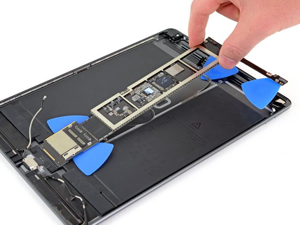

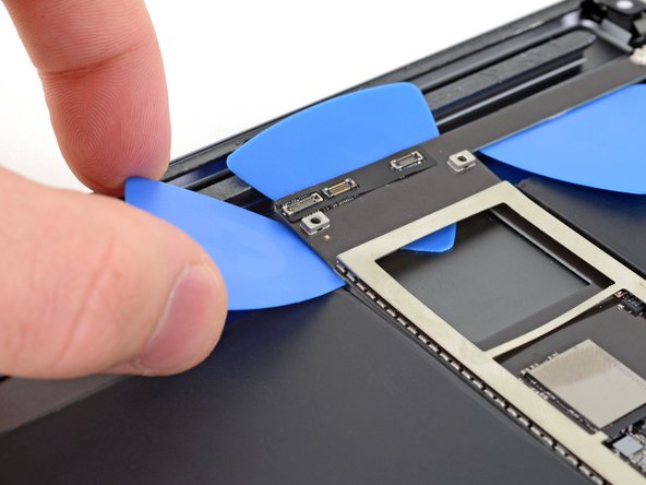

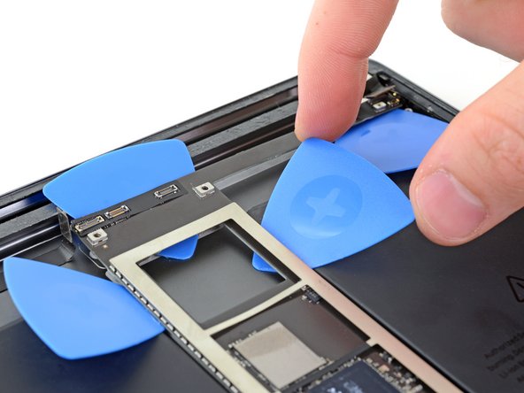

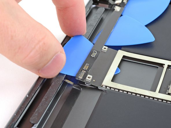

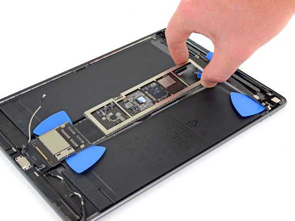

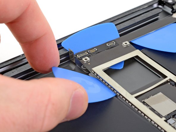

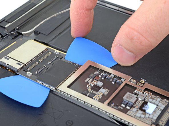

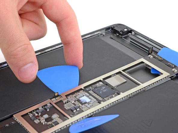

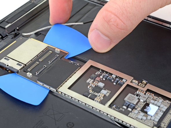

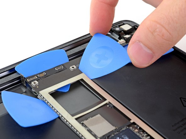

  37. iPad Air 3 Logic Board Replacement, Pry up the logic board arm: crwdns2935265:037crwdnd2935265:01crwdnd2935265:03crwdne2935265:0 iPad Air 3 Logic Board Replacement, Pry up the logic board arm: crwdns2935265:037crwdnd2935265:02crwdnd2935265:03crwdne2935265:0 iPad Air 3 Logic Board Replacement, Pry up the logic board arm: crwdns2935265:037crwdnd2935265:03crwdnd2935265:03crwdne2935265:0
    • Insert an opening tool underneath the logic board arm near the rear camera.
    • Pry up the arm until you can slide in an opening pick underneath it.

  41. iPad Air 3 Logic Board Replacement: crwdns2935265:041crwdnd2935265:01crwdnd2935265:03crwdne2935265:0 iPad Air 3 Logic Board Replacement: crwdns2935265:041crwdnd2935265:02crwdnd2935265:03crwdne2935265:0 iPad Air 3 Logic Board Replacement: crwdns2935265:041crwdnd2935265:03crwdnd2935265:03crwdne2935265:0
    • Insert an opening tool under the logic board next to the front camera.
    • Pry up the logic board until you can slide an opening pick underneath the logic board.
    • Take care to not slice the headphone jack cable.
  42. iPad Air 3 Logic Board Replacement, Remove the logic board: crwdns2935265:042crwdnd2935265:01crwdnd2935265:02crwdne2935265:0 iPad Air 3 Logic Board Replacement, Remove the logic board: crwdns2935265:042crwdnd2935265:02crwdnd2935265:02crwdne2935265:0
    • Push the opening pick underneath the logic board to slice the adhesive.
  43. iPad Air 3 Logic Board Replacement: crwdns2935265:043crwdnd2935265:01crwdnd2935265:03crwdne2935265:0 iPad Air 3 Logic Board Replacement: crwdns2935265:043crwdnd2935265:02crwdnd2935265:03crwdne2935265:0 iPad Air 3 Logic Board Replacement: crwdns2935265:043crwdnd2935265:03crwdnd2935265:03crwdne2935265:0
    • Insert another opening pick under the upper left corner of the logic board.
    • Slide the pick down towards the bottom of the iPad to slice the adhesive.
  44. iPad Air 3 Logic Board Replacement: crwdns2935265:044crwdnd2935265:01crwdnd2935265:02crwdne2935265:0 iPad Air 3 Logic Board Replacement: crwdns2935265:044crwdnd2935265:02crwdnd2935265:02crwdne2935265:0
    • Slide the opening pick down the left edge of the logic board until you get near the Smart Connector cable.
    • Take care not to slice through the Smart Connector cable.
  45. iPad Air 3 Logic Board Replacement, Shift the Smart Connector cable: crwdns2935265:045crwdnd2935265:01crwdnd2935265:03crwdne2935265:0 iPad Air 3 Logic Board Replacement, Shift the Smart Connector cable: crwdns2935265:045crwdnd2935265:02crwdnd2935265:03crwdne2935265:0 iPad Air 3 Logic Board Replacement, Shift the Smart Connector cable: crwdns2935265:045crwdnd2935265:03crwdnd2935265:03crwdne2935265:0
    • Use a spudger to move the Smart Connector cable behind the opening pick.
  46. iPad Air 3 Logic Board Replacement: crwdns2935265:046crwdnd2935265:01crwdnd2935265:02crwdne2935265:0 iPad Air 3 Logic Board Replacement: crwdns2935265:046crwdnd2935265:02crwdnd2935265:02crwdne2935265:0
    • Slide the opening pick past the Smart Connector cable and down to the antenna connectors.
    • If you have trouble, apply a few drops of isopropyl alcohol to the edge of the logic board, wait a minute, and try again.
  47. iPad Air 3 Logic Board Replacement: crwdns2935265:047crwdnd2935265:01crwdnd2935265:03crwdne2935265:0 iPad Air 3 Logic Board Replacement: crwdns2935265:047crwdnd2935265:02crwdnd2935265:03crwdne2935265:0 iPad Air 3 Logic Board Replacement: crwdns2935265:047crwdnd2935265:03crwdnd2935265:03crwdne2935265:0
    • Insert an opening pick under the upper right edge of the logic board.
  48. iPad Air 3 Logic Board Replacement: crwdns2935265:048crwdnd2935265:01crwdnd2935265:03crwdne2935265:0 iPad Air 3 Logic Board Replacement: crwdns2935265:048crwdnd2935265:02crwdnd2935265:03crwdne2935265:0 iPad Air 3 Logic Board Replacement: crwdns2935265:048crwdnd2935265:03crwdnd2935265:03crwdne2935265:0
    • Slide the opening pick down the right edge until you encounter the battery connector.
  49. iPad Air 3 Logic Board Replacement, Remove the battery blocker: crwdns2935265:049crwdnd2935265:01crwdnd2935265:02crwdne2935265:0 iPad Air 3 Logic Board Replacement, Remove the battery blocker: crwdns2935265:049crwdnd2935265:02crwdnd2935265:02crwdne2935265:0
    • Remove the battery blocker.
  50. iPad Air 3 Logic Board Replacement: crwdns2935265:050crwdnd2935265:01crwdnd2935265:03crwdne2935265:0 iPad Air 3 Logic Board Replacement: crwdns2935265:050crwdnd2935265:02crwdnd2935265:03crwdne2935265:0 iPad Air 3 Logic Board Replacement: crwdns2935265:050crwdnd2935265:03crwdnd2935265:03crwdne2935265:0
    • Slide the left opening pick down the left edge to the speaker connectors.
  51. iPad Air 3 Logic Board Replacement: crwdns2935265:051crwdnd2935265:01crwdnd2935265:03crwdne2935265:0 iPad Air 3 Logic Board Replacement: crwdns2935265:051crwdnd2935265:02crwdnd2935265:03crwdne2935265:0 iPad Air 3 Logic Board Replacement: crwdns2935265:051crwdnd2935265:03crwdnd2935265:03crwdne2935265:0
    • Slowly lift the logic board up and pull the charging port out of its recess.
    • If you can't lift up the logic board, identify where it is stuck and use an opening pick to slice the adhesive there.
    • You can also apply a few drops of high concentration (90% or higher) isopropyl alcohol where it's extra stuck.
  52. iPad Air 3 Logic Board Replacement: crwdns2935265:052crwdnd2935265:01crwdnd2935265:01crwdne2935265:0
    • Remove the logic board.
    • During reassembly, follow this guide if you are using a pre-cut adhesive card to reattach the logic board to the rear case.
Compare your new replacement part to the original part—you may need to transfer remaining components or remove adhesive backings from the new part before you install it.
