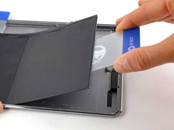

  71. iPad Air 2 Wi-Fi Battery Replacement: crwdns2935265:071crwdnd2935265:01crwdnd2935265:03crwdne2935265:0 iPad Air 2 Wi-Fi Battery Replacement: crwdns2935265:071crwdnd2935265:02crwdnd2935265:03crwdne2935265:0 iPad Air 2 Wi-Fi Battery Replacement: crwdns2935265:071crwdnd2935265:03crwdnd2935265:03crwdne2935265:0
    • Push the plastic card about two inches underneath the battery, and lift it up to pry the first battery cell off the rear case.
    • If the battery begins to bend, use an iOpener to apply heat to the back of the battery and repeat the previous two steps to adequately break up the battery adhesive.

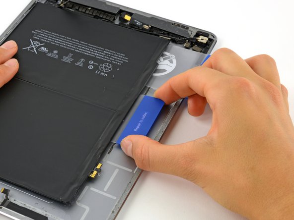

  72. iPad Air 2 Wi-Fi Battery Replacement: crwdns2935265:072crwdnd2935265:01crwdnd2935265:02crwdne2935265:0 iPad Air 2 Wi-Fi Battery Replacement: crwdns2935265:072crwdnd2935265:02crwdnd2935265:02crwdne2935265:0
    • Remove the card from the bottom of the battery and slide it between the battery and rear case, along the side and underneath the seam where the two battery cells meet.
    • Push the card as far underneath the battery as you can.

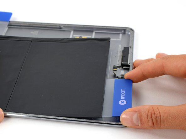

  73. iPad Air 2 Wi-Fi Battery Replacement: crwdns2935265:073crwdnd2935265:01crwdnd2935265:02crwdne2935265:0 iPad Air 2 Wi-Fi Battery Replacement: crwdns2935265:073crwdnd2935265:02crwdnd2935265:02crwdne2935265:0
    • Firmly grasp the first card you inserted underneath the battery and push it as far as you can underneath the battery.
    • You may need to add more heat to soften the adhesive before completing this step.

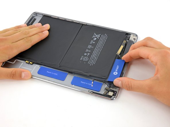

    • Slide a third card underneath the top edge of the battery, on the right side.
    • Carefully maneuver the card past the upper component cables so as not to damage them.
    • Push the card in as far as it will go, breaking through as much of the adhesive underneath the battery as you can.

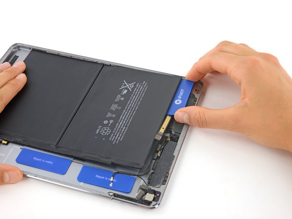

  75. iPad Air 2 Wi-Fi Battery Replacement: crwdns2935265:075crwdnd2935265:01crwdnd2935265:02crwdne2935265:0 iPad Air 2 Wi-Fi Battery Replacement: crwdns2935265:075crwdnd2935265:02crwdnd2935265:02crwdne2935265:0
    • Remove the card and slide it under the top edge of the battery again, on the left side near the edge of the iPad.
    • Be extremely careful to slide the card over the front-facing camera and headphone jack cables to avoid cutting them.
