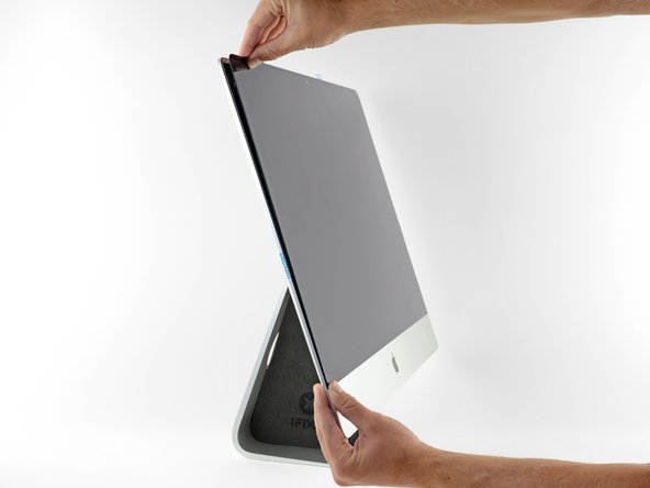

  1. iMac Intel 27" Retina 5K Display 2020 Display Adhesive Replacement, Stabilize the iMac: crwdns2935265:01crwdnd2935265:01crwdnd2935265:01crwdne2935265:0
    iMac Intel 27" Cardboard Service Wedge
    • Follow these assembly directions to put the service wedge together.
    • Insert the service wedge between the back of the display and the stand.
    • If you are not using a service wedge, the iMac can shift unexpectedly during the repair. You can complete the repair without it, but the procedure will be easier with an iFixit cardboard service wedge.

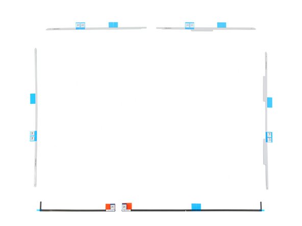

  3. iMac Intel 27" Retina 5K Display 2020 Display Adhesive Replacement, Lay out the adhesive strips: crwdns2935265:03crwdnd2935265:01crwdnd2935265:02crwdne2935265:0 iMac Intel 27" Retina 5K Display 2020 Display Adhesive Replacement, Lay out the adhesive strips: crwdns2935265:03crwdnd2935265:02crwdnd2935265:02crwdne2935265:0
    • Lay out the adhesive strips to ensure you install them in the correct place:
    • Strip 22 on the top left
    • Strip 23 on the top right
    • Strip 21 on the right vertical
    • Strip 25 on the bottom right, dark side facing up—double check to make sure this strip has the necessary cutout for the microphone
    • Strip 26 on the bottom left, dark side facing up
    • Strip 16 on the left vertical

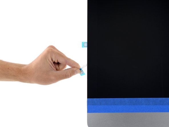

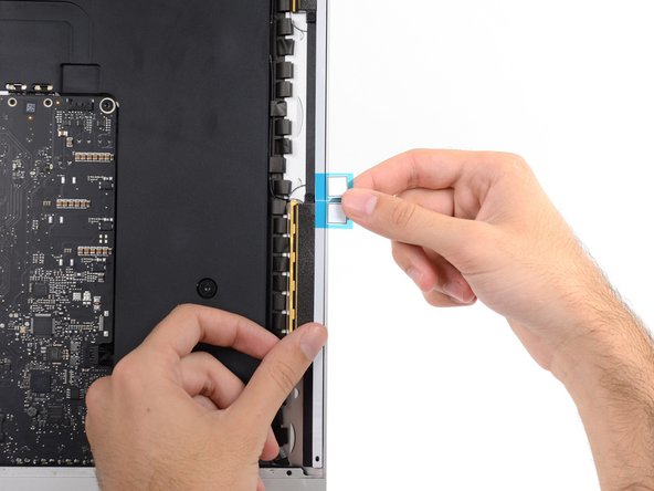

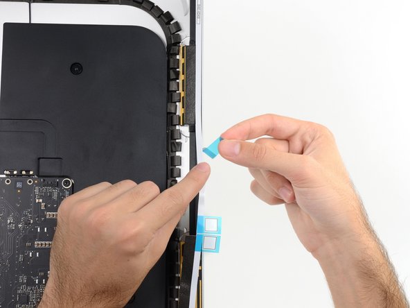

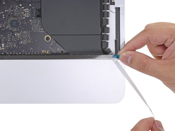

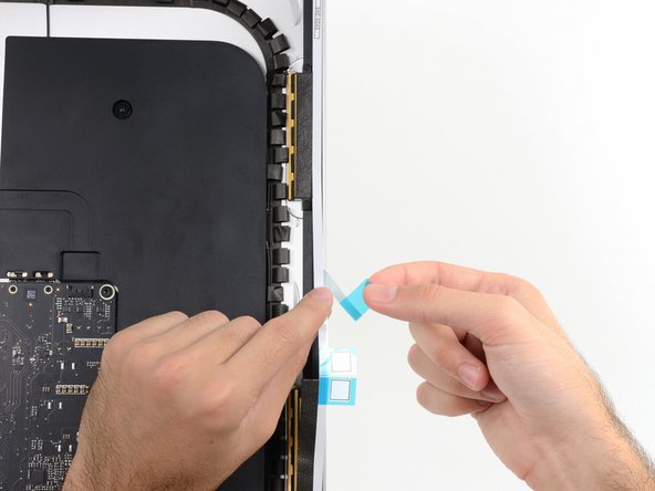

  4. iMac Intel 27" Retina 5K Display 2020 Display Adhesive Replacement, Install the right side adhesive: crwdns2935265:04crwdnd2935265:01crwdnd2935265:03crwdne2935265:0 iMac Intel 27" Retina 5K Display 2020 Display Adhesive Replacement, Install the right side adhesive: crwdns2935265:04crwdnd2935265:02crwdnd2935265:03crwdne2935265:0 iMac Intel 27" Retina 5K Display 2020 Display Adhesive Replacement, Install the right side adhesive: crwdns2935265:04crwdnd2935265:03crwdnd2935265:03crwdne2935265:0
    • Start with strip 21, which goes on the right vertical edge of the iMac frame.
    • Before you peel off any backing, line the adhesive strip up along the frame of the iMac to get an idea of where it goes.
    • Peel the short piece of backing off the back of the strip.

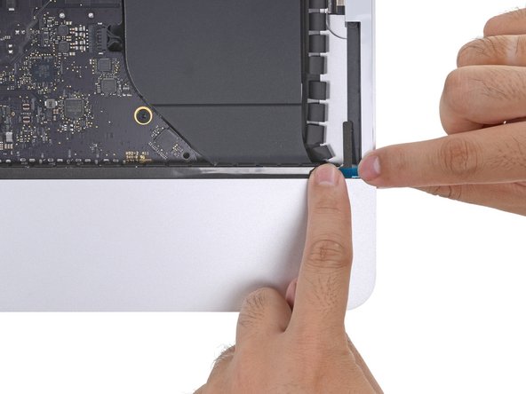

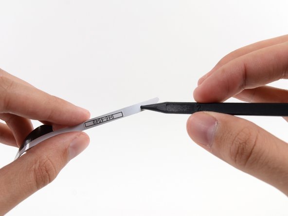

  5. iMac Intel 27" Retina 5K Display 2020 Display Adhesive Replacement: crwdns2935265:05crwdnd2935265:01crwdnd2935265:02crwdne2935265:0 iMac Intel 27" Retina 5K Display 2020 Display Adhesive Replacement: crwdns2935265:05crwdnd2935265:02crwdnd2935265:02crwdne2935265:0
    • Insert the tip of a spudger into the hole at the end of the strip where you just removed one layer of backing. Insert the spudger from the side that still has a layer of white backing on it.
  6. iMac Intel 27" Retina 5K Display 2020 Display Adhesive Replacement: crwdns2935265:06crwdnd2935265:01crwdnd2935265:03crwdne2935265:0 iMac Intel 27" Retina 5K Display 2020 Display Adhesive Replacement: crwdns2935265:06crwdnd2935265:02crwdnd2935265:03crwdne2935265:0 iMac Intel 27" Retina 5K Display 2020 Display Adhesive Replacement: crwdns2935265:06crwdnd2935265:03crwdnd2935265:03crwdne2935265:0
    • With the spudger still poking through the hole in the adhesive strip, push the spudger tip into the corresponding hole in the frame of the iMac.
    • Using the hole and spudger to anchor the position of the adhesive strip, line the strip up against the right edge, gently pull down against the spudger to ensure the strip is taut, and stick it onto the frame.
  7. iMac Intel 27" Retina 5K Display 2020 Display Adhesive Replacement: crwdns2935265:07crwdnd2935265:01crwdnd2935265:03crwdne2935265:0 iMac Intel 27" Retina 5K Display 2020 Display Adhesive Replacement: crwdns2935265:07crwdnd2935265:02crwdnd2935265:03crwdne2935265:0 iMac Intel 27" Retina 5K Display 2020 Display Adhesive Replacement: crwdns2935265:07crwdnd2935265:03crwdnd2935265:03crwdne2935265:0
    • Once you're satisfied that the top half of the adhesive strip is neatly aligned, peel the longer blue piece of backing out from behind the strip.
    • If the top half isn't aligned properly, you can carefully peel it up and re-stick it before peeling off the lower backing strip. Be sure to use the spudger tip to anchor the top.
  8. iMac Intel 27" Retina 5K Display 2020 Display Adhesive Replacement: crwdns2935265:08crwdnd2935265:01crwdnd2935265:02crwdne2935265:0 iMac Intel 27" Retina 5K Display 2020 Display Adhesive Replacement: crwdns2935265:08crwdnd2935265:02crwdnd2935265:02crwdne2935265:0
    • Align the lower portion of the strip with the right edge of the frame, and stick it down.
  9. iMac Intel 27" Retina 5K Display 2020 Display Adhesive Replacement: crwdns2935265:09crwdnd2935265:01crwdnd2935265:02crwdne2935265:0 iMac Intel 27" Retina 5K Display 2020 Display Adhesive Replacement: crwdns2935265:09crwdnd2935265:02crwdnd2935265:02crwdne2935265:0
    • Use your finger to smooth out the strip. Make sure it is neatly aligned with the right side of the frame and that it sits flat.
    • Do not peel off the front adhesive backing yet.

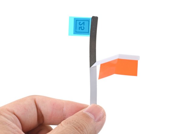

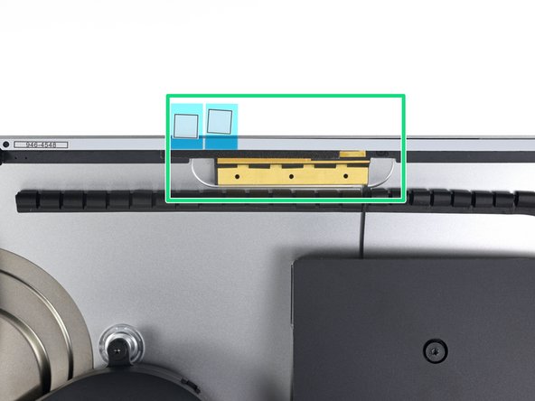

  11. iMac Intel 27" Retina 5K Display 2020 Display Adhesive Replacement, Install the bottom adhesives: crwdns2935265:011crwdnd2935265:01crwdnd2935265:01crwdne2935265:0
    • The next few steps will show you how to modify and install the bottom right adhesive strip (strip 25), which includes a notch that must be aligned with the left microphone and a notch that you must cut to accommodate the right microphone.
    • The microphone is a small hole located between two larger holes.

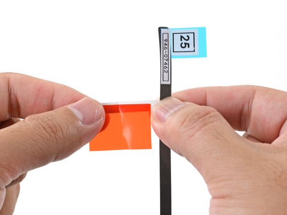

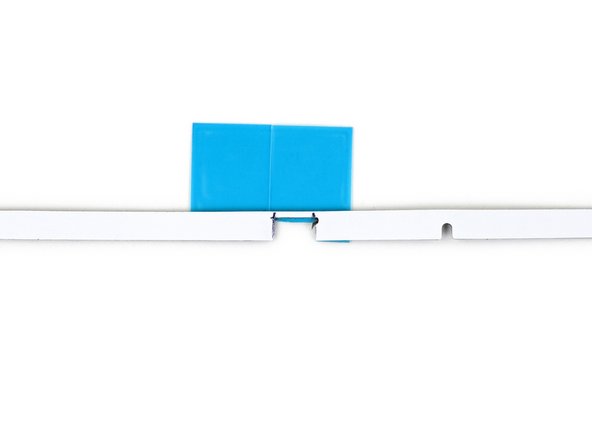

  12. iMac Intel 27" Retina 5K Display 2020 Display Adhesive Replacement: crwdns2935265:012crwdnd2935265:01crwdnd2935265:03crwdne2935265:0 iMac Intel 27" Retina 5K Display 2020 Display Adhesive Replacement: crwdns2935265:012crwdnd2935265:02crwdnd2935265:03crwdne2935265:0 iMac Intel 27" Retina 5K Display 2020 Display Adhesive Replacement: crwdns2935265:012crwdnd2935265:03crwdnd2935265:03crwdne2935265:0
    • Place adhesive strip 25 on your work surface with the white side facing up and the opening of the microphone notch facing away from you.
    • Measuring from the center of the microphone notch, make two marks on the adhesive strip as guides for where to cut:
    • Make the first mark 13/16 inch (23 mm) right of the notch
    • Make the second mark 1 & 5/16 inch (29 mm) right of the notch
    • Rotate the adhesive strip so that the notch is now facing toward you.
    • Measuring from the bottom edge of the strip, make a third mark in between the first two 5/32 inch (4 mm) up from the bottom edge.
    • This cut will be very close to the top edge of the adhesive strip, but it's important that you leave material over top of the adhesive strip for proper sound isolation. When in doubt, remove less material than you think you need to. If the adhesive still covers the microphone you can always make the notch bigger.
  13. iMac Intel 27" Retina 5K Display 2020 Display Adhesive Replacement: crwdns2935265:013crwdnd2935265:01crwdnd2935265:02crwdne2935265:0 iMac Intel 27" Retina 5K Display 2020 Display Adhesive Replacement: crwdns2935265:013crwdnd2935265:02crwdnd2935265:02crwdne2935265:0
    • Very carefully cut along the marks you made with a pair of scissors or a razor blade.
    • After cutting, your microphone notch should look like the one in the second photo.
    • Before removing the backing, place your adhesive strip on the iMac and make sure the notches line up with the microphones.

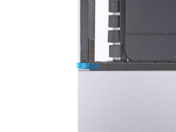

  19. iMac Intel 27" Retina 5K Display 2020 Display Adhesive Replacement: crwdns2935265:019crwdnd2935265:01crwdnd2935265:03crwdne2935265:0 iMac Intel 27" Retina 5K Display 2020 Display Adhesive Replacement: crwdns2935265:019crwdnd2935265:02crwdnd2935265:03crwdne2935265:0 iMac Intel 27" Retina 5K Display 2020 Display Adhesive Replacement: crwdns2935265:019crwdnd2935265:03crwdnd2935265:03crwdne2935265:0
    • Repeat the previous steps for the bottom left adhesive strip (strip 26), aligning and placing it along the bottom left edge of the iMac.
    • The strip should be positioned such that the L-bend sits next to the left vertical adhesive. The L-bend should not overlap the left vertical adhesive.
    • Once you've applied all the adhesive strips, the iMac should look as shown in the second photo.

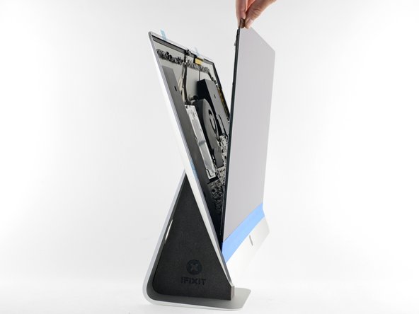

  20. iMac Intel 27" Retina 5K Display 2020 Display Adhesive Replacement, Replace the display: crwdns2935265:020crwdnd2935265:01crwdnd2935265:02crwdne2935265:0 iMac Intel 27" Retina 5K Display 2020 Display Adhesive Replacement, Replace the display: crwdns2935265:020crwdnd2935265:02crwdnd2935265:02crwdne2935265:0
    • Gently set the display in place over the iMac and align it carefully.

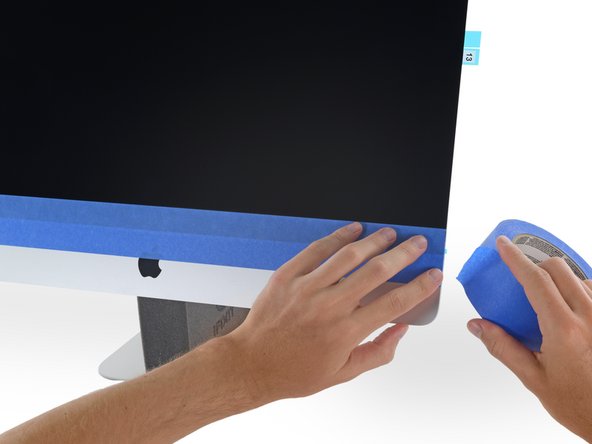

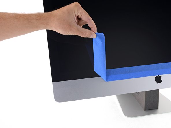

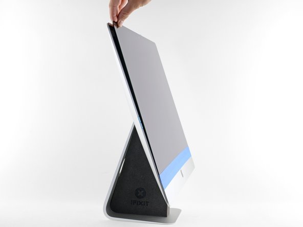

  21. iMac Intel 27" Retina 5K Display 2020 Display Adhesive Replacement: crwdns2935265:021crwdnd2935265:01crwdnd2935265:02crwdne2935265:0 iMac Intel 27" Retina 5K Display 2020 Display Adhesive Replacement: crwdns2935265:021crwdnd2935265:02crwdnd2935265:02crwdne2935265:0
    • Use painter's tape or masking tape to temporarily secure the bottom edge of the display to the iMac's enclosure.
    • The tape preserves the display's alignment, and allows you to safely swing the top edge of the display open to access the display cables.

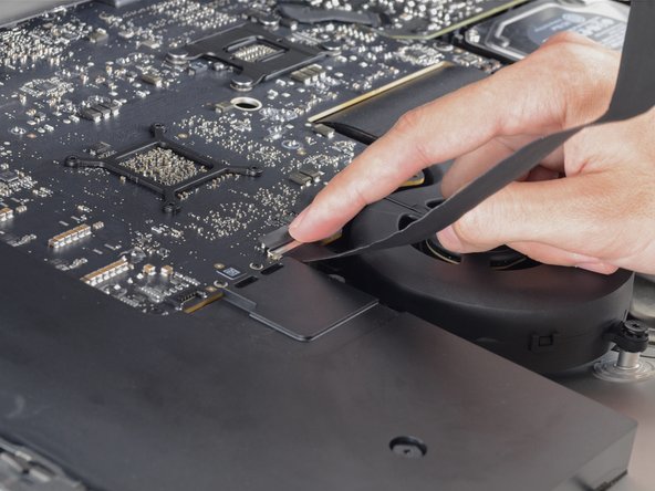

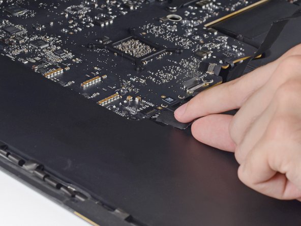

  22. iMac Intel 27" Retina 5K Display 2020 Display Adhesive Replacement, Test your repair: crwdns2935265:022crwdnd2935265:01crwdnd2935265:03crwdne2935265:0 iMac Intel 27" Retina 5K Display 2020 Display Adhesive Replacement, Test your repair: crwdns2935265:022crwdnd2935265:02crwdnd2935265:03crwdne2935265:0 iMac Intel 27" Retina 5K Display 2020 Display Adhesive Replacement, Test your repair: crwdns2935265:022crwdnd2935265:03crwdnd2935265:03crwdne2935265:0
    • At this point it's a good idea to test your repair, in order to make sure your iMac works properly before you seal it back up. Follow the next three steps to temporarily reconnect the display cables and boot up your iMac prior to pulling the protective film off the adhesive strips.
    • Gently insert the display data connector into its socket on the logic board. Be sure to press it straight into the socket, and insert it completely.
    • Flip the display data connector lock down onto the socket.
    • Insert the display power connector into its socket on the logic board.
  23. iMac Intel 27" Retina 5K Display 2020 Display Adhesive Replacement: crwdns2935265:023crwdnd2935265:01crwdnd2935265:02crwdne2935265:0 iMac Intel 27" Retina 5K Display 2020 Display Adhesive Replacement: crwdns2935265:023crwdnd2935265:02crwdnd2935265:02crwdne2935265:0
    • Set the display back on the iMac's rear enclosure.
    • Plug in your iMac, power it on, and test your repair before sealing up the computer. Be sure to check for full functionality of any hardware you removed or disconnected.
    • When you are finished, shut the iMac down and unplug the power cord before you continue.

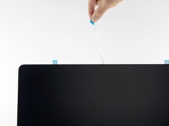

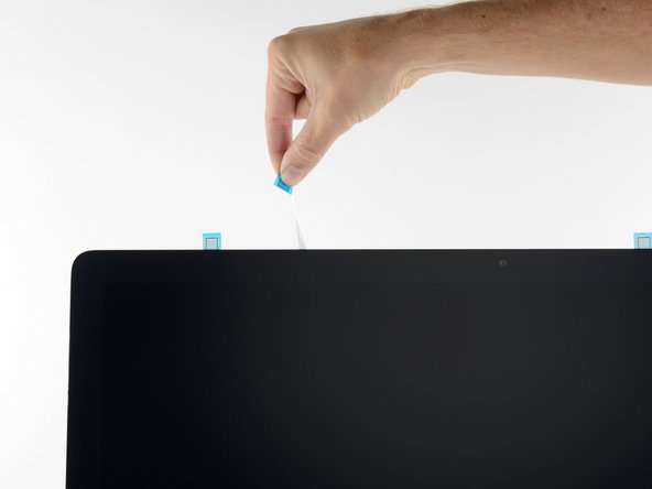

    • Remove one side of the protective film from the top left strip by pulling its tab straight up.
  28. iMac Intel 27" Retina 5K Display 2020 Display Adhesive Replacement: crwdns2935265:028crwdnd2935265:01crwdnd2935265:02crwdne2935265:0 iMac Intel 27" Retina 5K Display 2020 Display Adhesive Replacement: crwdns2935265:028crwdnd2935265:02crwdnd2935265:02crwdne2935265:0
    • Remove the other side of the protective film from the top left strip.
  29. iMac Intel 27" Retina 5K Display 2020 Display Adhesive Replacement: crwdns2935265:029crwdnd2935265:01crwdnd2935265:02crwdne2935265:0 iMac Intel 27" Retina 5K Display 2020 Display Adhesive Replacement: crwdns2935265:029crwdnd2935265:02crwdnd2935265:02crwdne2935265:0
    • Repeat the previous steps to remove the protective films from all the remaining adhesive strips.
