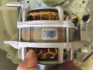

Motor can now be repalced.
Here is the tag for anybody that will need to know more about the motor.
The Calibration Cycle must be run whenever a main component i.e. main control, motor, pump etc. has been replaced. To run the cycle, use the instructions received from the seller of a replacement part. Or you can use the Tech Sheet for this washer and follow the instructions on page 4
