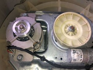

Belt is now removed
The motor is held to the housing by two 13mm machine bolts
I am using a 13mm socket to remove one,
