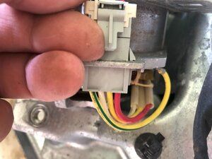

lift the locking tab with your fingernail (or a small screwdriver will work as well )
pull on the connector, (not the wire!)
until the connector comes free
