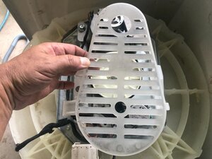

Remove the pulley cover
Now clearly visible are motor, pulley for the drive (clutch/splutch is underneath), shift actuator and start capacitor for the motor
To remove the drive belt, lift one side up and then pulling it to the drive pulley while continuing to pull up on it. The belt will eventually run off the pulley
