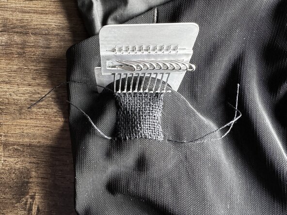

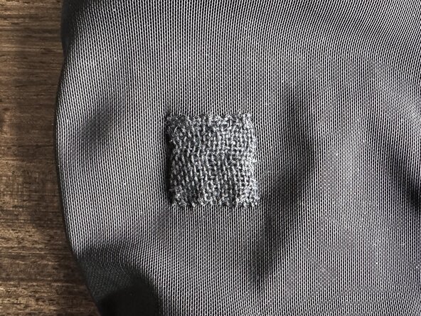

    • Structure - Woven darning is a repair technique that involves interweaving perpendicular threads or yarns to create a small woven patch.
    • Repair Use - Woven darning is used on small holes where yarn is missing or the area is worn thin and the resulting gap needs to be filled or reinforced. Despite being a woven technique, its used on both woven and knit garments.
    • This tutorial outlines a specific technique where rows of stitches are laid on top of the fabric utilizing a device that expedites the weaving process. If you don't have a Speedy Weave, refer instead to the Woven Darn a Hole in a Knit tutorial.

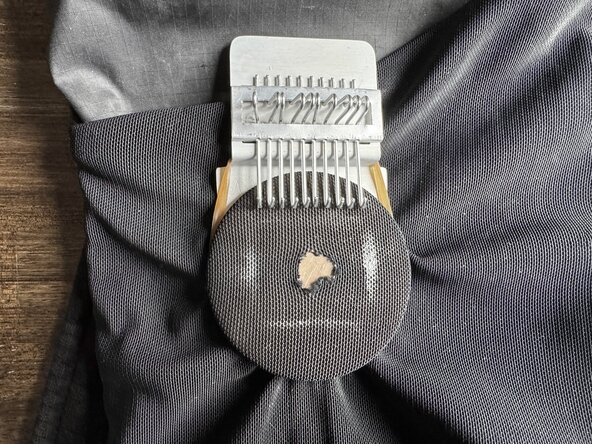

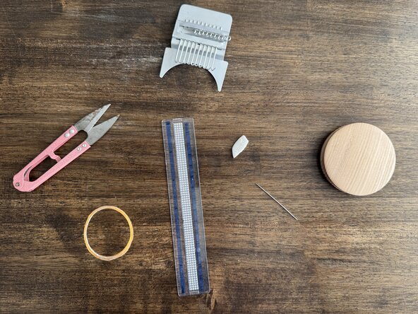

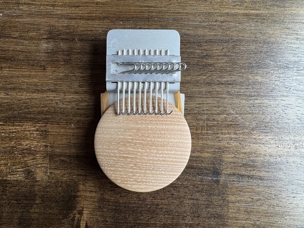

  2. Woven Darning with a Speedy Weave, Intro to the Speedy Weave: crwdns2935265:02crwdnd2935265:01crwdnd2935265:03crwdne2935265:0 Woven Darning with a Speedy Weave, Intro to the Speedy Weave: crwdns2935265:02crwdnd2935265:02crwdnd2935265:03crwdne2935265:0 Woven Darning with a Speedy Weave, Intro to the Speedy Weave: crwdns2935265:02crwdnd2935265:03crwdnd2935265:03crwdne2935265:0
    • The vertical threads in a woven patch or piece of fabric are called the warp and the horizontal threads are called the weft.
    • Weaving Rig: The metal weaving rig holds the warp yarns in place and helps speed up the weaving process by lifting and lowering alternating warp threads.
    • Warp Hooks: Each metal hook in the weaving rig moves side to side to lift and lower the warp threads while weaving.
    • Base Disk: The wooden base disk provides a smooth surface to work on, and prevents accidentally weaving through multiple layers at once.

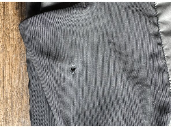

  3. Woven Darning with a Speedy Weave, Assess the damage: crwdns2935265:03crwdnd2935265:01crwdnd2935265:03crwdne2935265:0 Woven Darning with a Speedy Weave, Assess the damage: crwdns2935265:03crwdnd2935265:02crwdnd2935265:03crwdne2935265:0 Woven Darning with a Speedy Weave, Assess the damage: crwdns2935265:03crwdnd2935265:03crwdnd2935265:03crwdne2935265:0

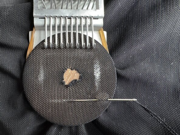

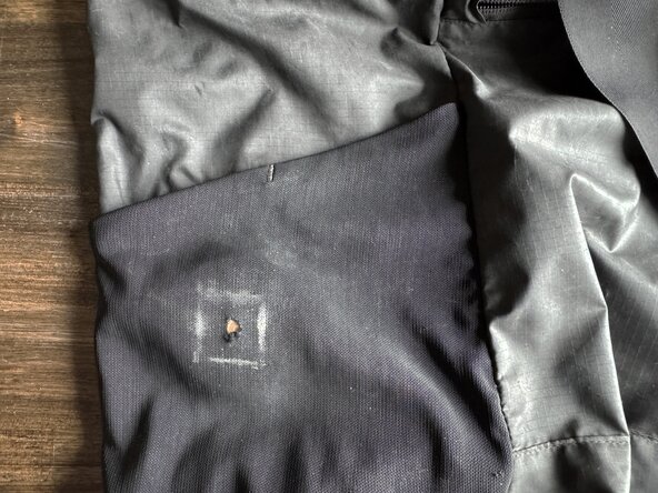

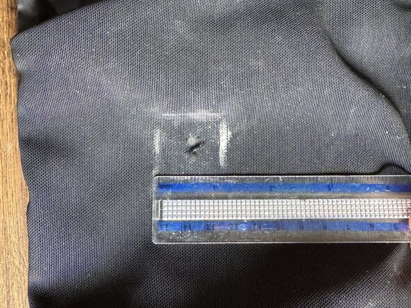

    • Locate the damage.
    • This repair type is meant for small to medium holes approximately 1 inch by 1 inch (~25 mm by ~25 mm) or less in size.
    • For the most invisible repair, choose a yarn or thread of similar weight, color, and materiality.
    • In this tutorial thick embroidery thread is used because the repair is to a mesh backpack pocket. On a knit garment such as a sweater, yarn would be a better choice.
    • Draw a square around the hole about 1/4 inch (~6 mm) bigger than the damage on all sides.

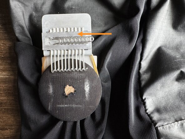

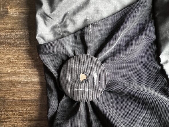

  4. Woven Darning with a Speedy Weave, Set the darning base disk: crwdns2935265:04crwdnd2935265:01crwdnd2935265:03crwdne2935265:0 Woven Darning with a Speedy Weave, Set the darning base disk: crwdns2935265:04crwdnd2935265:02crwdnd2935265:03crwdne2935265:0 Woven Darning with a Speedy Weave, Set the darning base disk: crwdns2935265:04crwdnd2935265:03crwdnd2935265:03crwdne2935265:0
    • Place the circular base disk directly beneath the hole so only one layer of fabric lays over it.
    • Center the disk, with the rounded side up, under the marked damage area.
    • Without overstretching, place the rubber band around the disk, over the fabric, securing them together. The drawn square shouldn't be twisted.
  5. Woven Darning with a Speedy Weave, Set the weaving rig: crwdns2935265:05crwdnd2935265:01crwdnd2935265:03crwdne2935265:0 Woven Darning with a Speedy Weave, Set the weaving rig: crwdns2935265:05crwdnd2935265:02crwdnd2935265:03crwdne2935265:0 Woven Darning with a Speedy Weave, Set the weaving rig: crwdns2935265:05crwdnd2935265:03crwdnd2935265:03crwdne2935265:0
    • Place the metal weaving rig in the crease at the top of the disk. Secure another rubber band around all pieces to hold the weaving rig to the disk.
    • Push the warp hooks up until the tips of the hooks are at a 90 degree angle from the fabric surface, standing exactly upright.
    • A warp hook should align on the left and right sides with the marked square. Adjust the hooks until they align properly.

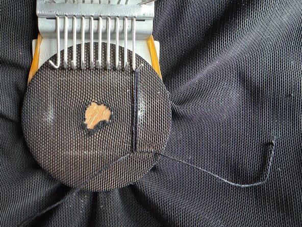

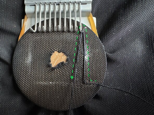

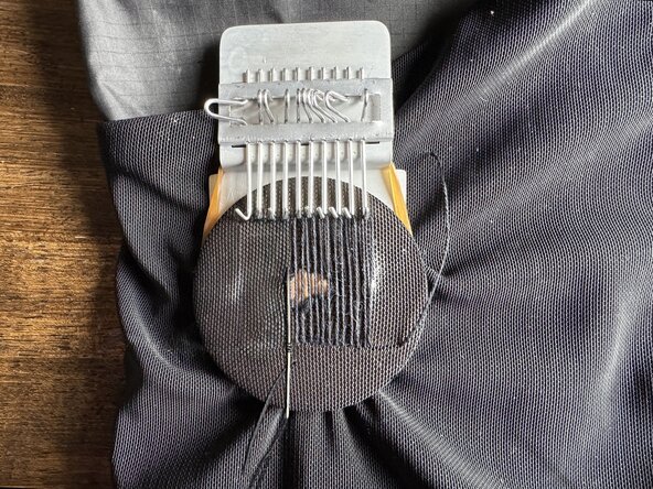

  6. Woven Darning with a Speedy Weave, Create the warp: crwdns2935265:06crwdnd2935265:01crwdnd2935265:03crwdne2935265:0 Woven Darning with a Speedy Weave, Create the warp: crwdns2935265:06crwdnd2935265:02crwdnd2935265:03crwdne2935265:0 Woven Darning with a Speedy Weave, Create the warp: crwdns2935265:06crwdnd2935265:03crwdnd2935265:03crwdne2935265:0

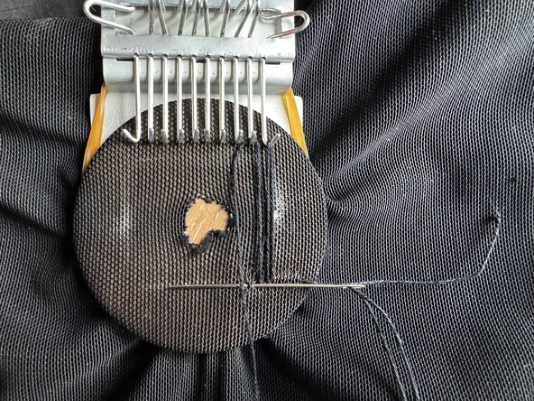

    • Thread an embroidery needle with a length of embroidery thread no longer than 32 inches (~81 cm). Don't knot the thread.
    • The eye size of the embroidery needle should be large enough to accommodate the yarn, but not much larger.

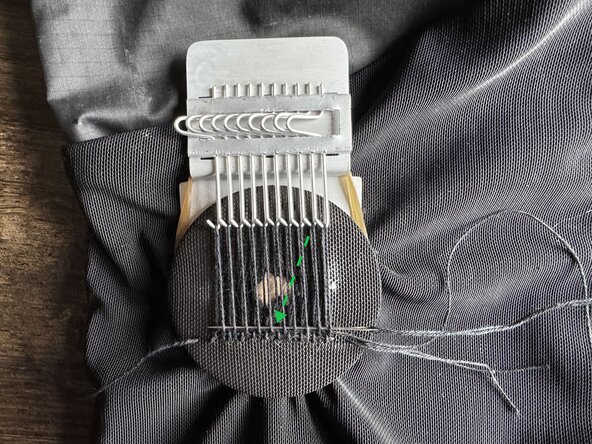

    • Make a horizontal stitch about 1/4 inch (~6 mm) long with the needle emerging at the bottom right corner of the drawn square. Pull the thread through until there's a short tail, about 1 inch (~25 mm) long.
    • Wrap the thread around the far right warp hook.
    • Pull the thread taught. Maintain even tension, but don't pull tight enough that the fabric pulls or the hole begins to close.
    • The darning will look the best if these lines align with the knit rows of the garment.

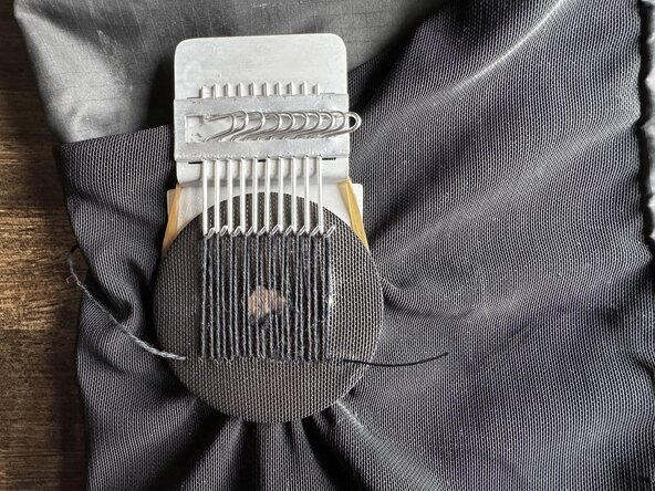

  7. Woven Darning with a Speedy Weave, Continue the warp: crwdns2935265:07crwdnd2935265:01crwdnd2935265:03crwdne2935265:0 Woven Darning with a Speedy Weave, Continue the warp: crwdns2935265:07crwdnd2935265:02crwdnd2935265:03crwdne2935265:0 Woven Darning with a Speedy Weave, Continue the warp: crwdns2935265:07crwdnd2935265:03crwdnd2935265:03crwdne2935265:0
    • Make a small horizontal stitch at the bottom of the square, to the left of the initial stitch.
    • The ideal gap between each vertical thread is the same as the width of the thread.
    • Wrap the thread around the second warp hook.
    • Continue this process until the warps cover the entire width of square or the thread begins to run out (stop when there's approximately 2 inches (~5 cm) left and see the next step).

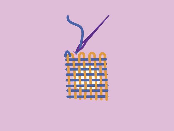

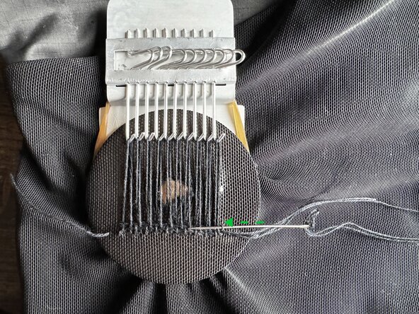

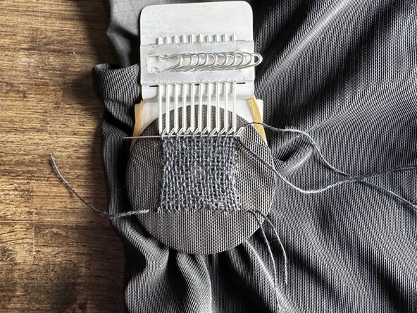

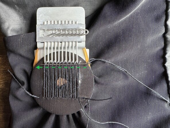

  10. Woven Darning with a Speedy Weave, Create the weft: crwdns2935265:010crwdnd2935265:01crwdnd2935265:03crwdne2935265:0 Woven Darning with a Speedy Weave, Create the weft: crwdns2935265:010crwdnd2935265:02crwdnd2935265:03crwdne2935265:0 Woven Darning with a Speedy Weave, Create the weft: crwdns2935265:010crwdnd2935265:03crwdnd2935265:03crwdne2935265:0

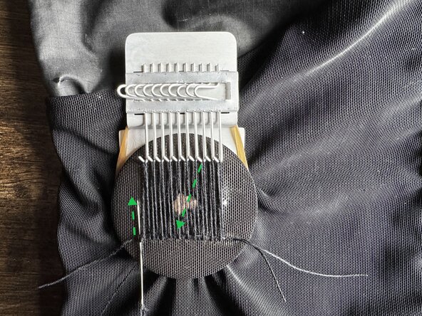

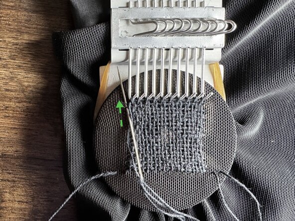

    • Starting 1/4 inch (~6 mm) from the bottom right corner, take a horizontal stitch and emerge directly above the first warp stitch.
    • Flip all warp hooks to the right. This will raise every other thread to make a channel for the needle to pass through.
    • Slide the needle through the channel to weave the thread through the warp threads. This will be easiest done close to the warp hooks.
    • Finish each weft thread to the left side of the weaving by taking a small vertical stitch. Similarly to securing warp stitches, make this stitch so that the gap between each row is the same width as the thread.
  11. Woven Darning with a Speedy Weave, Continue the weft: crwdns2935265:011crwdnd2935265:01crwdnd2935265:03crwdne2935265:0 Woven Darning with a Speedy Weave, Continue the weft: crwdns2935265:011crwdnd2935265:02crwdnd2935265:03crwdne2935265:0 Woven Darning with a Speedy Weave, Continue the weft: crwdns2935265:011crwdnd2935265:03crwdnd2935265:03crwdne2935265:0

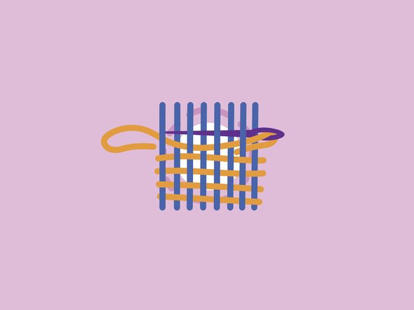

    • Use the needle to carefully push the row of thread down to the bottom of the weaving.
    • Flip the warp hooks to the left side of the weaving rig. The opposite warp threads from the previous row should now be lifted. Pass the needle through the channel.
    • Continuing weaving the horizontal wefts from left to right, flipping the warp hooks each time, creating a securing stitch at the end of each pass, and pulling taught.
    • Tamp down each row of thread after making it. Attempt to mimic the tightness or looseness of the original fabric structure.
  12. Woven Darning with a Speedy Weave, Finish the weft: crwdns2935265:012crwdnd2935265:01crwdnd2935265:03crwdne2935265:0 Woven Darning with a Speedy Weave, Finish the weft: crwdns2935265:012crwdnd2935265:02crwdnd2935265:03crwdne2935265:0 Woven Darning with a Speedy Weave, Finish the weft: crwdns2935265:012crwdnd2935265:03crwdnd2935265:03crwdne2935265:0
    • Once the top of the drawn square is reached, pierce the needle in the top corner and emerge 1/4 inch (~6 mm) away.
    • The top of the weaving should be within 1/8 inch (~3 mm) of the warp hooks.
    • Keep the needle threaded and don't cut off the thread.

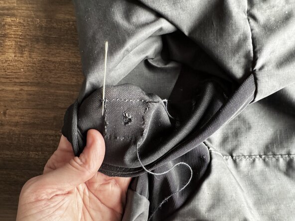

  14. Woven Darning with a Speedy Weave, Secure the warps: crwdns2935265:014crwdnd2935265:01crwdnd2935265:03crwdne2935265:0 Woven Darning with a Speedy Weave, Secure the warps: crwdns2935265:014crwdnd2935265:02crwdnd2935265:03crwdne2935265:0 Woven Darning with a Speedy Weave, Secure the warps: crwdns2935265:014crwdnd2935265:03crwdnd2935265:03crwdne2935265:0

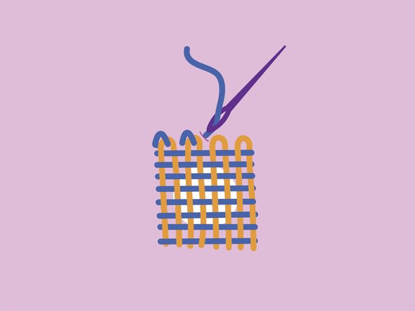

    • Secure the upper loops of the warp yarns by tacking down the top of each loop.
    • This stitch will mimic a whip stitch.
    • After the last tack stitch, trim the tail of the thread to about 2 inches (~4 cm).

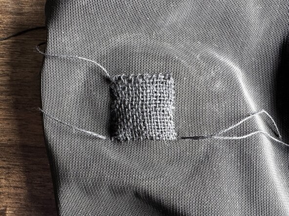

  15. Woven Darning with a Speedy Weave, Finishing: crwdns2935265:015crwdnd2935265:01crwdnd2935265:03crwdne2935265:0 Woven Darning with a Speedy Weave, Finishing: crwdns2935265:015crwdnd2935265:02crwdnd2935265:03crwdne2935265:0 Woven Darning with a Speedy Weave, Finishing: crwdns2935265:015crwdnd2935265:03crwdnd2935265:03crwdne2935265:0
    • Flip over the fabric.
    • With an empty needle, pull all the tails of thread to the back of the fabric.
  16. Woven Darning with a Speedy Weave, Tie off the thread: crwdns2935265:016crwdnd2935265:01crwdnd2935265:02crwdne2935265:0 Woven Darning with a Speedy Weave, Tie off the thread: crwdns2935265:016crwdnd2935265:02crwdnd2935265:02crwdne2935265:0

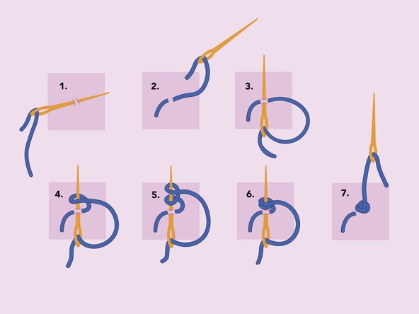

    • Tie off all these loose thread tails, ensuring that all sections are taught but not overly tight.
    • For extra security, thread each end into the needle and knot it off using one of the techniques from Knot Thread to the Fabric (2 Ways).

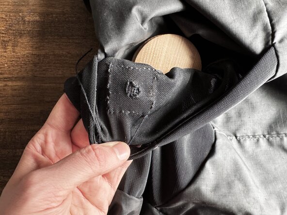

  17. Woven Darning with a Speedy Weave, Quality check: crwdns2935265:017crwdnd2935265:01crwdnd2935265:01crwdne2935265:0
    • Carefully steam away chalk or pen markings.
    • Make sure there are no tucks or puckers in the surface of the fabric.
    • Ensure that the hole is fully covered and the patch secures all sides of damaged area.
