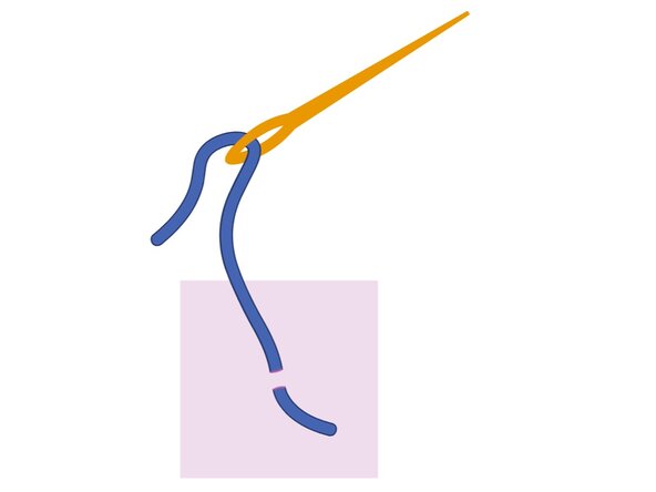

    • On the backside of the fabric, make a very small stitch.
    • Pull the thread through, leaving a short tail of approximately 1/2 inch (~13 mm) to 1 inch (~25 mm).
    • Make another small stitch in the same area. Leave the needle piercing the fabric without pulling it all the way through.

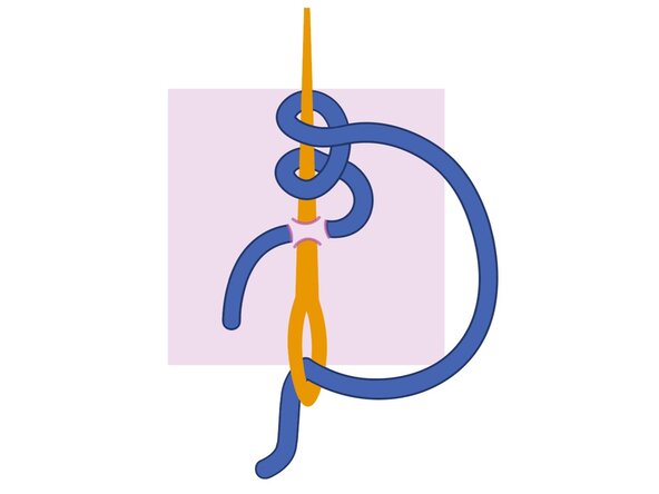

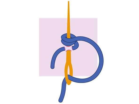

    • Take the thread that's emerging from the stitch and wrap it around the needle.
    • Wrap the thread around the needle a second time.
    • Push the wrapped threads down towards the base of the needle where it's emerging from the fabric.

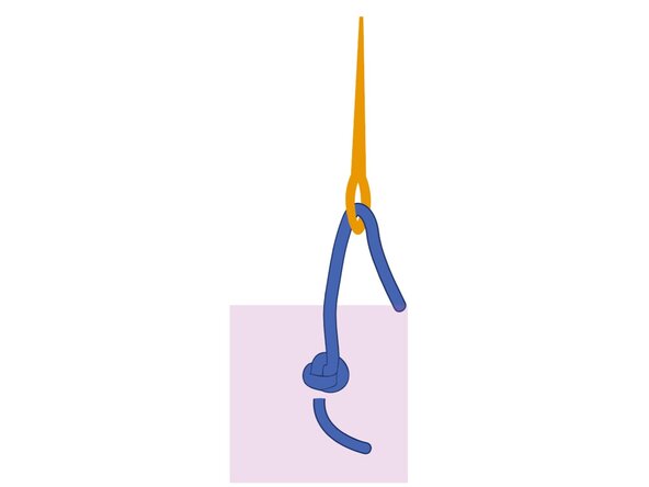

  3. Knot Thread to the Fabric (2 Ways): crwdns2935265:03crwdnd2935265:01crwdnd2935265:01crwdne2935265:0
    • Pull the needle through the loops and pull the thread tight. The knot will lay flush with the fabric.

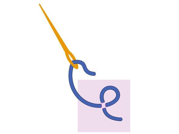

    • Make another small stitch in the same area, across the first stitch.
    • Pull the thread through but don't pull it tight, leaving a small loop.

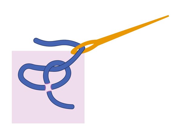

    • Thread the needle through the loop that was created in the previous step.
    • Gently pull the needle through the loop without pulling the thread tight, keeping the thread loop intact.
