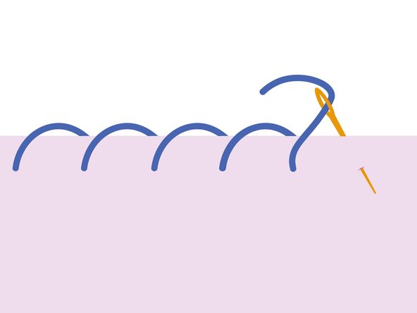

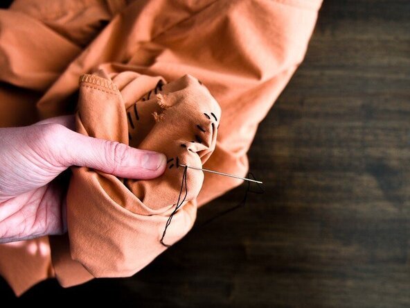

    1. Whip Stitch on a Patch, Intro to the whip stitch: crwdns2935265:01crwdnd2935265:01crwdnd2935265:03crwdne2935265:0 Whip Stitch on a Patch, Intro to the whip stitch: crwdns2935265:01crwdnd2935265:02crwdnd2935265:03crwdne2935265:0 Whip Stitch on a Patch, Intro to the whip stitch: crwdns2935265:01crwdnd2935265:03crwdnd2935265:03crwdne2935265:0

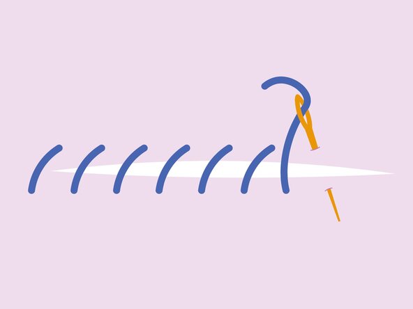

      • Structure - The whip stitch is a simple looping stitch that creates a spiral of thread.
      • Repair Use - This stretch stitch is highly versatile and can be used to seal a tear, bind a raw fabric edge, or attach a patch.

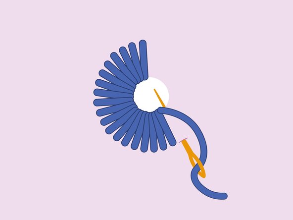

      • When placed close together, whip stitches can also reinforce an opening to create a buttonhole or a decorative eyelet.

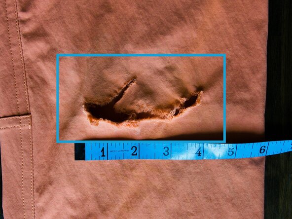

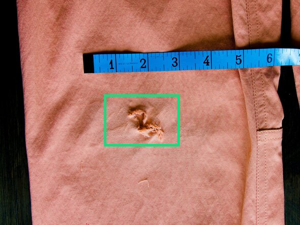

    2. Whip Stitch on a Patch, Assess the damage: crwdns2935265:02crwdnd2935265:01crwdnd2935265:03crwdne2935265:0 Whip Stitch on a Patch, Assess the damage: crwdns2935265:02crwdnd2935265:02crwdnd2935265:03crwdne2935265:0 Whip Stitch on a Patch, Assess the damage: crwdns2935265:02crwdnd2935265:03crwdnd2935265:03crwdne2935265:0
      • Locate and assess the damage.
      • If possible, stitch the tear closed. This will seal the tear on the inside of the patch so it doesn't grow bigger or get caught while the garment is being worn. See Whip Stitch on a Tear.
      • If the tear is too large or oddly shaped to be stitched closed, see the final step in this guide for details on creating an underpatch.
      • If you're repairing Patagonia Quandary Pants with a repair patch included, move on to the next step. Otherwise, see Make a Fabric Patch for guidance and best practices on making a fabric patch.

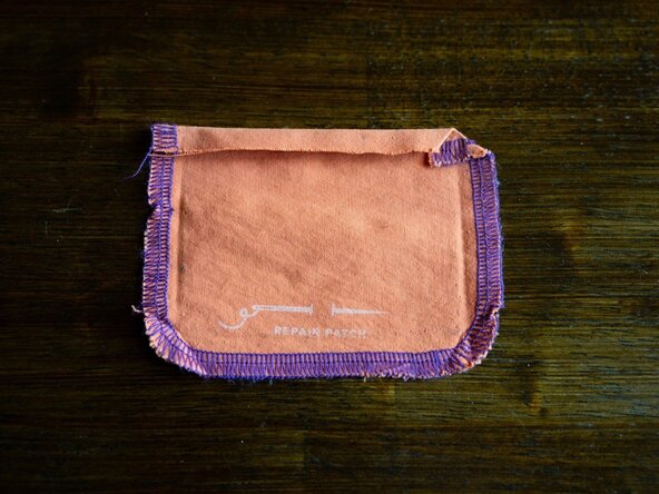

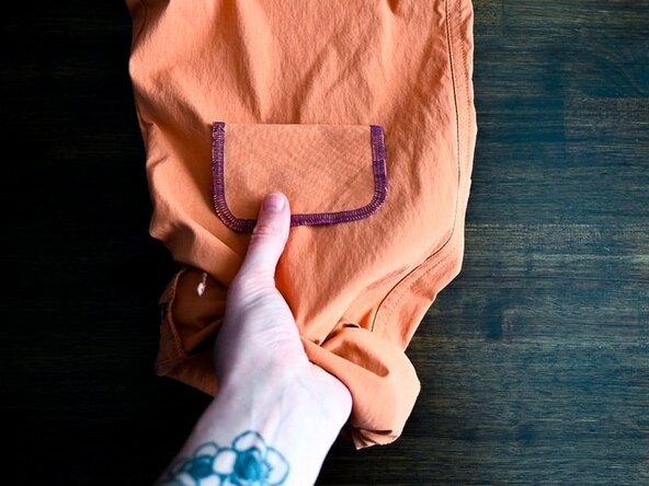

    3. Whip Stitch on a Patch, Removing the fabric patch in Patagonia® Quandary Pants: crwdns2935265:03crwdnd2935265:01crwdnd2935265:03crwdne2935265:0 Whip Stitch on a Patch, Removing the fabric patch in Patagonia® Quandary Pants: crwdns2935265:03crwdnd2935265:02crwdnd2935265:03crwdne2935265:0 Whip Stitch on a Patch, Removing the fabric patch in Patagonia® Quandary Pants: crwdns2935265:03crwdnd2935265:03crwdnd2935265:03crwdne2935265:0

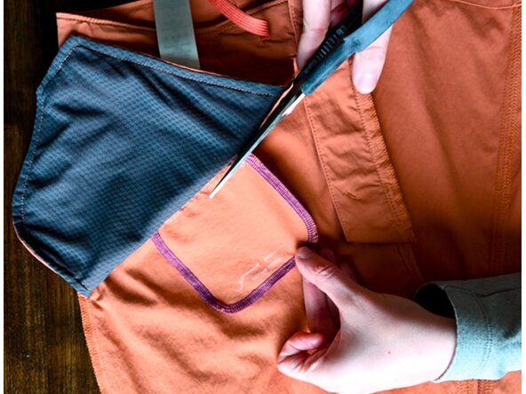

      • Patagonia® Quandary Pants made Spring 2024 or after have a fabric patch included! The patch is located behind the front left pocket bag.
      • Cut the patch out of the pants along the marked cut line.
      • Take care not to cut the pocket bag!
      • Fold over the raw edge and press with an iron.
      • This tutorial will continue using this patch but any patch can be substituted with the same technique.
      • Cut a length of thread approximately 24 inches (~61 cm) long.
      • Thread the needle and adjust the thread so there are equal lengths of thread on each side of the needle.
      • Tie an overhand knot with both ends to create a doubled length of thread.
      • The pictured repair uses contrast color thread for visibility, but matching thread will make this repair more invisible.
      • See Needles and Thread for more details.

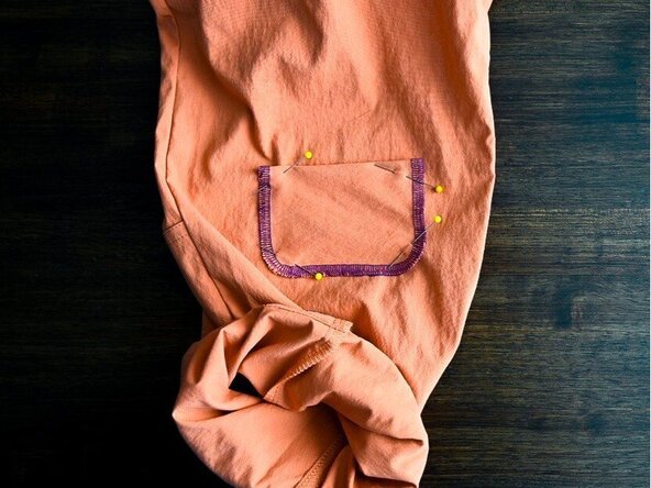

    4. Whip Stitch on a Patch, Pin on the patch: crwdns2935265:05crwdnd2935265:01crwdnd2935265:03crwdne2935265:0 Whip Stitch on a Patch, Pin on the patch: crwdns2935265:05crwdnd2935265:02crwdnd2935265:03crwdne2935265:0 Whip Stitch on a Patch, Pin on the patch: crwdns2935265:05crwdnd2935265:03crwdnd2935265:03crwdne2935265:0

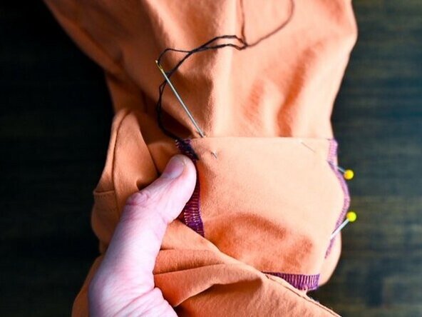

      • Position the fabric patch over the hole and pin it in place, ensuring the hole is centered.
      • Be careful to only pin through one side of the garment, especially if repairing a leg or arm.
      • Place the pins perpendicular to the patch edges, with the pin heads facing outward for easy removal while sewing on the patch.

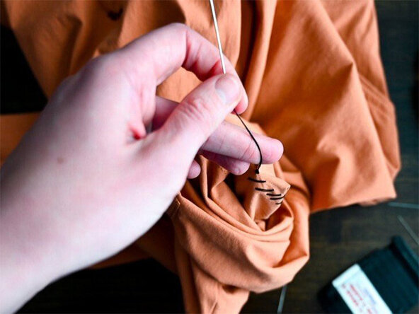

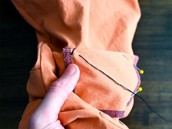

    5. Whip Stitch on a Patch, Start the stitch: crwdns2935265:06crwdnd2935265:01crwdnd2935265:03crwdne2935265:0 Whip Stitch on a Patch, Start the stitch: crwdns2935265:06crwdnd2935265:02crwdnd2935265:03crwdne2935265:0 Whip Stitch on a Patch, Start the stitch: crwdns2935265:06crwdnd2935265:03crwdnd2935265:03crwdne2935265:0

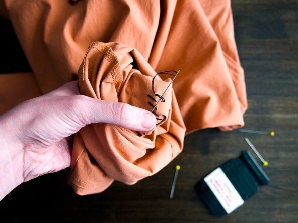

      • Insert the needle into the back of the patch, about 1/4 inch (~6 mm) in from the edge. Pull through so the thread knot is flush against the back of the patch.
      • Starting behind the patch will trap the starting knot between the patch and the garment, and reduce the number of knots the wearer will be able to see or feel.
      • Pierce the needle down at the edge of the patch, into the garment fabric adjacent to the first stitch.
      • Bring the back needle up approximately 1/4 inch (~6 mm) in from the edge of the patch and 1/4 inch (~6 mm) away from the first stitch. Pull the stitch tight.
      • Make sure that this stitch grabs all layers.
      • This technique creates a spiral of thread that adheres the edge of the patch to the garment.

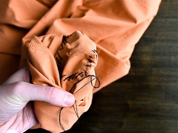

    6. Whip Stitch on a Patch, Continue the stitch: crwdns2935265:07crwdnd2935265:01crwdnd2935265:02crwdne2935265:0 Whip Stitch on a Patch, Continue the stitch: crwdns2935265:07crwdnd2935265:02crwdnd2935265:02crwdne2935265:0

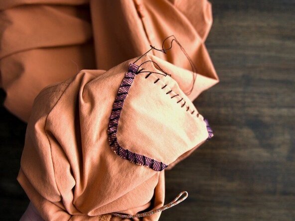

      • Continue the whip stitch technique around all four edges of the patch, taking care to maintain consistent stitch lengths.
