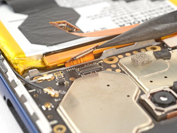

  12. Motorola Moto G Play (2021) Screen Replacement, Disconnect the battery: crwdns2935265:012crwdnd2935265:01crwdnd2935265:02crwdne2935265:0 Motorola Moto G Play (2021) Screen Replacement, Disconnect the battery: crwdns2935265:012crwdnd2935265:02crwdnd2935265:02crwdne2935265:0
    • Use the pointed end of your spudger to pry and disconnect the battery's press connector.
    • To re-attach press connectors, carefully align and press down on one side until it clicks into place, then repeat on the other side. Don't press down on the middle. If the connector is misaligned, the pins can bend and cause permanent damage.

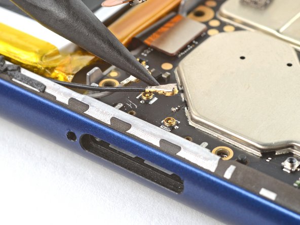

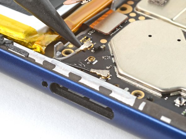

  15. Motorola Moto G Play (2021) Screen Replacement, Disconnect the antenna cables: crwdns2935265:015crwdnd2935265:01crwdnd2935265:02crwdne2935265:0 Motorola Moto G Play (2021) Screen Replacement, Disconnect the antenna cables: crwdns2935265:015crwdnd2935265:02crwdnd2935265:02crwdne2935265:0
    • Use the pointed end of your spudger to pry and disconnect the gray antenna cable.
    • Pry on the metal head of the connector only. Avoid lifting the cable itself as much as possible.
    • During reassembly, these can be tricky to reconnect. Hold the connector in place over its socket and press down with the flat end of a spudger. The connector should snap into place.

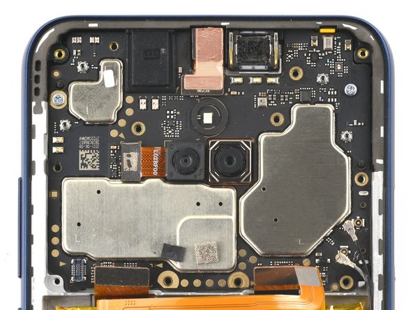

  19. Motorola Moto G Play (2021) Screen Replacement, Unfasten the motherboard: crwdns2935265:019crwdnd2935265:01crwdnd2935265:02crwdne2935265:0 Motorola Moto G Play (2021) Screen Replacement, Unfasten the motherboard: crwdns2935265:019crwdnd2935265:02crwdnd2935265:02crwdne2935265:0
    • Use your Phillips screwdriver to remove the two 2.5 mm-long screws securing the motherboard.

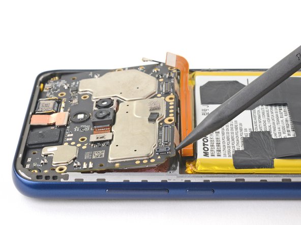

  20. Motorola Moto G Play (2021) Screen Replacement, Lift the motherboard: crwdns2935265:020crwdnd2935265:01crwdnd2935265:02crwdne2935265:0 Motorola Moto G Play (2021) Screen Replacement, Lift the motherboard: crwdns2935265:020crwdnd2935265:02crwdnd2935265:02crwdne2935265:0
    • Insert the pointed end of your spudger between the bottom left edge of the motherboard and the frame.
    • Lift the motherboard from its recess.
    • Be sure the loose cables don't catch on the motherboard as it's removed.

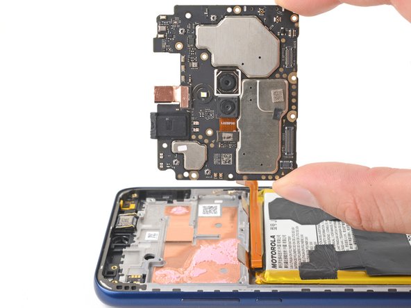

  21. Motorola Moto G Play (2021) Screen Replacement, Remove the motherboard: crwdns2935265:021crwdnd2935265:01crwdnd2935265:02crwdne2935265:0 Motorola Moto G Play (2021) Screen Replacement, Remove the motherboard: crwdns2935265:021crwdnd2935265:02crwdnd2935265:02crwdne2935265:0
    • Grab the motherboard by its bottom corners and remove it.
    • During reassembly, make sure no cables or connectors become trapped underneath the motherboard.

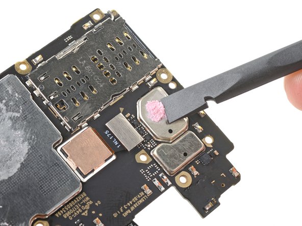

  22. Motorola Moto G Play (2021) Screen Replacement, Clean the thermal paste: crwdns2935265:022crwdnd2935265:01crwdnd2935265:02crwdne2935265:0 Motorola Moto G Play (2021) Screen Replacement, Clean the thermal paste: crwdns2935265:022crwdnd2935265:02crwdnd2935265:02crwdne2935265:0
    • Follow this guide to remove excess thermal paste and prepare the frame and motherboard for reassembly.

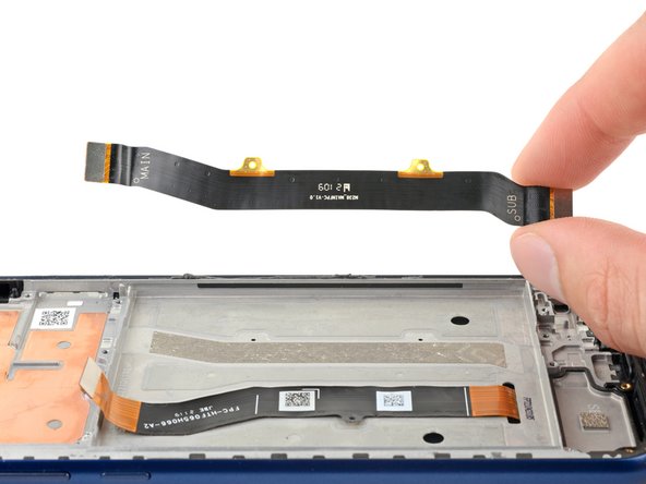

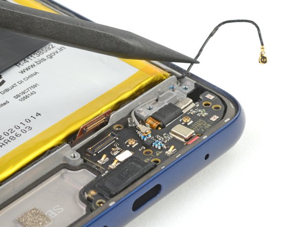

  26. Motorola Moto G Play (2021) Screen Replacement, Disconnect the board cable: crwdns2935265:026crwdnd2935265:01crwdnd2935265:02crwdne2935265:0 Motorola Moto G Play (2021) Screen Replacement, Disconnect the board cable: crwdns2935265:026crwdnd2935265:02crwdnd2935265:02crwdne2935265:0
    • Use the pointed end of your spudger to pry and disconnect the board cable's press connector.

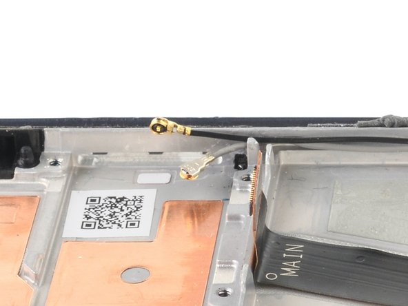

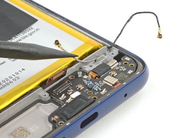

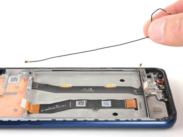

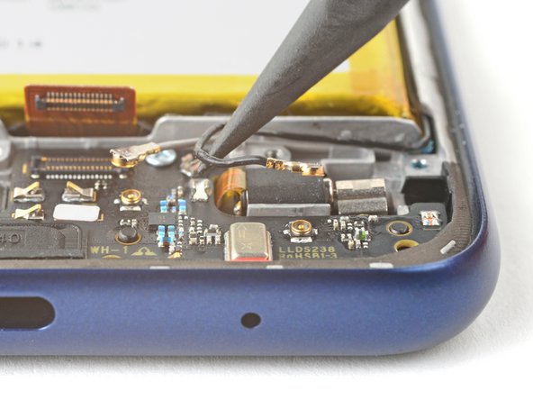

  27. Motorola Moto G Play (2021) Screen Replacement, Disconnect the antenna cables: crwdns2935265:027crwdnd2935265:01crwdnd2935265:02crwdne2935265:0 Motorola Moto G Play (2021) Screen Replacement, Disconnect the antenna cables: crwdns2935265:027crwdnd2935265:02crwdnd2935265:02crwdne2935265:0
    • Pry on only the metal head of the connector. Avoid lifting the cable itself as much as possible.
    • Free the cable from the retaining clip.
    • During reassembly, be sure to secure the cable to the clip in the daughterboard.

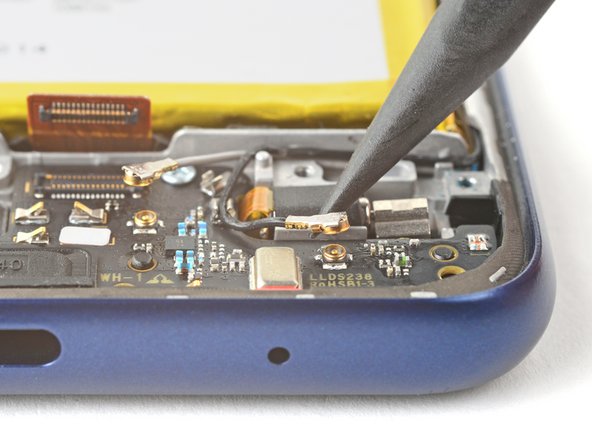

  28. Motorola Moto G Play (2021) Screen Replacement: crwdns2935265:028crwdnd2935265:01crwdnd2935265:03crwdne2935265:0 Motorola Moto G Play (2021) Screen Replacement: crwdns2935265:028crwdnd2935265:02crwdnd2935265:03crwdne2935265:0 Motorola Moto G Play (2021) Screen Replacement: crwdns2935265:028crwdnd2935265:03crwdnd2935265:03crwdne2935265:0
    • Repeat the previous step for the black antenna cable.

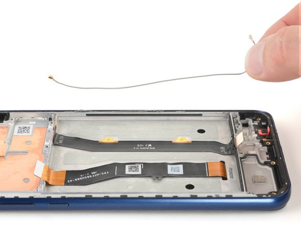

  30. Motorola Moto G Play (2021) Screen Replacement, Reposition the antenna cables: crwdns2935265:030crwdnd2935265:01crwdnd2935265:03crwdne2935265:0 Motorola Moto G Play (2021) Screen Replacement, Reposition the antenna cables: crwdns2935265:030crwdnd2935265:02crwdnd2935265:03crwdne2935265:0 Motorola Moto G Play (2021) Screen Replacement, Reposition the antenna cables: crwdns2935265:030crwdnd2935265:03crwdnd2935265:03crwdne2935265:0
    • Move the black and gray antenna cables away from the daughterboard.

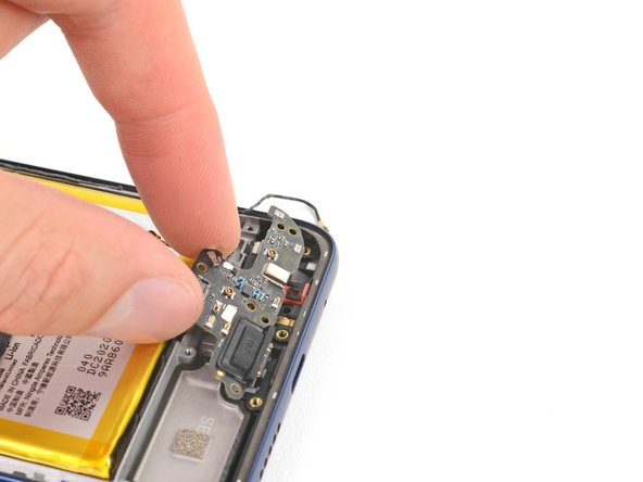

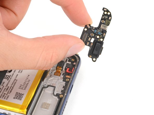

  31. Motorola Moto G Play (2021) Screen Replacement, Remove the daughterboard: crwdns2935265:031crwdnd2935265:01crwdnd2935265:03crwdne2935265:0 Motorola Moto G Play (2021) Screen Replacement, Remove the daughterboard: crwdns2935265:031crwdnd2935265:02crwdnd2935265:03crwdne2935265:0 Motorola Moto G Play (2021) Screen Replacement, Remove the daughterboard: crwdns2935265:031crwdnd2935265:03crwdnd2935265:03crwdne2935265:0
    • Grip the top edge of the daughterboard.
    • Lift and remove the daughterboard from its recess.
    • Be sure not to catch on any loose cables.

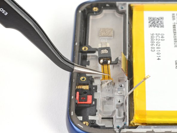

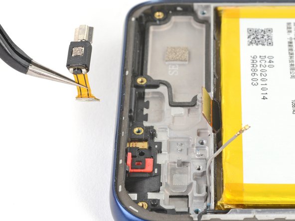

  33. Motorola Moto G Play (2021) Screen Replacement, Reposition the vibration motor: crwdns2935265:033crwdnd2935265:01crwdnd2935265:03crwdne2935265:0 Motorola Moto G Play (2021) Screen Replacement, Reposition the vibration motor: crwdns2935265:033crwdnd2935265:02crwdnd2935265:03crwdne2935265:0 Motorola Moto G Play (2021) Screen Replacement, Reposition the vibration motor: crwdns2935265:033crwdnd2935265:03crwdnd2935265:03crwdne2935265:0
    • Insert the point of your spudger between the motor counterweight and the frame.
    • Pry the motor out of its recess and flip it over.
    • Don't fold the flex cable.
  34. Motorola Moto G Play (2021) Screen Replacement, Remove the vibration motor: crwdns2935265:034crwdnd2935265:01crwdnd2935265:03crwdne2935265:0 Motorola Moto G Play (2021) Screen Replacement, Remove the vibration motor: crwdns2935265:034crwdnd2935265:02crwdnd2935265:03crwdne2935265:0 Motorola Moto G Play (2021) Screen Replacement, Remove the vibration motor: crwdns2935265:034crwdnd2935265:03crwdnd2935265:03crwdne2935265:0
    • The vibration motor's flex cable is very fragile. Work slowly to prevent tearing the cable.
    • Use tweezers to grab and peel the base of the flex cable from the frame.
    • If the cable feels stuck or re-adheres, apply more isopropyl alcohol or heat.
    • Remove the vibration motor from the frame.

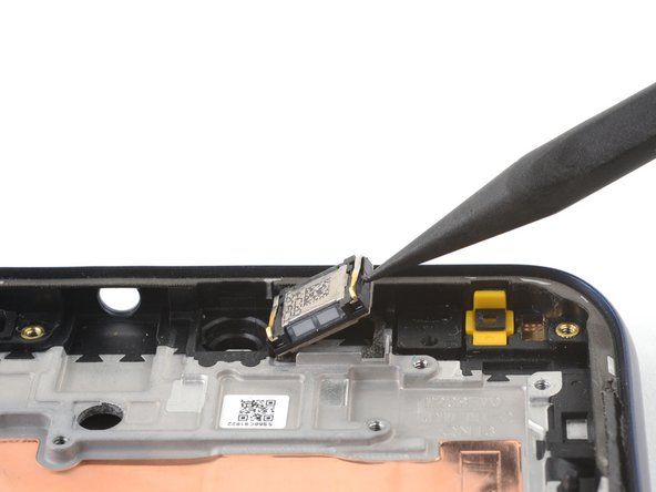

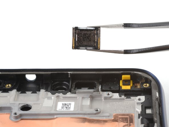

  35. Motorola Moto G Play (2021) Screen Replacement, Remove the earpiece speaker: crwdns2935265:035crwdnd2935265:01crwdnd2935265:03crwdne2935265:0 Motorola Moto G Play (2021) Screen Replacement, Remove the earpiece speaker: crwdns2935265:035crwdnd2935265:02crwdnd2935265:03crwdne2935265:0 Motorola Moto G Play (2021) Screen Replacement, Remove the earpiece speaker: crwdns2935265:035crwdnd2935265:03crwdnd2935265:03crwdne2935265:0
    • Insert the pointed end of your spudger between the right edge of the earpiece speaker and the motherboard.
    • Pry up on the speaker and remove it
    • During reassembly, ensure that the raised side of the connectors are toward the bottom of the device.

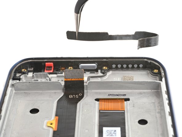

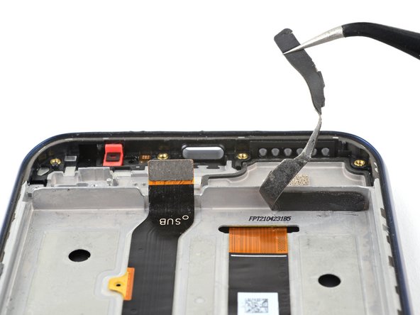

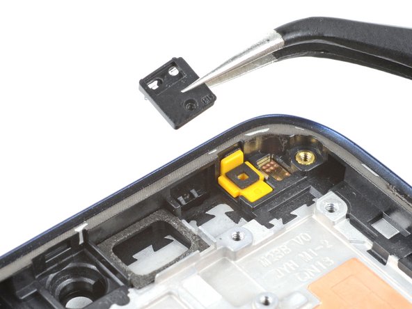

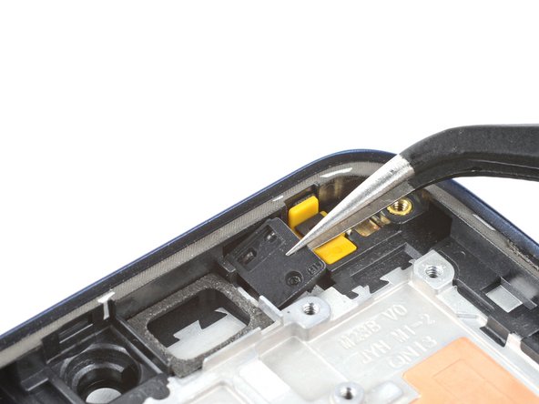

  36. Motorola Moto G Play (2021) Screen Replacement, Remove the proximity sensor bracket: crwdns2935265:036crwdnd2935265:01crwdnd2935265:03crwdne2935265:0 Motorola Moto G Play (2021) Screen Replacement, Remove the proximity sensor bracket: crwdns2935265:036crwdnd2935265:02crwdnd2935265:03crwdne2935265:0 Motorola Moto G Play (2021) Screen Replacement, Remove the proximity sensor bracket: crwdns2935265:036crwdnd2935265:03crwdnd2935265:03crwdne2935265:0
    • Use tweezers to grab and remove the proximity sensor bracket from its recess.
    • The rubber gasket is lightly adhered to the frame.

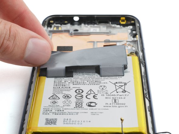

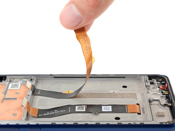

  37. Motorola Moto G Play (2021) Screen Replacement, Reposition the graphite film: crwdns2935265:037crwdnd2935265:01crwdnd2935265:02crwdne2935265:0 Motorola Moto G Play (2021) Screen Replacement, Reposition the graphite film: crwdns2935265:037crwdnd2935265:02crwdnd2935265:02crwdne2935265:0
    • Fold the graphite heat dispersion film toward the top of the battery.

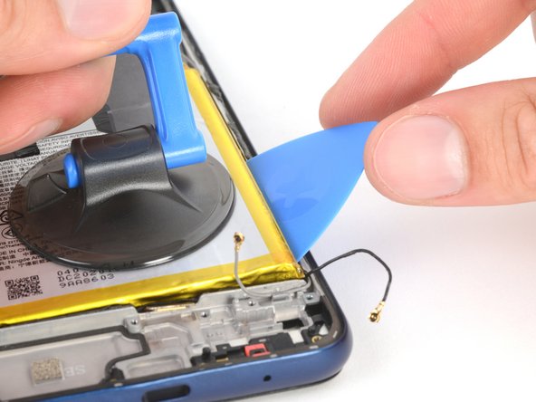

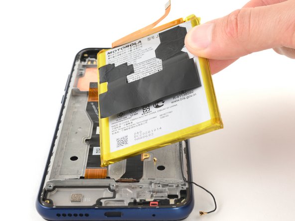

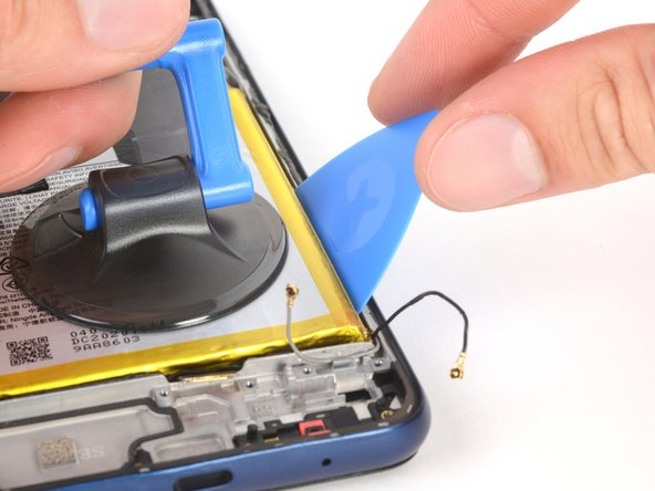

  40. Motorola Moto G Play (2021) Screen Replacement, Pry the battery: crwdns2935265:040crwdnd2935265:01crwdnd2935265:03crwdne2935265:0 Motorola Moto G Play (2021) Screen Replacement, Pry the battery: crwdns2935265:040crwdnd2935265:02crwdnd2935265:03crwdne2935265:0 Motorola Moto G Play (2021) Screen Replacement, Pry the battery: crwdns2935265:040crwdnd2935265:03crwdnd2935265:03crwdne2935265:0
    • Place a suction handle on the center of the battery.
    • Insert an opening pick between the right edge of the battery and the frame.
    • Use a steady force to pull on the suction handle and simultaneously pry with the pick.
    • Don't use excessive force on the battery. Slow, consistent pressure is all that is required to free it from the frame.
    • Apply more heat or isopropyl alcohol if the battery readheres.
  41. Motorola Moto G Play (2021) Screen Replacement, Remove the battery: crwdns2935265:041crwdnd2935265:01crwdnd2935265:02crwdne2935265:0 Motorola Moto G Play (2021) Screen Replacement, Remove the battery: crwdns2935265:041crwdnd2935265:02crwdnd2935265:02crwdne2935265:0
    • Remove the battery from its recess.
    • Don't reinstall a damaged or deformed battery, as doing so is a potential safety hazard.
    • Use this guide to install a battery with custom-cut adhesives, or use this guide to install a battery with an adhesive sheet.
  42. Motorola Moto G Play (2021) Screen Replacement, Remove the antenna cables: crwdns2935265:042crwdnd2935265:01crwdnd2935265:03crwdne2935265:0 Motorola Moto G Play (2021) Screen Replacement, Remove the antenna cables: crwdns2935265:042crwdnd2935265:02crwdnd2935265:03crwdne2935265:0 Motorola Moto G Play (2021) Screen Replacement, Remove the antenna cables: crwdns2935265:042crwdnd2935265:03crwdnd2935265:03crwdne2935265:0
    • Grab and remove the black antenna cable from its recess in the frame.
    • During reassembly, leave 5 mm of slack on the upper ends of the antenna cables.
  43. Motorola Moto G Play (2021) Screen Replacement: crwdns2935265:043crwdnd2935265:01crwdnd2935265:02crwdne2935265:0 Motorola Moto G Play (2021) Screen Replacement: crwdns2935265:043crwdnd2935265:02crwdnd2935265:02crwdne2935265:0
    • Grab and remove the gray antenna cable from its recess in the frame.
  44. Motorola Moto G Play (2021) Screen Replacement, Remove the foam strip: crwdns2935265:044crwdnd2935265:01crwdnd2935265:03crwdne2935265:0 Motorola Moto G Play (2021) Screen Replacement, Remove the foam strip: crwdns2935265:044crwdnd2935265:02crwdnd2935265:03crwdne2935265:0 Motorola Moto G Play (2021) Screen Replacement, Remove the foam strip: crwdns2935265:044crwdnd2935265:03crwdnd2935265:03crwdne2935265:0
    • Use your tweezers to peel and remove the foam strip from the bottom of the battery recess.
  45. Motorola Moto G Play (2021) Screen Replacement, Soften the board cable's adhesive: crwdns2935265:045crwdnd2935265:01crwdnd2935265:01crwdne2935265:0
    • Heat an iOpener and apply it to the board cable for two minutes.
    • The iOpener may stick to the residue left over from the battery. Clean the surrounding surface with highly-concentrated isopropyl alcohol (over 90%) to prevent this.
    • A hair dryer, heat gun, or hot plate may also be used, but be careful not to overheat the phone—the display is susceptible to heat damage.
  46. Motorola Moto G Play (2021) Screen Replacement, Remove the board cable: crwdns2935265:046crwdnd2935265:01crwdnd2935265:03crwdne2935265:0 Motorola Moto G Play (2021) Screen Replacement, Remove the board cable: crwdns2935265:046crwdnd2935265:02crwdnd2935265:03crwdne2935265:0 Motorola Moto G Play (2021) Screen Replacement, Remove the board cable: crwdns2935265:046crwdnd2935265:03crwdnd2935265:03crwdne2935265:0
    • Grab the upper end of the board cable.
    • Peel and remove the cable from the frame.
  47. Motorola Moto G Play (2021) Screen Replacement: crwdns2935265:047crwdnd2935265:01crwdnd2935265:01crwdne2935265:0
    • The screen is all that remains.
