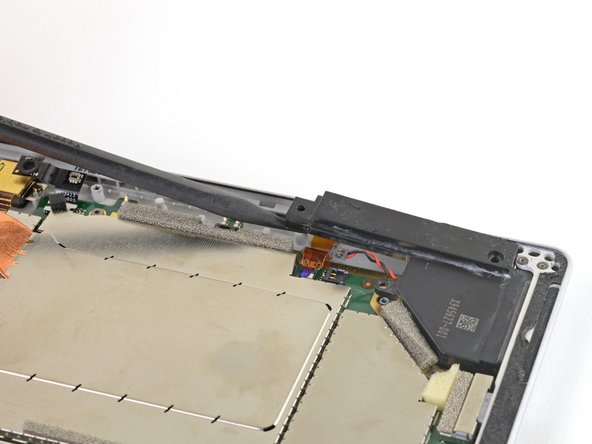

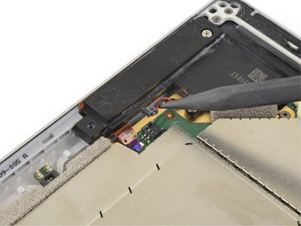

  23. Microsoft Surface Pro 4 Right Speaker Replacement, Remove the right speaker: crwdns2935265:023crwdnd2935265:01crwdnd2935265:02crwdne2935265:0 Microsoft Surface Pro 4 Right Speaker Replacement, Remove the right speaker: crwdns2935265:023crwdnd2935265:02crwdnd2935265:02crwdne2935265:0
    • Gently lift the speaker wire connector straight up with the pointed end of a spudger to disconnect it from the motherboard.
  24. Microsoft Surface Pro 4 Right Speaker Replacement: crwdns2935265:024crwdnd2935265:01crwdnd2935265:01crwdne2935265:0
    • Use a T5 Torx screwdriver to remove the following two screws securing the right speaker:
    • One 6.0 mm silver screw
    • One 4.2 mm grey screw

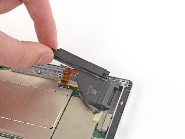

  25. Microsoft Surface Pro 4 Right Speaker Replacement: crwdns2935265:025crwdnd2935265:01crwdnd2935265:02crwdne2935265:0 Microsoft Surface Pro 4 Right Speaker Replacement: crwdns2935265:025crwdnd2935265:02crwdnd2935265:02crwdne2935265:0
    • Use a spudger to lift up the narrow section of the speaker box until you can grip it with your fingers.

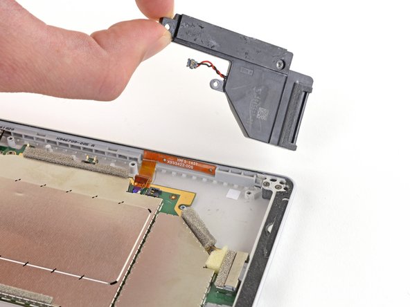

  26. Microsoft Surface Pro 4 Right Speaker Replacement: crwdns2935265:026crwdnd2935265:01crwdnd2935265:03crwdne2935265:0 Microsoft Surface Pro 4 Right Speaker Replacement: crwdns2935265:026crwdnd2935265:02crwdnd2935265:03crwdne2935265:0 Microsoft Surface Pro 4 Right Speaker Replacement: crwdns2935265:026crwdnd2935265:03crwdnd2935265:03crwdne2935265:0
    • Slide the right speaker back out of the chassis.
    • Remove the right speaker.
