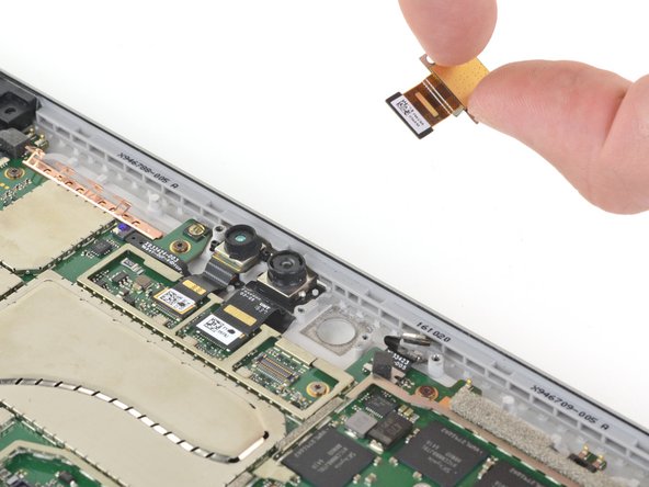

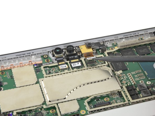

  31. Microsoft Surface Pro 4 Rear Camera Replacement, Remove the upper EMI shield: crwdns2935265:031crwdnd2935265:01crwdnd2935265:03crwdne2935265:0 Microsoft Surface Pro 4 Rear Camera Replacement, Remove the upper EMI shield: crwdns2935265:031crwdnd2935265:02crwdnd2935265:03crwdne2935265:0 Microsoft Surface Pro 4 Rear Camera Replacement, Remove the upper EMI shield: crwdns2935265:031crwdnd2935265:03crwdnd2935265:03crwdne2935265:0
    • Insert one point of a pair of pointed tweezers into a gap in the corner of the EMI shield covering the camera connectors.
    • Use the tweezers to pry the EMI shield away from the motherboard as much as you can without bending it.
    • Try not to deform the shield too much—you will need to reinstall it during reassembly.
    • Remove the EMI shield.
  32. Microsoft Surface Pro 4 Rear Camera Replacement, Remove the rear camera: crwdns2935265:032crwdnd2935265:01crwdnd2935265:02crwdne2935265:0 Microsoft Surface Pro 4 Rear Camera Replacement, Remove the rear camera: crwdns2935265:032crwdnd2935265:02crwdnd2935265:02crwdne2935265:0
    • Use the pointed end of a spudger to disconnect the rear camera from the motherboard.

    • Use a T3 Torx screwdriver to remove the two 2.2 mm screws securing the rear camera.
  34. Microsoft Surface Pro 4 Rear Camera Replacement: crwdns2935265:034crwdnd2935265:01crwdnd2935265:02crwdne2935265:0 Microsoft Surface Pro 4 Rear Camera Replacement: crwdns2935265:034crwdnd2935265:02crwdnd2935265:02crwdne2935265:0
    • Remove the rear camera.
