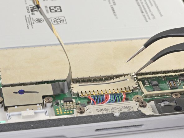

  17. Microsoft Surface Pro 4 Motherboard Replacement, Tip for removing EMI shields: crwdns2935265:017crwdnd2935265:01crwdnd2935265:03crwdne2935265:0 Microsoft Surface Pro 4 Motherboard Replacement, Tip for removing EMI shields: crwdns2935265:017crwdnd2935265:02crwdnd2935265:03crwdne2935265:0 Microsoft Surface Pro 4 Motherboard Replacement, Tip for removing EMI shields: crwdns2935265:017crwdnd2935265:03crwdnd2935265:03crwdne2935265:0
    $3.99
    • Use this method to remove any EMI shields necessary during your repair:
    • Use one tip of a pair of angled tweezers to pry up the EMI shield from the gaps between the "teeth."
    • Repeat this procedure at different points around the perimeter of the shield until it is free.
    • Try not to deform the shields too much—you will need to reinstall them during reassembly.
    • To reinstall, correct any deformations to the best of your ability, make sure the "teeth" align with the rim on the motherboard, and press down on the entire perimeter of the EMI shield.
    • Make sure all "teeth" are snug to the metal rim and not bent underneath the EMI shield.
    • Make sure the "teeth" are also touching the gold conductive strips on the top of ribbon cables.

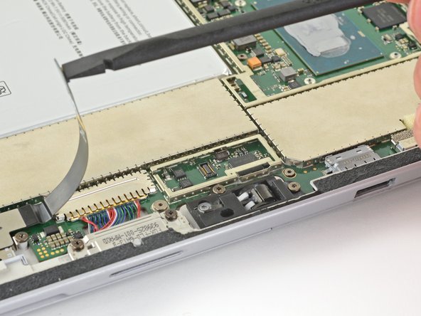

  18. Microsoft Surface Pro 4 Motherboard Replacement, Disconnect the screen: crwdns2935265:018crwdnd2935265:01crwdnd2935265:03crwdne2935265:0 Microsoft Surface Pro 4 Motherboard Replacement, Disconnect the screen: crwdns2935265:018crwdnd2935265:02crwdnd2935265:03crwdne2935265:0 Microsoft Surface Pro 4 Motherboard Replacement, Disconnect the screen: crwdns2935265:018crwdnd2935265:03crwdnd2935265:03crwdne2935265:0
    • Use your tweezers to remove the two EMI shields covering the display cable connectors.
  19. Microsoft Surface Pro 4 Motherboard Replacement: crwdns2935265:019crwdnd2935265:01crwdnd2935265:03crwdne2935265:0 Microsoft Surface Pro 4 Motherboard Replacement: crwdns2935265:019crwdnd2935265:02crwdnd2935265:03crwdne2935265:0 Microsoft Surface Pro 4 Motherboard Replacement: crwdns2935265:019crwdnd2935265:03crwdnd2935265:03crwdne2935265:0
    • Pry up with the flat end of a spudger to disconnect each display cable from the motherboard.

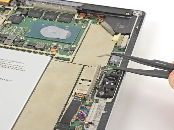

  23. Microsoft Surface Pro 4 Motherboard Replacement, Remove the CPU shield: crwdns2935265:023crwdnd2935265:01crwdnd2935265:02crwdne2935265:0 Microsoft Surface Pro 4 Motherboard Replacement, Remove the CPU shield: crwdns2935265:023crwdnd2935265:02crwdnd2935265:02crwdne2935265:0
    • Insert one point of a pair of pointed tweezers into a gap in the corner of the EMI shield covering the heat sink.
    • Use the tweezers to pry the EMI shield away from the motherboard as much as you can without bending it. Do not remove it yet.
    • Take care not to puncture the battery with the tweezers while working on this shield.

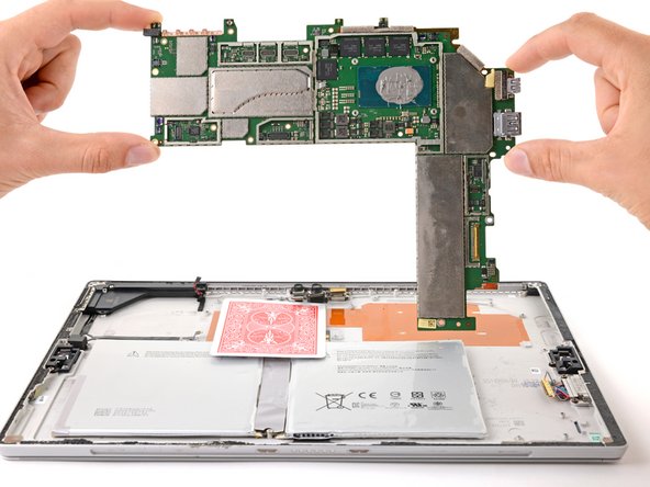

  24. Microsoft Surface Pro 4 Motherboard Replacement: crwdns2935265:024crwdnd2935265:01crwdnd2935265:03crwdne2935265:0 Microsoft Surface Pro 4 Motherboard Replacement: crwdns2935265:024crwdnd2935265:02crwdnd2935265:03crwdne2935265:0 Microsoft Surface Pro 4 Motherboard Replacement: crwdns2935265:024crwdnd2935265:03crwdnd2935265:03crwdne2935265:0
    • Repeat the last step at various locations around the perimeter of the EMI shield covering the heat sink.
    • Remove the CPU shield.

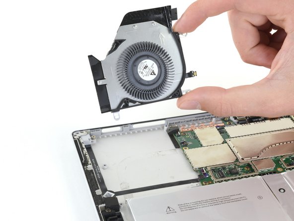

  26. Microsoft Surface Pro 4 Motherboard Replacement: crwdns2935265:026crwdnd2935265:01crwdnd2935265:01crwdne2935265:0
    • The heat sink is firmly adhered to the fan.
    • Use a Phillips screwdriver to remove three 2.4 mm screws securing the fan.
    • Use a T5 Torx screwdriver to remove the final 4.4 mm screw securing in the fan cover.
  27. Microsoft Surface Pro 4 Motherboard Replacement: crwdns2935265:027crwdnd2935265:01crwdnd2935265:01crwdne2935265:0
    • Use a T5 Torx screwdriver to remove the heat sink screws surrounding the CPU in the following pattern, one turn at a time, until they're free.
    • Screw 1
    • Screw 2
    • Screw 3
    • Screw 4
    • During reassembly, use the same method to install these screws, tightening one turn at a time until each screw is snug.

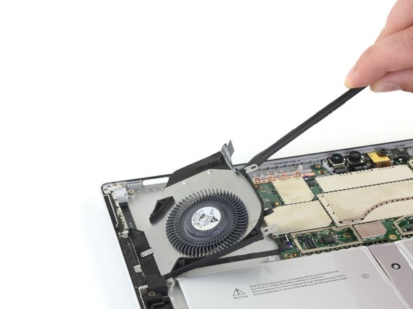

  28. Microsoft Surface Pro 4 Motherboard Replacement, Remove the heatsink: crwdns2935265:028crwdnd2935265:01crwdnd2935265:02crwdne2935265:0 Microsoft Surface Pro 4 Motherboard Replacement, Remove the heatsink: crwdns2935265:028crwdnd2935265:02crwdnd2935265:02crwdne2935265:0
    • Use the flat end of a spudger to gently pry the heat sink straight up and off of the CPU.
    • Take care not to dent or crease the heat sink pipes during removal.
  29. Microsoft Surface Pro 4 Motherboard Replacement: crwdns2935265:029crwdnd2935265:01crwdnd2935265:03crwdne2935265:0 Microsoft Surface Pro 4 Motherboard Replacement: crwdns2935265:029crwdnd2935265:02crwdnd2935265:03crwdne2935265:0 Microsoft Surface Pro 4 Motherboard Replacement: crwdns2935265:029crwdnd2935265:03crwdnd2935265:03crwdne2935265:0
    • Insert the pointed end of a spudger into a screw hole in the fan shield and lift up to separate it from the fan.
    • The fan shield is held in place with light adhesive.

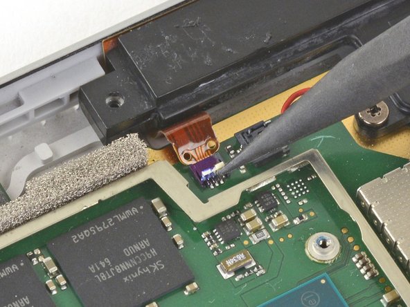

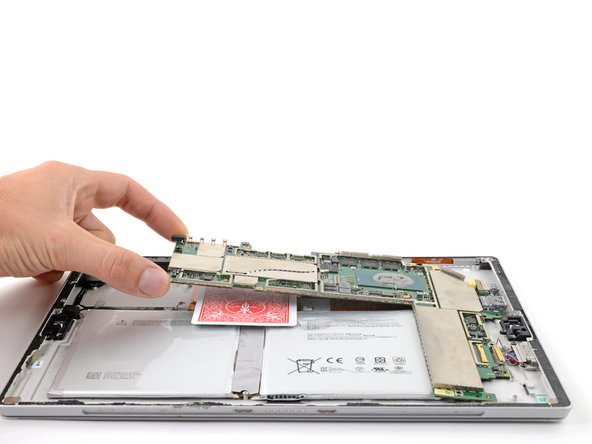

  31. Microsoft Surface Pro 4 Motherboard Replacement, Remove the upper EMI shield: crwdns2935265:031crwdnd2935265:01crwdnd2935265:03crwdne2935265:0 Microsoft Surface Pro 4 Motherboard Replacement, Remove the upper EMI shield: crwdns2935265:031crwdnd2935265:02crwdnd2935265:03crwdne2935265:0 Microsoft Surface Pro 4 Motherboard Replacement, Remove the upper EMI shield: crwdns2935265:031crwdnd2935265:03crwdnd2935265:03crwdne2935265:0
    • Insert one point of a pair of pointed tweezers into a gap in the corner of the EMI shield covering the camera connectors.
    • Try not to deform the shield too much—you will need to reinstall it during reassembly.
    • Remove the EMI shield.

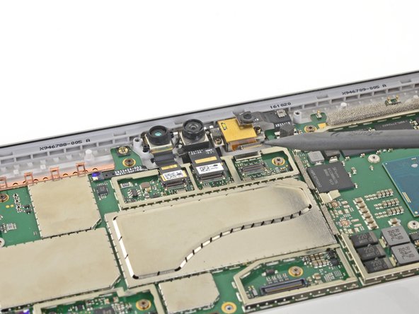

  32. Microsoft Surface Pro 4 Motherboard Replacement, Disconnect the cameras: crwdns2935265:032crwdnd2935265:01crwdnd2935265:03crwdne2935265:0 Microsoft Surface Pro 4 Motherboard Replacement, Disconnect the cameras: crwdns2935265:032crwdnd2935265:02crwdnd2935265:03crwdne2935265:0 Microsoft Surface Pro 4 Motherboard Replacement, Disconnect the cameras: crwdns2935265:032crwdnd2935265:03crwdnd2935265:03crwdne2935265:0
    • Pry up with the pointed end of your spudger to disconnect all three camera cables from the motherboard.

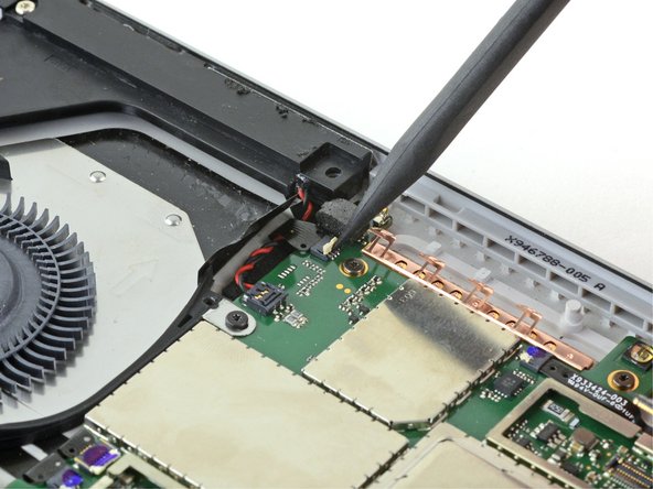

  34. Microsoft Surface Pro 4 Motherboard Replacement, Disconnect the left speaker: crwdns2935265:034crwdnd2935265:01crwdnd2935265:02crwdne2935265:0 Microsoft Surface Pro 4 Motherboard Replacement, Disconnect the left speaker: crwdns2935265:034crwdnd2935265:02crwdnd2935265:02crwdne2935265:0
    • Slide the pointed end of a spudger between the speaker wires and the motherboard until it is resting against the speaker wire connector.
    • Carefully pry straight up on the speaker wire connector to disconnect it from the motherboard.
    • Be gentle—the speaker wires are delicate.
    • During reassembly, place the new speaker wire harness on top of the connector on the motherboard and gently press it straight down with your finger to reconnect it.

  38. Microsoft Surface Pro 4 Motherboard Replacement, Remove the fan: crwdns2935265:038crwdnd2935265:01crwdnd2935265:03crwdne2935265:0 Microsoft Surface Pro 4 Motherboard Replacement, Remove the fan: crwdns2935265:038crwdnd2935265:02crwdnd2935265:03crwdne2935265:0 Microsoft Surface Pro 4 Motherboard Replacement, Remove the fan: crwdns2935265:038crwdnd2935265:03crwdnd2935265:03crwdne2935265:0
    • Use a spudger to lift one side of the fan.
    • Pick up the fan and remove it.
  39. Microsoft Surface Pro 4 Motherboard Replacement, Remove the EMI shield: crwdns2935265:039crwdnd2935265:01crwdnd2935265:03crwdne2935265:0 Microsoft Surface Pro 4 Motherboard Replacement, Remove the EMI shield: crwdns2935265:039crwdnd2935265:02crwdnd2935265:03crwdne2935265:0 Microsoft Surface Pro 4 Motherboard Replacement, Remove the EMI shield: crwdns2935265:039crwdnd2935265:03crwdnd2935265:03crwdne2935265:0
    • Insert one point of a pair of tweezers into a gap in the edge of the EMI shield covering the microSD card reader cable and connector.
    • Remove the shield.

  41. Microsoft Surface Pro 4 Motherboard Replacement, Remove the EMI shield: crwdns2935265:041crwdnd2935265:01crwdnd2935265:03crwdne2935265:0 Microsoft Surface Pro 4 Motherboard Replacement, Remove the EMI shield: crwdns2935265:041crwdnd2935265:02crwdnd2935265:03crwdne2935265:0 Microsoft Surface Pro 4 Motherboard Replacement, Remove the EMI shield: crwdns2935265:041crwdnd2935265:03crwdnd2935265:03crwdne2935265:0
    • Insert one point of a pair of tweezers into a gap in the edge of the EMI shield covering the charging assembly cable connector.

  46. Microsoft Surface Pro 4 Motherboard Replacement, Disconnect the flex cable: crwdns2935265:046crwdnd2935265:01crwdnd2935265:03crwdne2935265:0 Microsoft Surface Pro 4 Motherboard Replacement, Disconnect the flex cable: crwdns2935265:046crwdnd2935265:02crwdnd2935265:03crwdne2935265:0 Microsoft Surface Pro 4 Motherboard Replacement, Disconnect the flex cable: crwdns2935265:046crwdnd2935265:03crwdnd2935265:03crwdne2935265:0
    • Use the pointed end of your spudger to unlock the ZIF connector between the processor and right speaker.
    • Disconnect the cable from the ZIF connector.
  47. Microsoft Surface Pro 4 Motherboard Replacement, Disconnect the right speaker: crwdns2935265:047crwdnd2935265:01crwdnd2935265:02crwdne2935265:0 Microsoft Surface Pro 4 Motherboard Replacement, Disconnect the right speaker: crwdns2935265:047crwdnd2935265:02crwdnd2935265:02crwdne2935265:0
    • Slide the pointed end of a spudger between the right speaker wires and the motherboard until it is resting against the speaker wire connector.

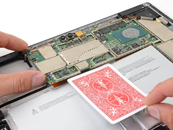

  49. Microsoft Surface Pro 4 Motherboard Replacement, Block the battery connector: crwdns2935265:049crwdnd2935265:01crwdnd2935265:03crwdne2935265:0 Microsoft Surface Pro 4 Motherboard Replacement, Block the battery connector: crwdns2935265:049crwdnd2935265:02crwdnd2935265:03crwdne2935265:0 Microsoft Surface Pro 4 Motherboard Replacement, Block the battery connector: crwdns2935265:049crwdnd2935265:03crwdnd2935265:03crwdne2935265:0
    • As you remove the motherboard, there's a chance it'll short-circuit against the battery connector. Block this connection to prevent damage.
    • Slightly lift the left edge of the motherboard.
    • Insert a playing card or similar object between the battery connector and the motherboard.
    • If your card catches on the underside of the motherboard, wiggle the card until it slides fully underneath.
    • If you're reassembling your Surface Pro with a new battery, remove the playing card now.

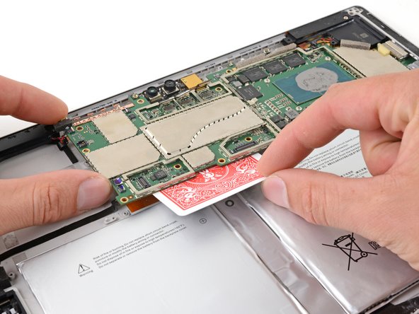

  51. Microsoft Surface Pro 4 Motherboard Replacement, Remove the motherboard: crwdns2935265:051crwdnd2935265:01crwdnd2935265:03crwdne2935265:0 Microsoft Surface Pro 4 Motherboard Replacement, Remove the motherboard: crwdns2935265:051crwdnd2935265:02crwdnd2935265:03crwdne2935265:0 Microsoft Surface Pro 4 Motherboard Replacement, Remove the motherboard: crwdns2935265:051crwdnd2935265:03crwdnd2935265:03crwdne2935265:0
    • Remove the motherboard by first lifting the left side until it is at roughly a 30 degree angle.
    • Gently slide the I/O ports on the motherboard out from their openings and remove the motherboard.
    • During reassembly, make sure the charging assembly, left speaker, and three camera cables are not trapped under the motherboard before you proceed.
