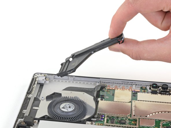

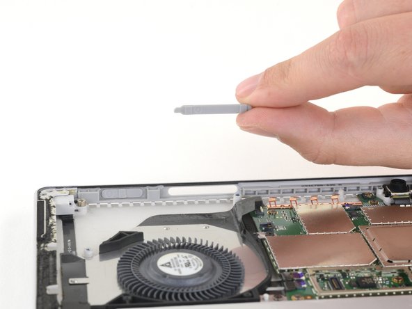

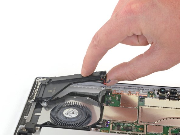

  31. Microsoft Surface Pro 4 Left Speaker Replacement, Remove the left speaker: crwdns2935265:031crwdnd2935265:01crwdnd2935265:03crwdne2935265:0 Microsoft Surface Pro 4 Left Speaker Replacement, Remove the left speaker: crwdns2935265:031crwdnd2935265:02crwdnd2935265:03crwdne2935265:0 Microsoft Surface Pro 4 Left Speaker Replacement, Remove the left speaker: crwdns2935265:031crwdnd2935265:03crwdnd2935265:03crwdne2935265:0
    • Gently slide the flat end of a spudger between the speaker wires and the motherboard until it is resting against the connector.
    • Carefully pry straight up on the speaker wire connector to disconnect it from the motherboard.
    • Be gentle—the speaker wires are delicate.
    • During reassembly, place the new speaker wire harness on top of the connector on the motherboard and gently press it straight down with your finger to reconnect it.

    • Use a T5 Torx screwdriver to remove the 3.3 mm screw securing the left speaker.
  34. Microsoft Surface Pro 4 Left Speaker Replacement: crwdns2935265:034crwdnd2935265:01crwdnd2935265:03crwdne2935265:0 Microsoft Surface Pro 4 Left Speaker Replacement: crwdns2935265:034crwdnd2935265:02crwdnd2935265:03crwdne2935265:0 Microsoft Surface Pro 4 Left Speaker Replacement: crwdns2935265:034crwdnd2935265:03crwdnd2935265:03crwdne2935265:0
    • Grip the left speaker by the narrow section of the box and slide it back out of the chassis.
    • Remove the left speaker.

    • The volume and power buttons are now loose and may fall out. Make sure not to lose them.
    • During reassembly, notice that the volume button is shaped to prevent it from being installed backwards. If it has fallen out and does not fit back into the chassis, reverse it and try again.
