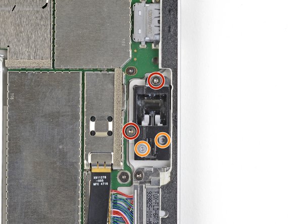

  21. Microsoft Surface Pro 4 Kickstand Hinge Replacement, Remove the kickstand hinges: crwdns2935265:021crwdnd2935265:01crwdnd2935265:02crwdne2935265:0 Microsoft Surface Pro 4 Kickstand Hinge Replacement, Remove the kickstand hinges: crwdns2935265:021crwdnd2935265:02crwdnd2935265:02crwdne2935265:0
    • Use a T5 Torx screwdriver to remove the following four screws from each kickstand hinge you are replacing:
    • Two 3.7 mm screws
    • Two 3.3 mm screws

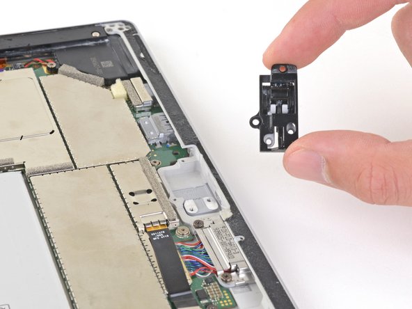

  22. Microsoft Surface Pro 4 Kickstand Hinge Replacement: crwdns2935265:022crwdnd2935265:01crwdnd2935265:03crwdne2935265:0 Microsoft Surface Pro 4 Kickstand Hinge Replacement: crwdns2935265:022crwdnd2935265:02crwdnd2935265:03crwdne2935265:0 Microsoft Surface Pro 4 Kickstand Hinge Replacement: crwdns2935265:022crwdnd2935265:03crwdnd2935265:03crwdne2935265:0
    • Remove the kickstand hinge(s).
