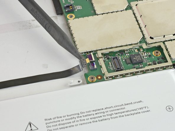

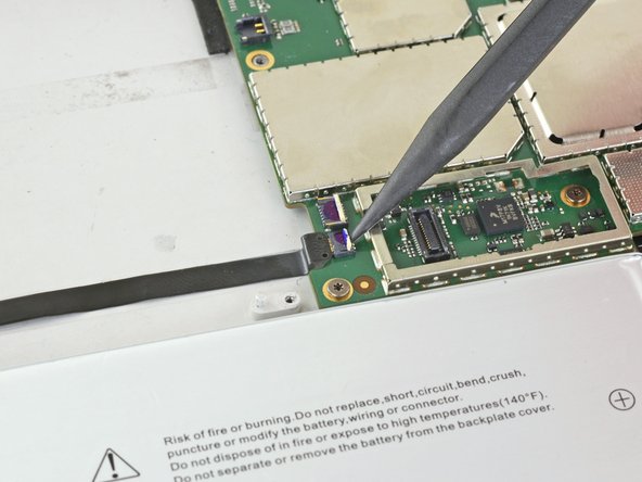

  18. Microsoft Surface Pro 4 Headphone Jack Replacement, Disconnect the screen: crwdns2935265:018crwdnd2935265:01crwdnd2935265:03crwdne2935265:0 Microsoft Surface Pro 4 Headphone Jack Replacement, Disconnect the screen: crwdns2935265:018crwdnd2935265:02crwdnd2935265:03crwdne2935265:0 Microsoft Surface Pro 4 Headphone Jack Replacement, Disconnect the screen: crwdns2935265:018crwdnd2935265:03crwdnd2935265:03crwdne2935265:0
    • Use your tweezers to remove the two EMI shields covering the display cable connectors.
  19. Microsoft Surface Pro 4 Headphone Jack Replacement: crwdns2935265:019crwdnd2935265:01crwdnd2935265:03crwdne2935265:0 Microsoft Surface Pro 4 Headphone Jack Replacement: crwdns2935265:019crwdnd2935265:02crwdnd2935265:03crwdne2935265:0 Microsoft Surface Pro 4 Headphone Jack Replacement: crwdns2935265:019crwdnd2935265:03crwdnd2935265:03crwdne2935265:0
    • Pry up with the flat end of a spudger to disconnect each display cable from the motherboard.

    • Use the flat end of a spudger to flip up the white plastic locking flap of the ZIF connector at the top-left corner of the motherboard.
    • Be sure to pry up on the hinged flap, not the connector itself.
    • Use the pointed end of a spudger to pull the cable out.

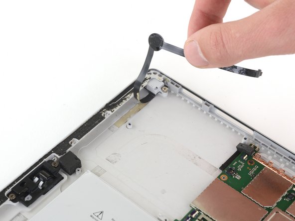

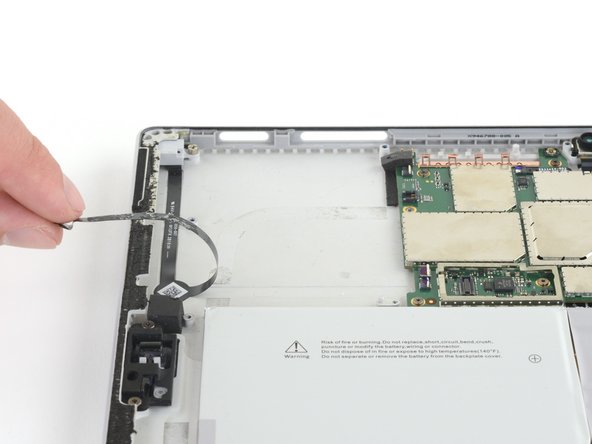

    • Gently peel the headphone jack ribbon cable off of the case until you reach the corner of the cable.
  41. Microsoft Surface Pro 4 Headphone Jack Replacement: crwdns2935265:041crwdnd2935265:01crwdnd2935265:02crwdne2935265:0 Microsoft Surface Pro 4 Headphone Jack Replacement: crwdns2935265:041crwdnd2935265:02crwdnd2935265:02crwdne2935265:0
    • Gently peel the rest of the headphone jack cable off of the case.
  42. Microsoft Surface Pro 4 Headphone Jack Replacement: crwdns2935265:042crwdnd2935265:01crwdnd2935265:01crwdne2935265:0

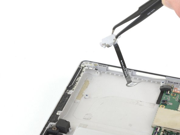

    • Use a standoff screwdriver to remove the 4.3 mm screw securing the headphone jack to the case.
  43. Microsoft Surface Pro 4 Headphone Jack Replacement: crwdns2935265:043crwdnd2935265:01crwdnd2935265:02crwdne2935265:0 Microsoft Surface Pro 4 Headphone Jack Replacement: crwdns2935265:043crwdnd2935265:02crwdnd2935265:02crwdne2935265:0
    • Remove the headphone jack.
