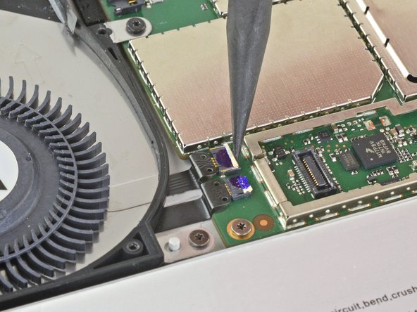

  28. Microsoft Surface Pro 4 Fan Replacement, Remove the heatsink: crwdns2935265:028crwdnd2935265:01crwdnd2935265:02crwdne2935265:0 Microsoft Surface Pro 4 Fan Replacement, Remove the heatsink: crwdns2935265:028crwdnd2935265:02crwdnd2935265:02crwdne2935265:0
    • Use the flat end of a spudger to gently pry the heat sink straight up and off of the CPU.
    • Take care not to dent or crease the heat sink pipes during removal.

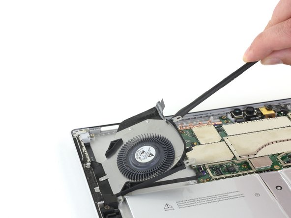

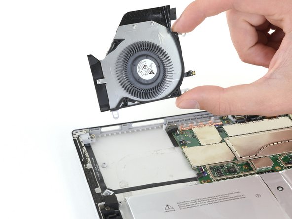

  29. Microsoft Surface Pro 4 Fan Replacement: crwdns2935265:029crwdnd2935265:01crwdnd2935265:03crwdne2935265:0 Microsoft Surface Pro 4 Fan Replacement: crwdns2935265:029crwdnd2935265:02crwdnd2935265:03crwdne2935265:0 Microsoft Surface Pro 4 Fan Replacement: crwdns2935265:029crwdnd2935265:03crwdnd2935265:03crwdne2935265:0
    • Insert the pointed end of a spudger into a screw hole in the fan shield and lift up to separate it from the fan.
    • The fan shield is held in place with light adhesive.
  30. Microsoft Surface Pro 4 Fan Replacement: crwdns2935265:030crwdnd2935265:01crwdnd2935265:01crwdne2935265:0

  36. Microsoft Surface Pro 4 Fan Replacement, Remove the fan: crwdns2935265:036crwdnd2935265:01crwdnd2935265:03crwdne2935265:0 Microsoft Surface Pro 4 Fan Replacement, Remove the fan: crwdns2935265:036crwdnd2935265:02crwdnd2935265:03crwdne2935265:0 Microsoft Surface Pro 4 Fan Replacement, Remove the fan: crwdns2935265:036crwdnd2935265:03crwdnd2935265:03crwdne2935265:0
    • Use the pointed end of a spudger to open the ZIF connector securing the fan to the motherboard.
    • The correct connector is near the lower-right corner of the fan, closest to the top of the device.
    • Disconnect the fan cable.
  37. Microsoft Surface Pro 4 Fan Replacement: crwdns2935265:037crwdnd2935265:01crwdnd2935265:01crwdne2935265:0
    • Use a T3 Torx screwdriver to remove the following screws from the fan:
    • One 2.5 mm screw with coarse threads
    • Two 2.4 mm screws
  38. Microsoft Surface Pro 4 Fan Replacement: crwdns2935265:038crwdnd2935265:01crwdnd2935265:03crwdne2935265:0 Microsoft Surface Pro 4 Fan Replacement: crwdns2935265:038crwdnd2935265:02crwdnd2935265:03crwdne2935265:0 Microsoft Surface Pro 4 Fan Replacement: crwdns2935265:038crwdnd2935265:03crwdnd2935265:03crwdne2935265:0
    • Use a spudger to lift one side of the fan.
    • Pick up the fan and remove it.
