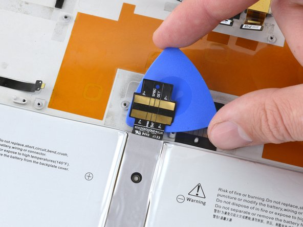

    2. Microsoft Surface Pro 4 Battery Replacement: crwdns2935265:053crwdnd2935265:01crwdnd2935265:03crwdne2935265:0 Microsoft Surface Pro 4 Battery Replacement: crwdns2935265:053crwdnd2935265:02crwdnd2935265:03crwdne2935265:0 Microsoft Surface Pro 4 Battery Replacement: crwdns2935265:053crwdnd2935265:03crwdnd2935265:03crwdne2935265:0
      • Starting at the edge furthest from the battery, slide an opening pick under the battery connector to separate the adhesive underneath.
      • Make sure the battery connector is completely free from the case.

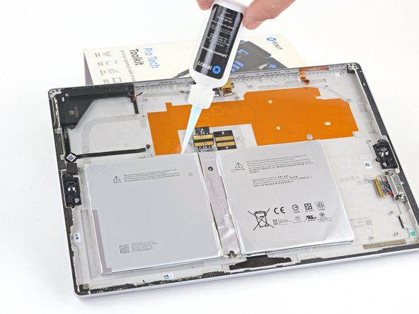

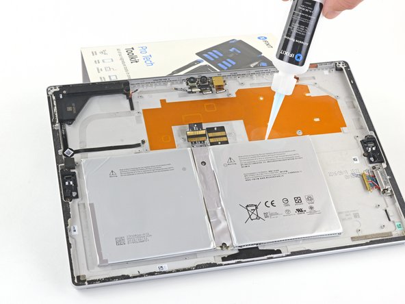

    3. Microsoft Surface Pro 4 Battery Replacement: crwdns2935265:054crwdnd2935265:01crwdnd2935265:03crwdne2935265:0 Microsoft Surface Pro 4 Battery Replacement: crwdns2935265:054crwdnd2935265:02crwdnd2935265:03crwdne2935265:0 Microsoft Surface Pro 4 Battery Replacement: crwdns2935265:054crwdnd2935265:03crwdnd2935265:03crwdne2935265:0
      • Prop the top edge of the Surface up a couple inches so the whole Surface slopes towards the bottom edge.
      • Drip adhesive remover or high-concentration (90% or higher) isopropyl alcohol under the top edge of the battery.
      • If you are using adhesive remover, follow these preparation steps first.
      • Let the solvent sit and soak into the adhesive for 2-3 minutes before continuing.

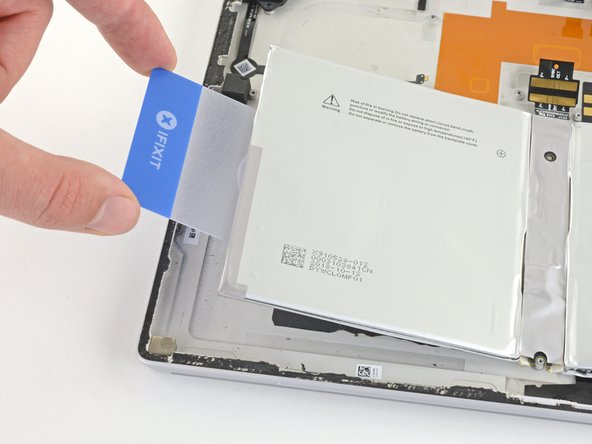

    4. Microsoft Surface Pro 4 Battery Replacement: crwdns2935265:055crwdnd2935265:01crwdnd2935265:03crwdne2935265:0 Microsoft Surface Pro 4 Battery Replacement: crwdns2935265:055crwdnd2935265:02crwdnd2935265:03crwdne2935265:0 Microsoft Surface Pro 4 Battery Replacement: crwdns2935265:055crwdnd2935265:03crwdnd2935265:03crwdne2935265:0
      Plastic Cards
      $2.99
      • Take care not to puncture or bend the battery with your tools—a punctured or bent battery may leak dangerous chemicals or cause a thermal event.
      • Slide a plastic card under the left side of the top edge of the battery.
      • If you encounter significant resistance at any point during this procedure, stop, apply a little more adhesive remover, and wait for it to soak in.
      • Slide the card side to side under the upper left battery cell to slice through the adhesive underneath.

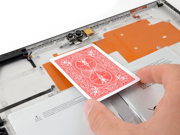

    5. Microsoft Surface Pro 4 Battery Replacement: crwdns2935265:056crwdnd2935265:01crwdnd2935265:03crwdne2935265:0 Microsoft Surface Pro 4 Battery Replacement: crwdns2935265:056crwdnd2935265:02crwdnd2935265:03crwdne2935265:0 Microsoft Surface Pro 4 Battery Replacement: crwdns2935265:056crwdnd2935265:03crwdnd2935265:03crwdne2935265:0
      • Fully insert your plastic card under the left battery cell and pry up to separate it from the chassis.

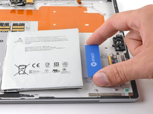

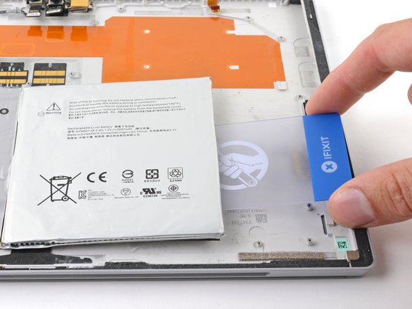

    6. Microsoft Surface Pro 4 Battery Replacement: crwdns2935265:057crwdnd2935265:01crwdnd2935265:03crwdne2935265:0 Microsoft Surface Pro 4 Battery Replacement: crwdns2935265:057crwdnd2935265:02crwdnd2935265:03crwdne2935265:0 Microsoft Surface Pro 4 Battery Replacement: crwdns2935265:057crwdnd2935265:03crwdnd2935265:03crwdne2935265:0
      • Insert your card under the right battery cell and pry up to separate it from the chassis.

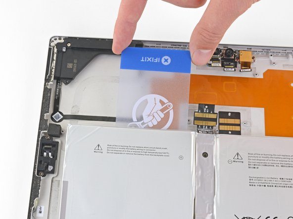

    7. Microsoft Surface Pro 4 Battery Replacement, Reassembly information: crwdns2935265:058crwdnd2935265:01crwdnd2935265:02crwdne2935265:0 Microsoft Surface Pro 4 Battery Replacement, Reassembly information: crwdns2935265:058crwdnd2935265:02crwdnd2935265:02crwdne2935265:0
      • After you install a new battery, place a playing card or similar object over the battery connector and leave it in place until you've installed the motherboard.
